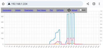

I have been chasing this problem for a while now.
Firmware version 1.10a Zombieverter
I have enclosed my parameter settings and 2 pictures of plots with differing speeds and throttle activation.
My observations are,
Even though MG1 and MG2 data are selected on the graph I can't see a plot for MG1 (top of graph).
The power plot (very low curve at bottom of graph, red) seems to show a jump then a flat line then a drop off before the Torque drops to zero.
Any thoughts or observations would be greatly appreciated.

Re-continuing problem,
The plot included shows, Torque (Blue), Power (red) and Potnom (Orange).
I think this problem is related to the power of my battery pack, 52Kwh. You can see that the system is cutting in and out because of a limit.
Could the reason be that Damien is not seeing this issue is because his pack is 22Kwh and so he is not reaching the set limit?
I can only stop the cutting out by reducing my throtmax to 16% or below which makes it drive like a snail.
I have tried to edit out the line
310 Throttle::IdcLimitCommand(finalSpnt, Param::Get(Param::idc));
in the utils.cpp file to test this theory as per et0's post on 17th November but I am having trouble compiling a usable .bin file.
I must admit I am getting desperate as I have been chasing this issue for 2 months now. :?

So it looks like something's pulling potnom to zero, and the inverter is reacting to that? Any errors stored?
Checked the connections on your throttle sensor? A loose +5V connection, for example, could have the pot output drop to zero intermittently.
How's your throttle pot signal getting to Zombieverter? (Direct analogue connection, or over CAN? Scoping the analogue, or logging CAN messages may 'prove' that the Zombieverter input is good/not good)
The 'speed' readout in your first images looks strange. Some large intervals between updates? Noise/grounding issues? Or is your inverter cutting out and resetting?
If your throttle signal is getting to Zombieverter cleanly, then yes, I suspect you're hitting a limit somewhere. I think it can derate based on inverter temperatures, HV voltage, HV and/or AC current, and your BMS may ask it to derate. All of those require parameters to be set.
Your udc, idc, temp parameters look sensible (what is your minimum and maximum pack voltage?) Check your udcsw value.
Have you (re)set the throttle parameters (potmin potmax throtmin throtmax throtdead) since the recent-ish change to their usage?
Have you plotted/logged udc, idc, temperatures during these cutouts? If udc goes out of range/currents get too high/temperatures get too high, it'll derate quite hard.
Worth running through https://openinverter.org/wiki/ZombieVer ... nd_testing again, just to make sure.

This problem was definately due to a hard cut off by the VCU. This may be a design point to stop the transmission being over powered. Unfortunately rather than tapering the power off there is a hard cut. This causes a massive shock through the transmission and could do more harm than good.
Having finally managed to get a compiled version of 1.10A with the line in util.cpp,
edited out (//) I have a driveable car.
