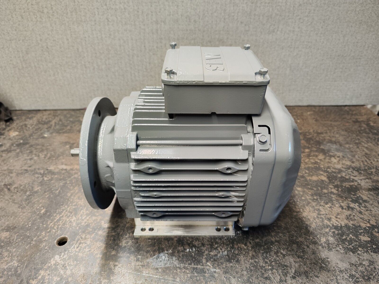

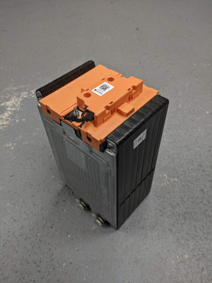

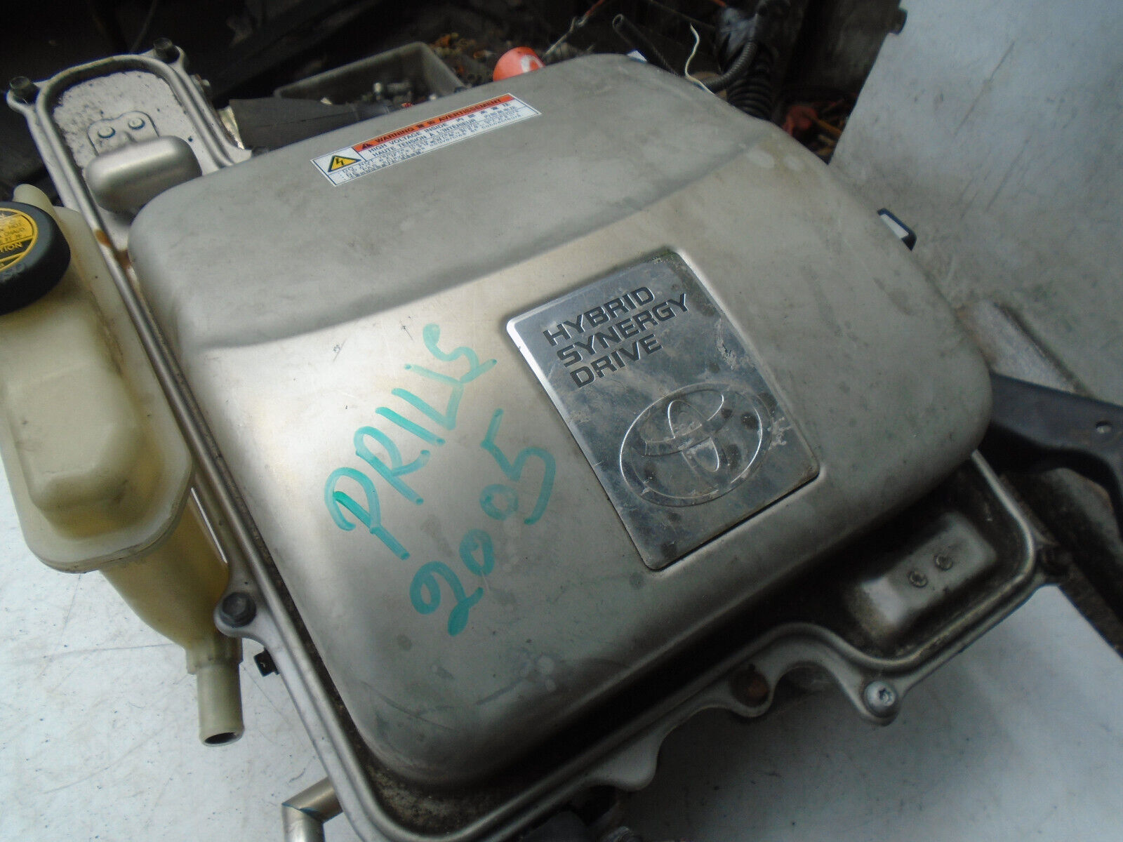

I am currently sourcing parts to build a bench testing setup for stm32-sine (particularly the code targeting Tesla drive units). This is probably one of the least exciting hardware projects on this forum, but I thought I'd document it anyway.
The plan is to build a 1kW openinverter setup in my small home workshop, and use it to test changes to the stm32-sine code. I want to be able to validate openinverter releases before running them in my main vehicle, but also develop some changes of my own.
I've ordered some hardware and will start building once everything arrives:

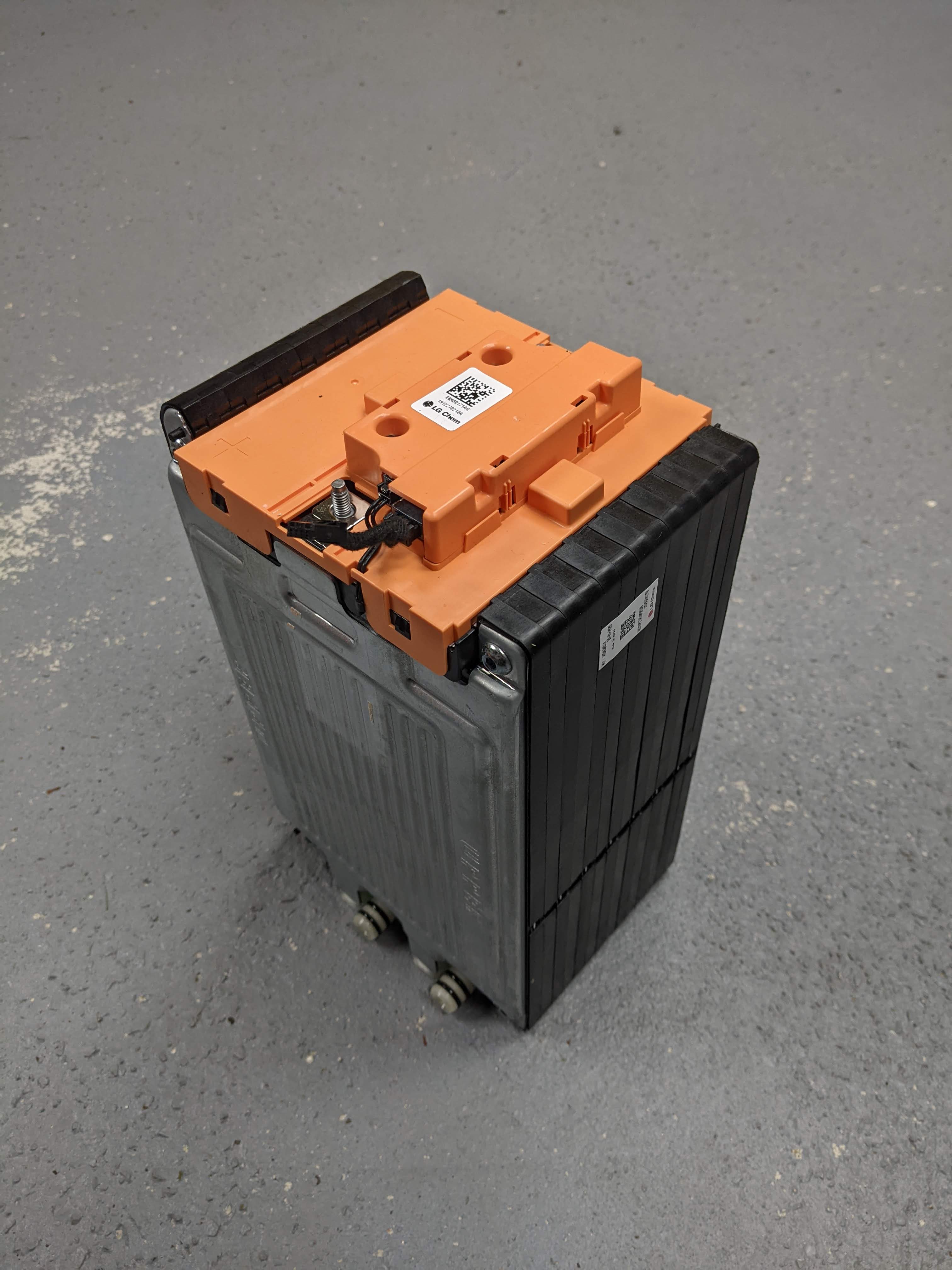

* 16S (60V) 30AH lithium battery module
* Prius gen2 inverter (and of course the appropriate openinverter logic board)
* 1.1kW 230V 4 pole industrial motor
* 100 PPR optical encoder

Any plans to add a second motor to provide load/regen capabilities? What are you doing for the encoder/resolver?
Edit - are you planning to use the Prius boost converter to step the voltage up?

Pete9008 wrote: Tue Dec 06, 2022 11:51 am Any plans to add a second motor to provide load/regen capabilities?
I haven't worked that out yet. I'm hoping I might be able to use a flywheel to simulate a load for both acceleration and regen.
Pete9008 wrote: Tue Dec 06, 2022 11:51 am What are you doing for the encoder/resolver?
I will use one of these: https://www.ebay.co.uk/itm/184451719957
It will be belt driven and if possible, I will set up the gearing to provide a reduction to cause it to output around 100 pulses per recolution.
Pete9008 wrote: Tue Dec 06, 2022 11:51 am Edit - are you planning to use the Prius boost converter to step the voltage up?
Yes, I'm hoping to run the 1100W 240VAC motor using a 60V battery. Hopefully this is within the capability of the converter.

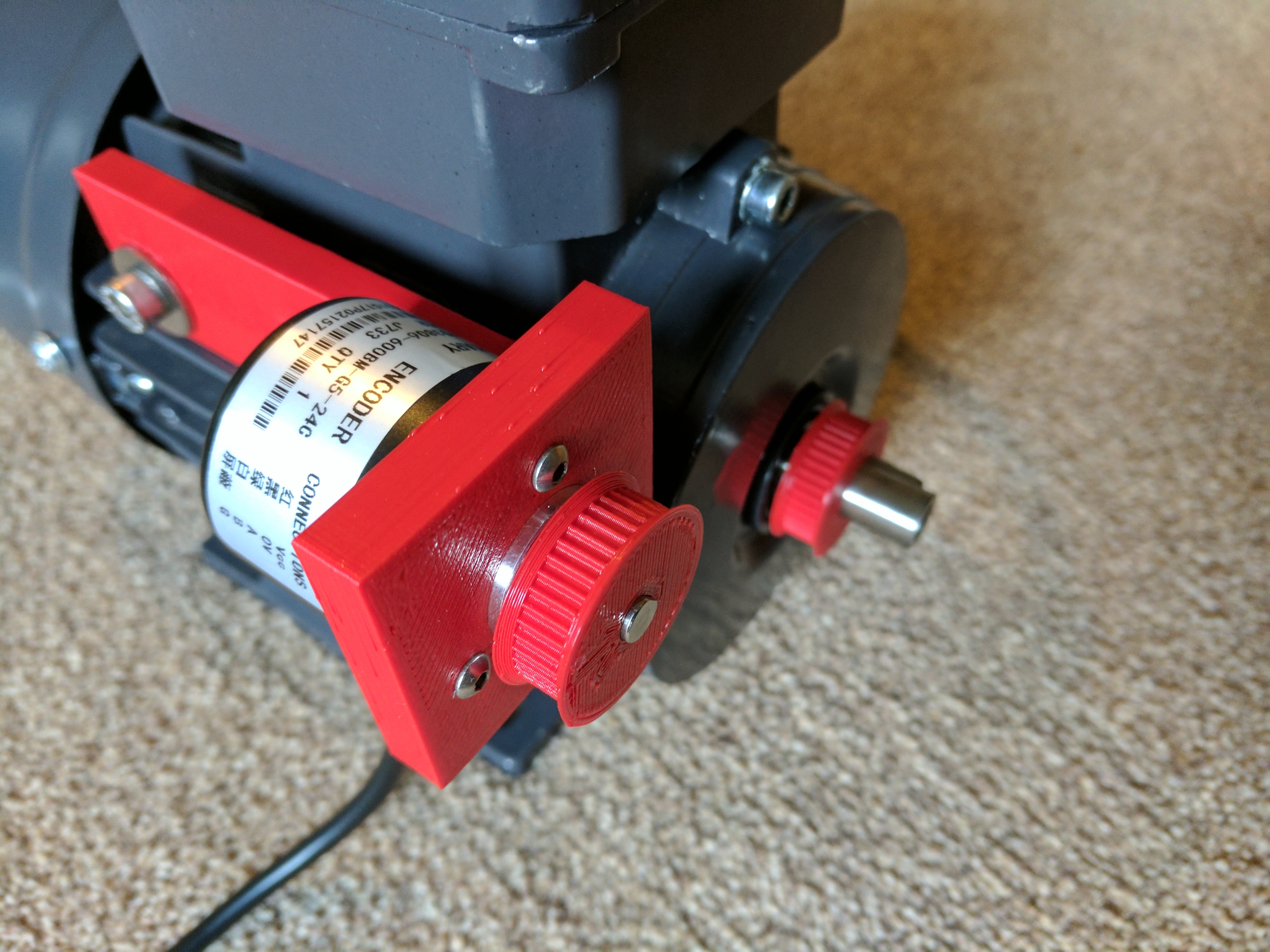

Pete9008 wrote: Thu Dec 08, 2022 5:32 pm Assume it will be a toothed belt to ensure that there is no encoder position drift with time?
Yes, I will 3D print some toothed pulleys and use a toothed rubber belt to drive the encoder and a fixed reduction. I did this successfully once before.

Like the pulley set up, that should work well :)

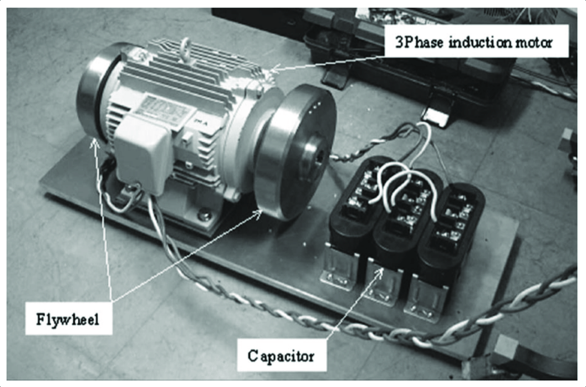

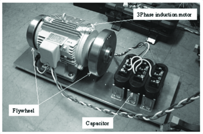

This is the kind of setup I was imagining. The flywheel doesn't need to be huge, just enough to provide a meaningful difference between natural spindown, and regen braking.
Pete9008
Posts: 1801
Has thanked: 102 times
Been thanked: 347 times
Re: Bench setup for stm32-sine development
Post by Pete9008 »
Like the idea of a flywheel at each end, halves the size and stresses of/on each. Can your motor be used like that?

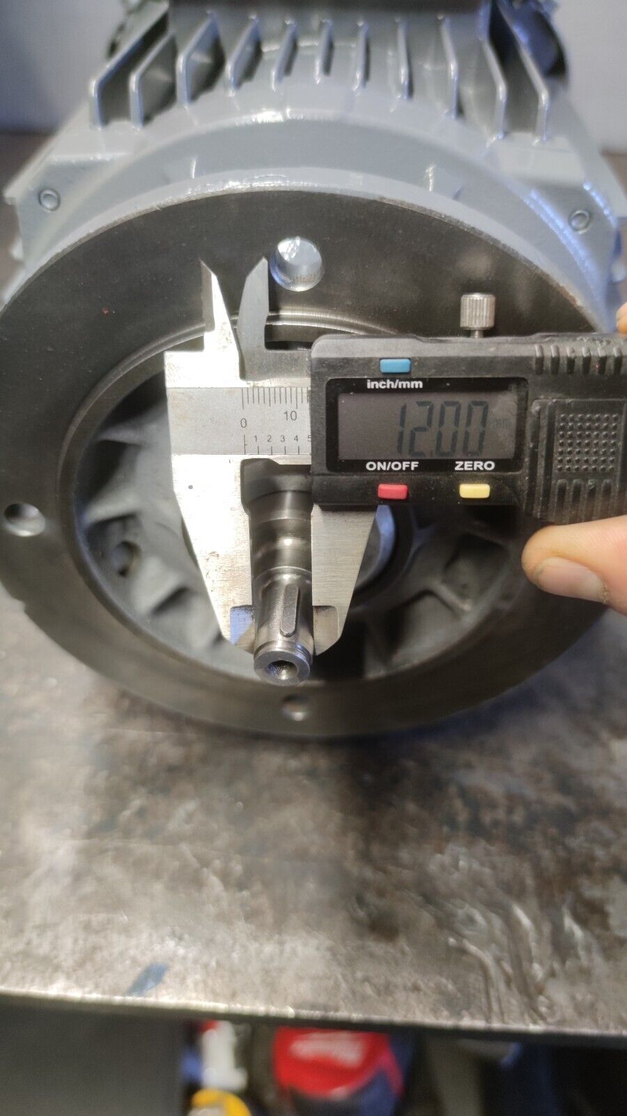

catphish wrote: Fri Dec 09, 2022 9:17 pm If I'm lucky, I can buy a purpose built flywheel with a keyed 12mm hole in the center. I'm not sure if that exists or not tough!
12mm sounds very small for a 1kW motor, are you sure it's not larger?

Pete9008 wrote: Fri Dec 09, 2022 9:42 pm 12mm sounds very small for a 1kW motor, are you sure it's not larger?
Only as sure as this photo the seller took :)

Can't argue with that! The diameter before the turned down section is more what I'm used to seeing.
Not sure I'd be happy putting anything more than a fairly small, well balanced flywheel on that though. I could see the vibration from any out of balance causing fatigue problems after a while.
Edit - wondering if that motor is designed to go into a gearbox which would limit the side loads/stress on the output shaft.

Pete9008 wrote: Fri Dec 09, 2022 9:48 pm Can't argue with that! The diameter before the turned down section is more what I'm used to seeing.
That's a good point. It would definitely need to be well balanced to be secure. The alternatives are quite a bit more complicated though!

Must admit to be a bit uneasy about hanging a flywheel on that shaft. Any chance of removing the fan and mounting it on the other end which is probably larger? The way you will be using I can't see cooling will be an issue.
