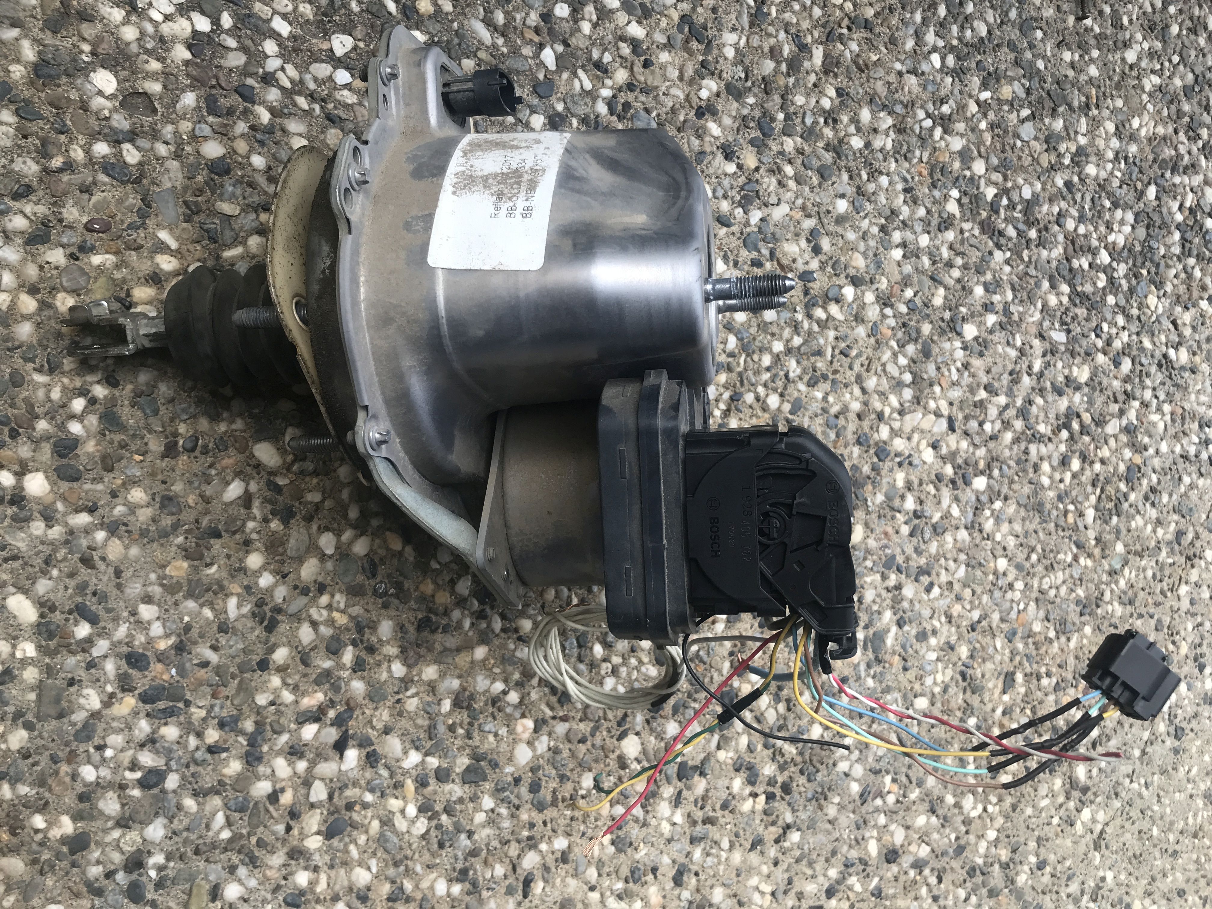

I bought a Honda Accord iBooster Gen 2 - Now what?
Gregski
Posts: 3164
Has thanked: 635 times
Been thanked: 1610 times
Post by Gregski »

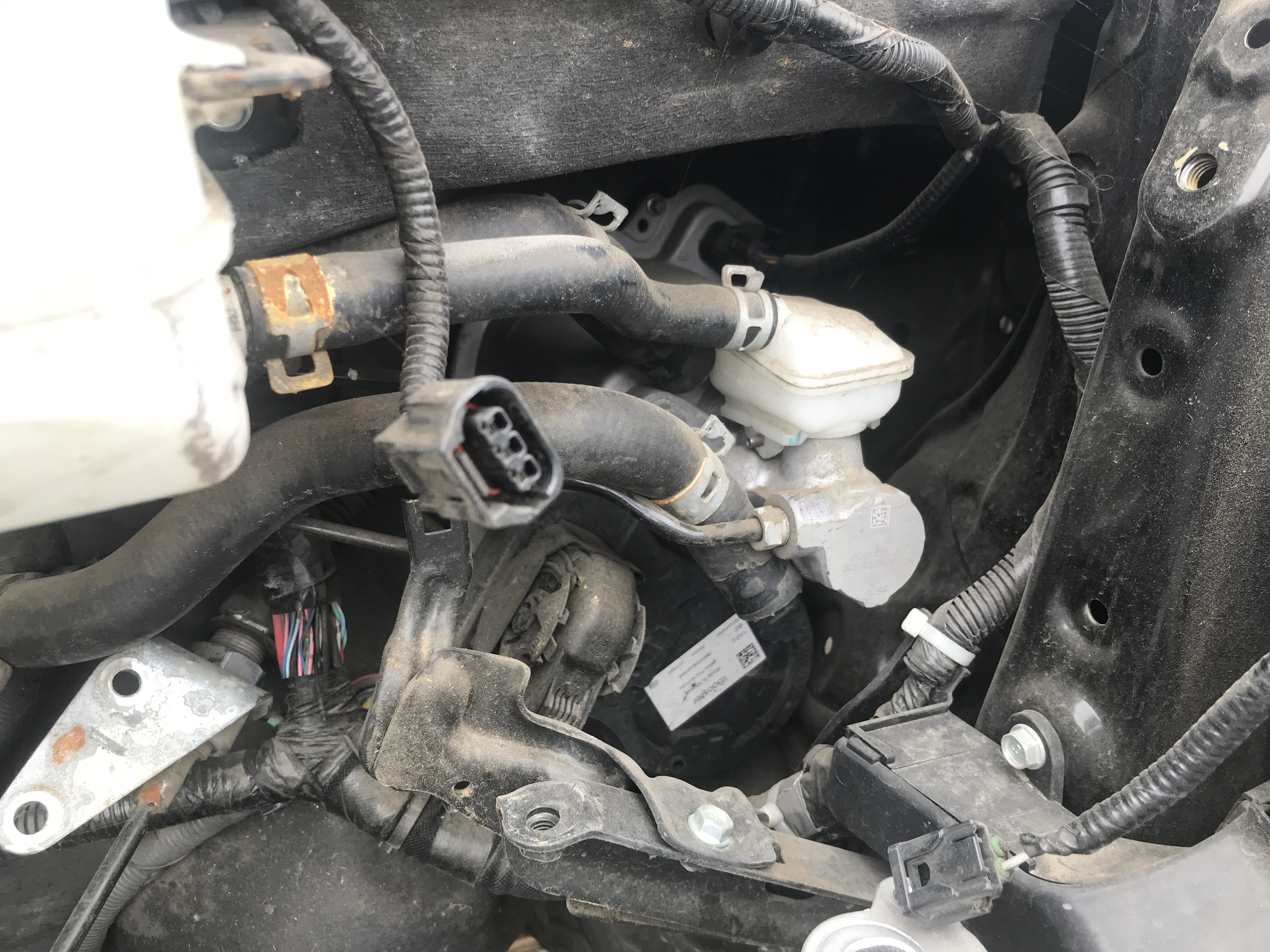

I was having some difficulties with my Honda CR-V iBooster Gen 1 cause I had no idea what I was getting myself into, so I decided to do the right thing, and go out and buy a Gen 2 iBooster out of a wrecked Honda Accord. [wonder what caused the wreck? maybe bad brakes!]
TABLE OF CONTENTS
Shopping List:
  • BOSCH iBooster
  • Master Cylinder
  • Remote Reservoir
  • Brake Pedal Assembly
  • Unfortunately no wire pigtails

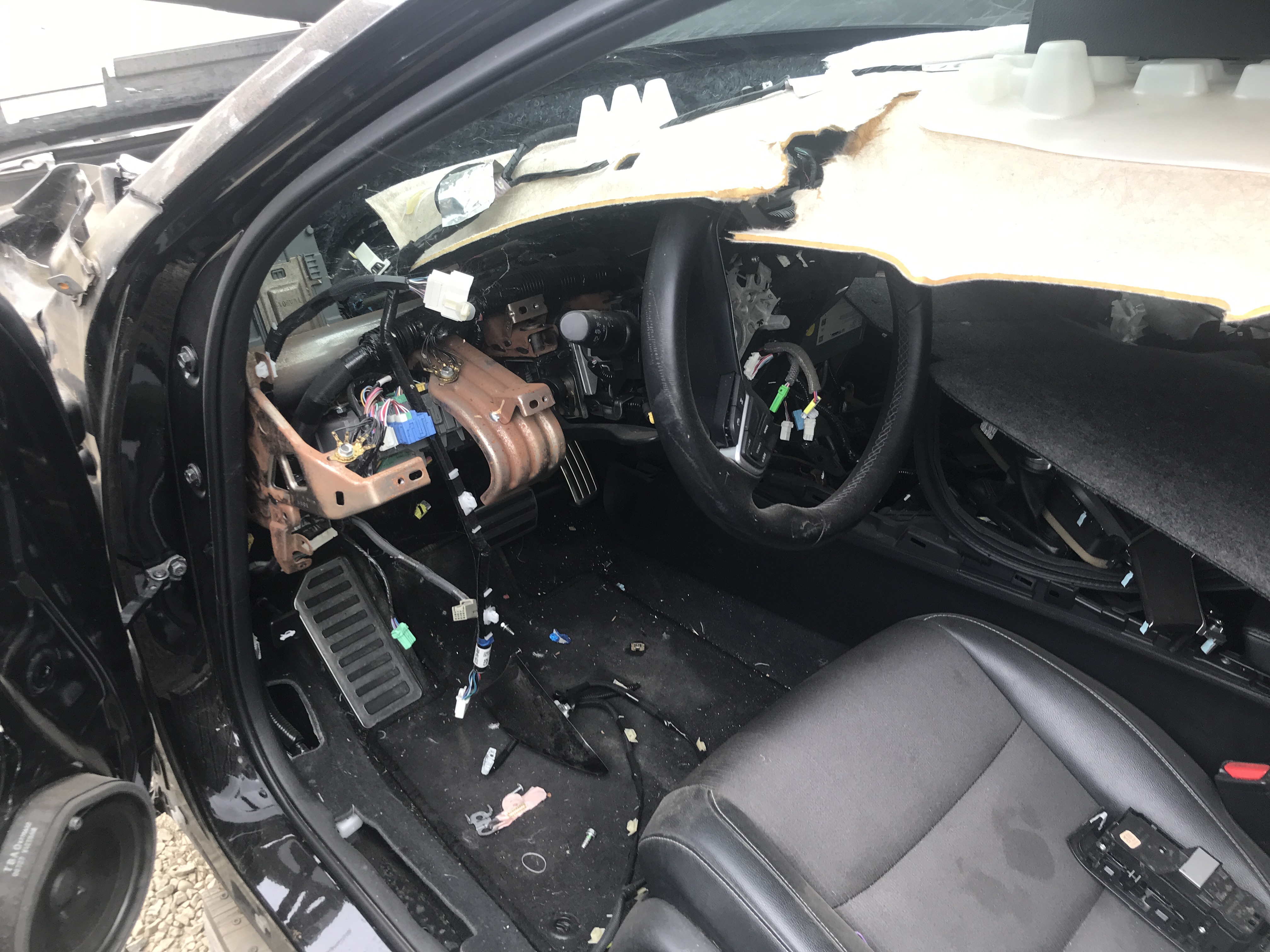

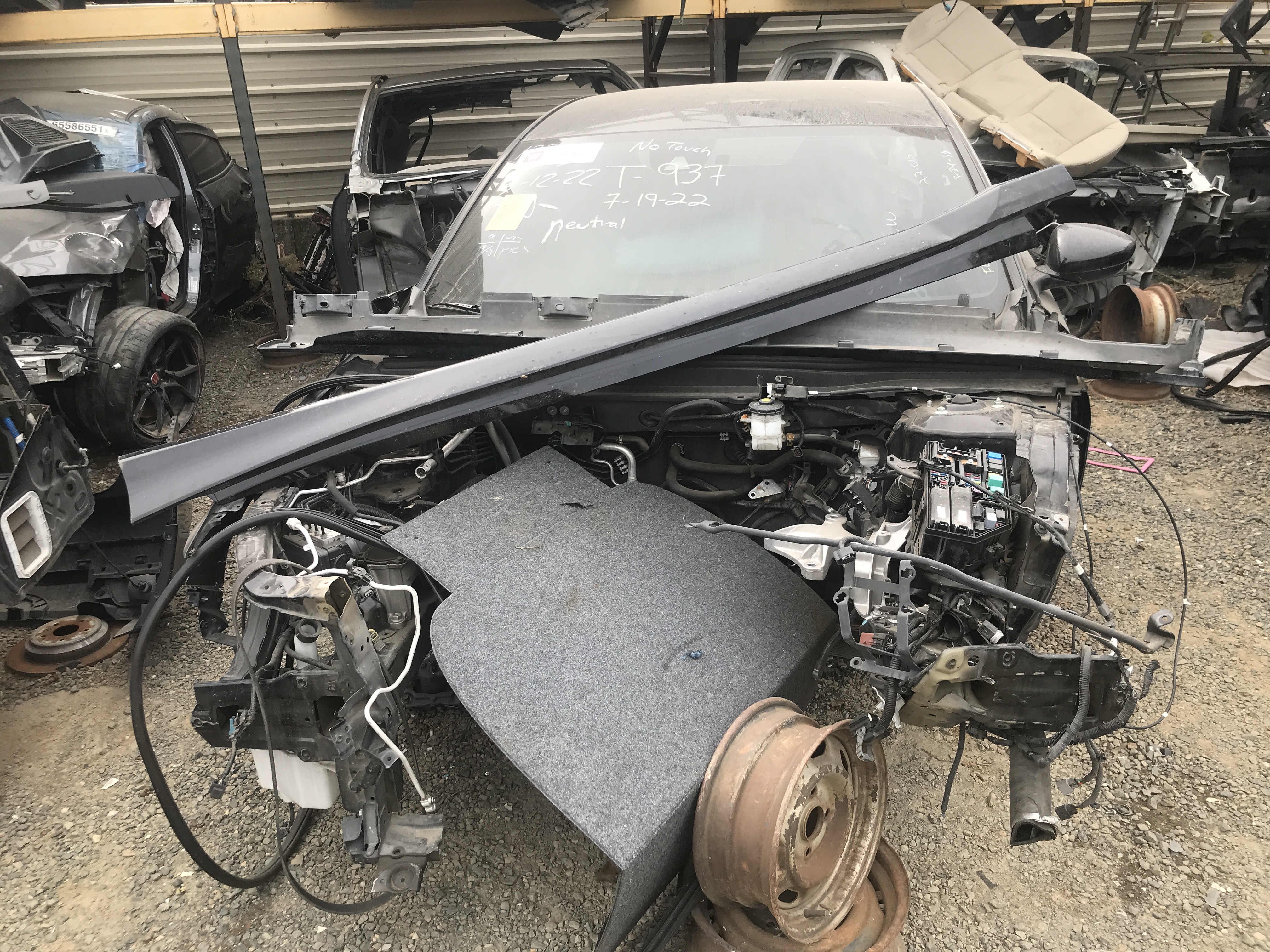

this one I sourced locally from a mom and pop wrecking yard for a wad of cash ($250 maybe)
follow along and together we'll learn more about it and have a few laffs

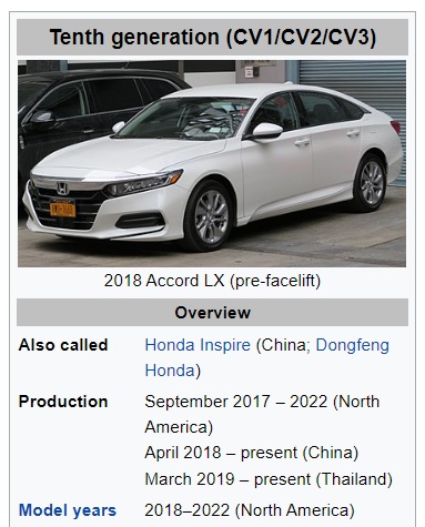

According to Scripture
iBooster GEN2 car donor list
  • Honda Accord
  • Tesla Model 3
  • Tesla Model Y
  • Renault Zoe (2018+)

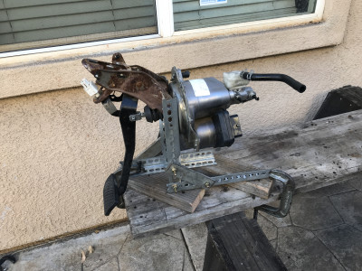

Post by MattsAwesomeStuff »

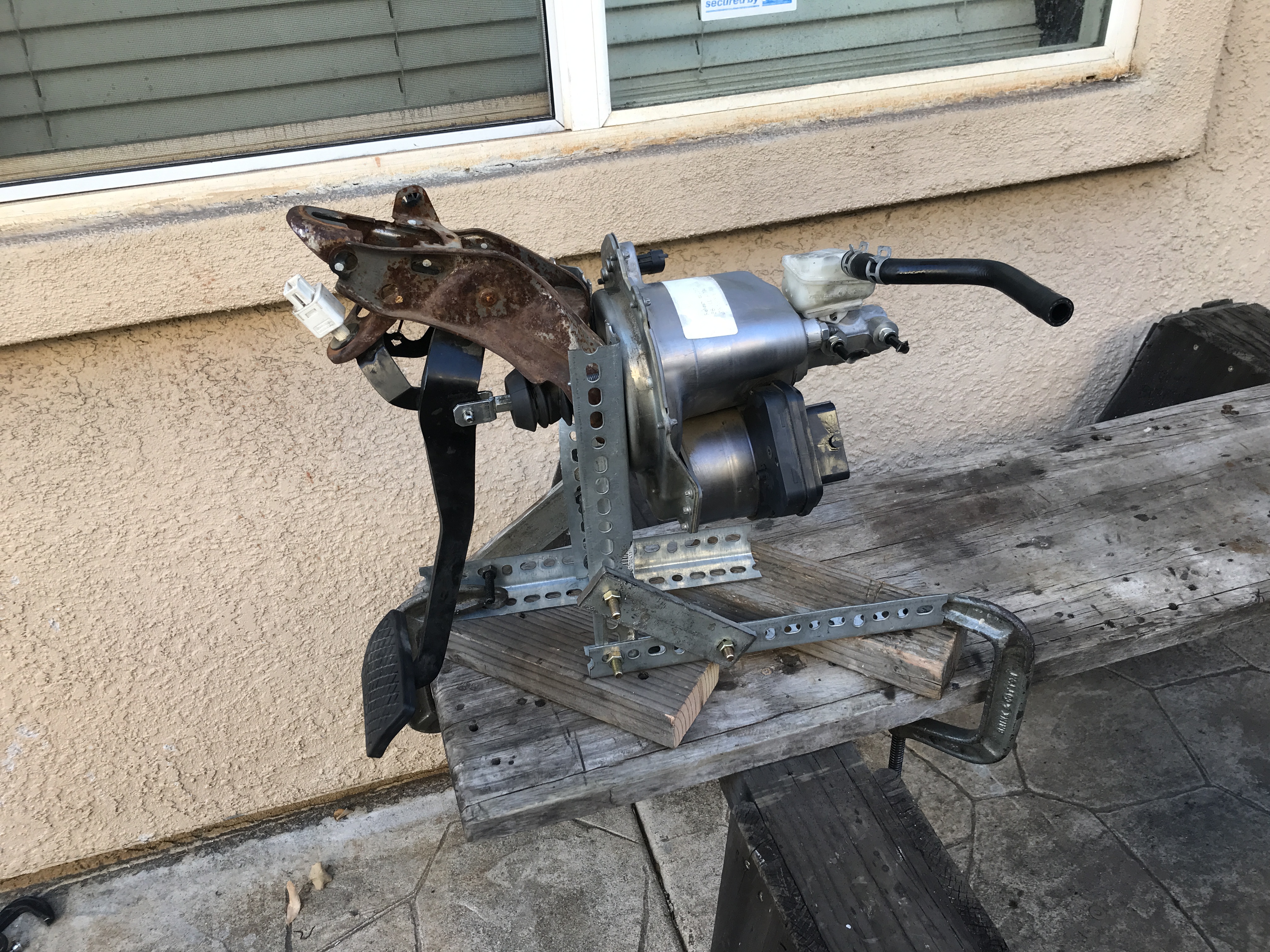

"Luckily this kit comes with these adapters"
holds up two rotten 2x4 offcuts
Ahh, good stuff.
I'm now scared of trying my Gen1 after yours crapped the bed.
Fluttering and pulsating seems to be an electrical problem :/

Post by Gregski »
MattsAwesomeStuff wrote: Thu Nov 24, 2022 8:50 am "Luckily this kit comes with these adapters"
Ahh, good stuff.
lol, yeah, not to hijack this thread but judging by the condition of the Gen 1 MC (master cylinder) my buddy and I assume that donor vehicle may have suffered a flood, so stay tuned for an iBooster autopsy (let's just say a Dremel may be involved)

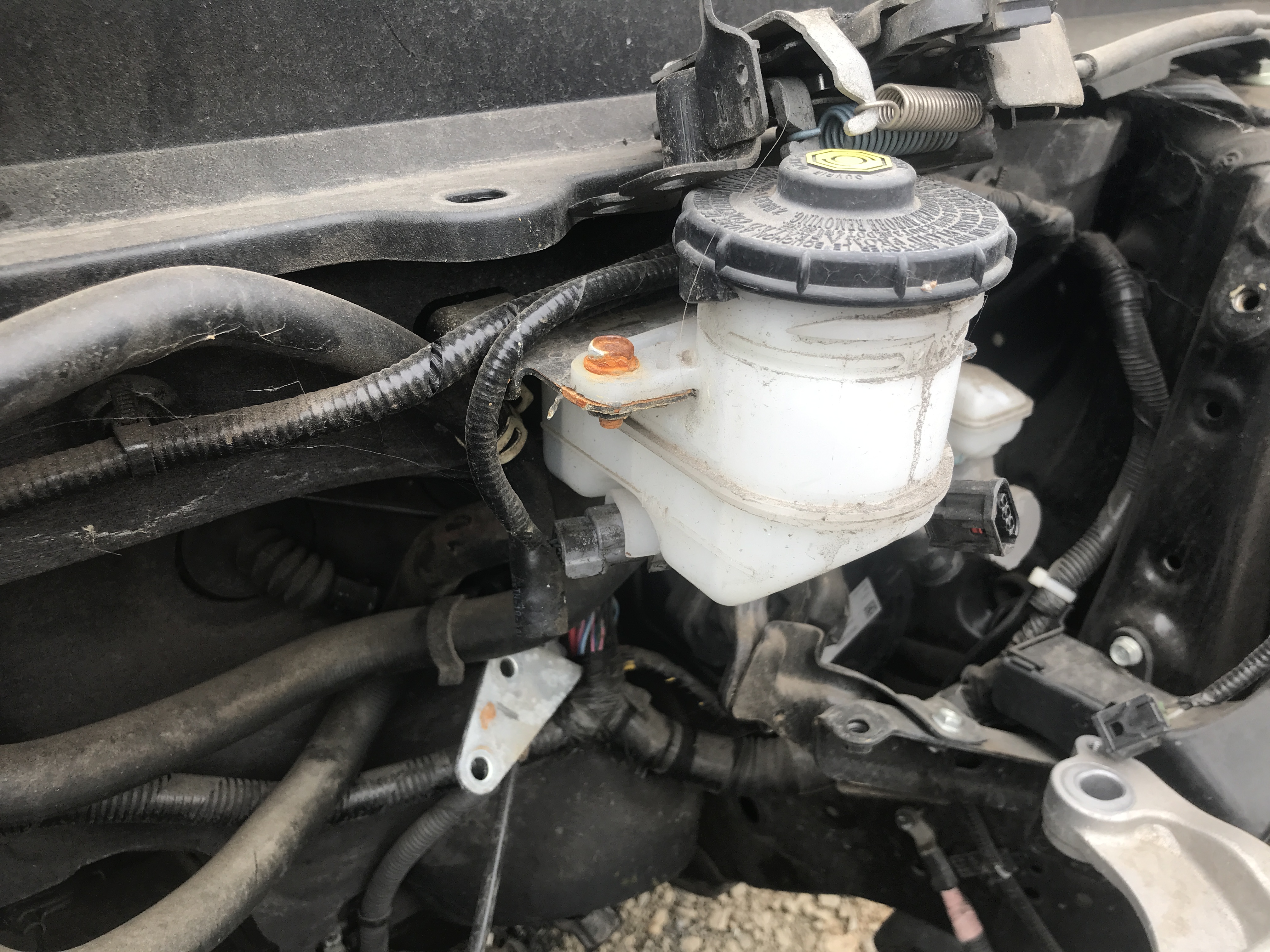

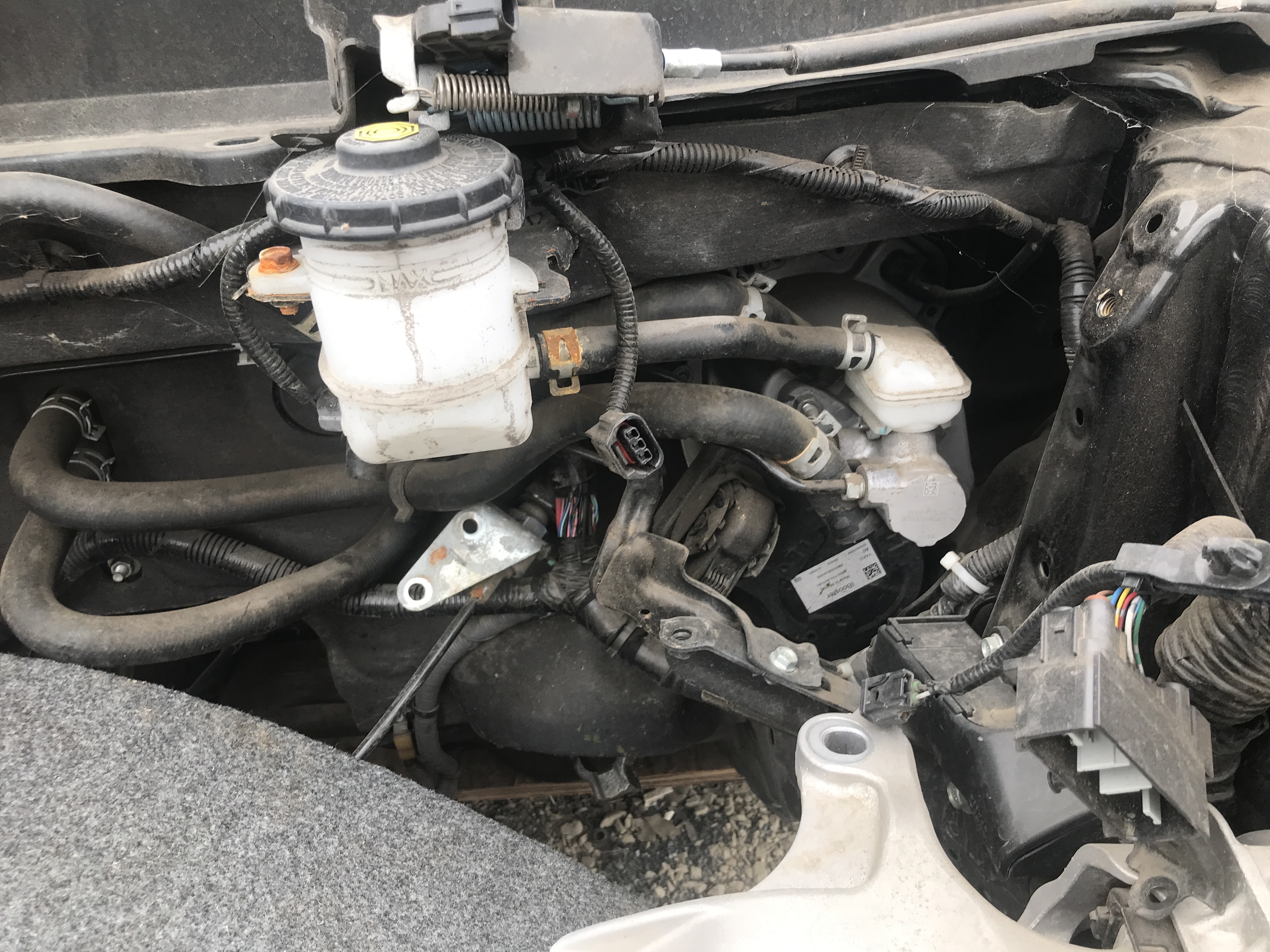

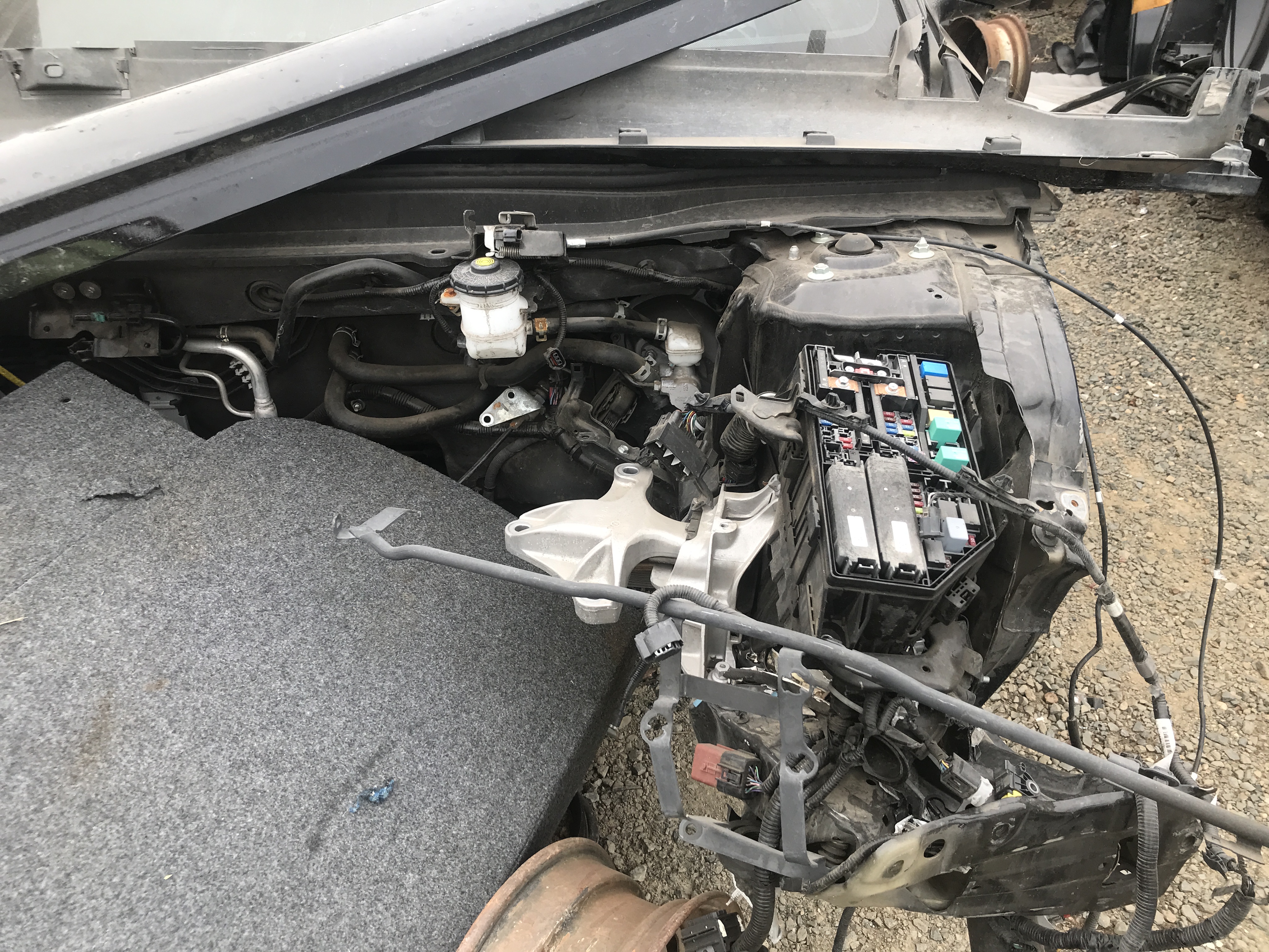

Gen 2 iBooster in the wild

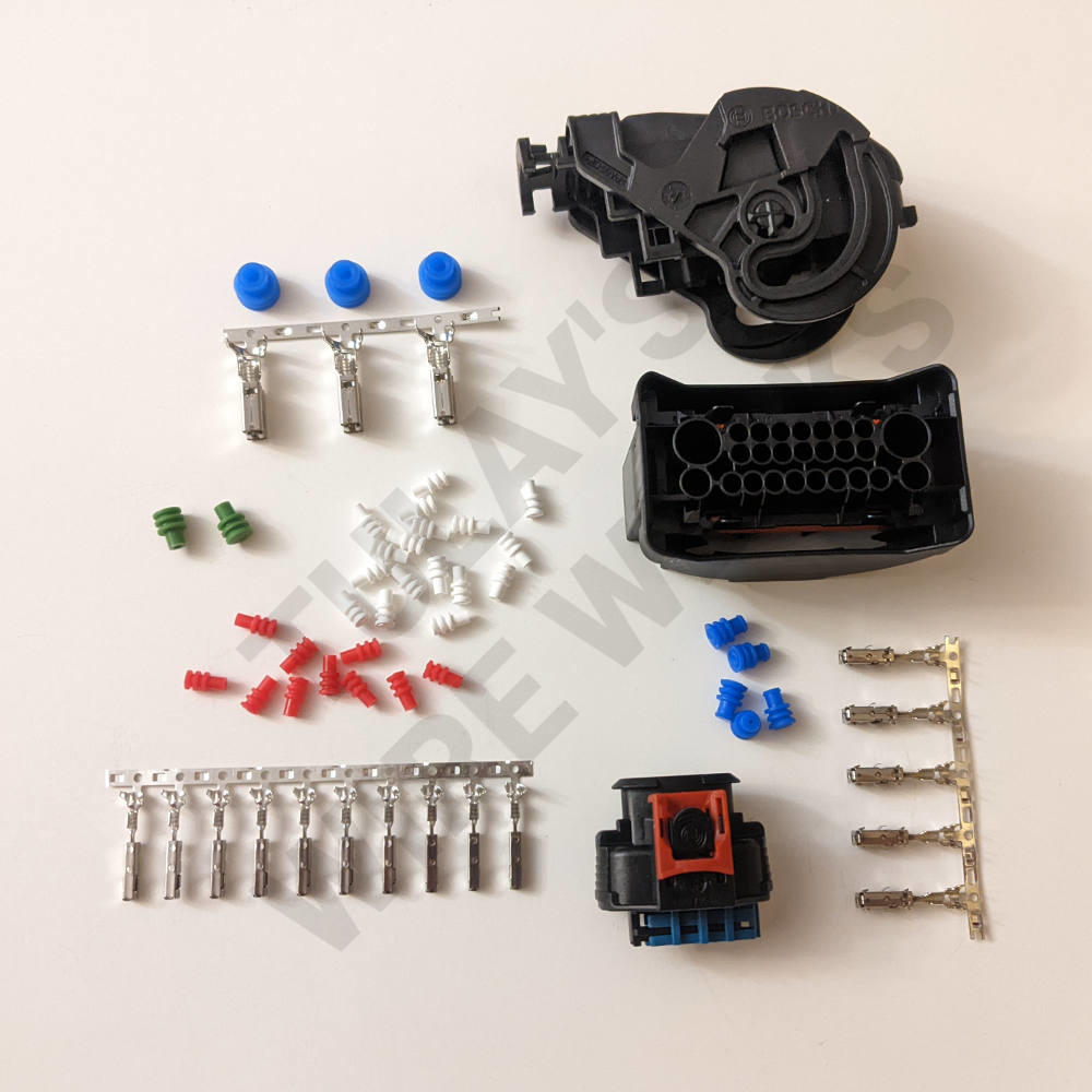

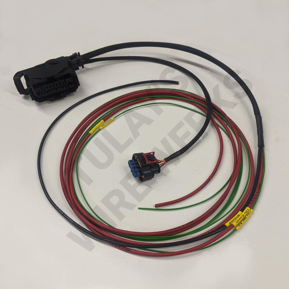

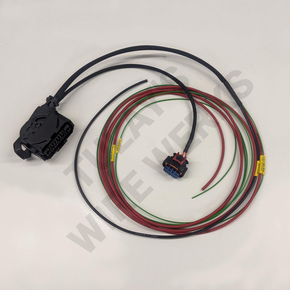

Just fyi: i have this in my Subaru Impreza conversion. The plug you can buy in the link below, works perfectly well, and all the can code for the Accord ibooster you can find in the code on GitHub of openpilot.
https://www.evcreate.nl/shop/brakes-whe ... ector-kit/

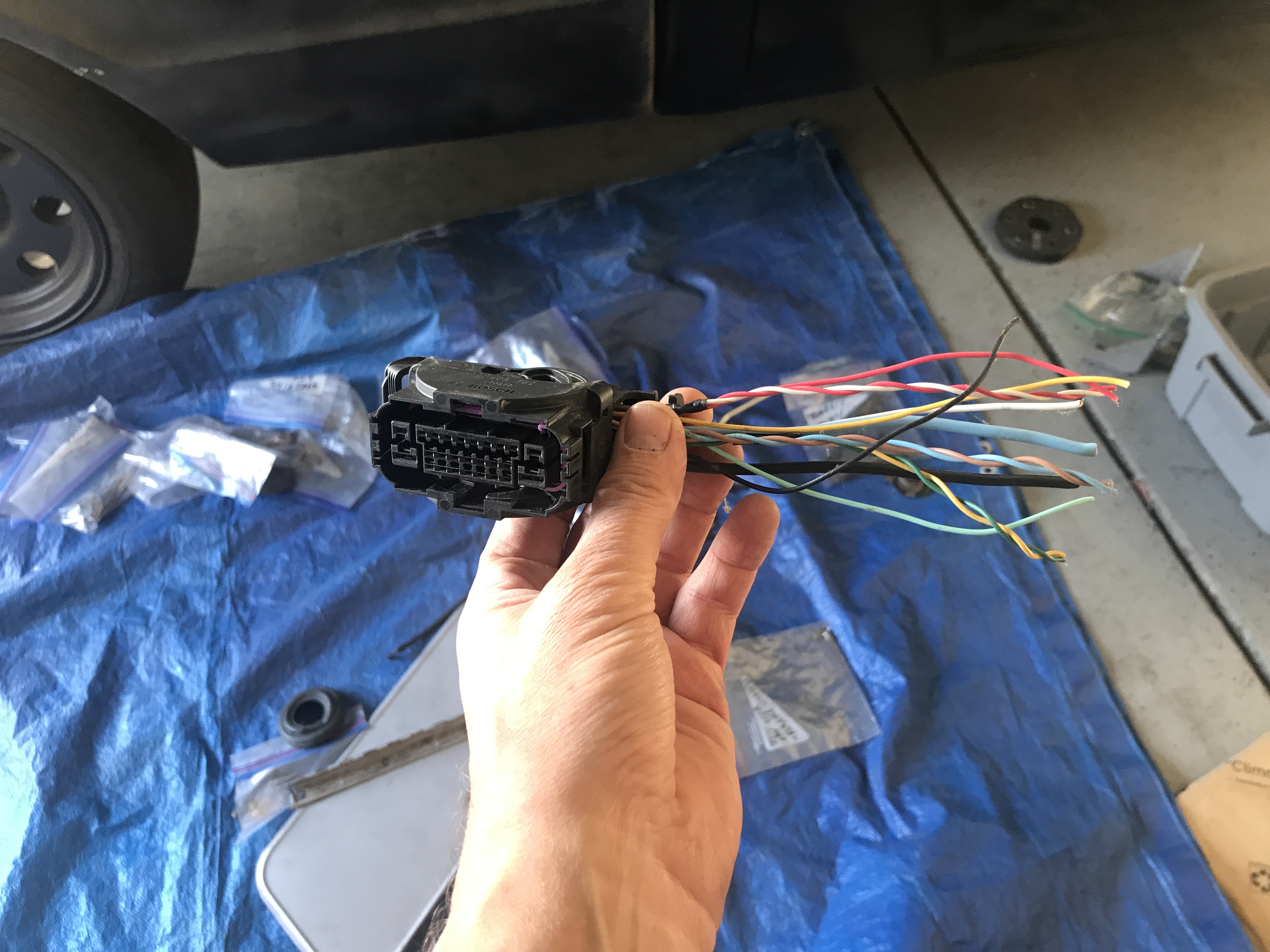

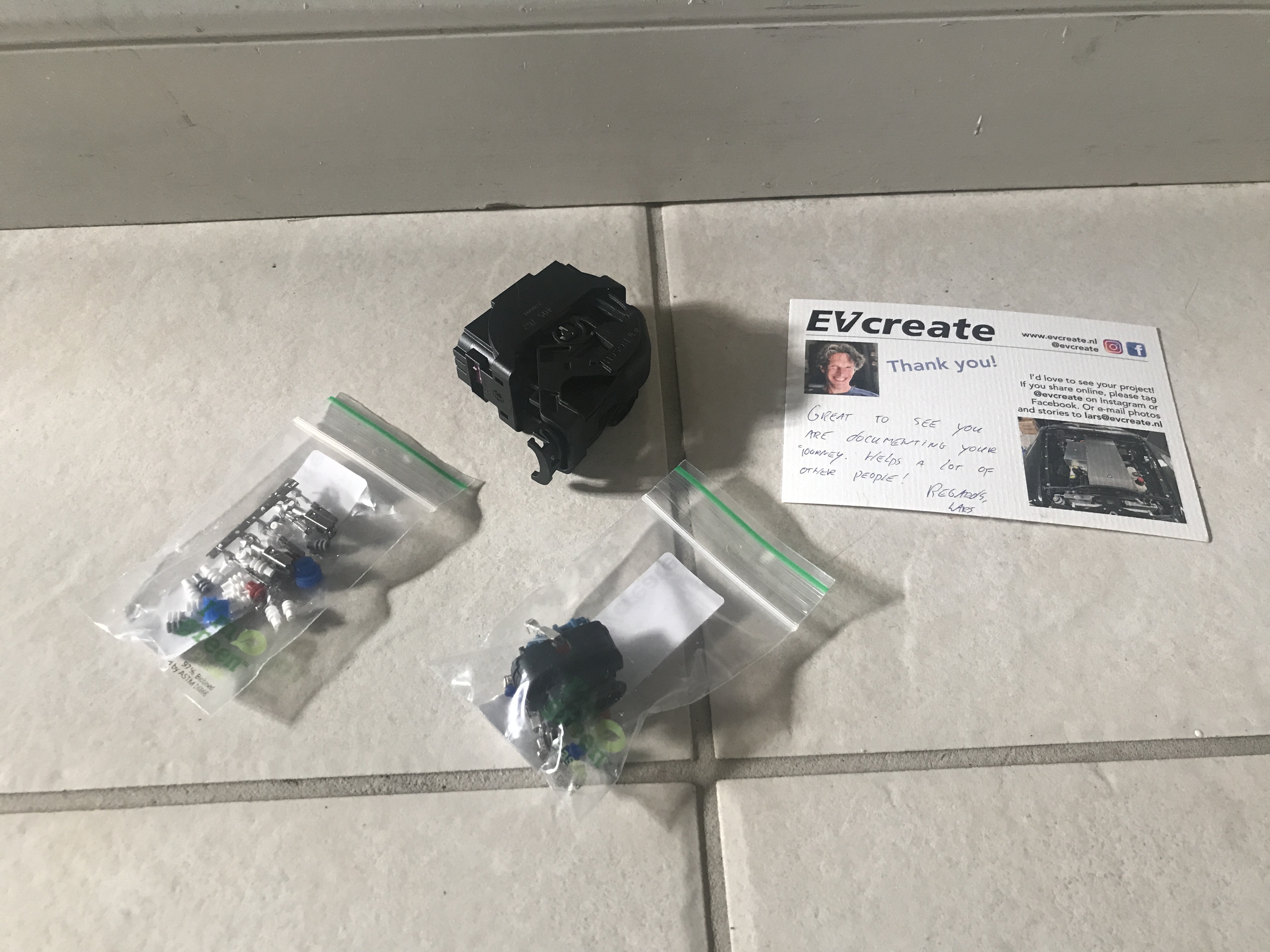

thanks I just bought this kit, Lars did a great job of taking all the guess work out of it, it can really be a pain to identify and track down all the little pins, gaskets, etc.
FYI, junkyard sellers do not wan to cut off pig tails off of the main engine bay wire harness, they say they sell the complete harness to those who have flooded cars

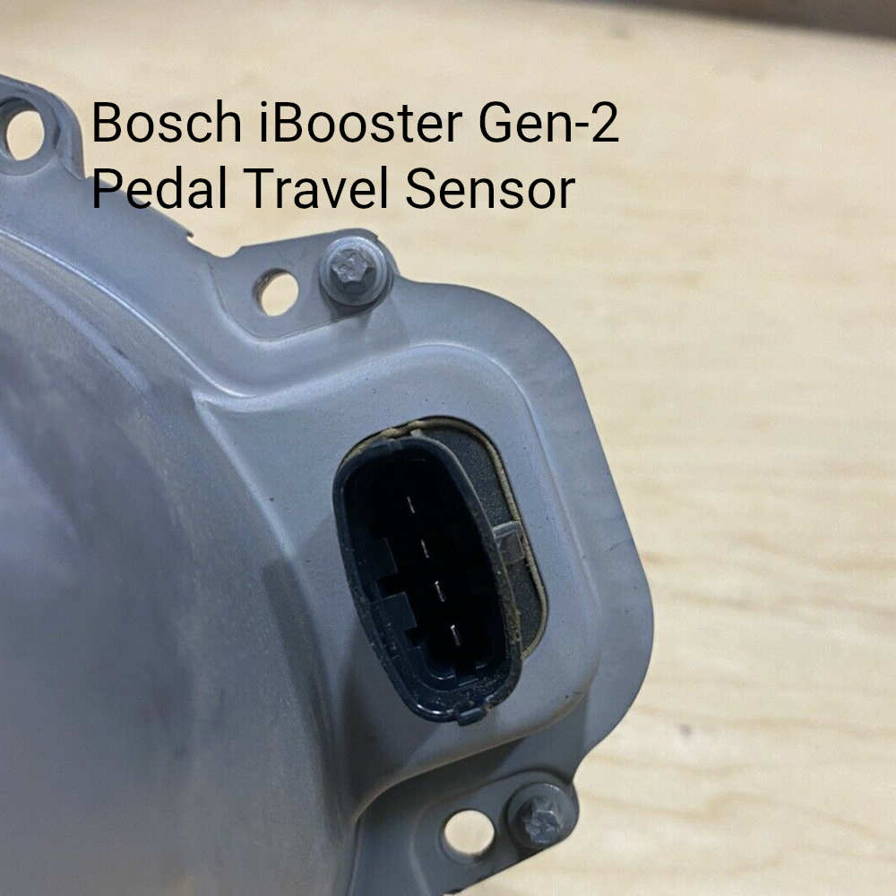

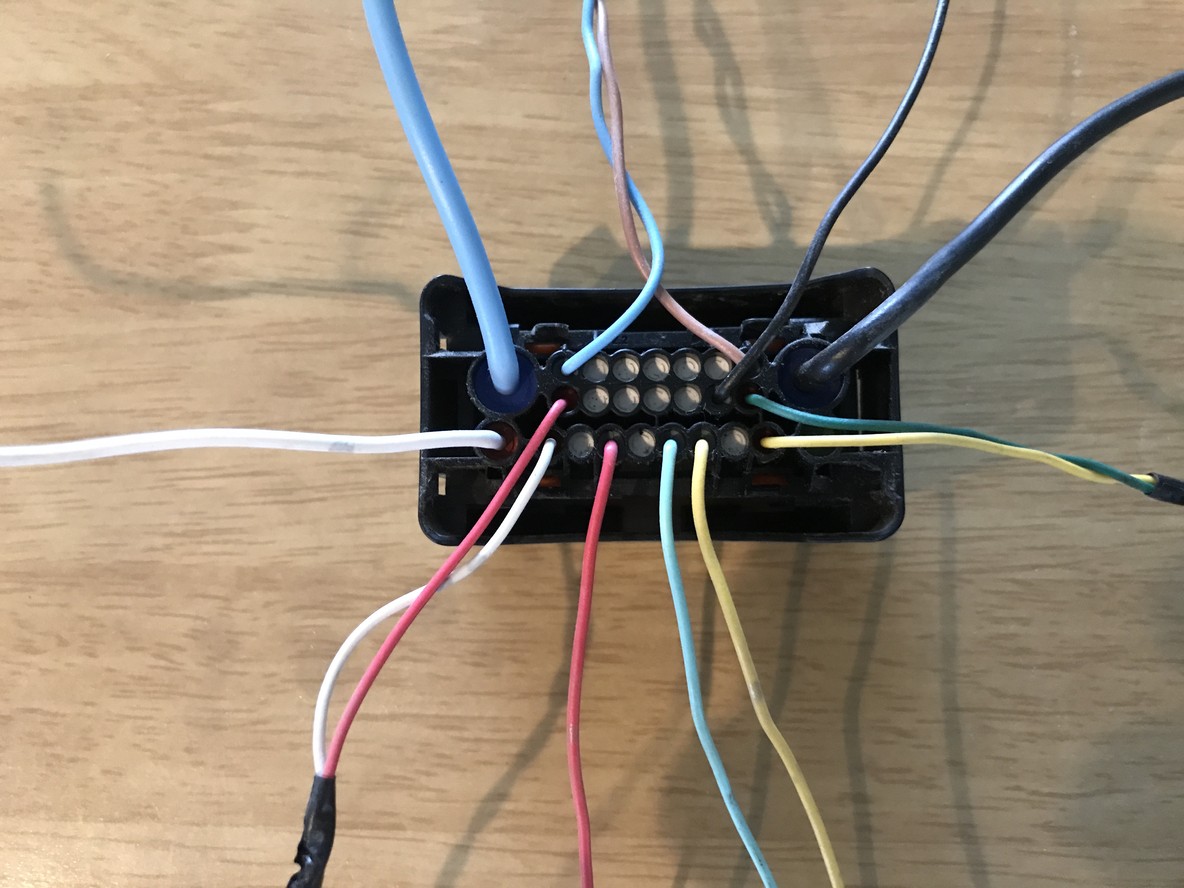

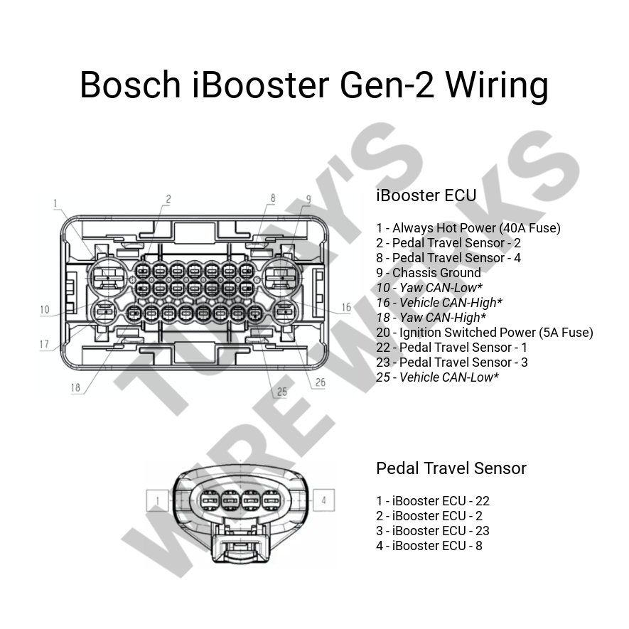

this is what the Honda CRV Gen 1 BOSCH iBooster larger plug looks like, I say this for two reasons:
  • 1. it does fit the Gen 2 Honda Accord BOSCH iBooster
  • 2. however I can not confirm if the wire colors are exactly the same

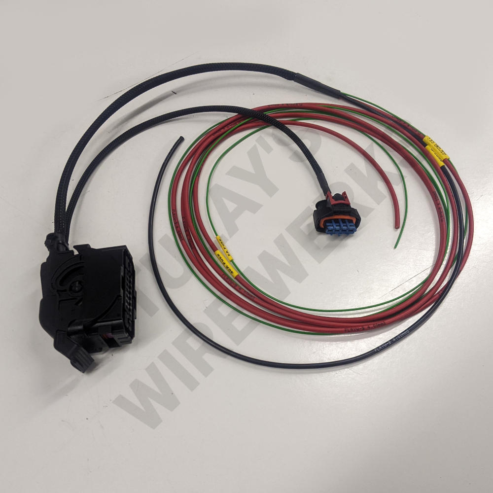

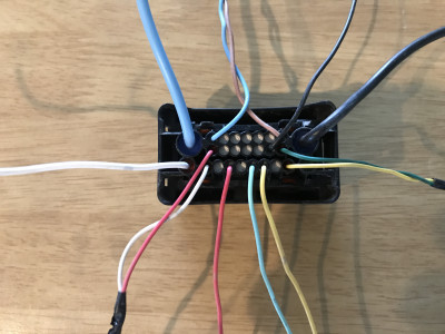

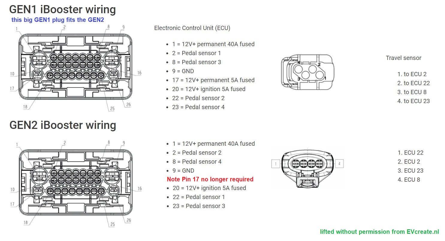

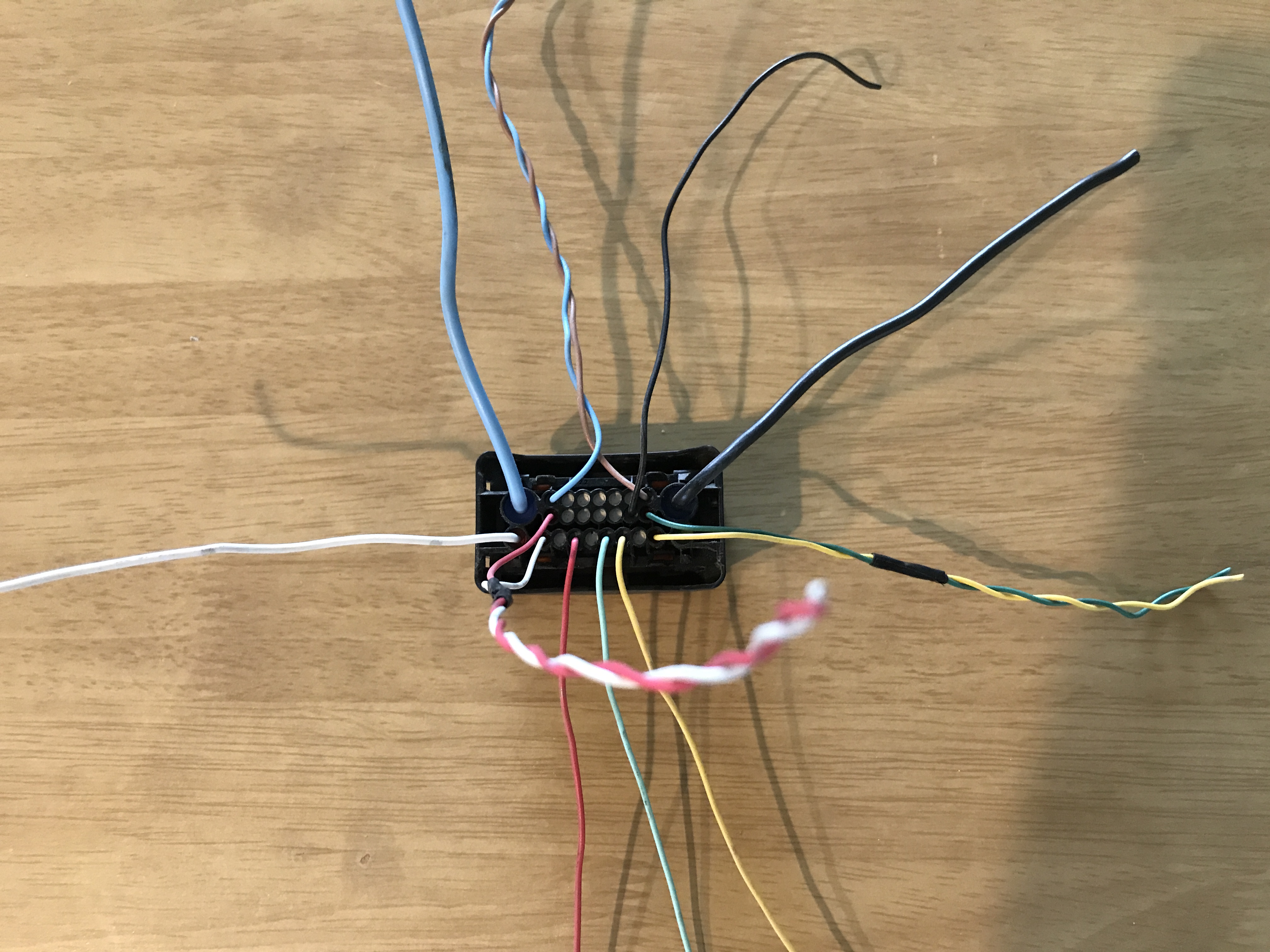

Wiring the Tesla iBooster according to Lars
i put the following graphic together to aid in the stare and compare process of Gen1 to Gen2

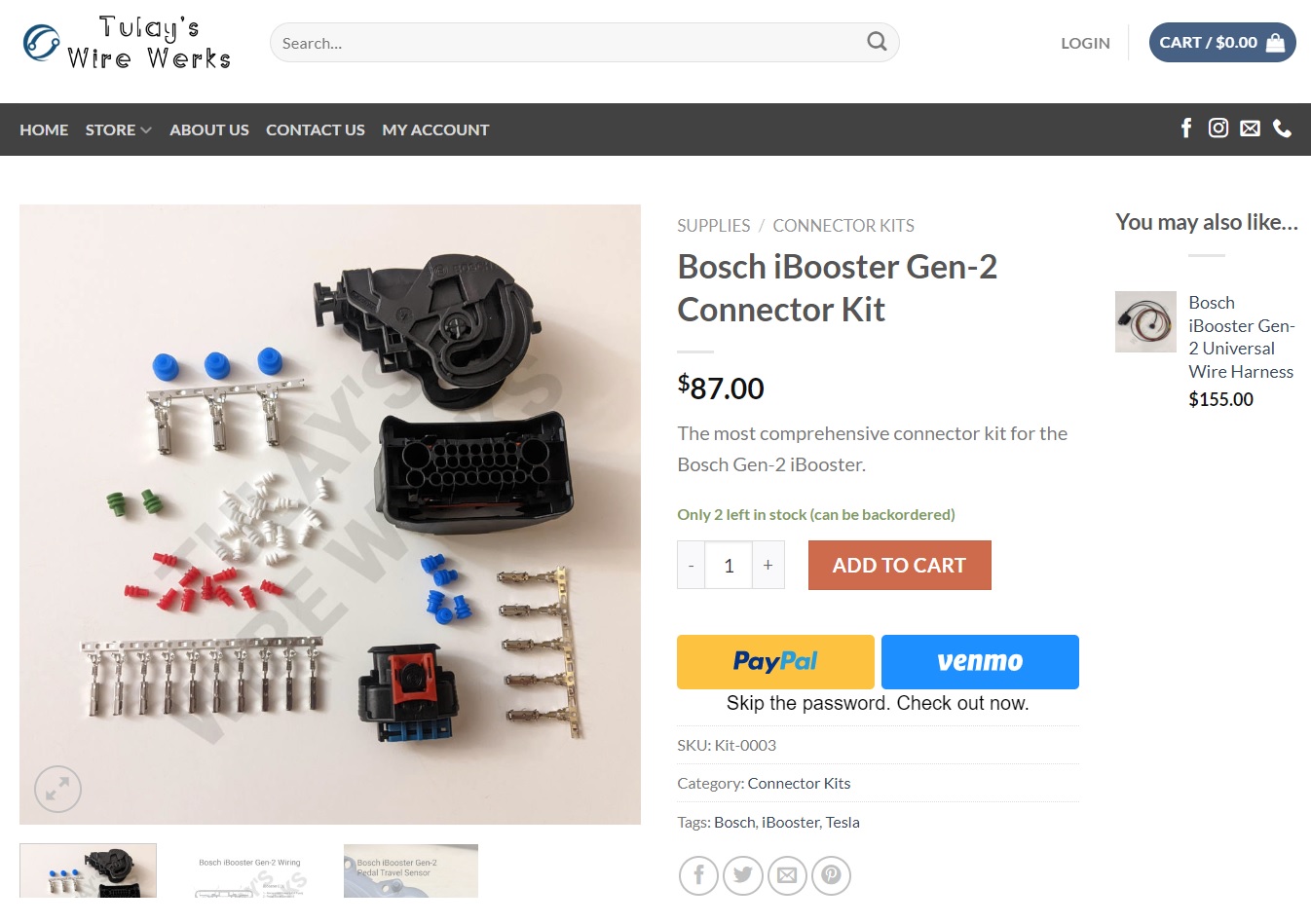

Well, I know I can buy it, but it's $140. I paid $55 for my whole brake booster and master cylinder.
I'm way too cheap to pay $140 for a few wires.
If we knew which ones it was, I presume it's far, far, far cheaper to buy the connectors directly. Hell it might be cheaper from a damned dealership.

MattsAwesomeStuff wrote: Sat Nov 26, 2022 7:26 am Well, I know I can buy it, but it's $140. I paid $55 for my whole brake booster and master cylinder.

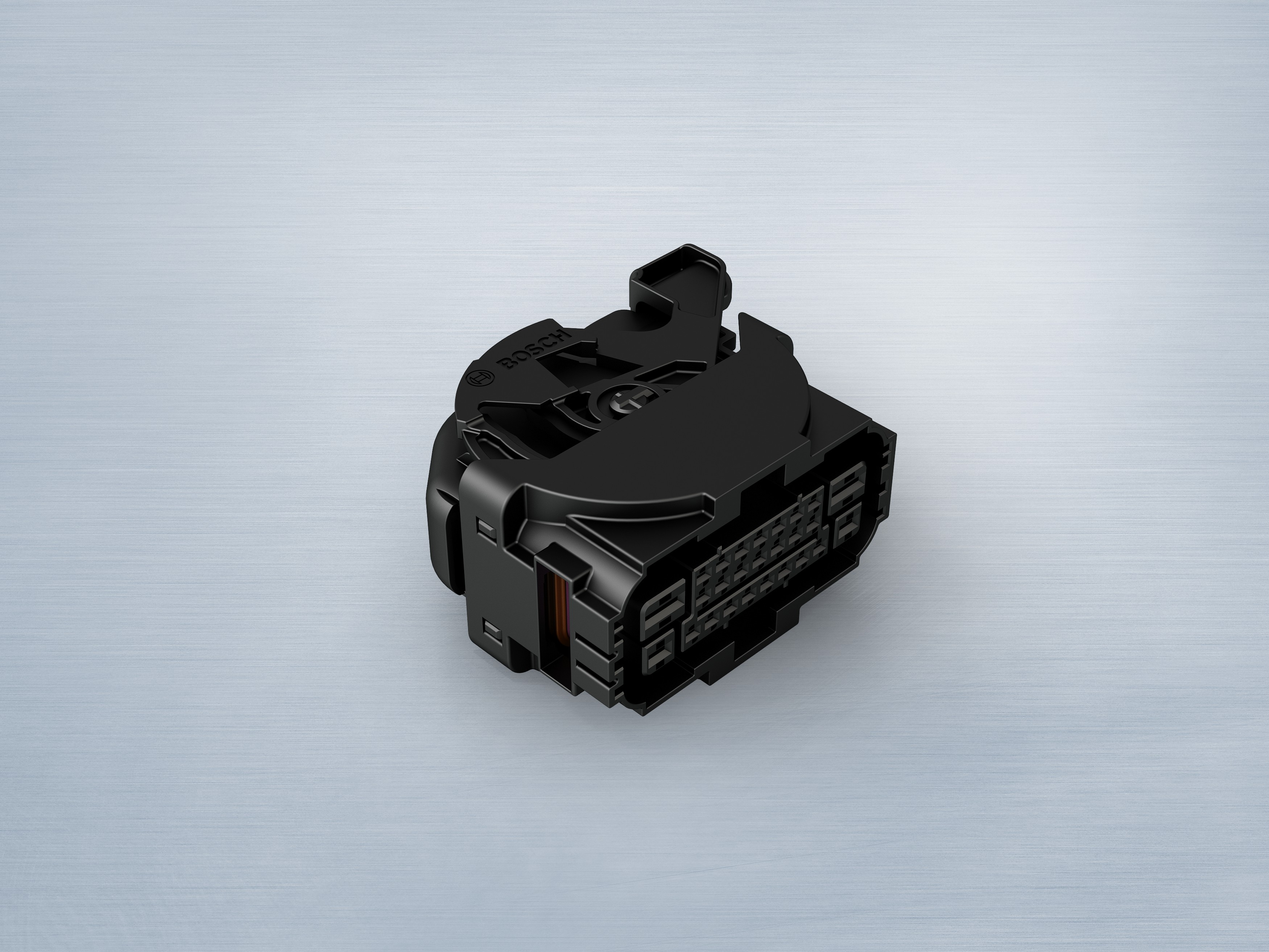

I hear you, 26 way BOSCH Connector housing Part # 1928405762
You're right, but I see it that way that I'm buying me time not having to put research in it. If it would be listed here by someone what exactly we had to buy, i had done that :D
I'm happy that I've got a functional ibooster for my openpilot car now 8-)

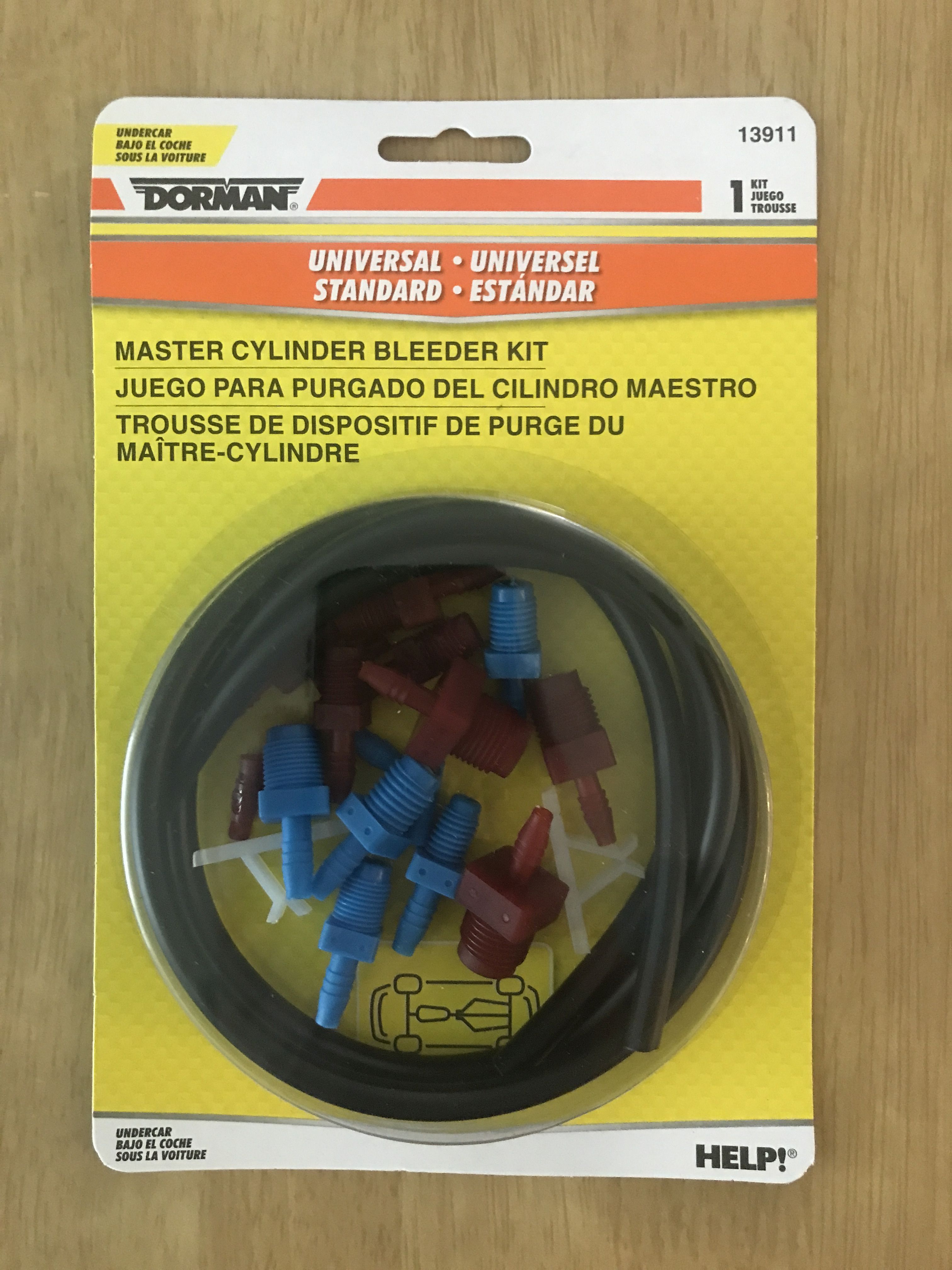

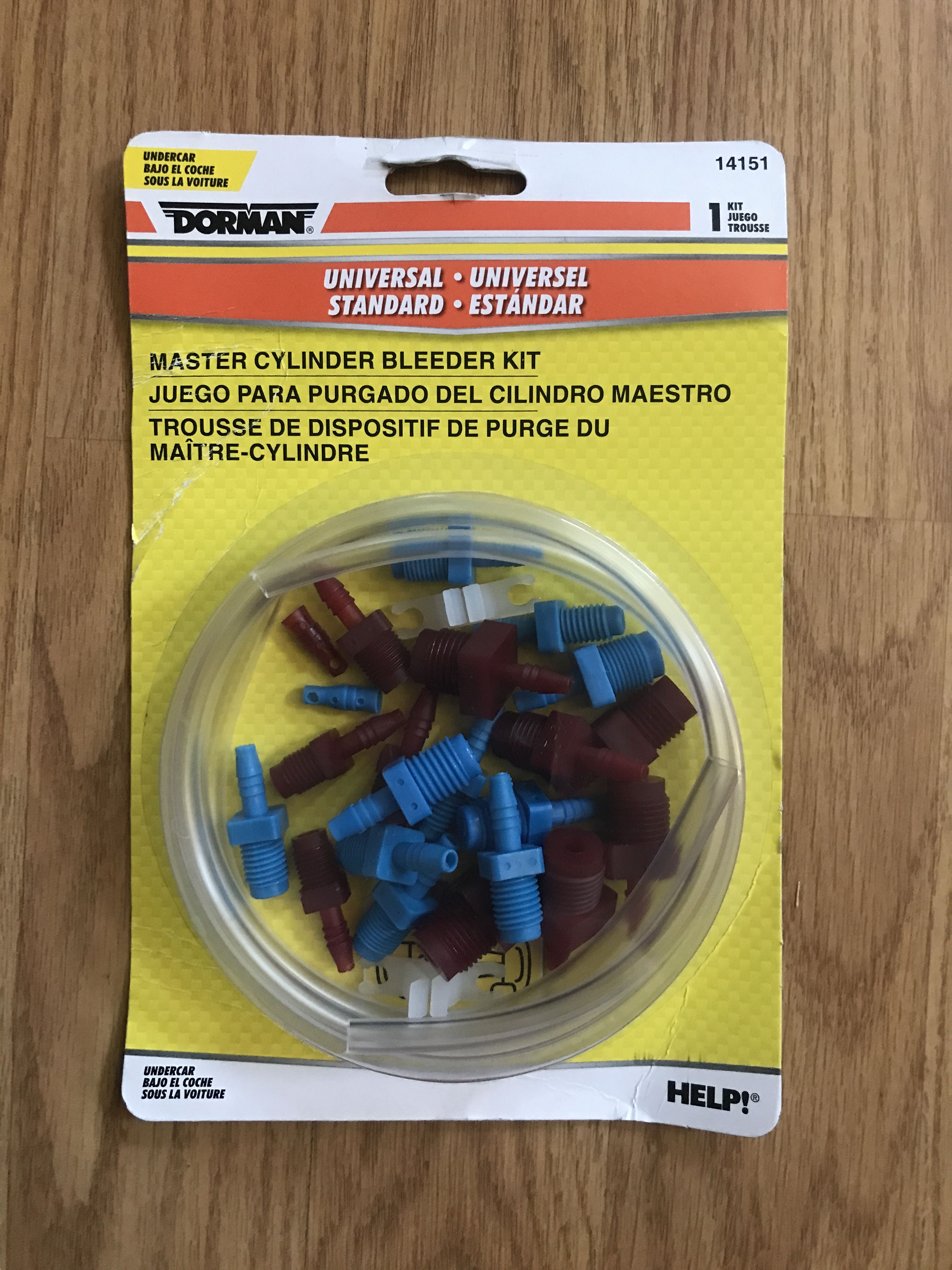

The Honda Accord master cylinder like 99.9999999987654321% of all master cylinders these days has two outlet ports, so in order to bench bleed it, one must use a Master Cylinder Bleeder Kit, perhaps such as this Dorman 13911 ? ... WRONG !!!
It appears that Mrs. Dorman has quite the sense of humor as she only provides the unsuspected AMAZON shopper with only one of each type of fitting! And the black non see through hoses, are an extra bonus to take a simple task and make it impossible! So we thank her.
DO NOT BUY THIS KIT !

as my old boss used to say: "Don't give us problems, give us solutions"
I give you the proper kit with a pair of every fitting Noah's Ark style, and clear hosers mind you:
Note: the red are Standard thread and the Blue are Metric thread doodads

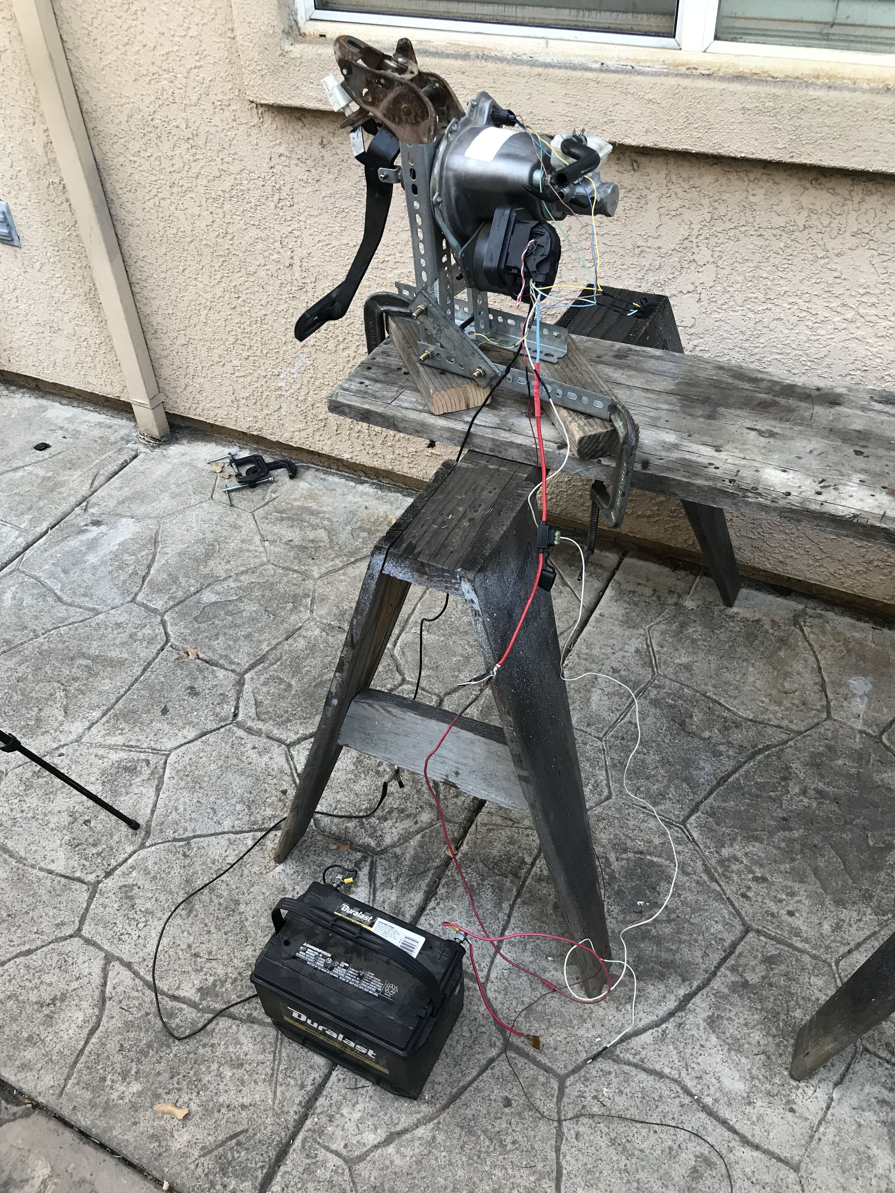

my Lars's's's iBooster GEN2 connector kit €99,00 (inc. VAT €119,79) the dude even wrote me a lovely note, [what is this? Customer Service???] I shall have it put together in a couple months no problem
Posts: 1084
Has thanked: 479 times
Been thanked: 314 times
Re: I bought a Honda Accord iBooster Gen 2 - Now what?
I don't think you accomplished anything bleeding the master cylinder like that. You let air get into it right away again. You probably did okay to keep the seals wet, but not much more.
Trying to think of how you can test it off of the car. With plugs put into the master, you have no ability to tell if the booster is boosting. The way you can tell if it's boosting, is if it's compressing something easier than you could compress it manually. And, at high pressure.
You could attach balloons to the end of tubes on the output, and see if you can inflate the balloons easier with the booster or not, but, it's such small volume of fluid you're moving I don't think you'd notice a difference. Maybe not balloons, maybe just a small air pocket at the end of the hose that you've clamped shut in a vice or vice grips. And even then, probably not.
You could just keep them capped as you did and measure if current's flowing, but that doesn't tell you much other than that it's wasting energy, could still be broken and using power uselessly.

alright I just totally stumbled upon this Tulay's Wire Werks Bosch iBooster Gen-2 Connector Kit by accident whilst trying to Google the first gen BOSCH iBooster pedal sensor
Post by Gregski »
now this is more my speed when it comes to building your own tedious wire harness
Tuley's Wire Werks Bosch iBooster Gen-2 Universal Wire Harness
