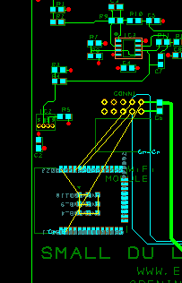

I am willing to have a go as long as it's only a few hours work. I have not use DesignSpark before but it seems fairly straight forward to use.
I have loaded one of the designs and have the footprint for ESP-WROOM loaded. Picture bellow as proof!
I am a electronics engineer although not working at the moment. I have a lot of schematic experience but most PCB layout was supervising someone else.
I have just completed a simple STM32 board and sent for manufacture so now I have a bit of free time until the boards arrive

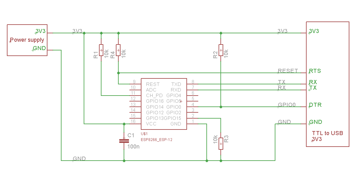

I have routed GPIO0 to a pin header next to a GND pin, so for programming I just put a jumper on there and a serial cable with 5V output. So it's GPIO0, GND, GND, 5V, RX, TX . RX/TX as seen from the STM32 processor!
Yes, even the ESP8266 has that issue.

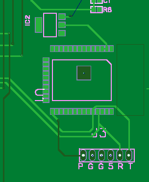

Both are done. The LDU was a bit tight but I managed to squeeze it in. Not sure how well these work mounted like this, but I cleared the planes under the antenna which should help. Also added 10k resistor arrays on PWM and clock output driver. Not sure if they are needed on the clk. What file name/version should I used for the update files? I can produce gerber and other output files, and pdf/png for schematic and layout if needed for checking. DesignSpark is fairly horrible so you made a good decision not to use it.
- Been thanked: 1918 times
Re: Put ESP32 on Tesla LDU and SDU board
Wow, are you serious
that was quick!
Just name them V6 and V8, respectively.
No pull down needed on the clock line. Just attach the files (design, gerber, pdf) here if that's fine for you.

Ok, i'll fix the clock lines. The other thing I was not sure about was the enable pin on the esp32. I think you have just connected it to 3.3V on your deisgn but have read it should have a c-r so that it is enabled after the power supply has stabilised.
So far it works well with enable tied to 3v3. In doubt follow the appnote though

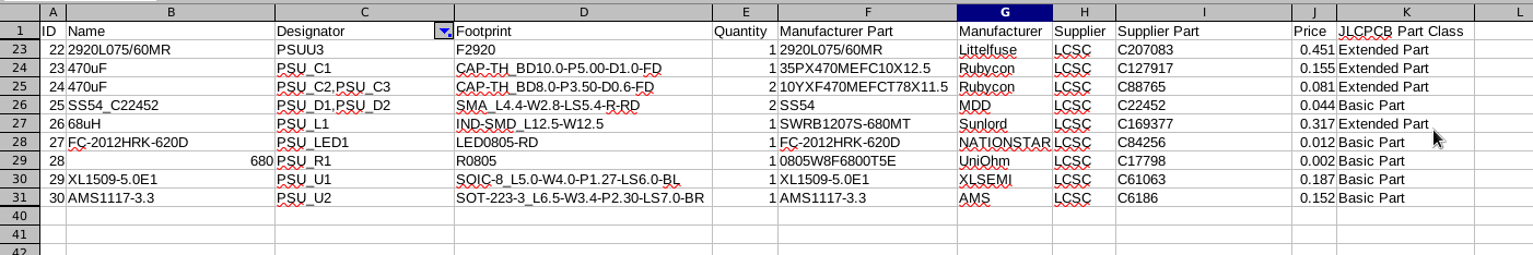

Johannes can you confirm the part number for ESP module ( ESP32-WROOM-32E-N4, C701341 has the highest stock level ). I am updating the BOMs, which is a manual process, and while checking the data sheet for the ESP32 I noticed that the footprint I am using is not quite correct.
I use this one: C82899. Only two requirements were PCB antenna and solderable in economy process (not standard process)

Ok I will put that in the BOM but as it is not recommended for new designs they may run out of stock.

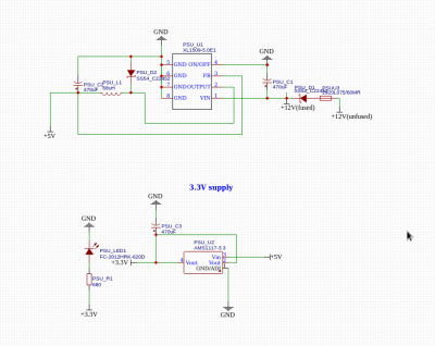

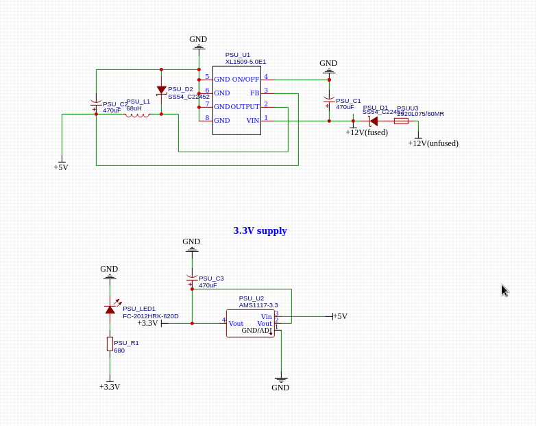

i would make sure that you have a large cap on the 3.3v rail (as well as ones very close to the chip) as the power spike when the wi-fi is enabled, caused me a great del of pain on some of my projects as its caused reboot loops! in had to bodge on some big caps rather than the smd ones.
i typically just go over kill now and put 470uF (through hole or smd) caps on the 12v,5v&3.3v lines, the esp32 dev board reference design is good for inspiration as well. personally i would just put a esp32 dev board footprint on there as you can buy them for sometimes less than you can source the parts for from jlc, also the genuine expressive ones aren't that expensive in the grand scheme4 of things.
for ref my typical psu arrangement i have been using with the esp32 (dev boards)

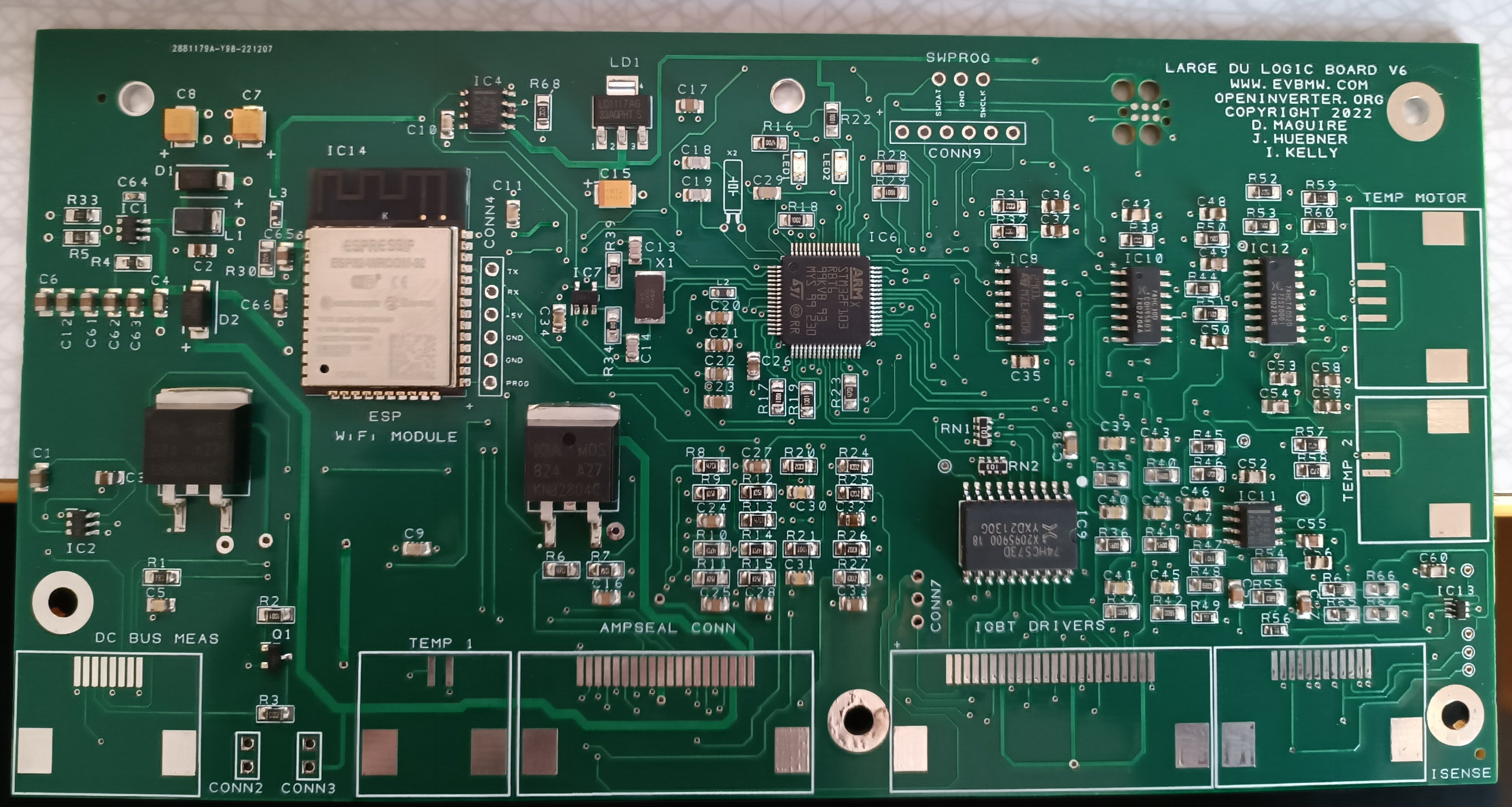

An enormous truck pulled up here this morning and delivered
Update: programmed fine and works
