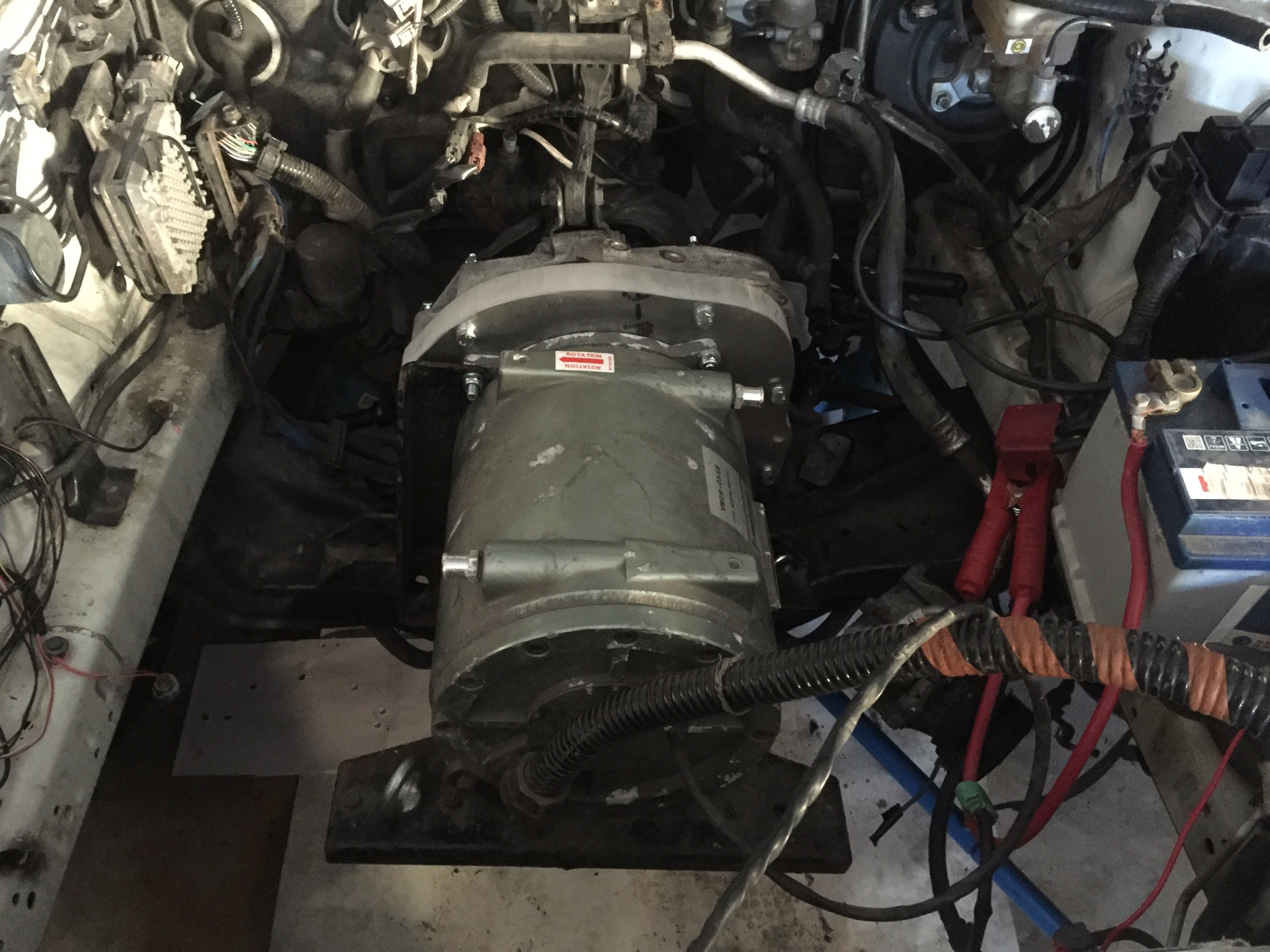

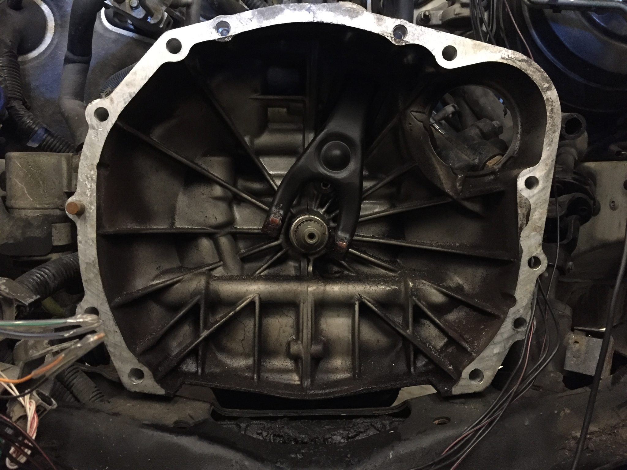

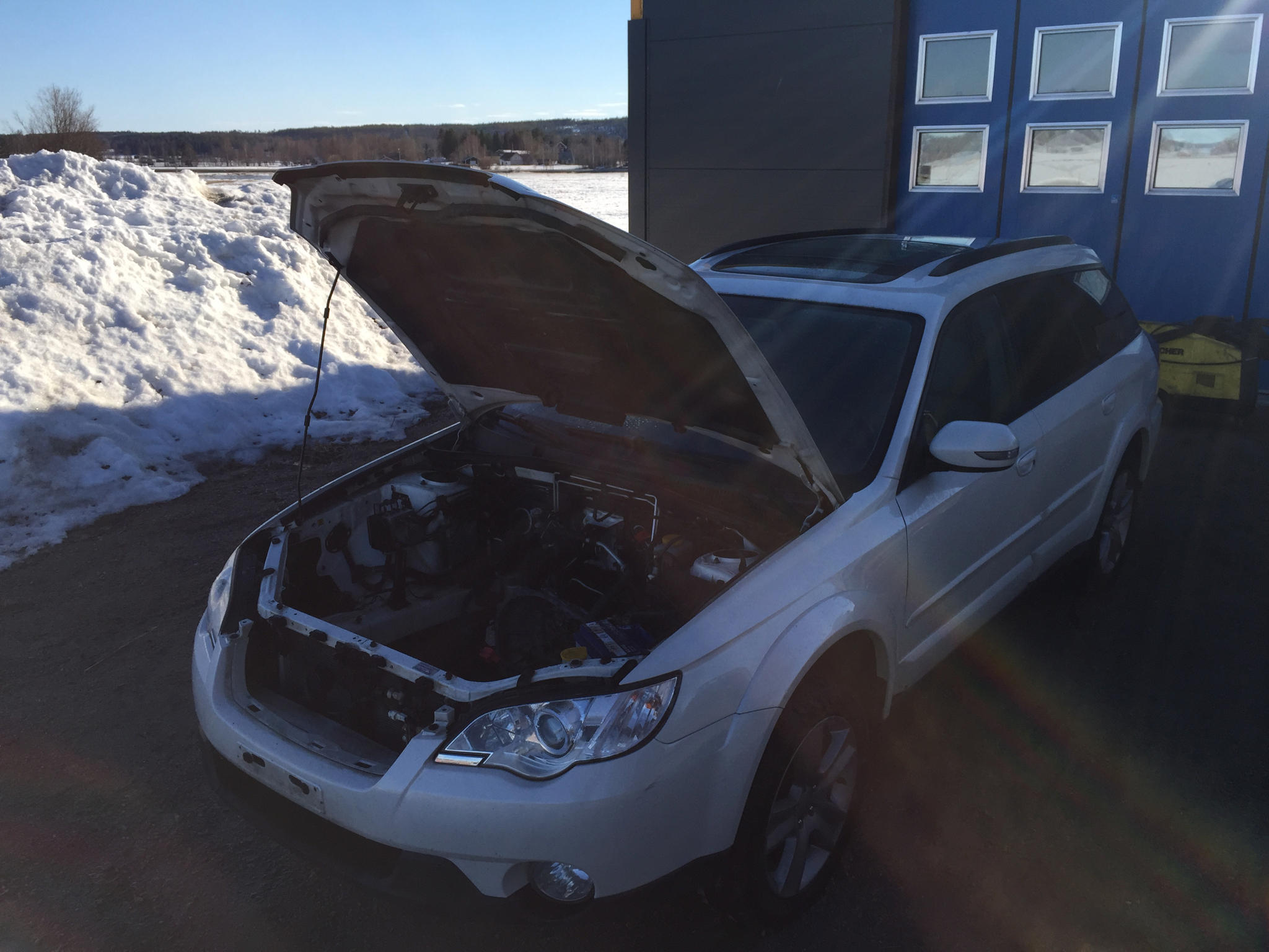

Subaru Outback powered by one of those Enova kit's that circulated some years ago.
Bought the car with the engine in pieces.. well except the engines two block half's and the crankshaft that had become one solid piece.
Most of the engine were in shoeboxes in the boot so extraction was easy ;)

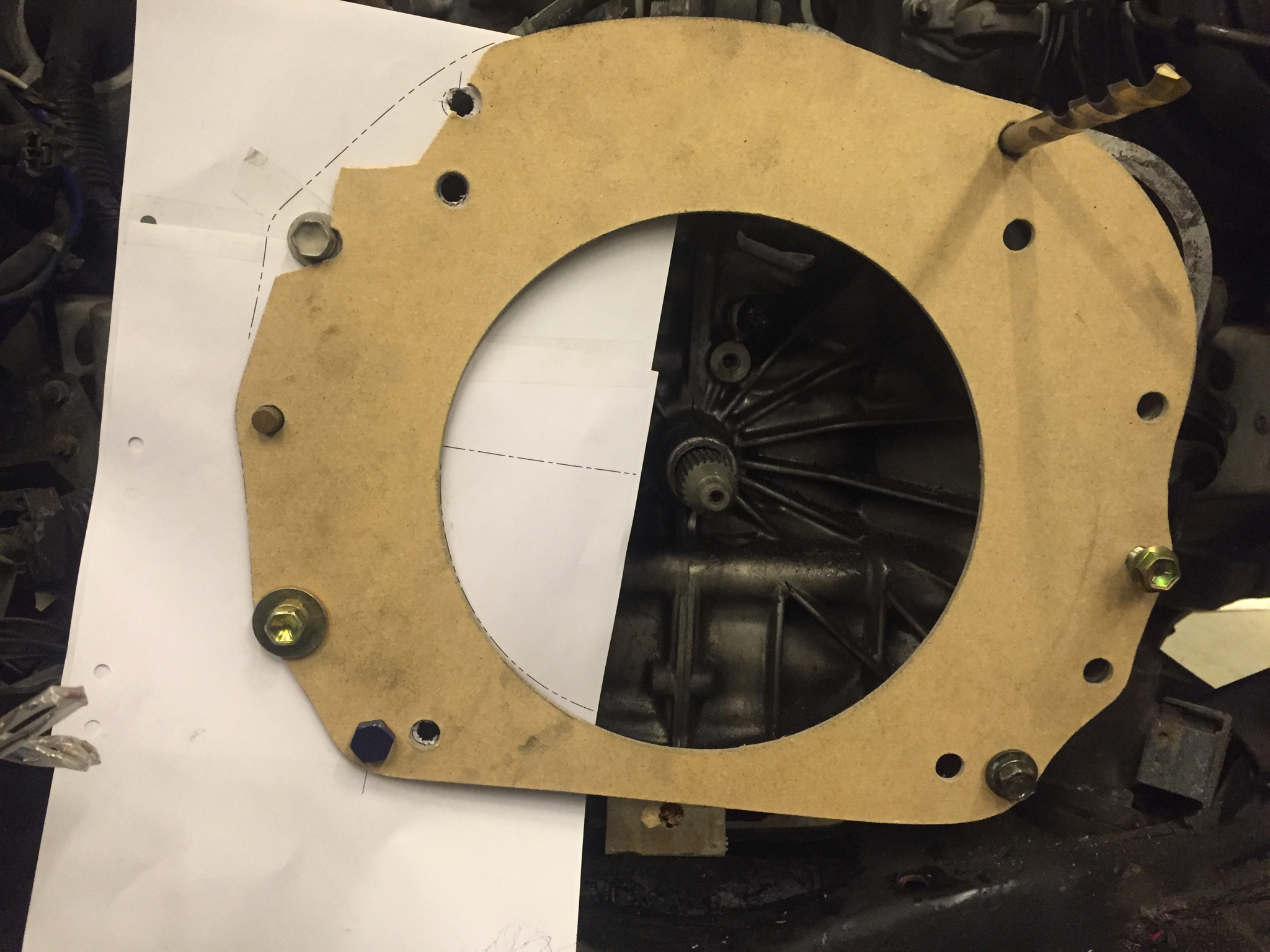

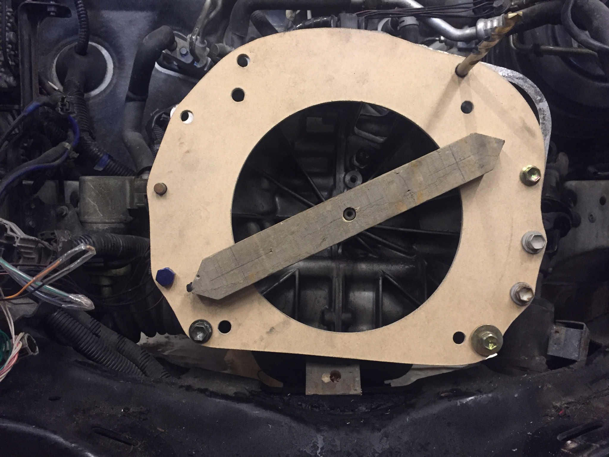

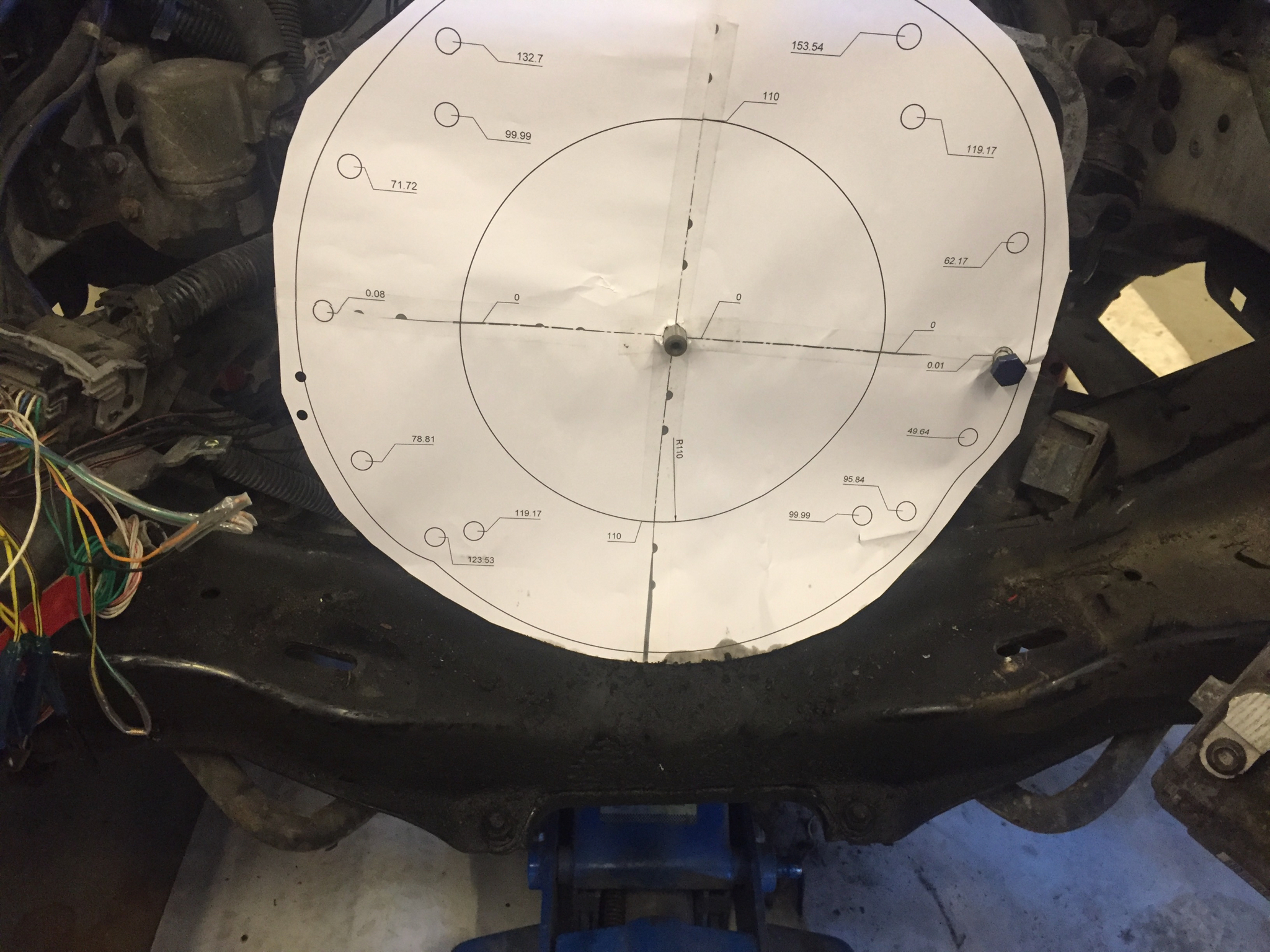

Calipers and ruler get's you a long way...
But some times not long enough. Masonite is a bit cheaper to mess up than 40mm alu.

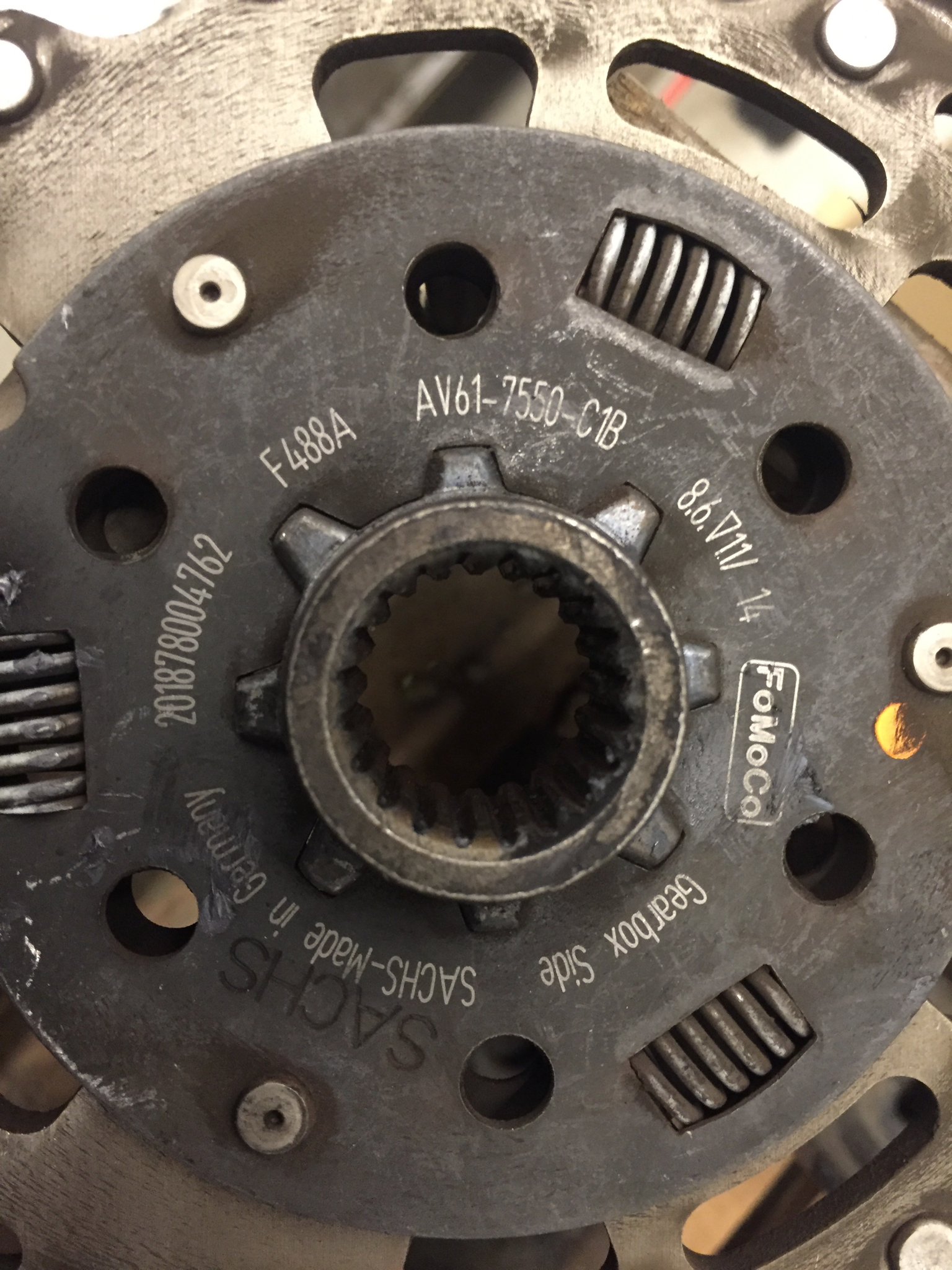

The only part that i didn't get (and hade some use of) from the diesel engine were the clutch, so i got clutch centers from a racing site.
Also for reference, Volvo S80 clutch, perfect fit on the Enova / Hyundai splines.
S80 clutch
S80 clutch

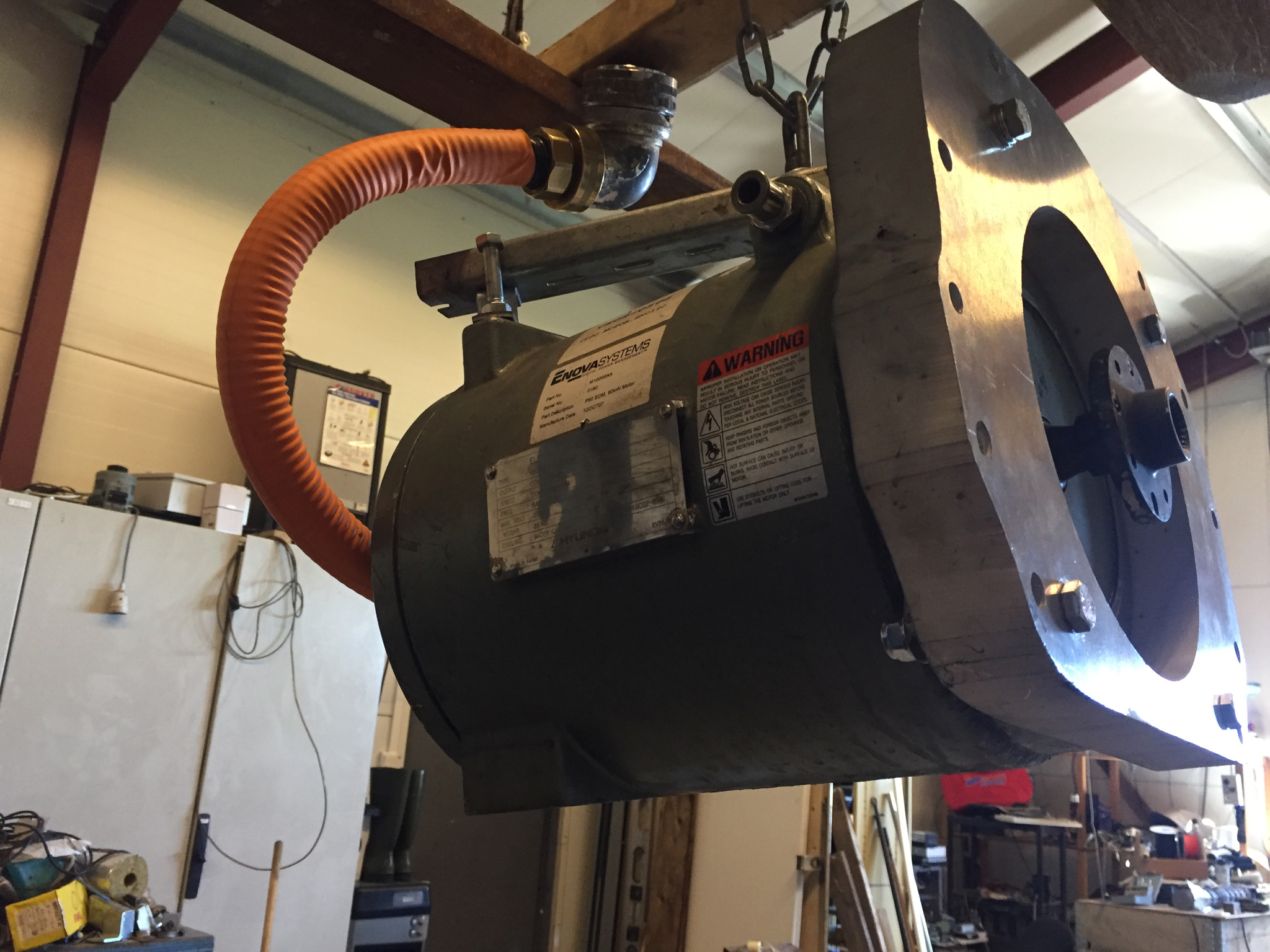

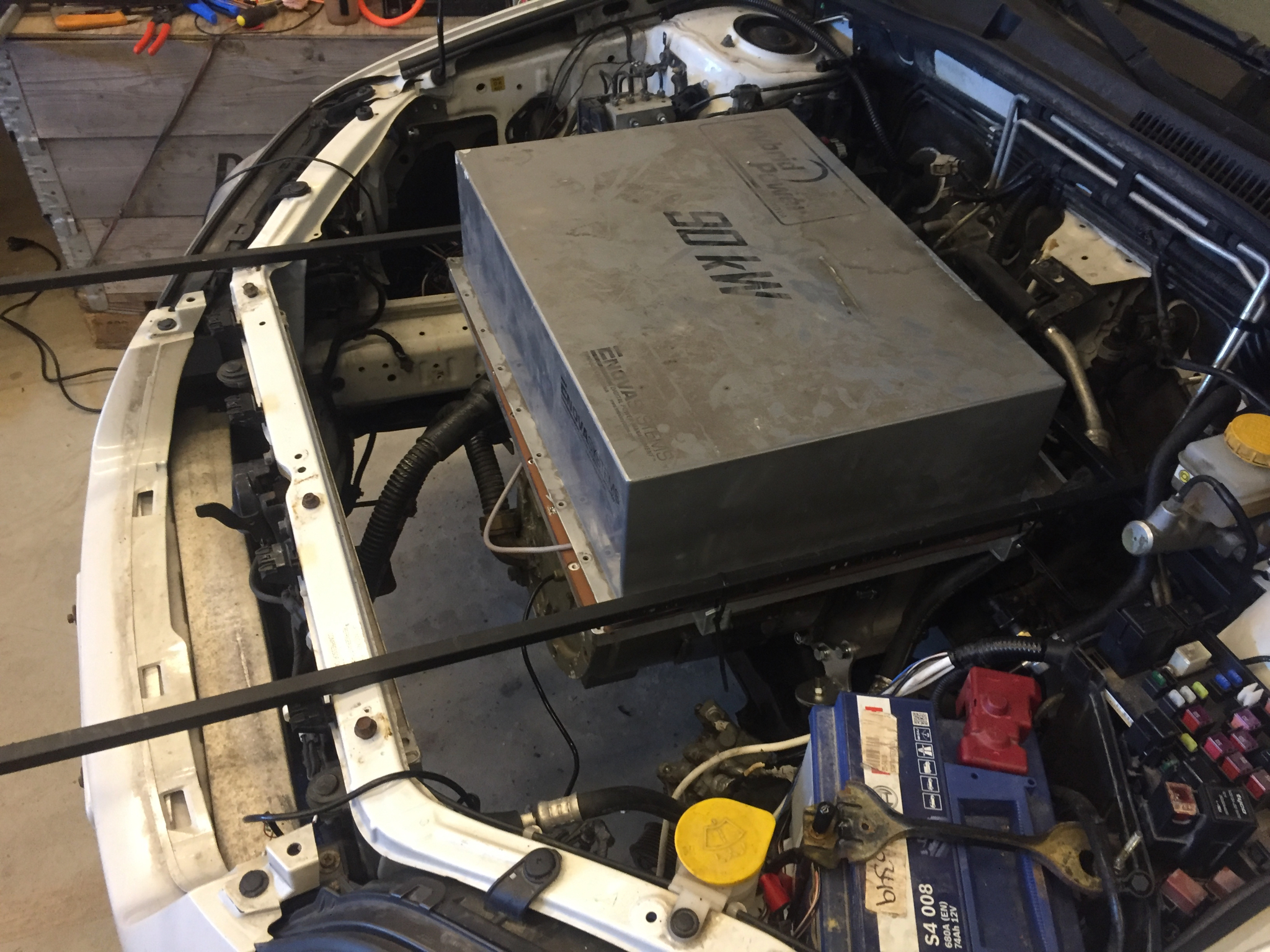

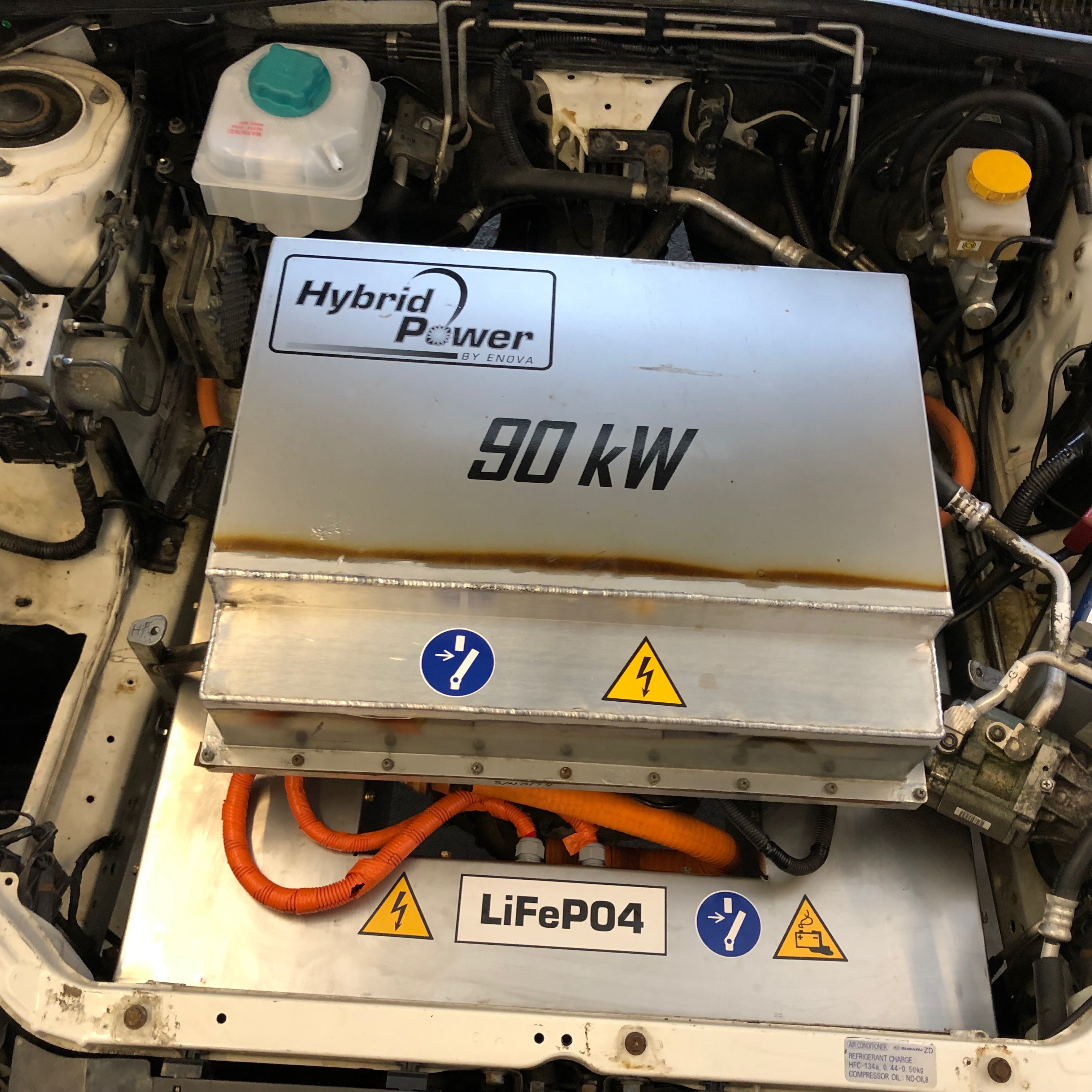

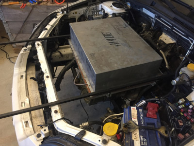

The Enova box is big.
Enova box
Enova box

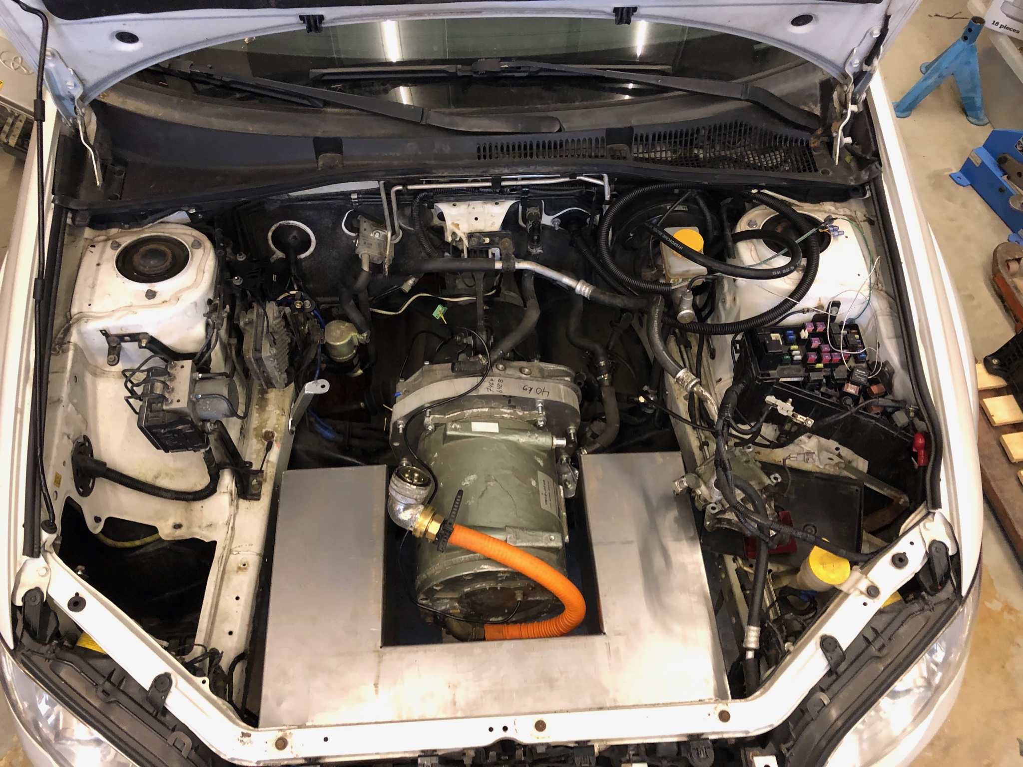

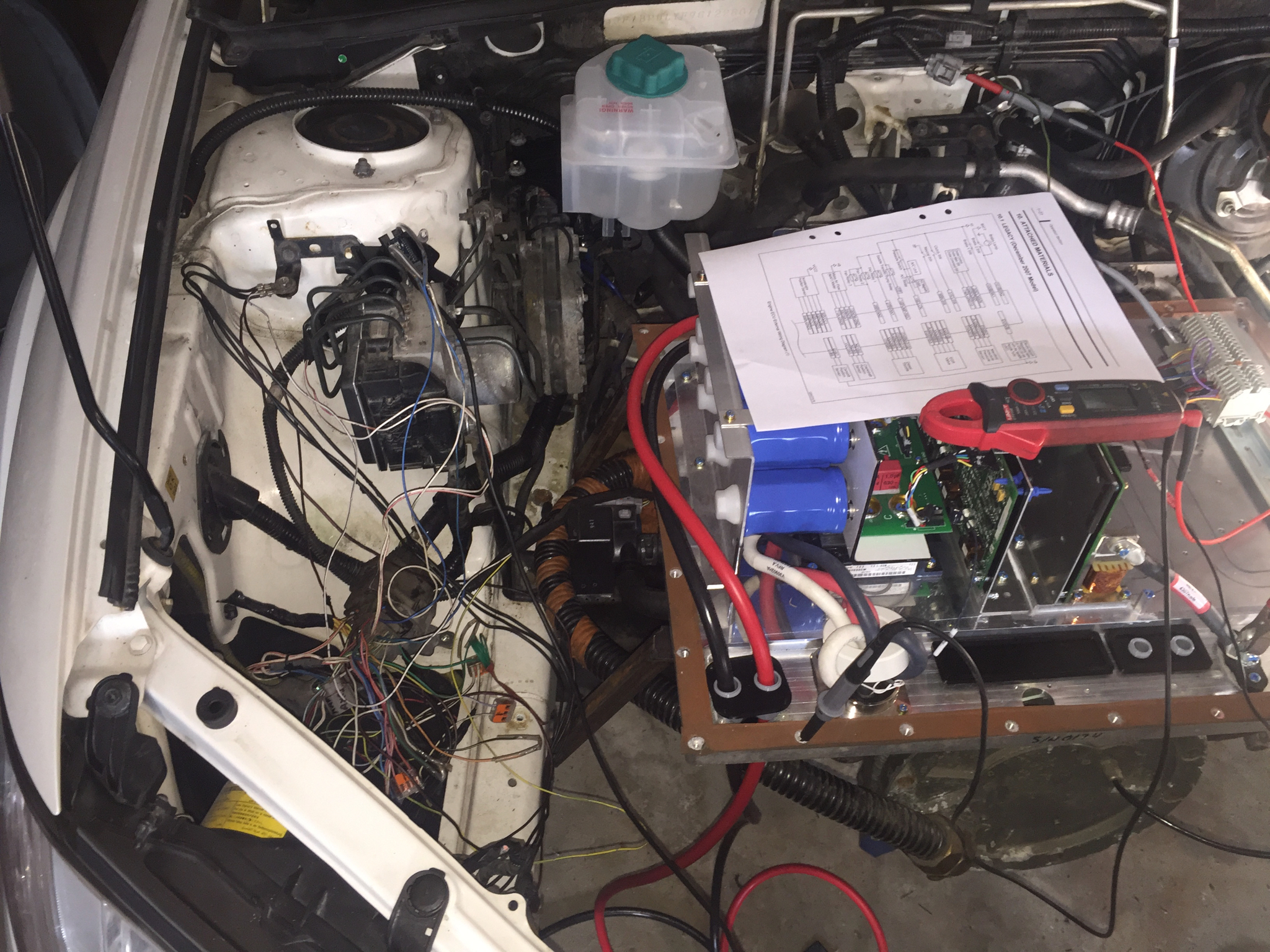

I'm letting the original ECU believe it still in charge. So i have to keep it happy.. Throttle valve, EGR, massflow, fuel pressure valve and turbo boost valve now lives under the stereo.
Fuel temp, fuel level, fuel pressure, air temp and some more are simulated with resistors.
Crankshaft and camshaft is simulated with an arduino nano and ardustim. Locked on 1800rpm, keeps ABS and power steering happy.

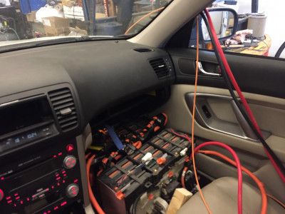

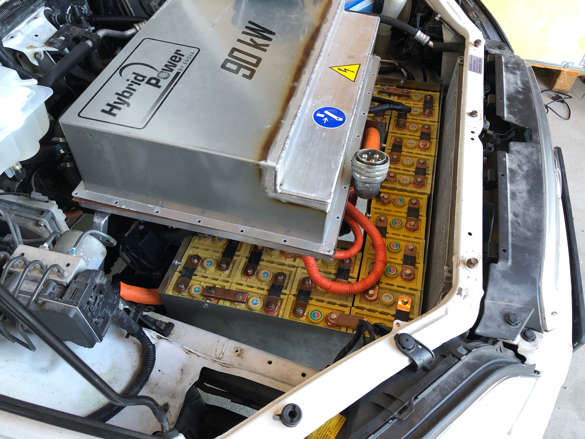

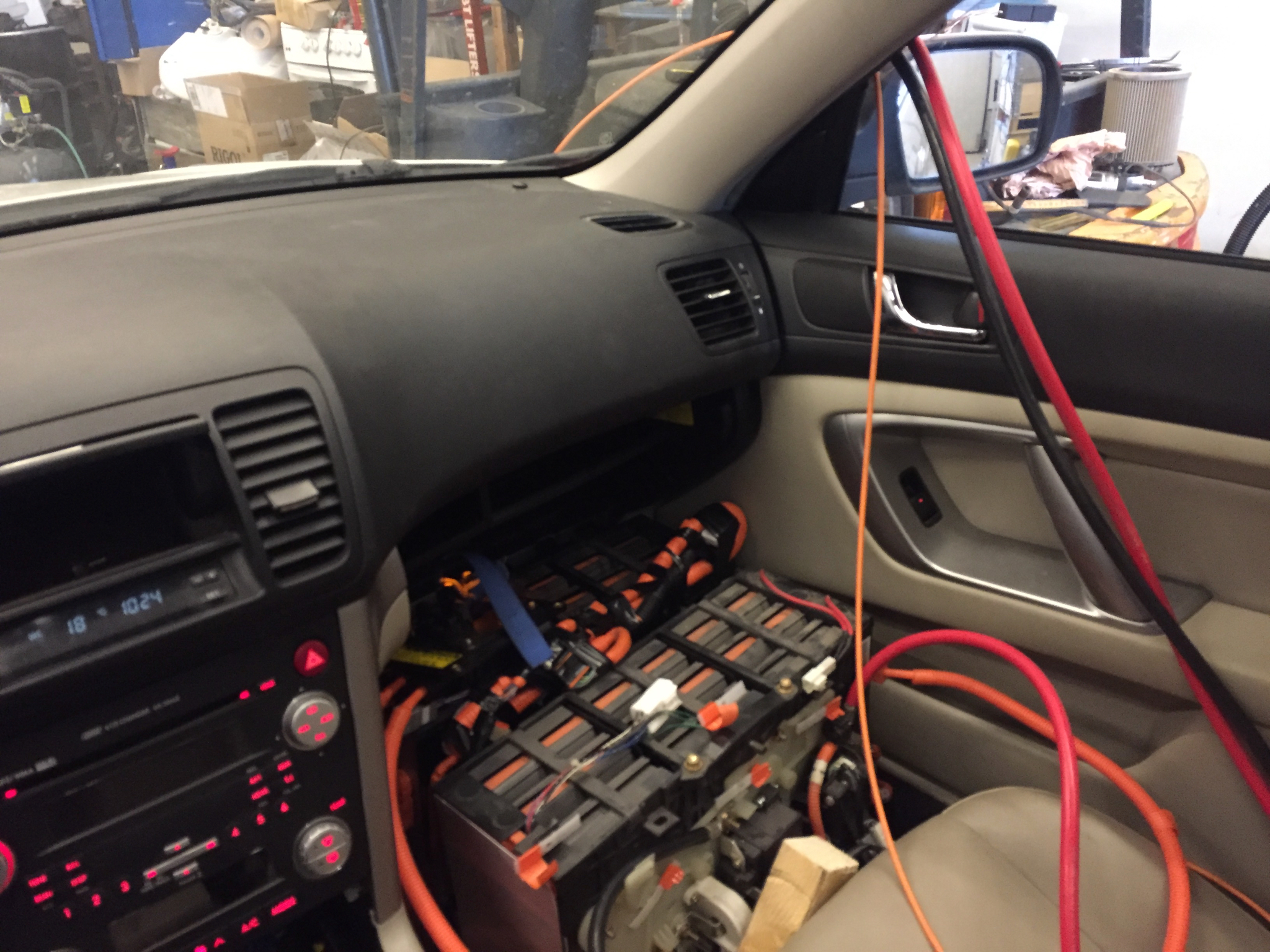

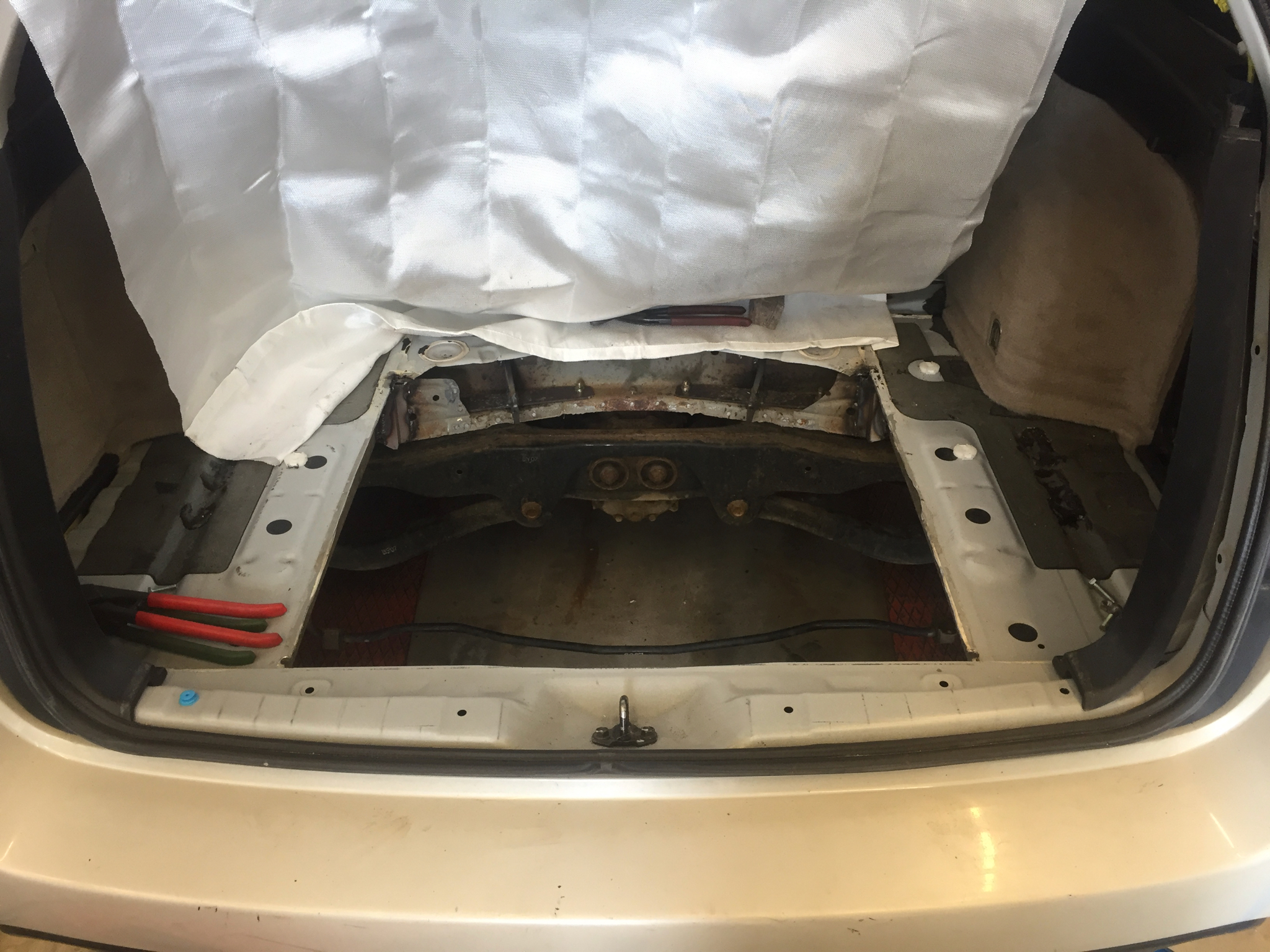

First test run was made on prius gen "0" cells, ≈20year old.

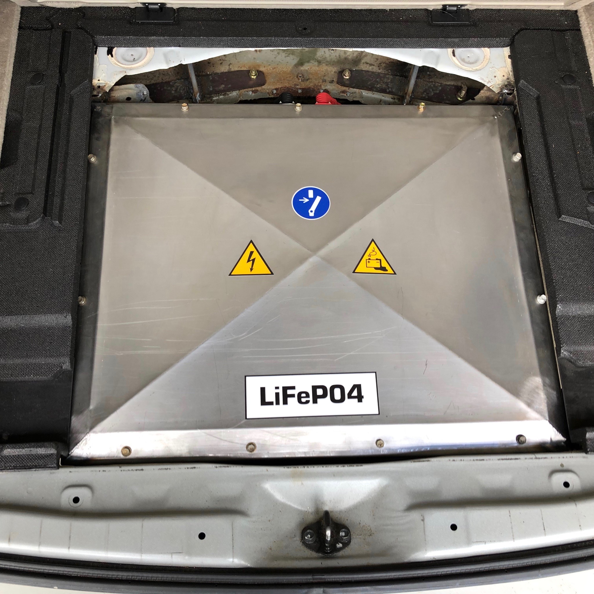

Spare wheel well had to go. Rear battery box. 54s 60ah winston thundersky
tripple glacing
tripple glacing

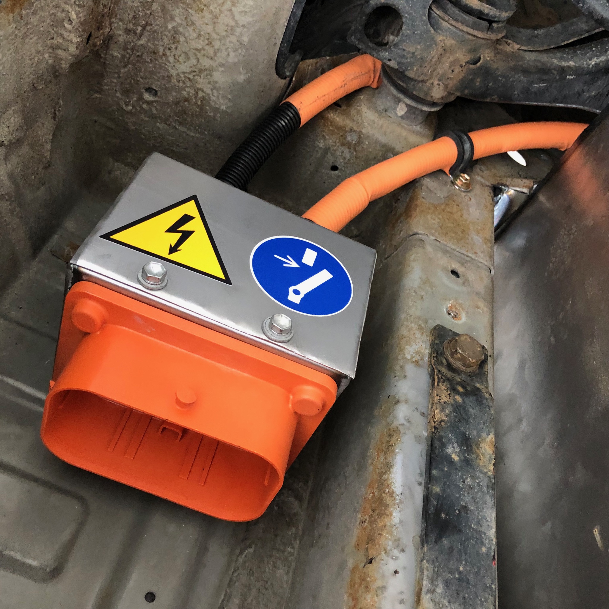

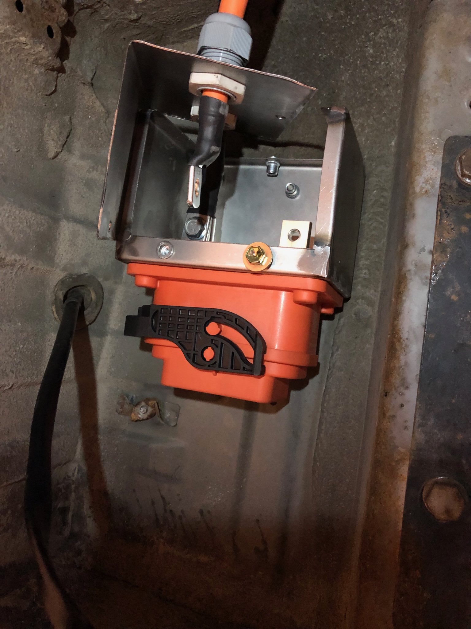

Safety disconnect..

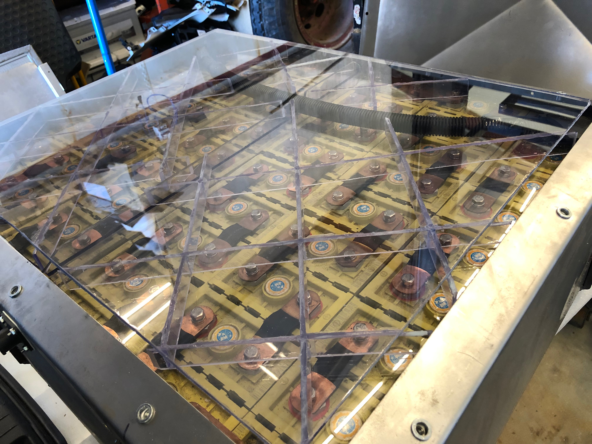

Front battery box. 30s 60ah winston thundersky

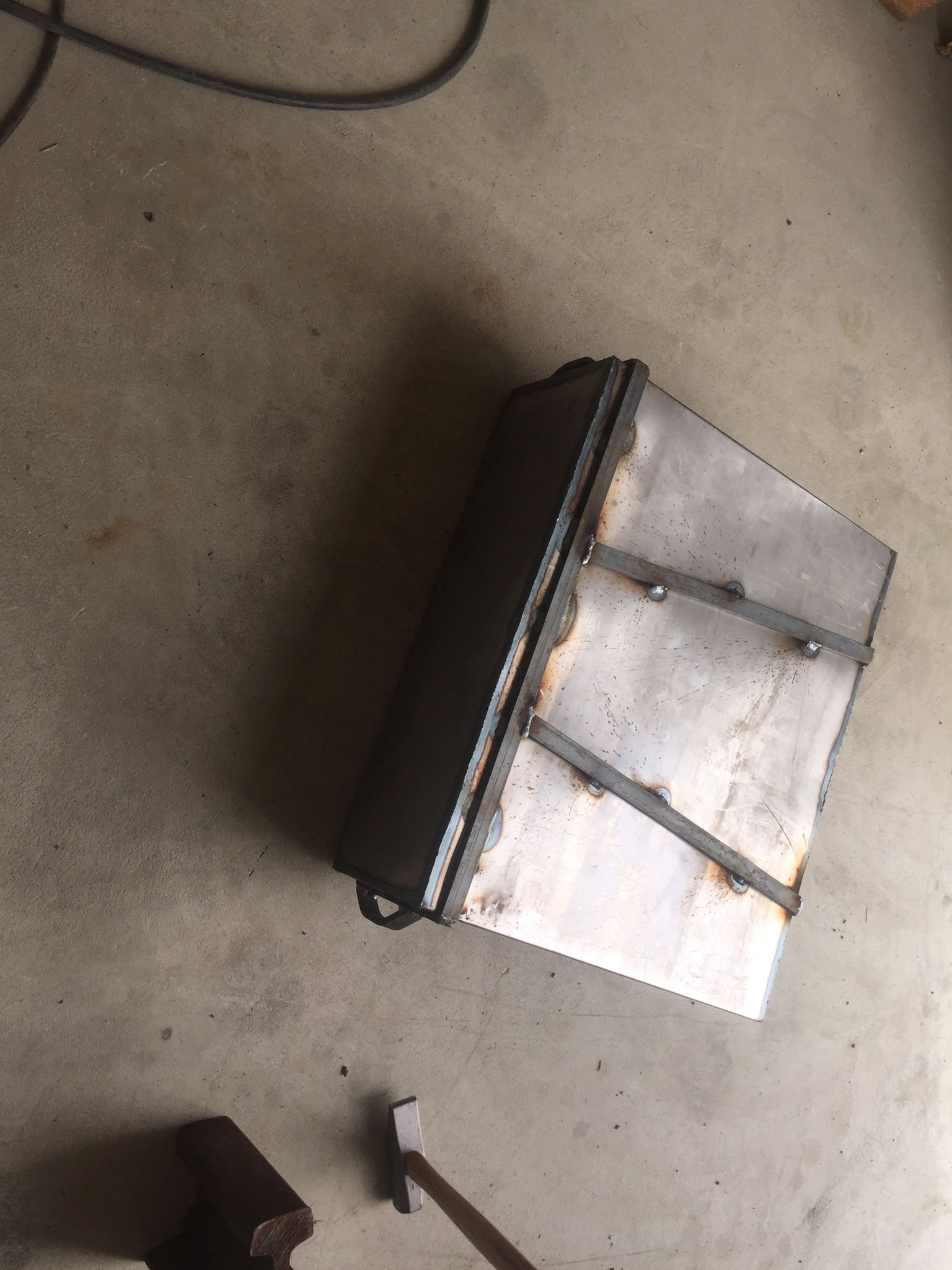

Enova box is cut down, just not enough room.

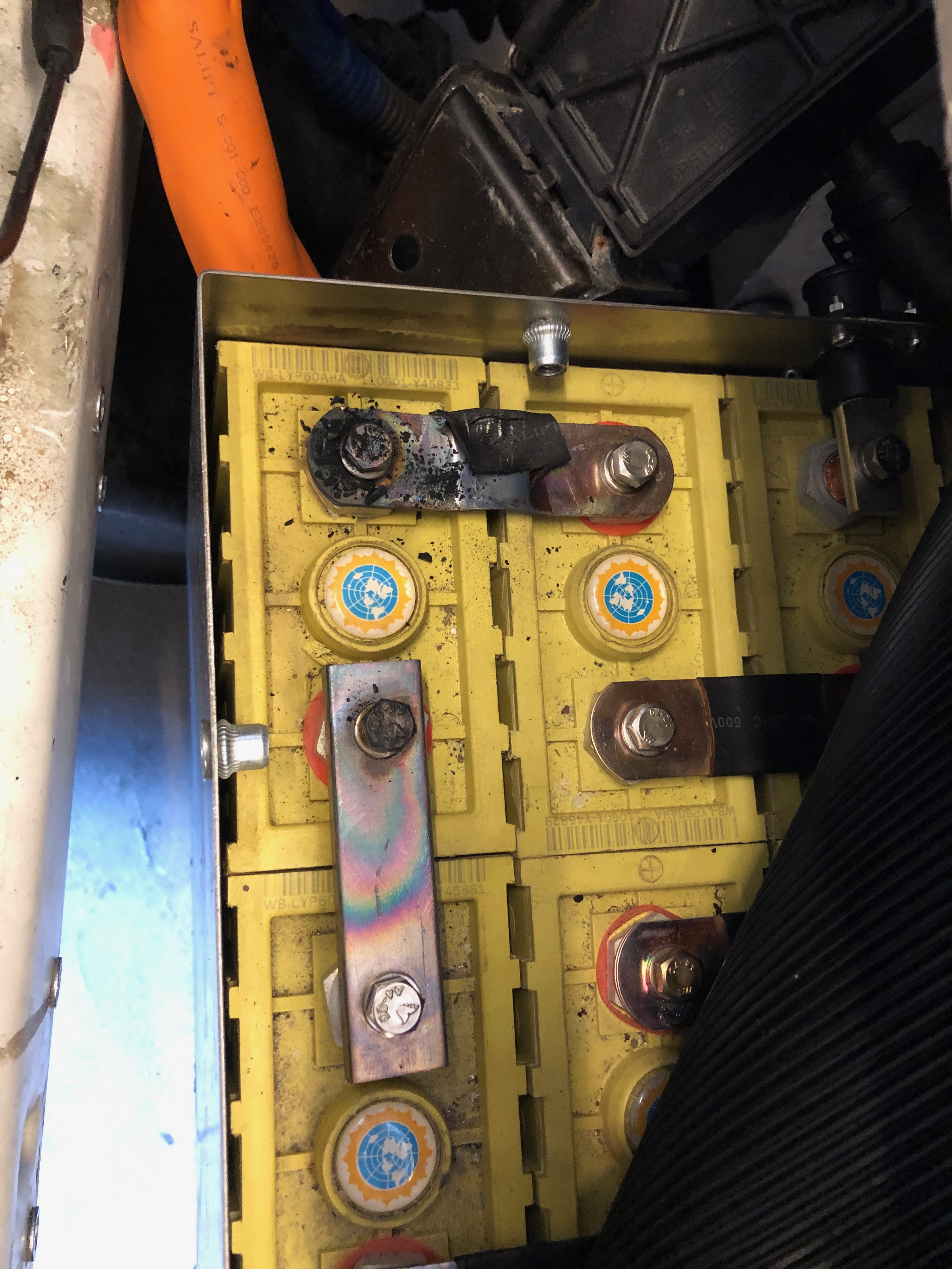

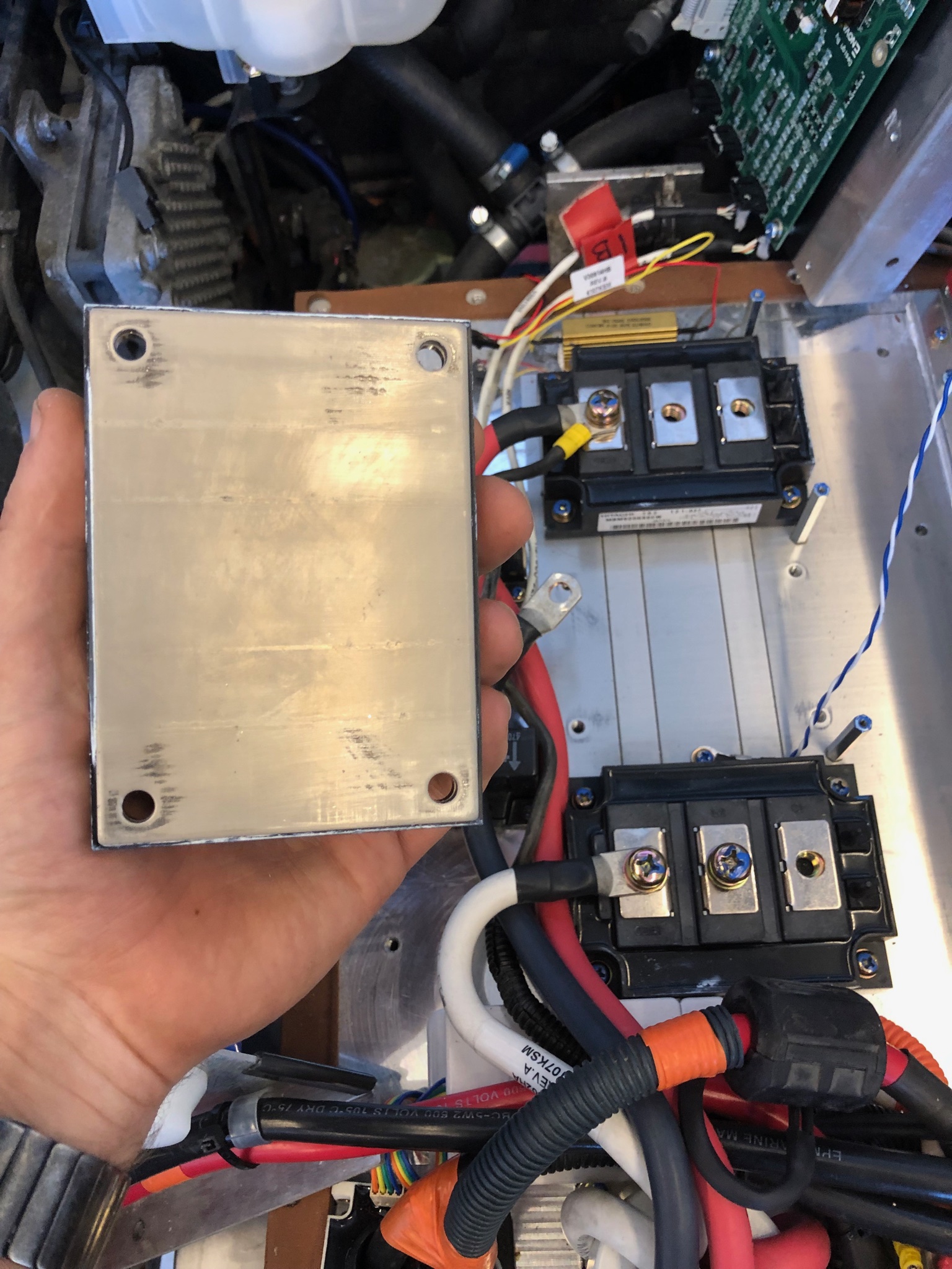

Remember to tighten your connections..

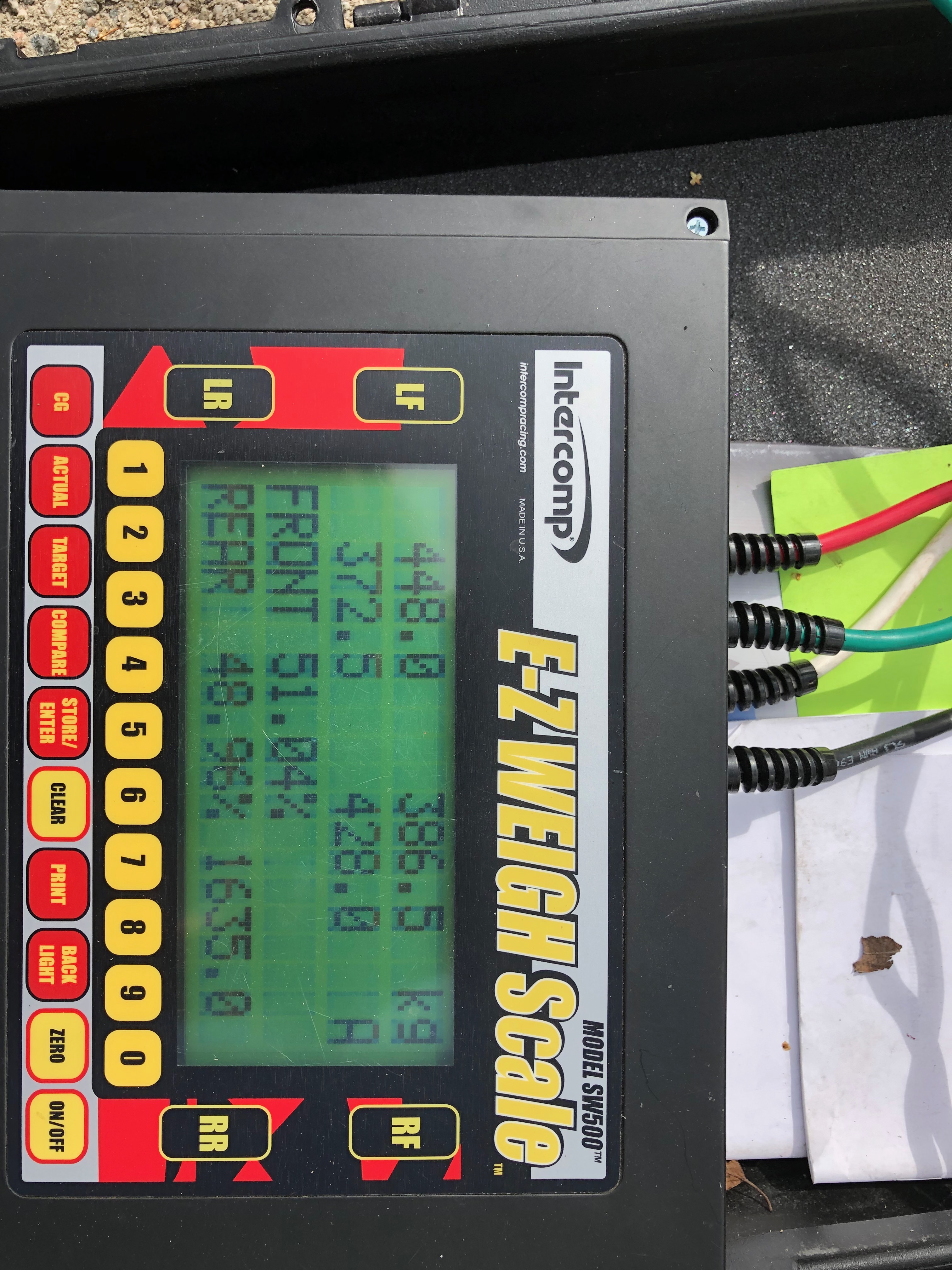

Final weight
Should'n it be some thermal grease under these :?

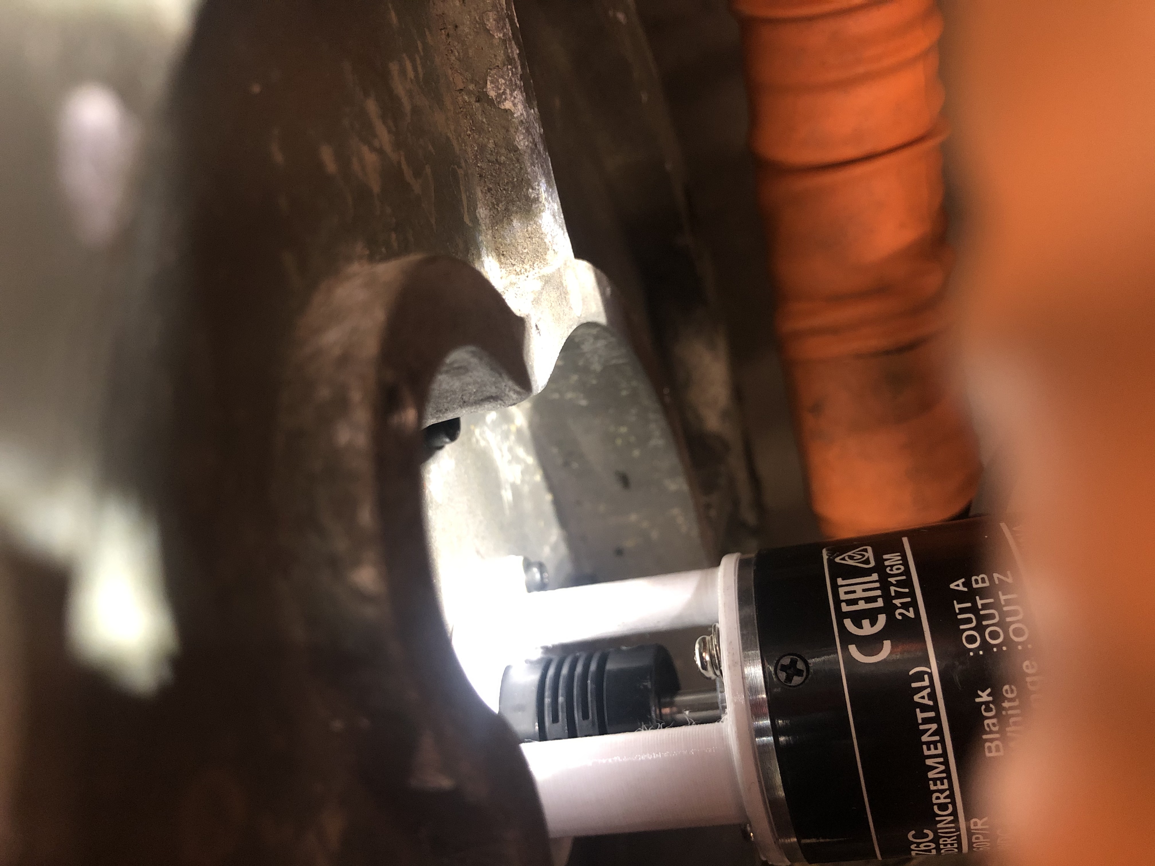

Fitted a new encoder to my enova motor today. Have had some problem with dust blocking either the slots in the encoder disk or the sensor itself. Have blown it out with compressed air to some success previously but two weeks ago it didn't clear the problem anymore.
I will probably go with aber333's route, with a shaft mounted plate, in the future. This one will be problematic to weather proof.

Do you have the gearbox CAD drawing?
