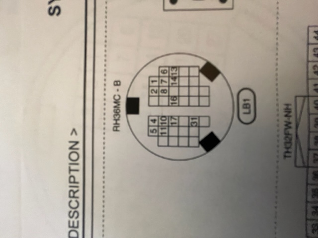

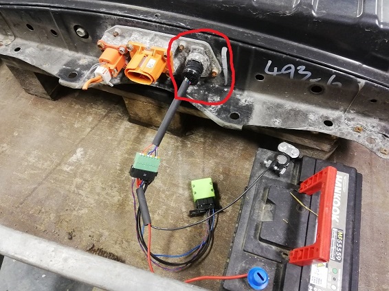

Hey all,

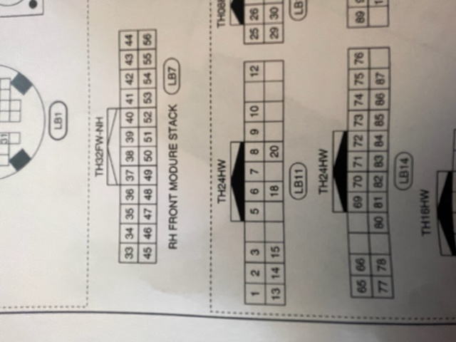

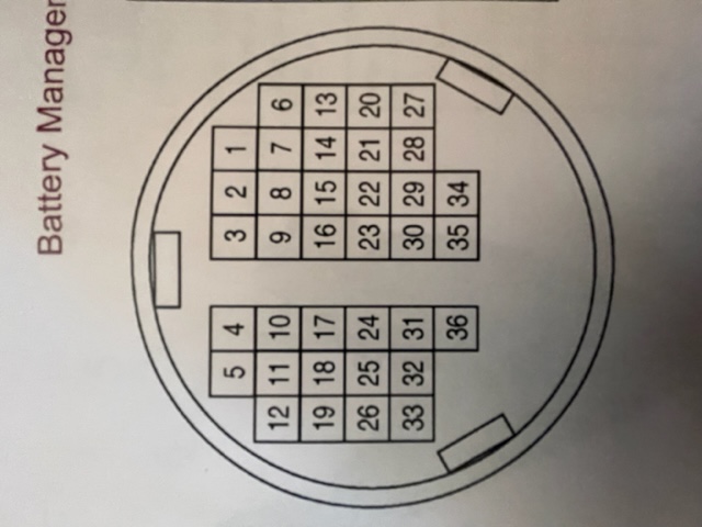

Im trying to pinout the LB24 connector on my pack to the Grey BMS plug and I have a few figured out. However the rest i'm unsure where they come from or connect to my only thought is maybe to the contactor box?. The reason i'm doing this is because I have a hacked up bms harness and the LB24 plug is long gone. So this is what i have so far..
LB11 to LB24
1-1 (Can high)
13-2(can Low)
-3 empty
7-4 Ign
12-5 12v+ battery
3-6 ground
14-7 ground
2-8 ground
-10 ground Current sensor signal
-11
-12 empty
-13
-14
-15 Empty
- 16
-17
5-31 Chg Ign
