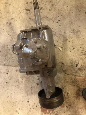

The original Chrysler gearbox looks like this:
The pulley at the end is the handbrake pulley.

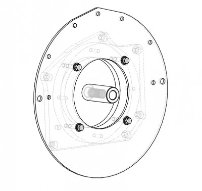

I had drawn up some adapter plate assemblies for it, as he bought a coupler and one of my nema b-face leaf adapter plates. I had integrated the bearing cap into the t5 adapter plate, as the original one sticks out quite far.
this is a input shaft from a t5 gearbox
you could take it out, get it machined down and have a leaf coupler welded to it, or cut it shorter and re-splined for a stub flange of some sort.
there are many differnt eras of the t5, and many rebuild kits, gears, etc for them. they can take some power for sure, but how many hard 160kw launches? not sure. lucky they are used in everything, so they are easy to come by. but i dont see any real issue with it

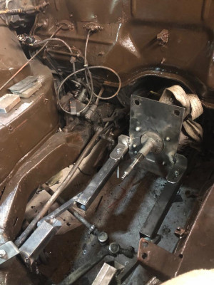

The Leaf stack has been attached to the Chrysler's gearbox. Will be doing a test spin in the next few days and this should reveal if there are any alignment issues/vibrations. Please let us know your thoughts 😊
Re: 1949 Chrysler conversion advice needed please
Posted: Thu Feb 16, 2023 11:12 pm
by Bratitude
thats quite the distance! a support bearing might be a good idea. but id just bore out the input gear and weld in the leaf splines. so the motor shaft goes into the gearbox.

Hi, do you mean cut off the ouput shaft from the gearbox and then bore a hole? I'm attaching a photo what this box looks withe the cover sleeve removed. Where do you think we should bore out?
We tried to spin the motor with the current coupler and it does wobble and shake at low RPM, so not so good so far.
Posted: Thu Mar 23, 2023 1:14 am
by Bratitude
m.art.y wrote: Wed Mar 22, 2023 2:43 pm We tried to spin the motor with the current coupler and it does wobble and shake at low RPM, so not so good so far.
stack your assembly vertically, loosen some of the bolts, and run the motor, it should help align the setup. then tighten everything down. this should help
m.art.y wrote: Wed Mar 22, 2023 2:43 pm Hi, do you mean cut off the ouput shaft from the gearbox and then bore a hole? I'm attaching a photo what this box looks withe the cover sleeve removed. Where do you think we should bore out?
its just a idea iv had, as theres lots of different vehicles with the t5 gearbox. would make for a smaller assembly if possible. i havent taken any measurements to see if it actually possible to do this.
you would essential turn the input gear from a "male" shafts to a "female" hole....

Leaf EM57 gearbox coupled to 1949 Chrysler M5/6 gearbox. Vibrations reduced to a minimum but is that good enough? 😊
