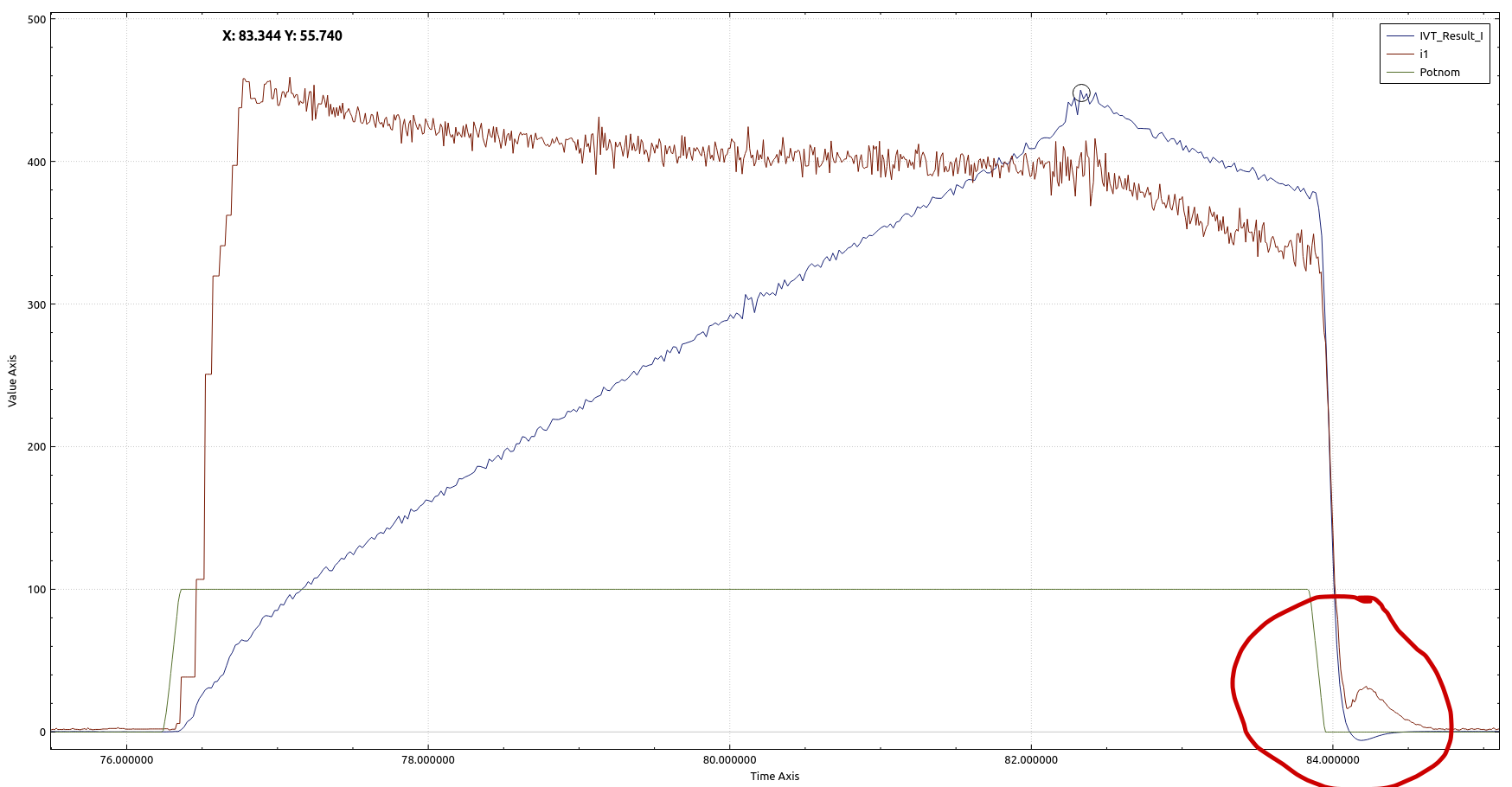

Another point to note is that I use a much less aggressive throtramp=5 than your throtramp=20, which is another possible explanation for the initial overcurrent error.
If you are interested in *why* tripmode damages the inverter, see the following graph: Notice that when the current is stopped suddenly, there is a brief period where the battery current (blue line) goes negative. This is basically the leftover magnetic energy in the motor coils returning to the battery. If this spike of energy can't get back to the battery, it will cause damage to the inverter.
It is understandable why most people think the safest thing to do in case of a fault is to disconnect the batteries as soon as possible, but without a short delay, this definitely has potential to do more harm than good.
It's a shame that this information has not disseminated more effectively. I would invite anyone and everyone to put this informaiton on the wiki here https://openinverter.org/wiki/Tesla_Mod ... %22SDU%22)
