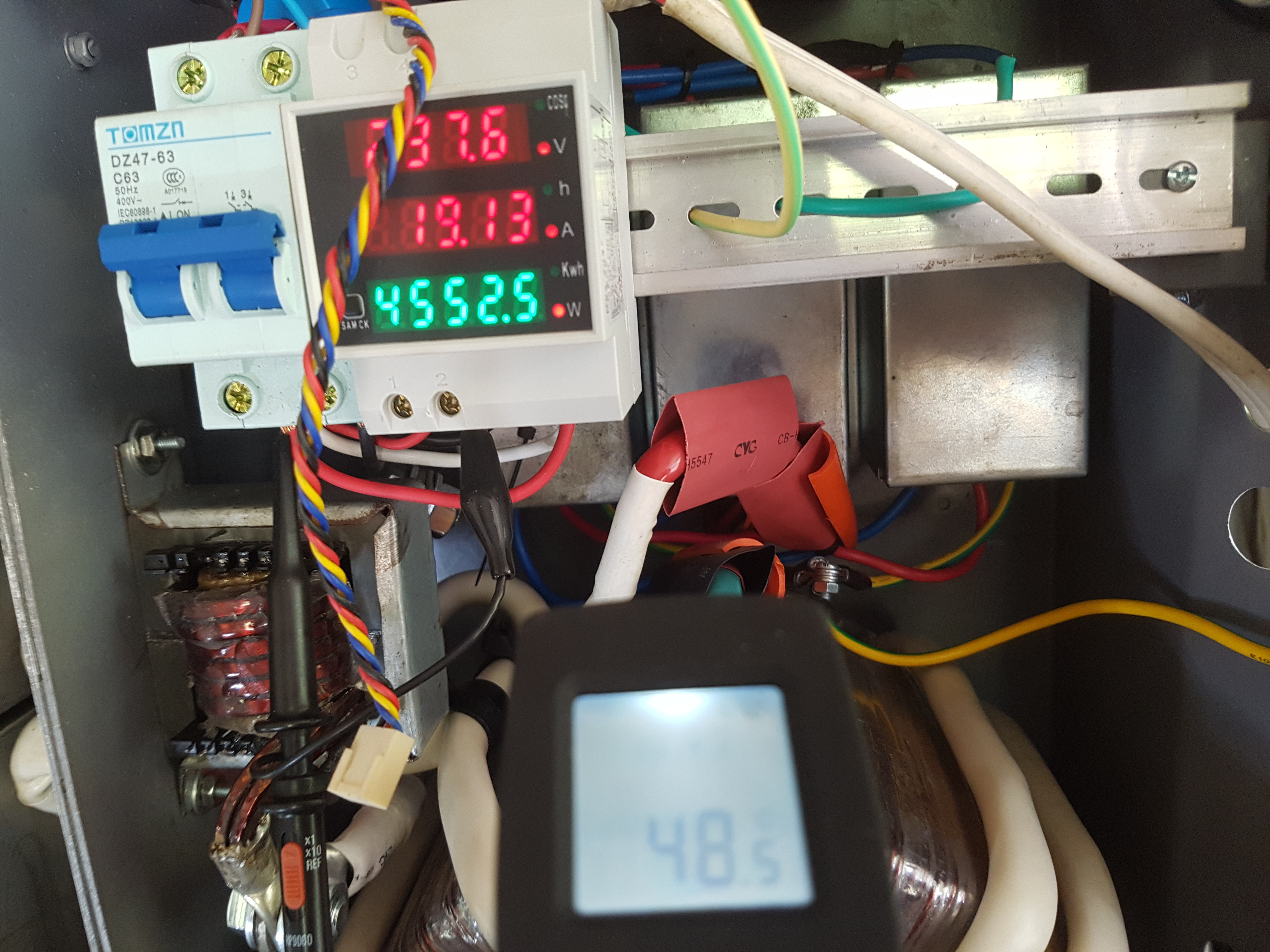

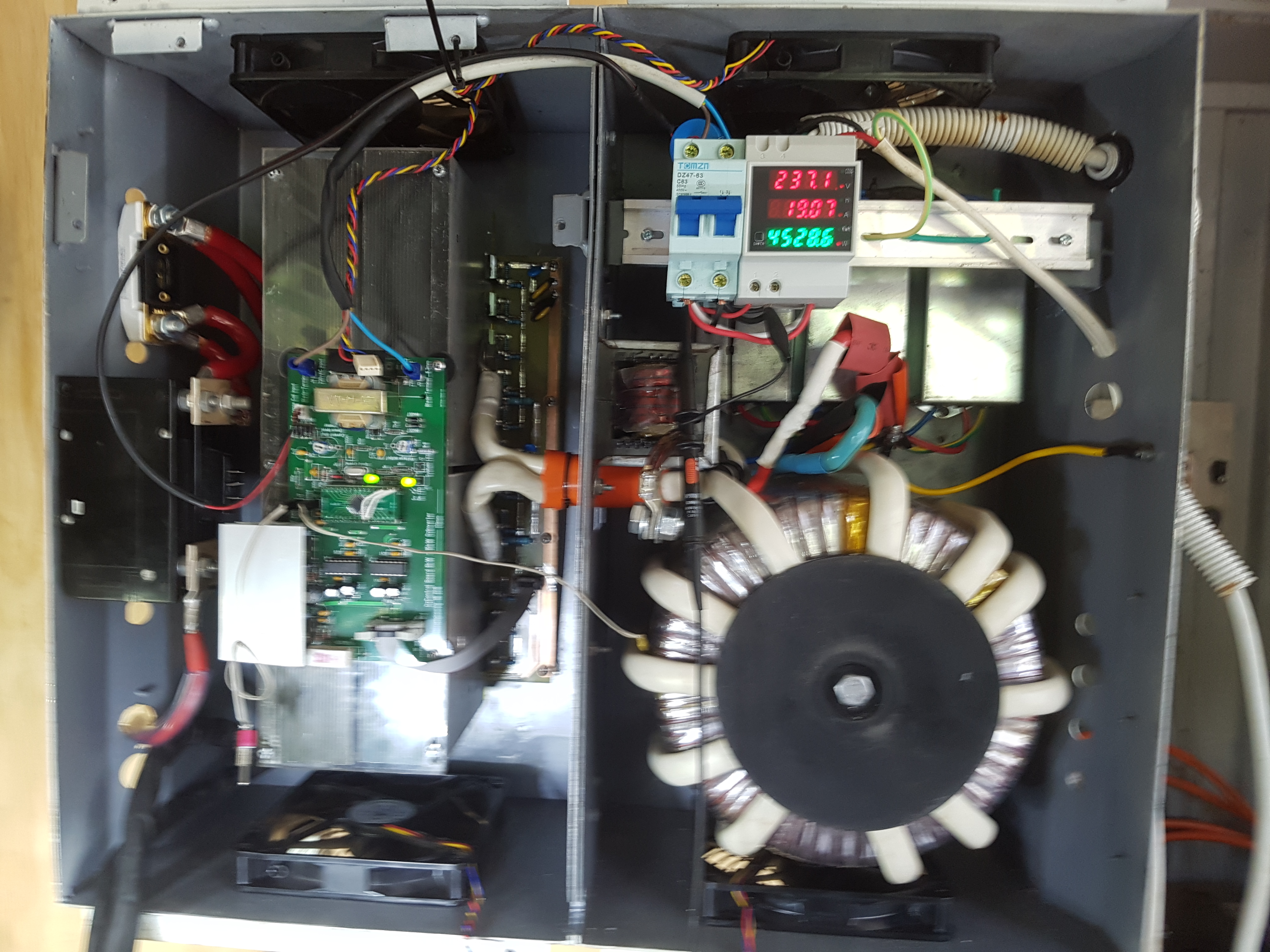

I noticed some time ago Damien asked me to share what I have done, unfortunately, I did not have email notification setup and had not been here for a long time.
I have built several of these inverters and sold many PCBs to others to do the same via https://www.thebackshed.com
For around $500USD you can build a very robust 8KW or 4KW CONTINUOUS 48V full sinewave inverter. I have been running my house off the 8KW version for 6 years now. We have a big screen TV, Dishwasher, washing machine, clothes dryer, water pumps, induction cooktop, computers running 24/7 and even a 10KW (cooling capacity, 3KW input) airconditioner that is used on hot sunny days here in Australia. All this is powered from 14KW of PV panels which charge a 775AH 48V FLA forklift battery. I know many of you will scream about Lithium etc but it was by far the cheapest battery when I bought it 4 years ago.
If people are interested I can upload PCB files, Arduino code etc, I used 2 Aerosharp 3KW grid tie inverters for the toroidal transformer by unwinding and rewind 2 and combining 2 cores to make 1 large toroid.

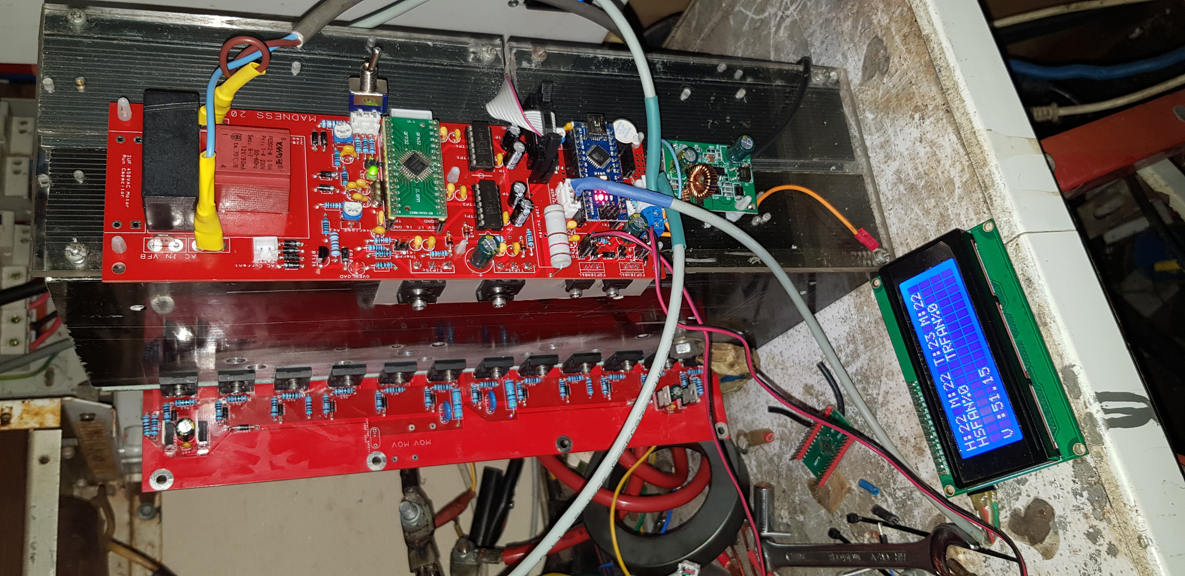

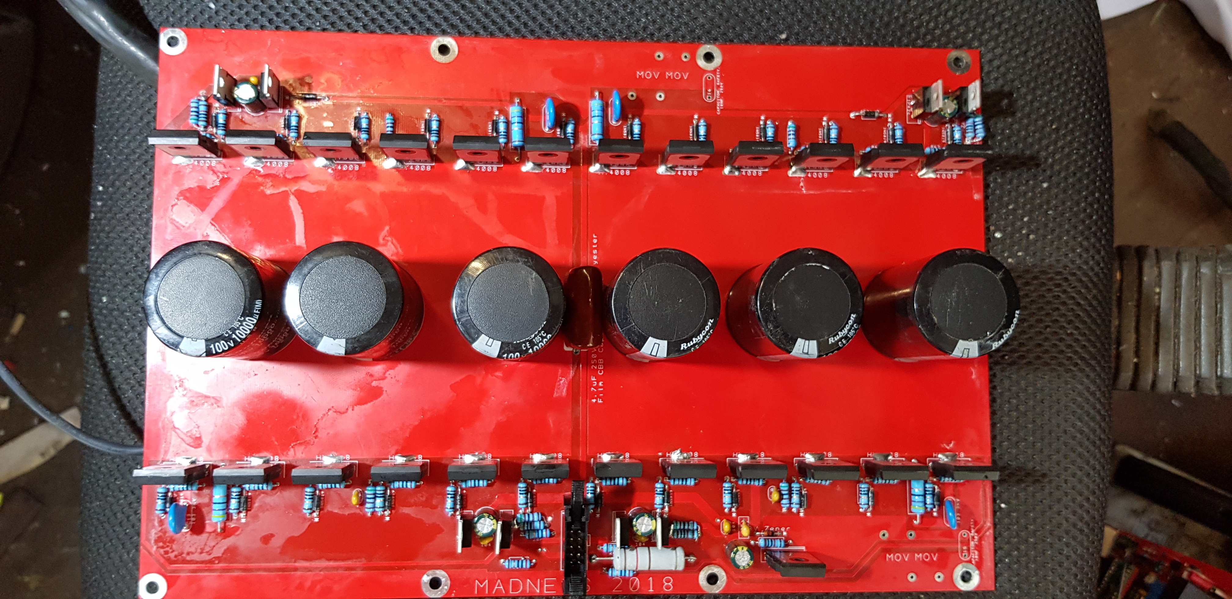

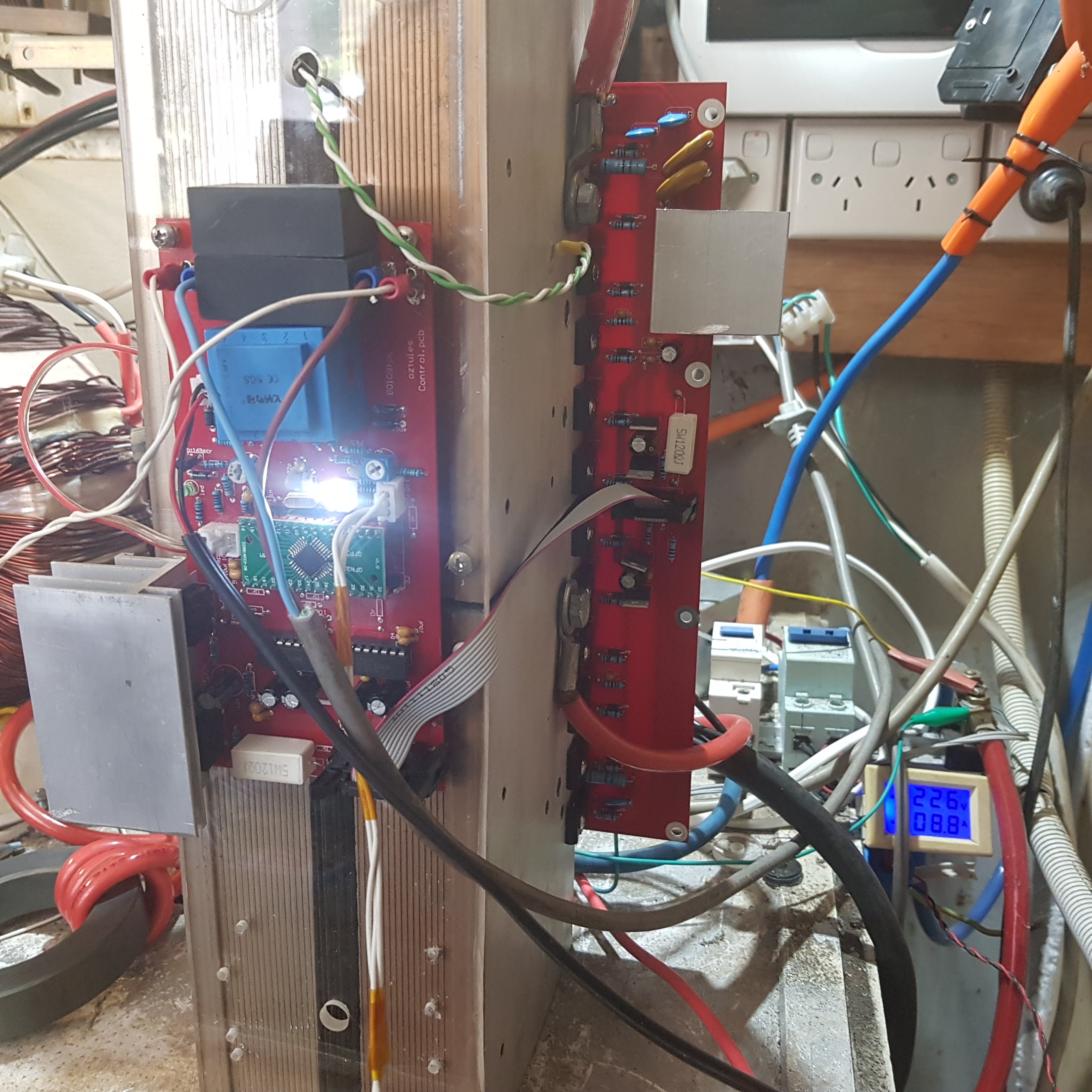

This is my design based on the work of Oztules who designed what is sold as the Ozinverter. I had originally used the Ozinverter design but had lots of issues and added Totem Pole Drivers to the Power PCB of my 8KW version. The 4KW is essentially an Ozinverter but has no Totem Pole Drivers and only 12 Mosfets rather than 24. The IR2110 driver ICs are fine with 3 MOSFETs on each leg but 6 is a bit much for them IMHO.
The control board I designed has an Arduino on it that controls the fans and will shut down the inverter if the battery voltage drops too low. This is essential if the voltage drops too low under load the inverter will have a catastrophic failure.
I will make a couple of small changes to the control board and put up the files shortly. I need change it to keep the Driver IC's turned off while the EG8010 IC boots up.

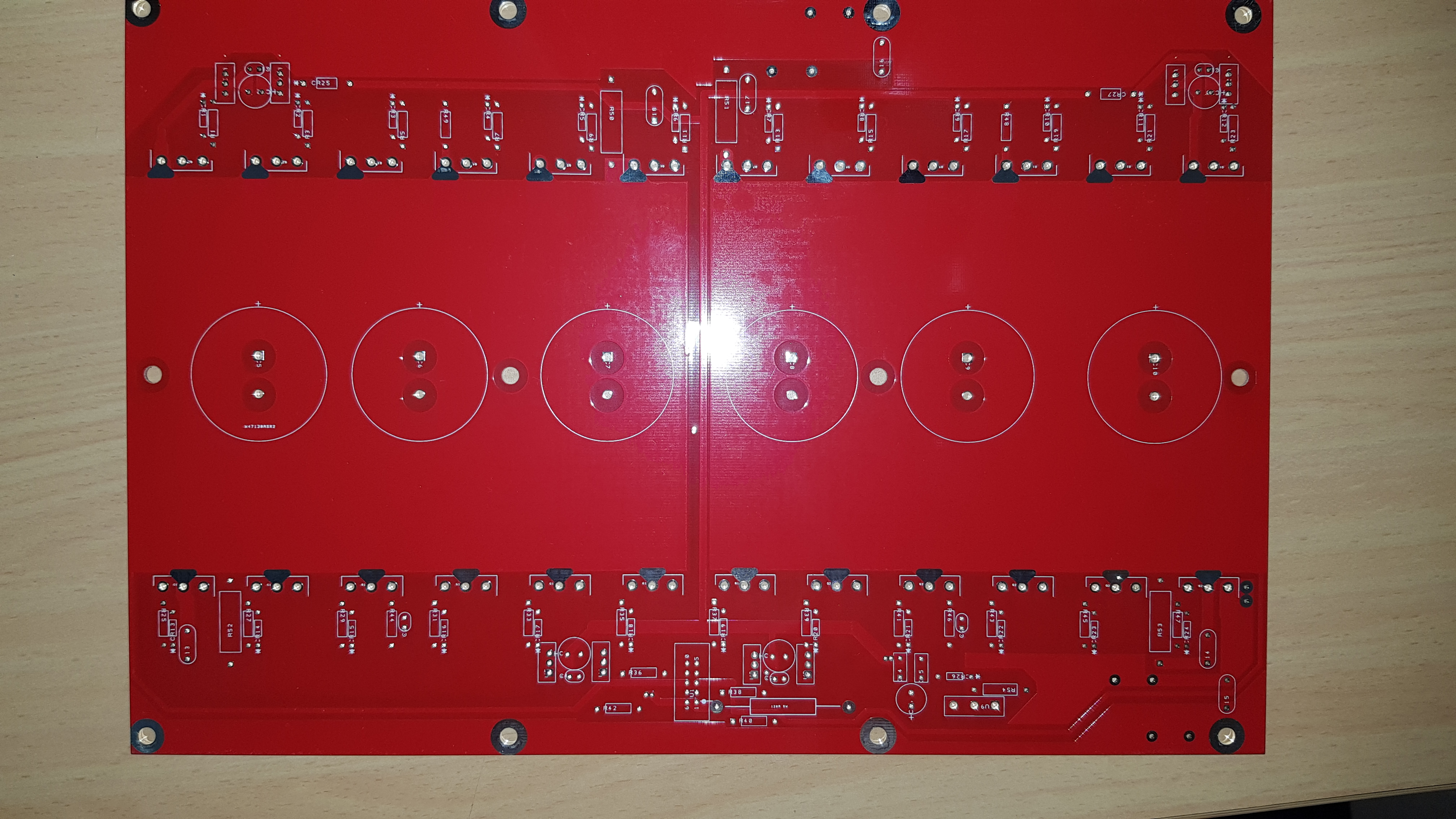

I have files in PCB design files in Designspark and can make Gerber files. However, I know many don't like this but the PCB is my schematic.
