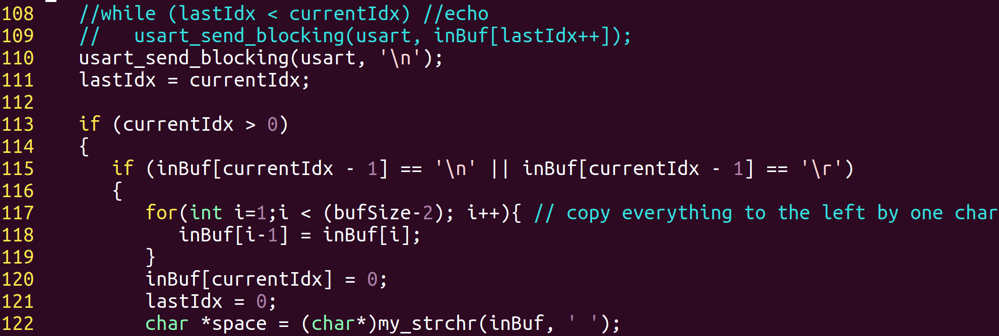

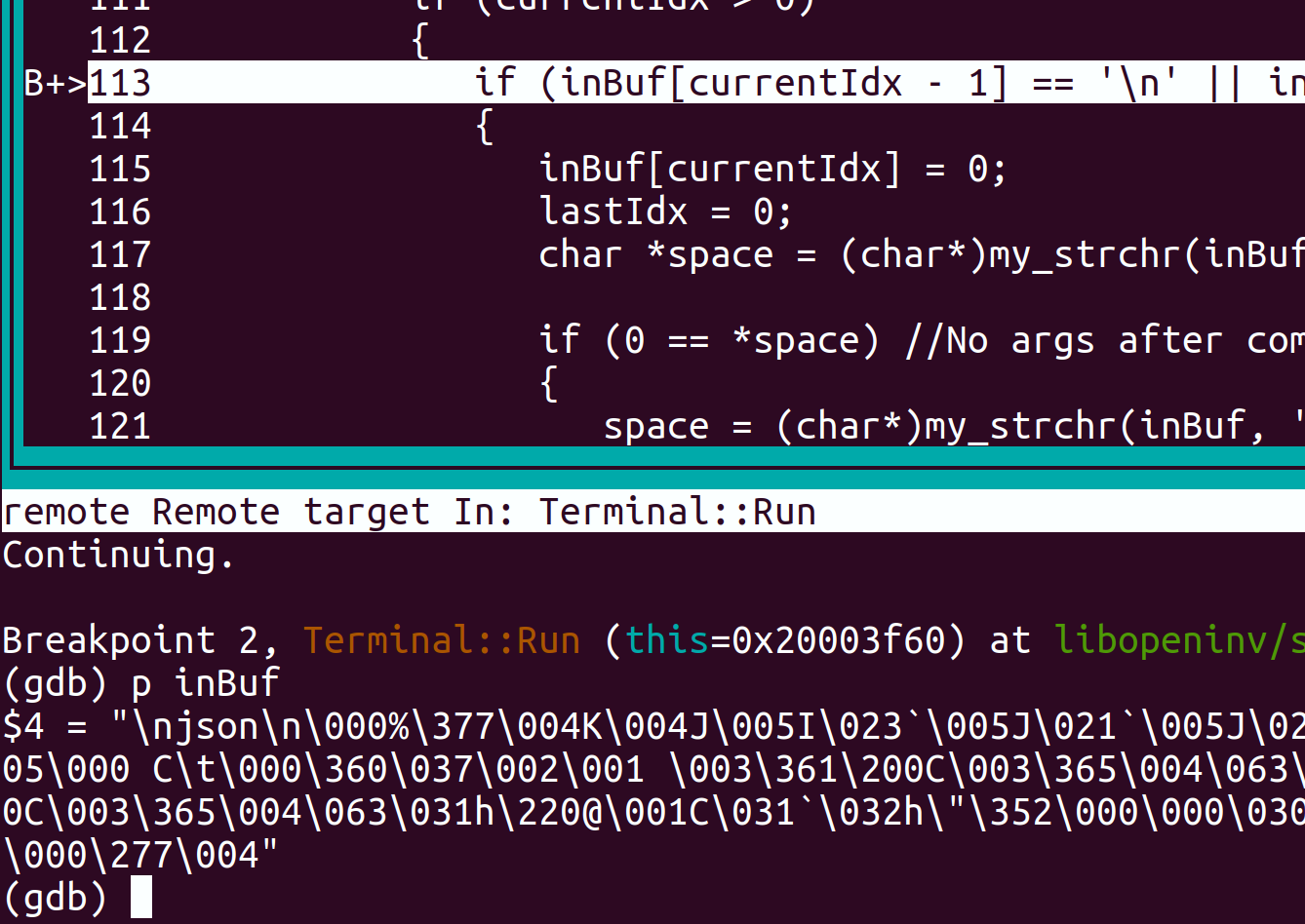

Web interface "spontaneously" stopped reading params from my VCU, so I had a bit of a look around and in Terminal::Run I stepped through the parsing and found leading "\n" in term->inBuf but I can't quite figure out how that got there.
I believe what needs to be in term->inBuf is "json\n\000...." but instead its "\njson\n\000...". I got no idea where that newline could come from all of a sudden
I stepped through "CmdLookup(inBuf)" and it looks for "" instead of "json", which doesn't match anything in termCmds[] obviously.
As a band-aid I added an EmptyCommand to terminal_prj.cpp that copies the inBuf one byte to the left and just calls CmdLookup again, that then gives a JSON response on UART, cool, but where are these newlines coming from? Presumably they are the terminating \n from previous call. Also my bandaid doesn't quite work because it then breaks the JSON parsing in the webinterface.

Yeah, copying everything to the left one char and replacing the command echo with just a newline echo brings the params back into the web interface, but I am sure breaks other functionality. It will break itself once the \n decide to go and I am one char short.

Re: terminal.cpp Unknown Command Sequence "json"
The ESP itself creates a newline to flush the buffer. That is all normal so far. Remains the question why it no longer reads the json command afterwards. You must have changed something somewhere, seemingly unrelated...

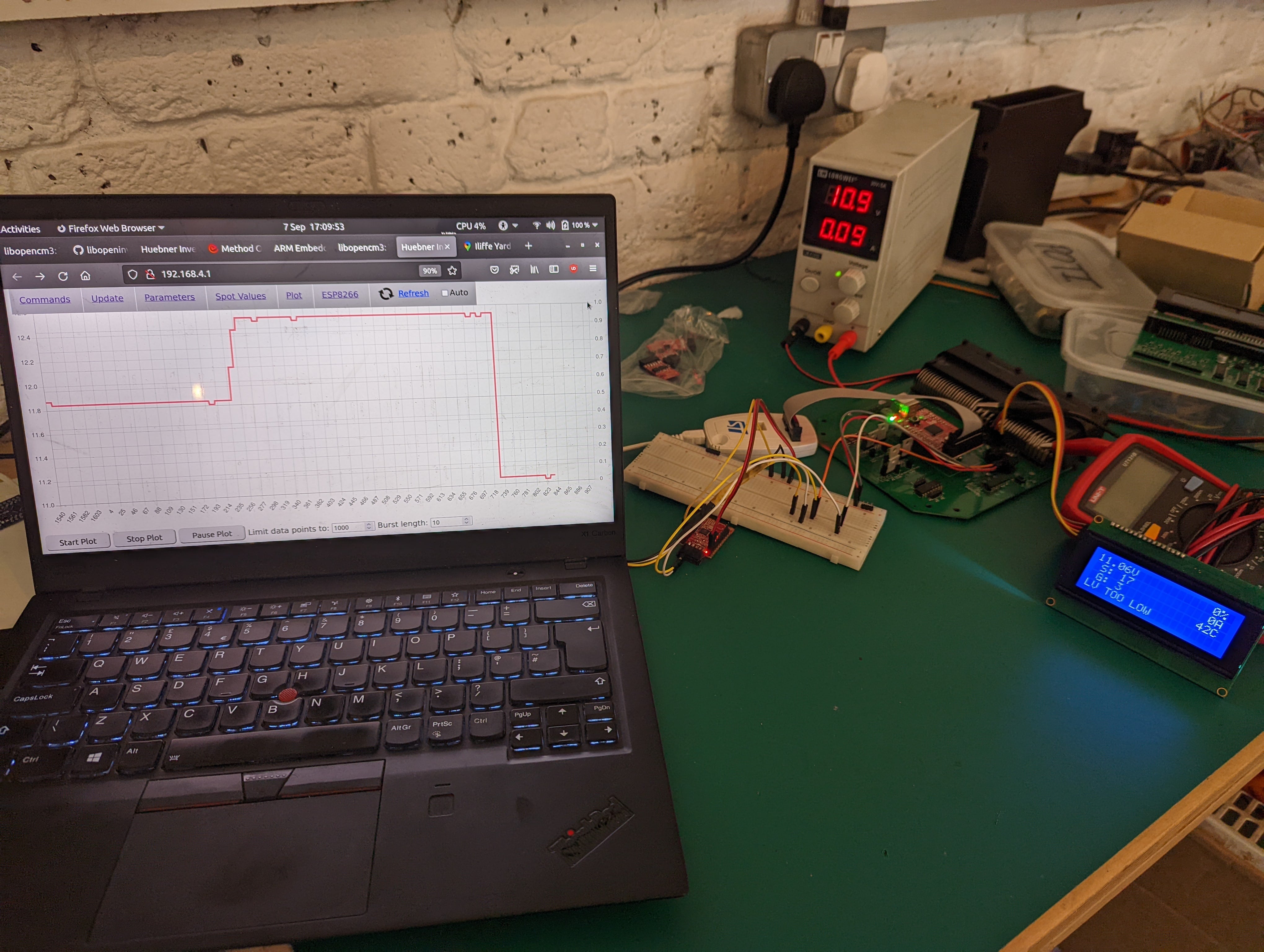

Right, what I tried to do here was add an I2C display and have it updated in main(){ while(1){}}.
Unfortunately adding I/O like that messes up the timings for Terminal::Run(), destroying plotting functionality and web interface.

if you have a free timer left you can instantiate another scheduler that runs at lower priority. Priorities are set in nvic_setup(), the higher the number, the lower the priority.
Otherwise check whether you can DMA your i2c code, that will make it latency free

Yes! I think it works with the second scheduler, thanks.
Had to:
- create a second scheduler using TIM3
- bump the priority for CAN_TX, CAN_RX and Ms{10,100,500}Task in libopeninv
- put a pointer to the Terminal on the stack
The variable is being plotted in the web interface and at the same time the I2C display is being updated. Marvelous indeed.
I tried calling tp->run() every 0.5ms (changed the 100 in Stm32Scheduler::AddTask to a variable, and thought I could make it faster, but that made the connection worse instead of better, calling it every 1ms seems to be rock solid so far.
I will check tomorrow if I broke CAN, if I can run all three at the same time then I am happy. Let's see!
Edit: CAN works too

It works in a car, you see e.g. 60A for regen, -100A when pressing throttle harder, 90A when ChaDeMo etc.
Just adding to 500ms made the display work, but it destroyed the web interface, hence having to add a second scheduler to be able to interrupt it, the code is blocking, so in 500ms it would also block important CAN messages etc. because 500ms runs at the same priority as 10ms
