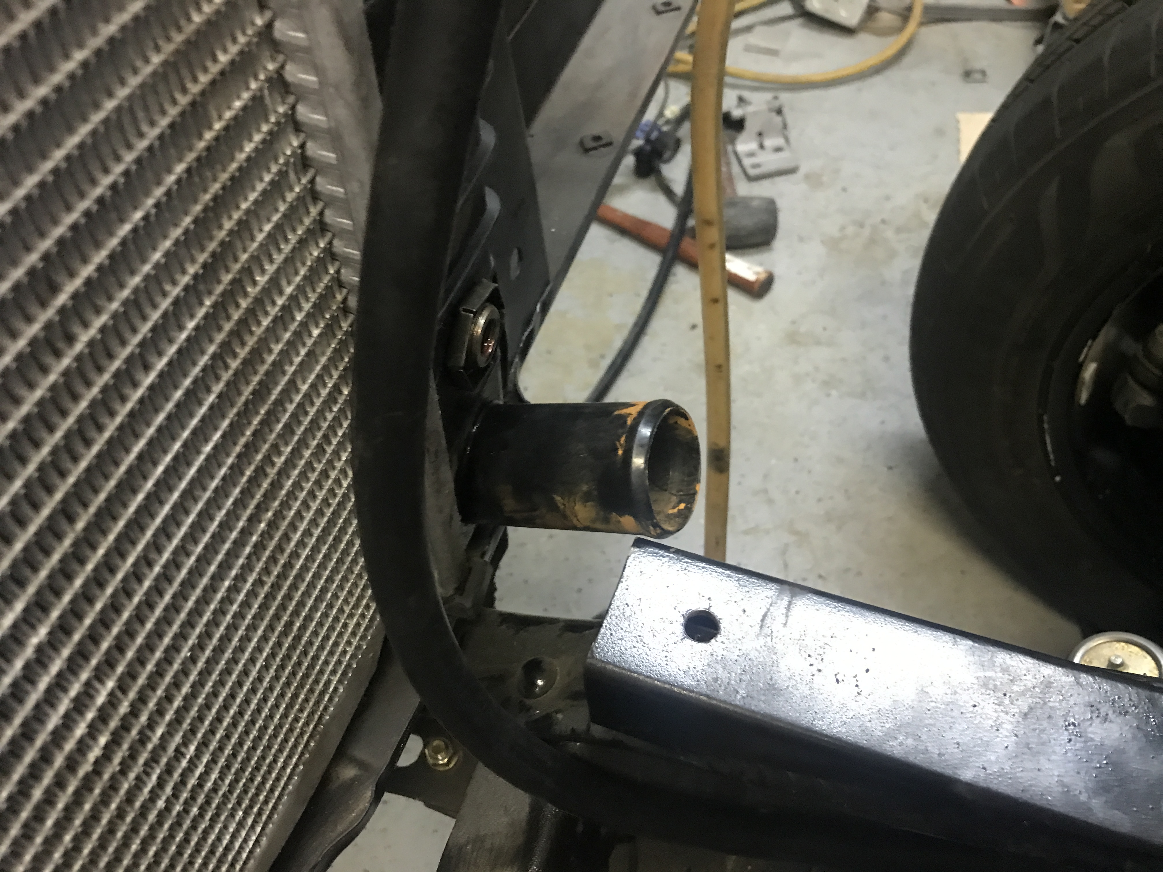

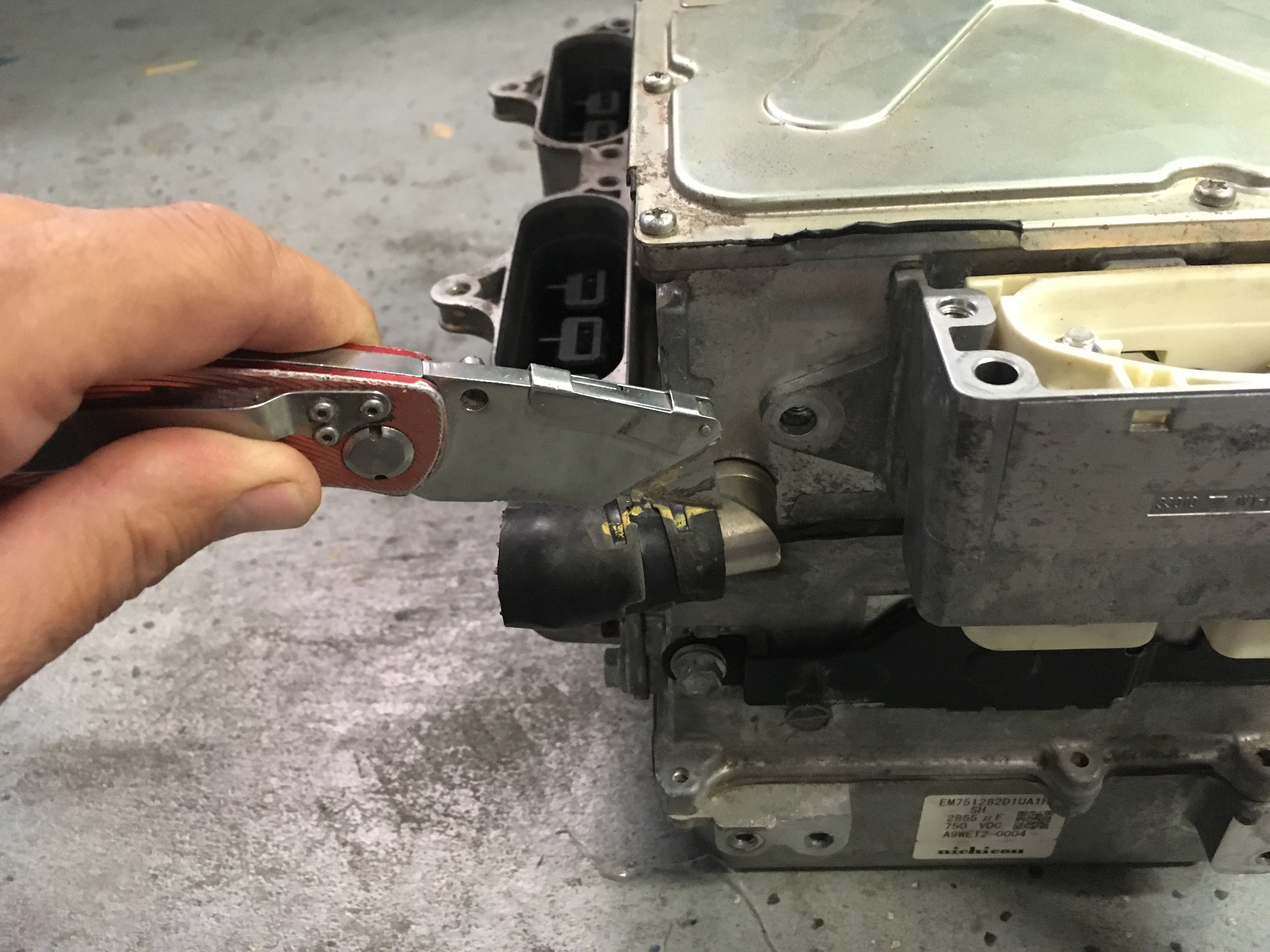

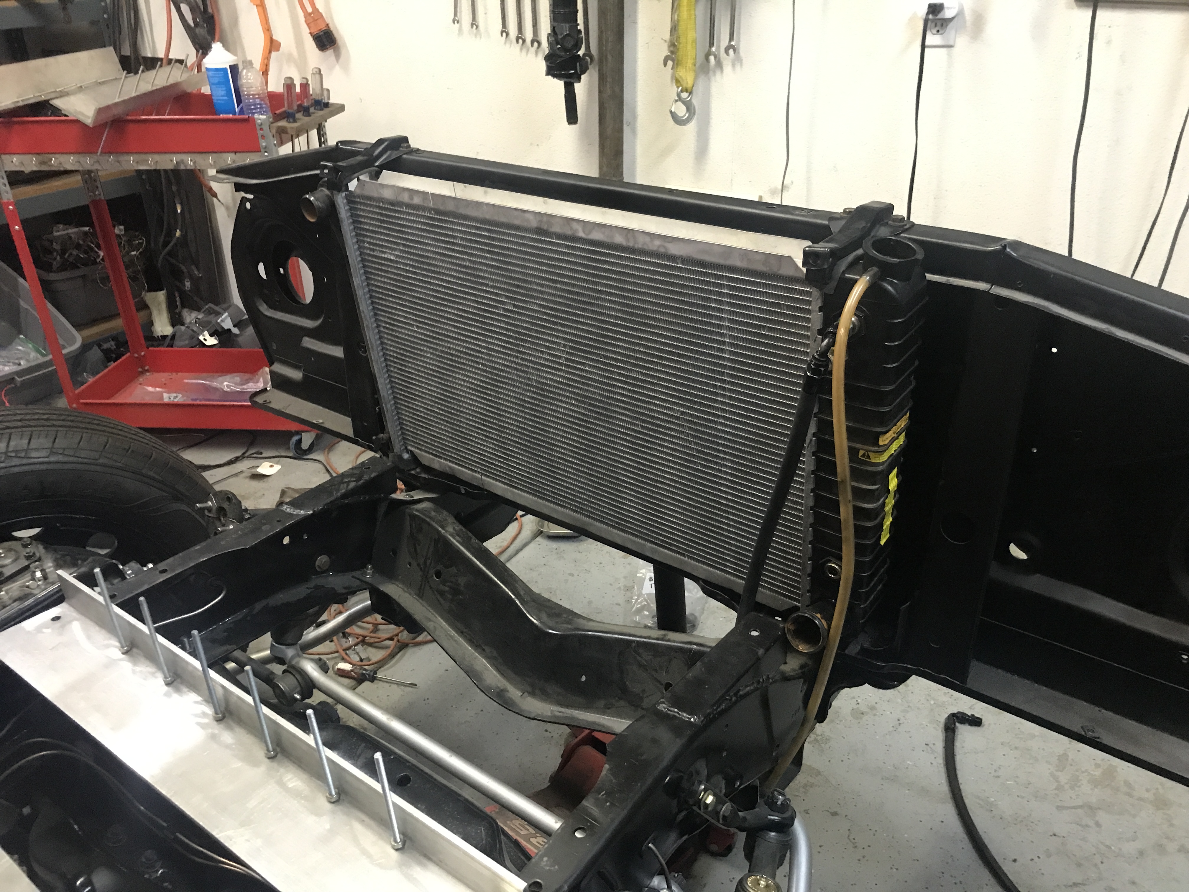

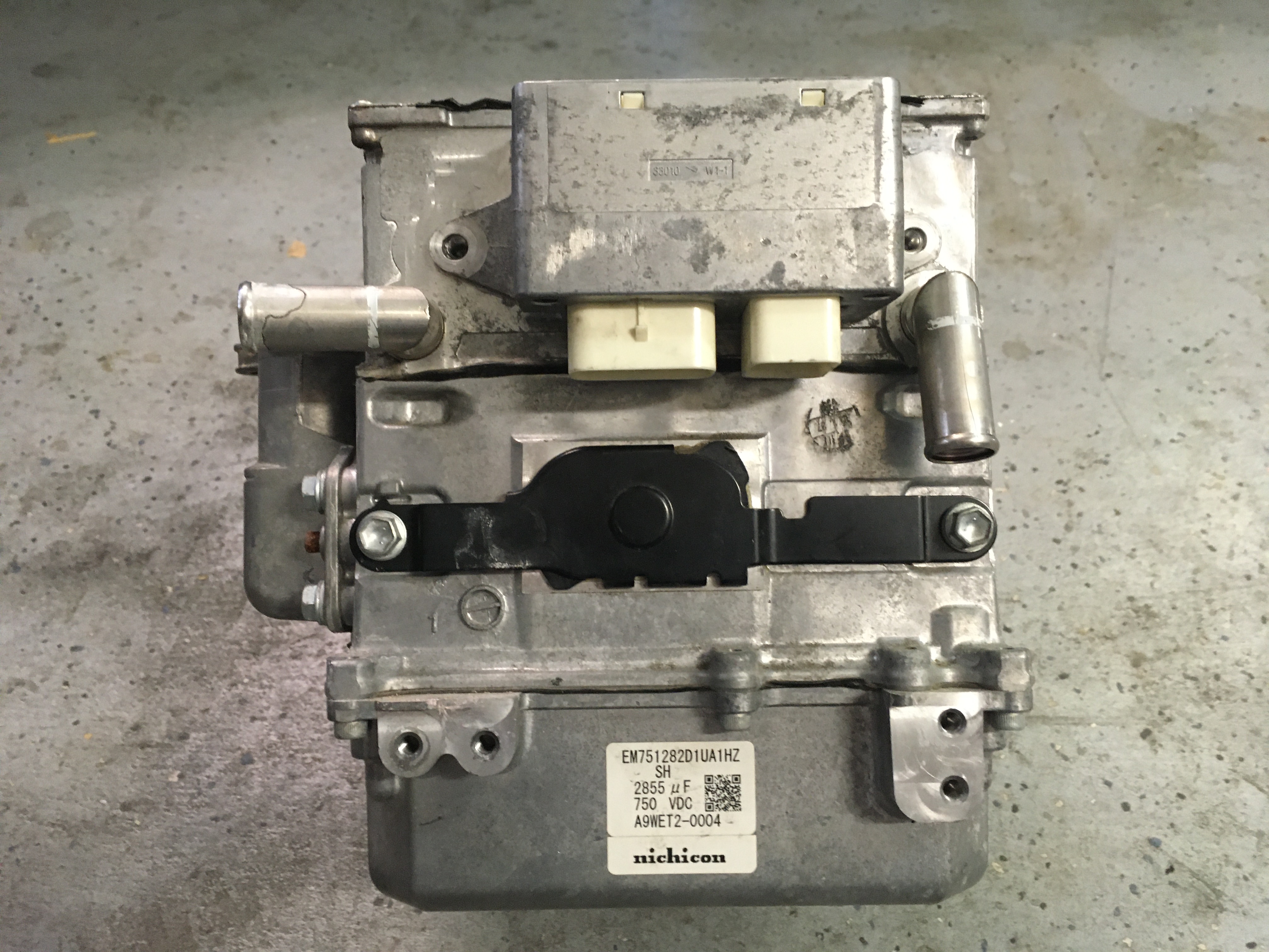

My American muscle brother, I plan on doing the same with my 1971 GMC and was wondering if you found any radiator inlet outlet reducer hoses, I think from what I measured the 'merican radiators are 1.5" and the coolant tubes on the Inverter appear to be 3/4" correct me if I am wrong
and now... more about me:
1971 Chevrolet C10 1/2 ton truck radiator
pretty standard 1 1/2" American radiator inlet / outlet
Top Tip: cut stubborn hosers length wise and split them open to liberate them from stuck on parts

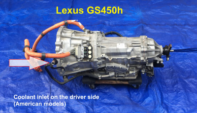

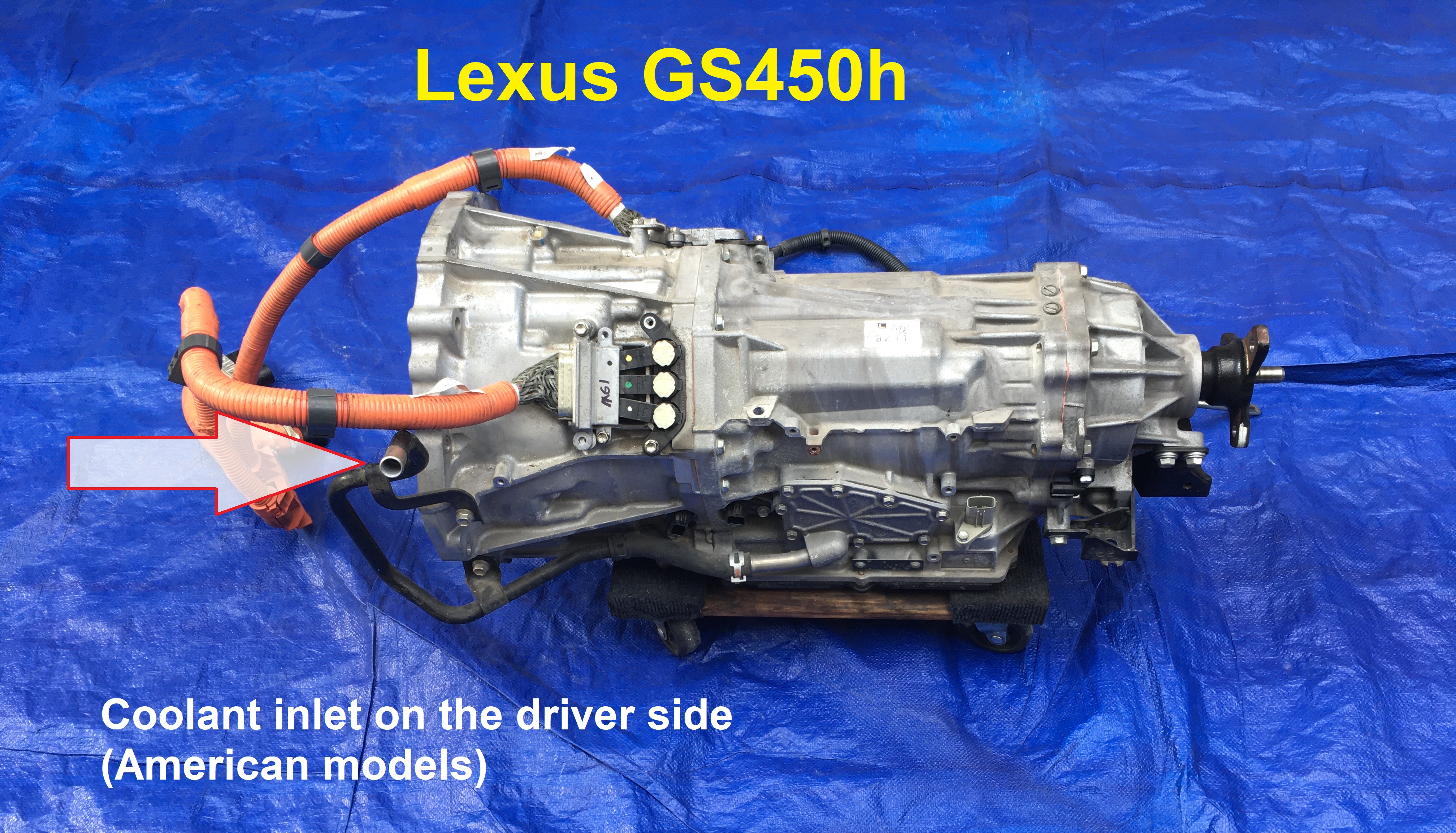

Lexus GS450h inverter

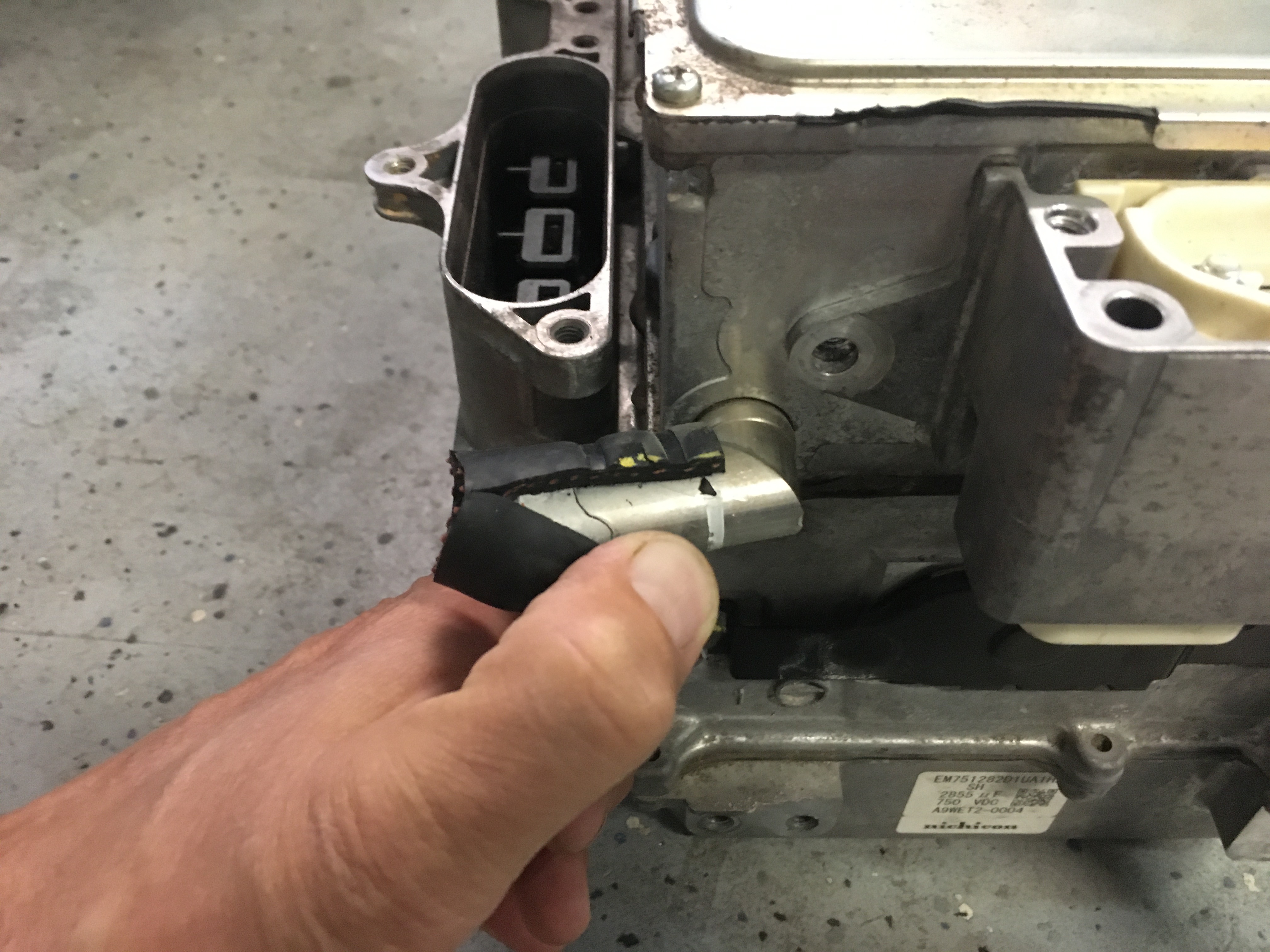

just some pics to visualize the setup

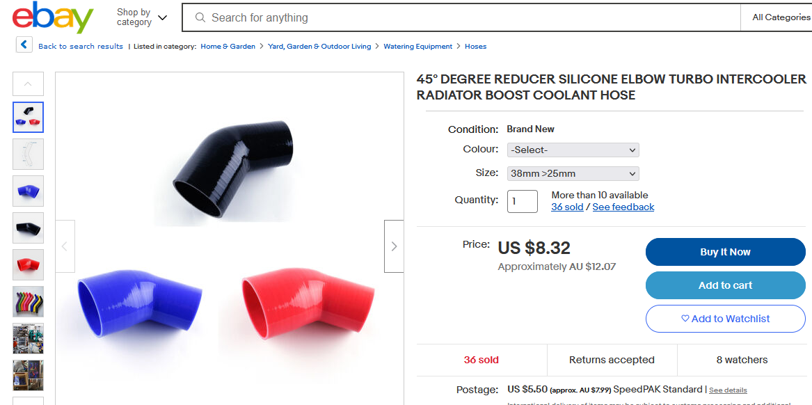

This ebay site may help you Gregski:
