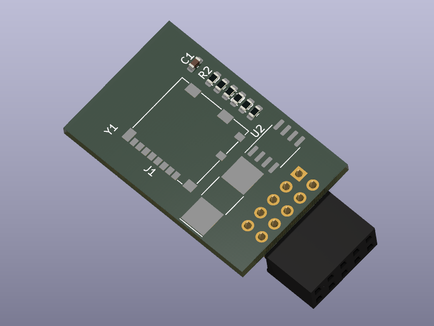

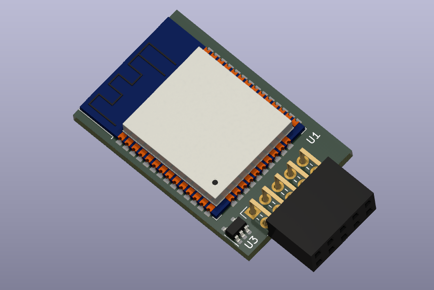

Been having a think about this too, just for fun I threw a few components onto a PCB to see what might be possible:
That's a PCB of around 0.8" by 1.3" (plus the IDC connector) with a ESP32-WROOM-32D on one side and a micro SD socket and a real time clock on the back. All looks possible, still a fair bit of work to turn it into something real though.
On the firmware Johannes terminal implementation is nicely done and uses double buffered DMA for the transfers so using uart_send might actually slow things down (especially once you allow for waiting for the Tx register to empty)! The existing PutChar function should do the job. The standard 921600baud would allow around 10bytes per run of the control loop which is not really enough. If we could double the baud rate then 10x 16-bit words would be possible. 1 or 2 would need to be used for a unique(ish) header leaving around 8x 16bit words, say i1, i2, angle, id, iq, pwm0-2? It would be nice to have a few more but that means either pushing the baud rate even higher (probably unrealistic) or only sending data every other run of the control loop. The later may be a better compromise.
Edit - PutChar won't quite work, it reserves '/n' to trigger a buffer transmit which we don't want (can't guarantee that a '/n' won't occur in the middle of the binary data) so would need a tweaked version of it that only started a new DMA when the buffer was full. And if doing that may as well optimise it for accepting binary data too.
Could do with figuring out how many people might want to use high speed logging?
