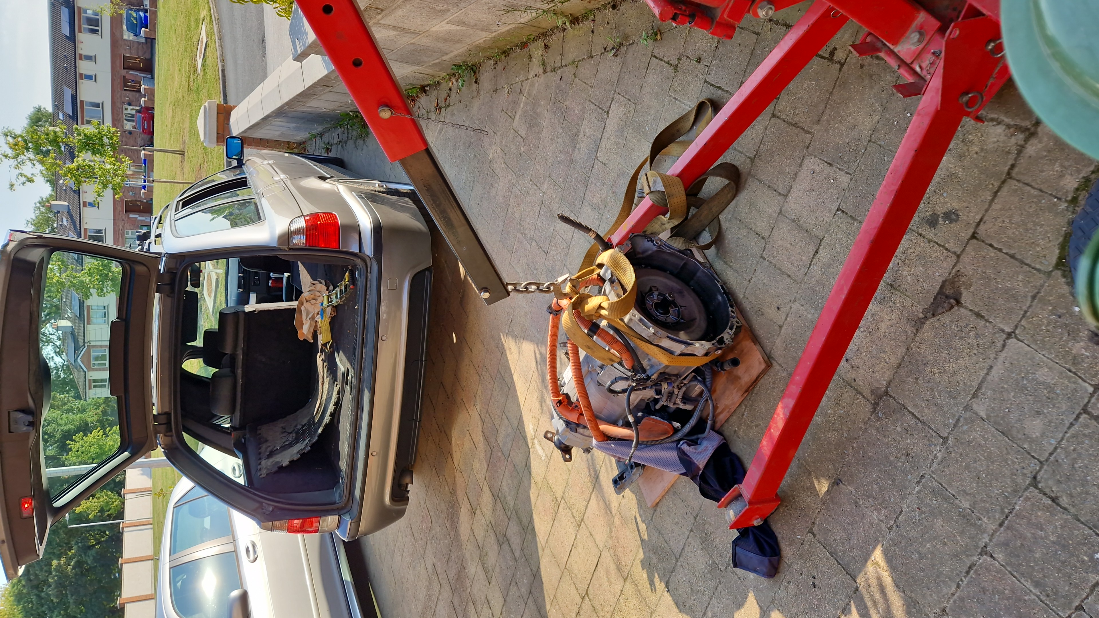

I've acquired the 450h box/motors ( thanks Jack Bauer )
I'm not jumping on a battery for now as I want to get the drivetrain running outside the car first.
I think that at least the main 24 modules of the battery will fit in the engine bay, perhaps in 2 banks of 12. I think that probably another 12 could go in there also without affecting weight.
And then 6 each side in place of the rear fuel tanks. That will not be day 1.
