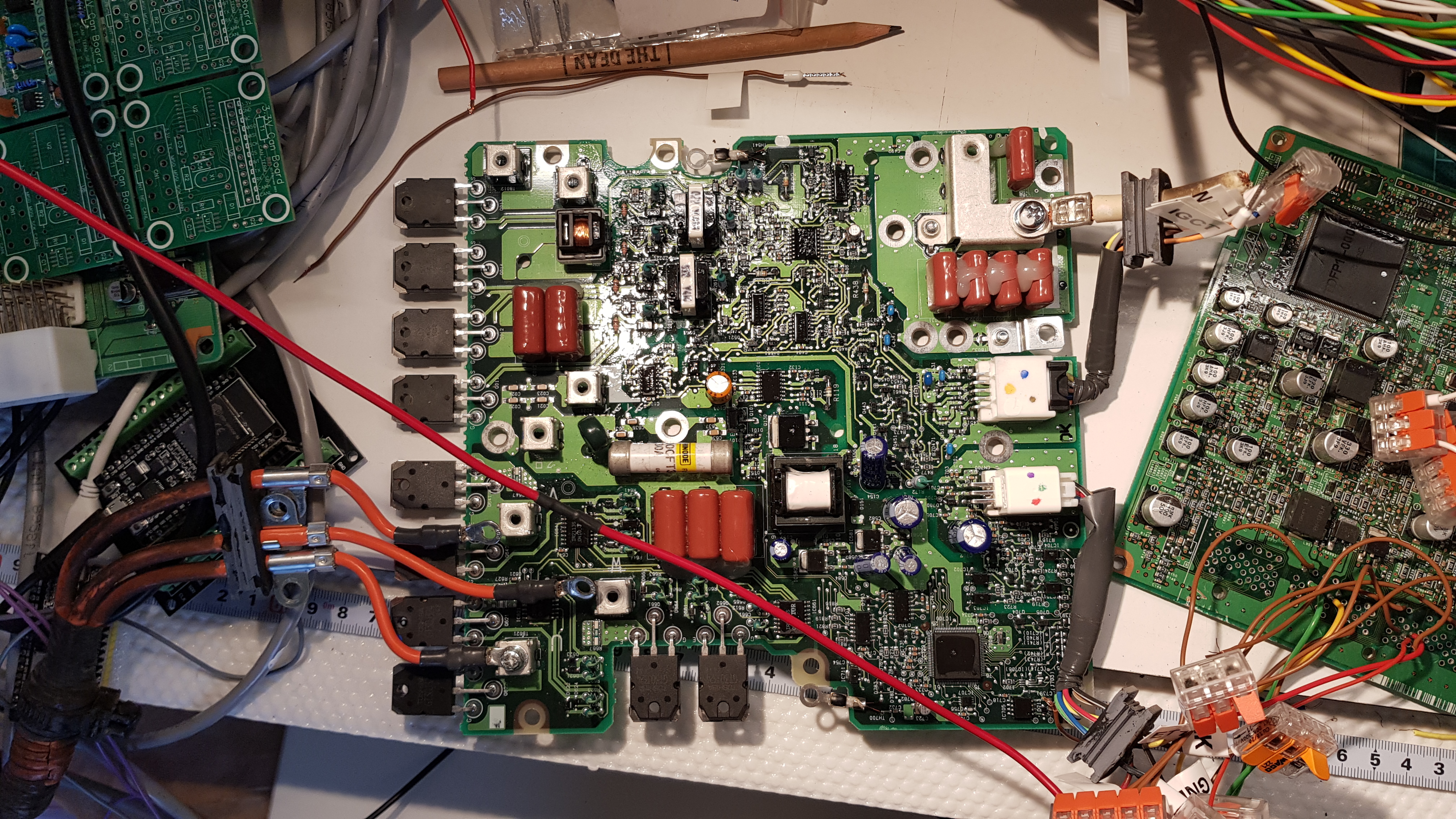

sure! i can confirm the gen2 a/c compressor is just a 3 wire connection from the bottom half of the inverter.
I will look for and document signals.
if anyone has a specific area of interest, it will speed up the process so I dont have to start from scratch with the schematics.
and I have a new siglent scope im eager to use
should we move that discussion somewhere ?... just give me direction

So to start out the pin mapping of the grey 6-pin LV connector of the A/C inverter needs to be researched. Apparently it runs some sort of serial protocol. In a second step that would need to be recorded with a protocol analyzer at various operational states. Most obviously A/C on and off.
The connector is on the same side as the DC/DC control connector and located below MG2 power output

Link to prius wire diagram:
https://priuschat.com/attachments/prius ... pdf.33780/
See page 350
Connector:
I11(C)
(I11 Inverter 90980–10988)
1C GND
2C ITE/TOECU
3C ETI/TOINV
4C CLK
5C STB
6C IG

Is any meaning known? Sounds like 2C/3C is like MISO/MOSI style and 4C obviously the clock. But what are the other 2?
Re: Prius Gen2 A/C compressor inverter
Posted: Sun Aug 14, 2022 1:36 pm
by turnip73
IG 6C 12 when ignition is on
STB 5C 12/14v while inverter is starting up then drops to ~1.5v. Didn't seem to change when a/c was turned on. I'll verify when my pack is changed.

Cool, thanks. So these seem to be pretty static leaving only pins 2,3,4 to be connected to a logic analyzer, perhaps in SPI mode.

I'm trying to figure out how make the gates stay permanently low so we can use the A/C compressor inverter as a rectifier without modifications see johu comment here:
viewtopic.php?f=14&p=61039#p61039
johu wrote: Tue Sep 05, 2023 7:30 am - Removed 4 IGBTs of the A/C inverter and replaced them with a bridge rectifier (maybe making sure the gates are permanently low achieves the same)
I've taken an A/C compressor inverter card out of an inverter.
1) If I connect IG to 12V and GND to GND on the A/C compressor inverter card it draws no current.
2) If I feed the HV ECU and A/C compressor inverter card 12V (IG) the HV ECU sets ETI, CLK and STB to 12V. ITE stay 0V.
3) If I connect IG to 12V and STB and GND to GND on the A/C compressor inverter card it draws some current (0.01A).
I've been measuring the legs of the gates for changes... not sure exactly what to expect or look for to show that gates are low

Conncted an ardunio nano with software from xp677 on the Denzo ES27C thread viewtopic.php?p=2744#p2744 Edited the software to send all the messages and now the A/C inverter is drawing 0.01 then 0.02 then 0.03 A.
void loop()
  transferpacket(1);
  serialdiag(1);
transferpacket(2);
  serialdiag(2);
transferpacket(2);
  serialdiag(2);
transferpacket(3);
  serialdiag(3);
STB is connected to ground
From the Denzo ES27C thread seems I now need to connect high voltage to get the inverter to wake up.

Using a logical analyser and sigrok I've captured:
2C ITE/TOECU (D0)
3C ETI/TOINV (D2)
4C CLK (D1)
5C STB (D3)
Turned ignition on, turned a/c on, off and then ignition off.
See attachments
I will test sending messages back to inverter using xp677 software and hardware solution from Denso thread.

No luck testing in the car. I tried with both msb and lsb from captures... Any ideas?
