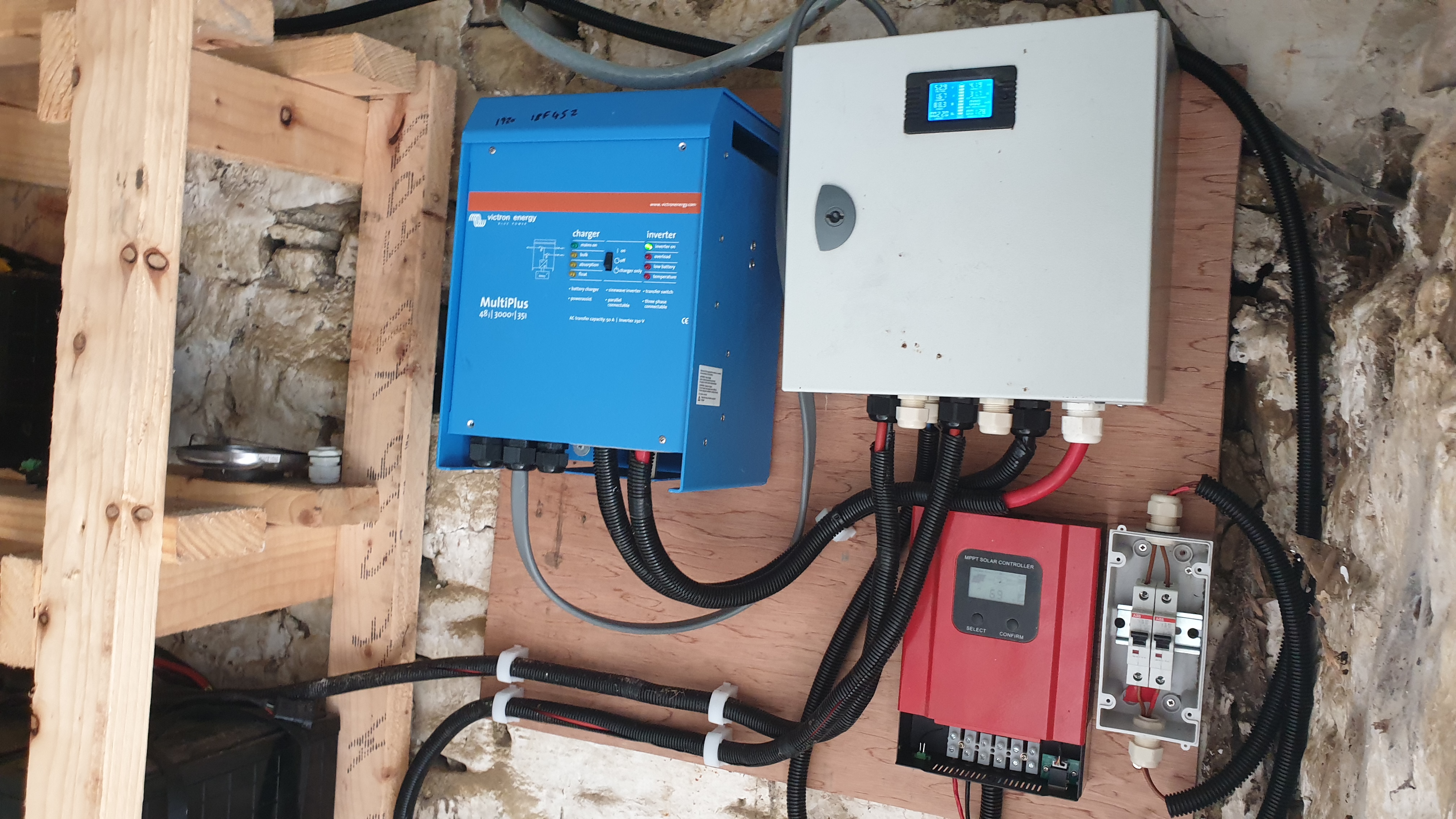

Yesterday we went on a road trip to collect 10 x 250w solar panels kindly donated by a forum member bringing my collection of panels to 19 (approx 5.5kw) and thus the start of my gradual off grid home project. Initially, power from these panels will be stored in 8 x Valance 130ah lifepo4 batteries in a 48v configuration to drive a Victron 3kw inverter.
But that's all a bit small and boring to the plan is to build a DIY 15kw 3 phase inverter and tie in my 3 cars for use as energy storage when not in use. This project will focus on low cost, upcycling and DIY so should be reachable by many. And of course opensource and ripping off as much of Johannes's work as possible so I can look sexy, make big $$$ and retire to Lanzarote.

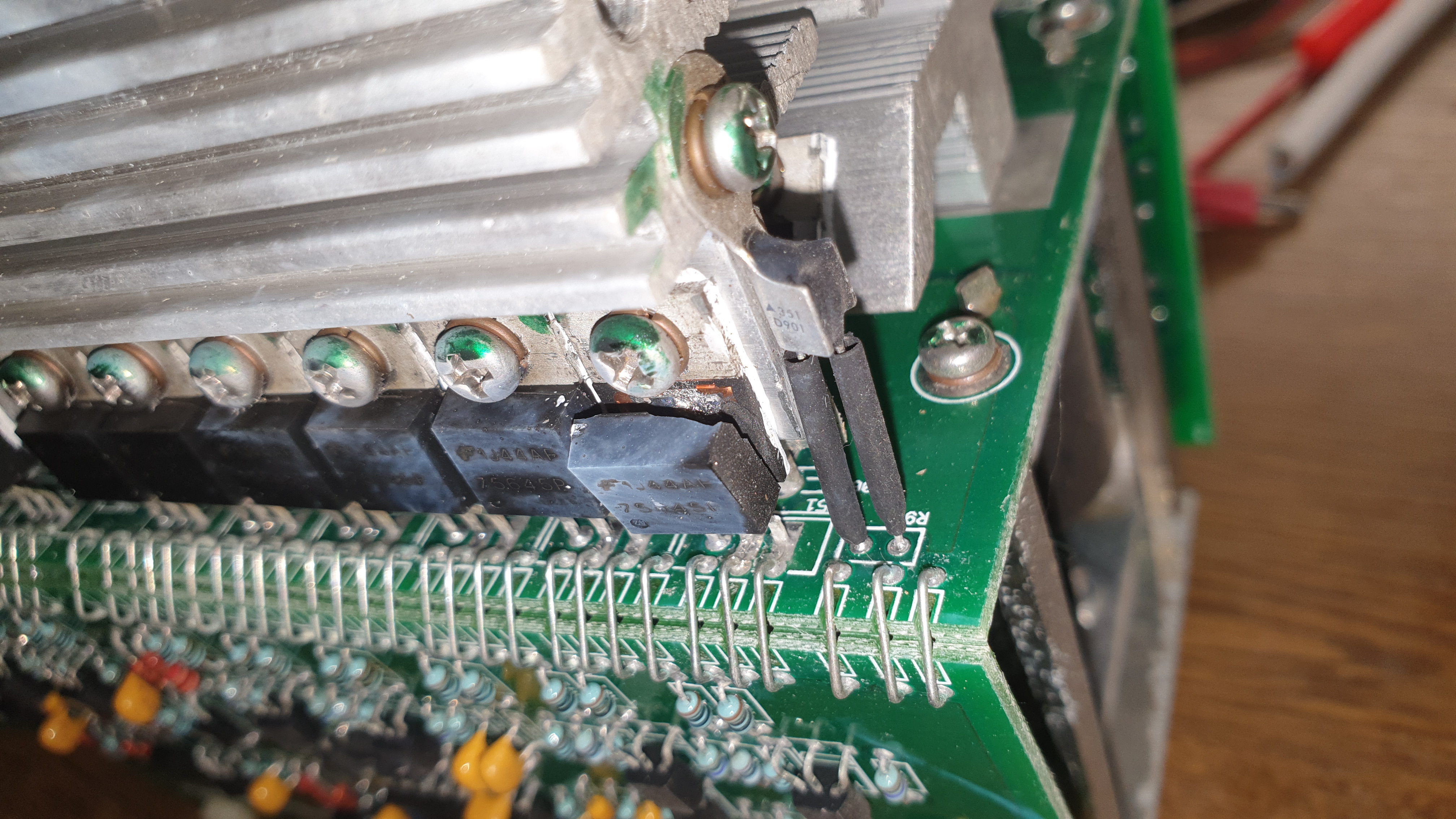

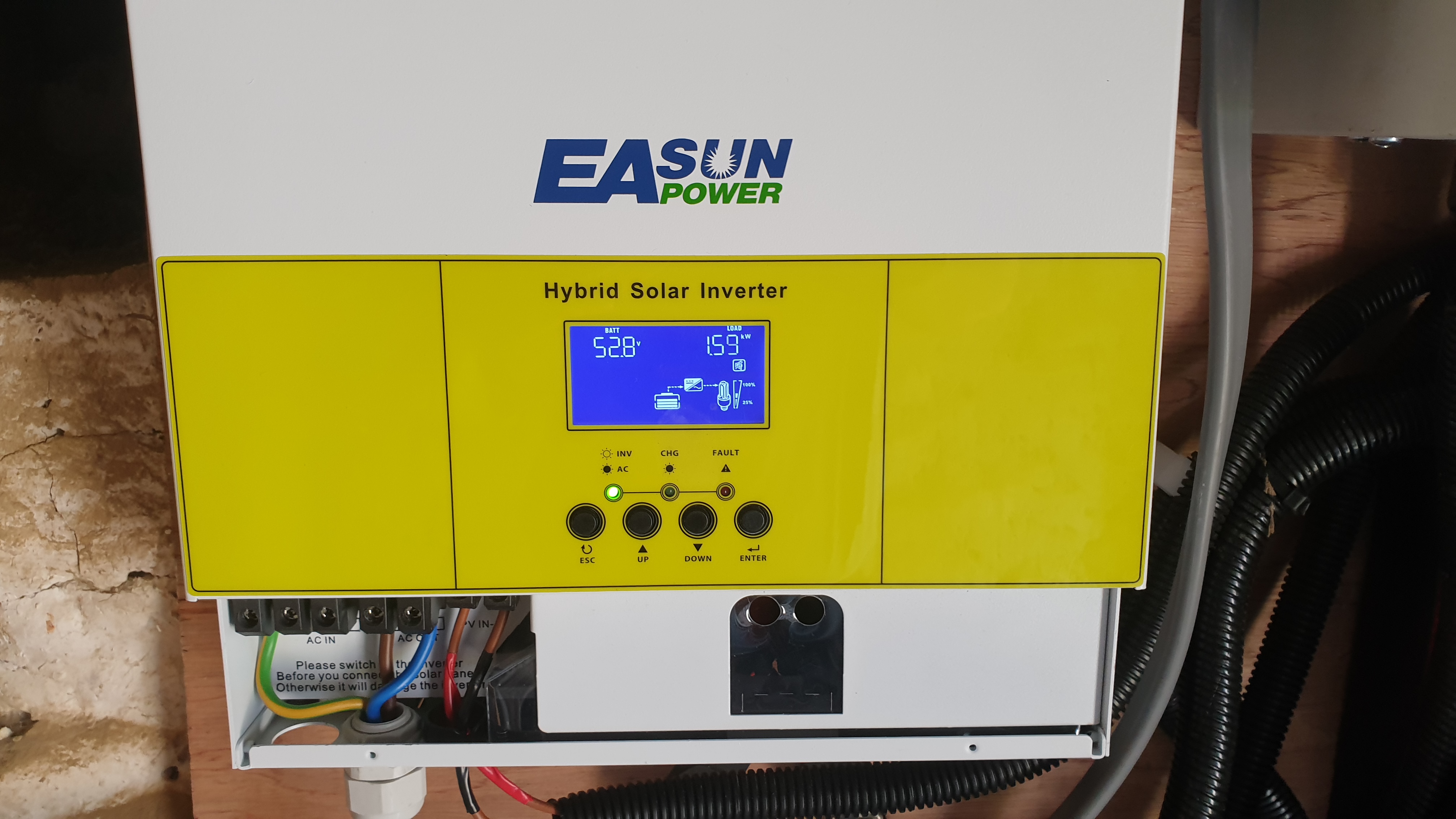

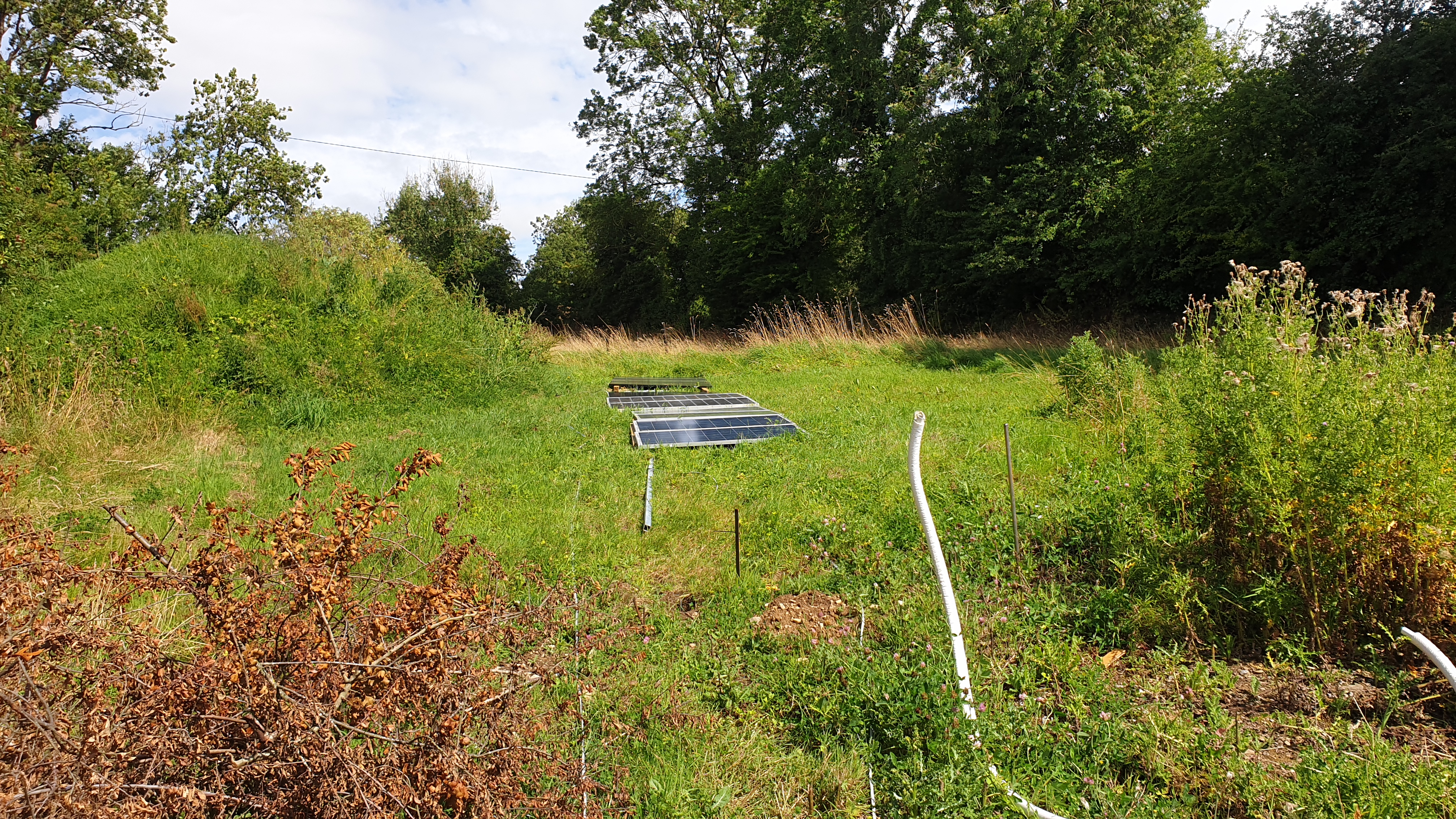

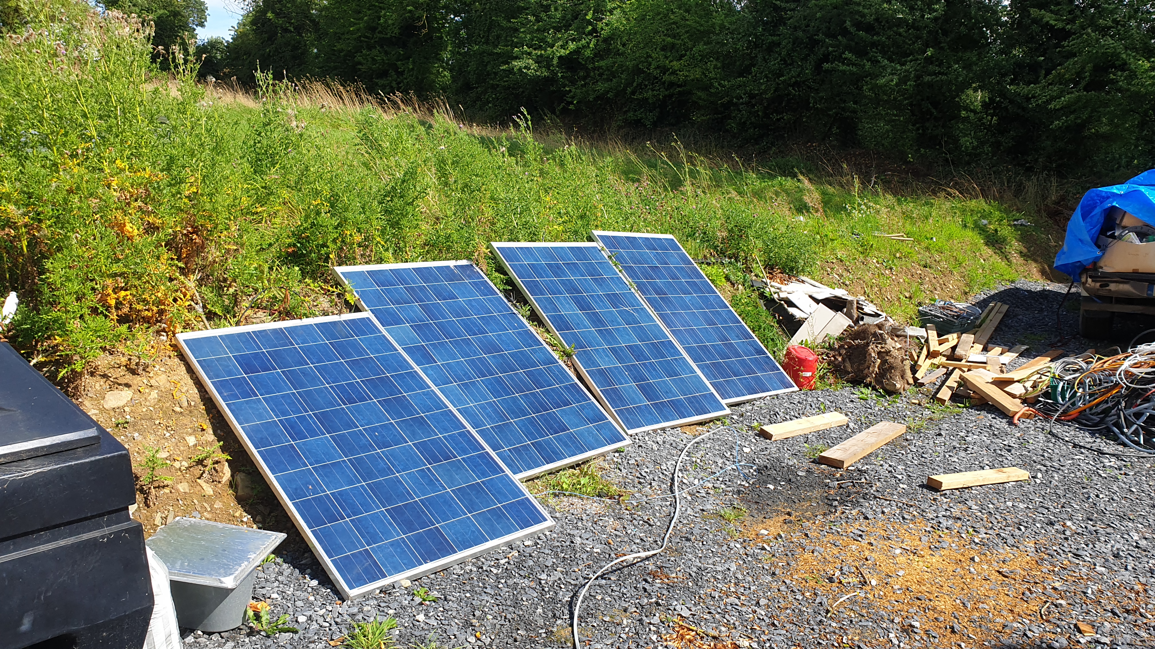

Time for a little update. The victron decided to blow one mosfet leg about a week ago. Ordered replacements from Ali. In the meantime I got lucky and picked up this "Easun" 5.5kw hybrid inverter second hand locally. Literally just threw some panels down in the field and have been running off grid since. Charged the goose today totally from solar as there was nowhere else for the energy to go as the house battery was full
Very impressed with this cheap little inverter. Also running 2 x 600 soladin grid tie inverters into the "local grid" created by the easun. It detects the gtis trying to raise the ac voltage and pumps it back into the batteries if there is not enough demand from loads. The solar thermal is heating the water to between 40 and 50c everyday as a bonus.
