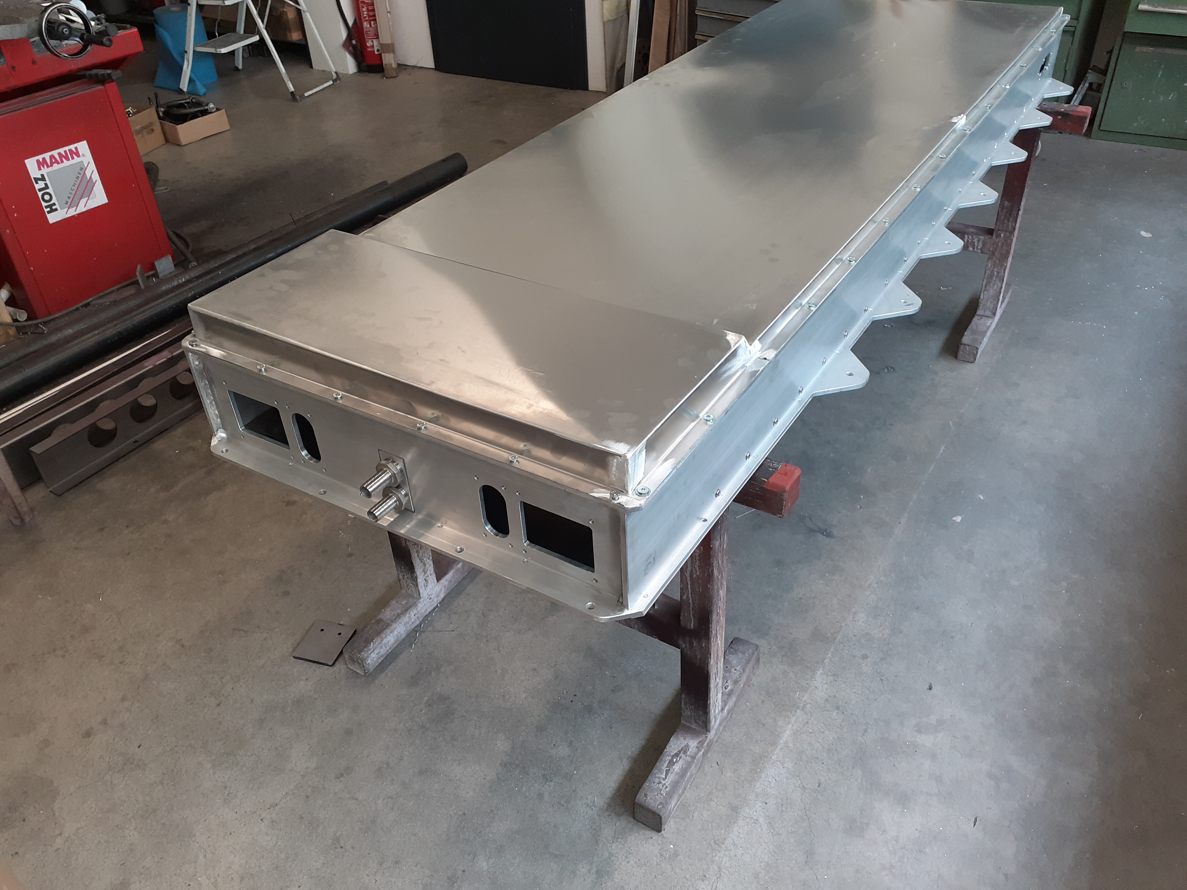

In addition to the right cable sizes and fuses, I think a mechanically stable structure is very important. My box is welded from aluminum profile and has a tin cover at the top (1mm) and bottom (2mm). The inside is lined with 1mm polycarbonate panels. The fuse and the cable connections can be reached by extra covers. Inside, all connections are insulated with caps.
In my case, the box is on the underside of the car and is therefore exposed to moisture and mechanical hazards.

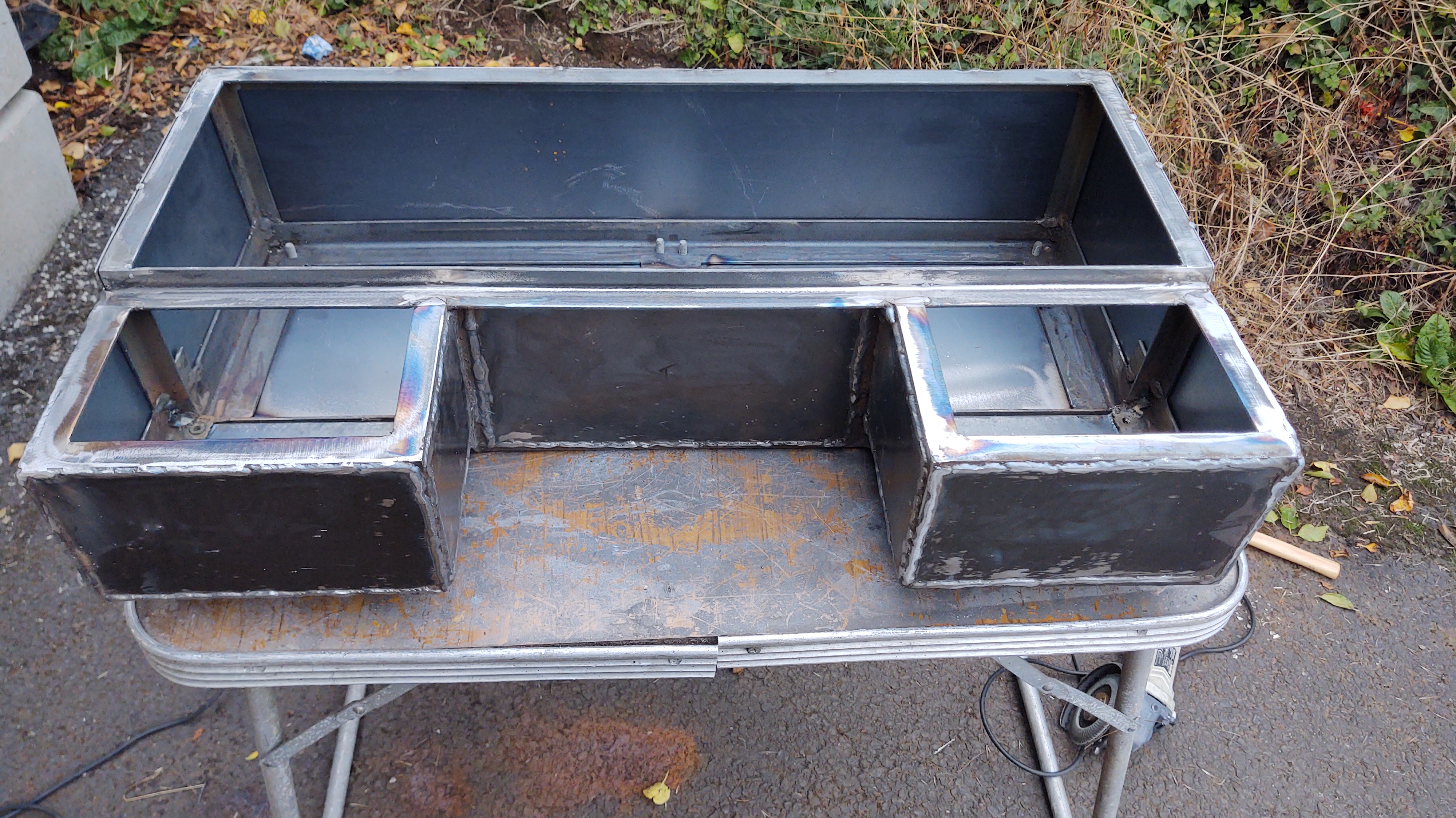

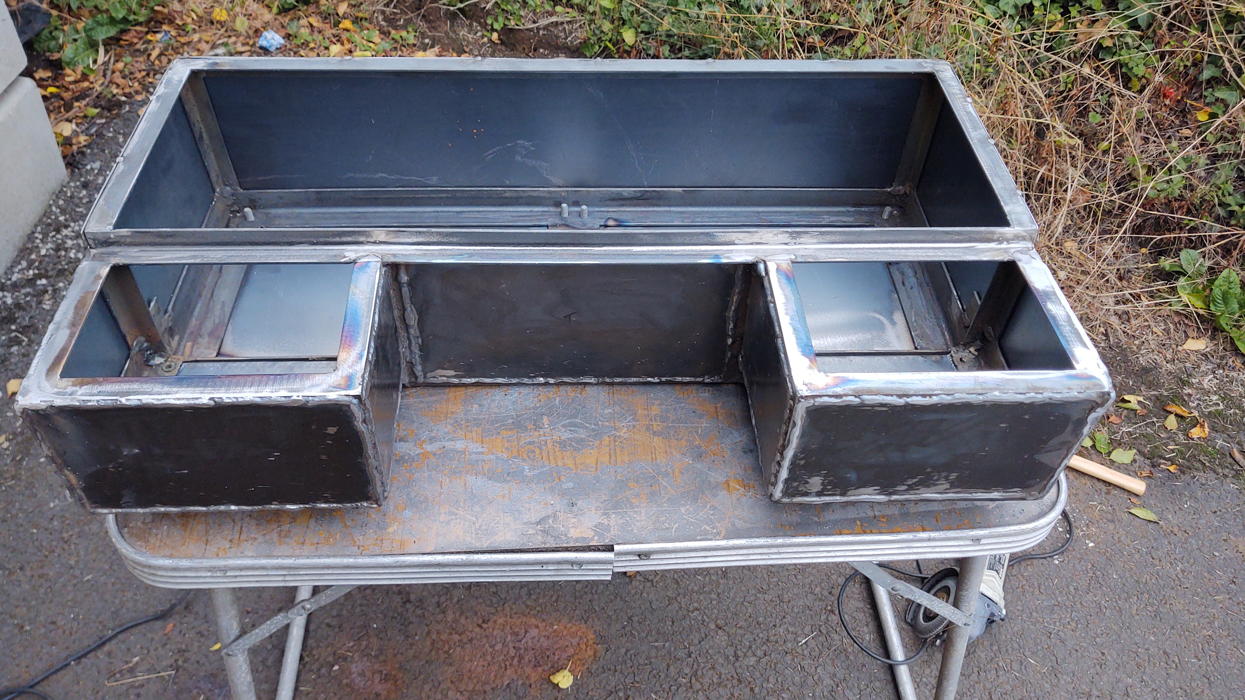

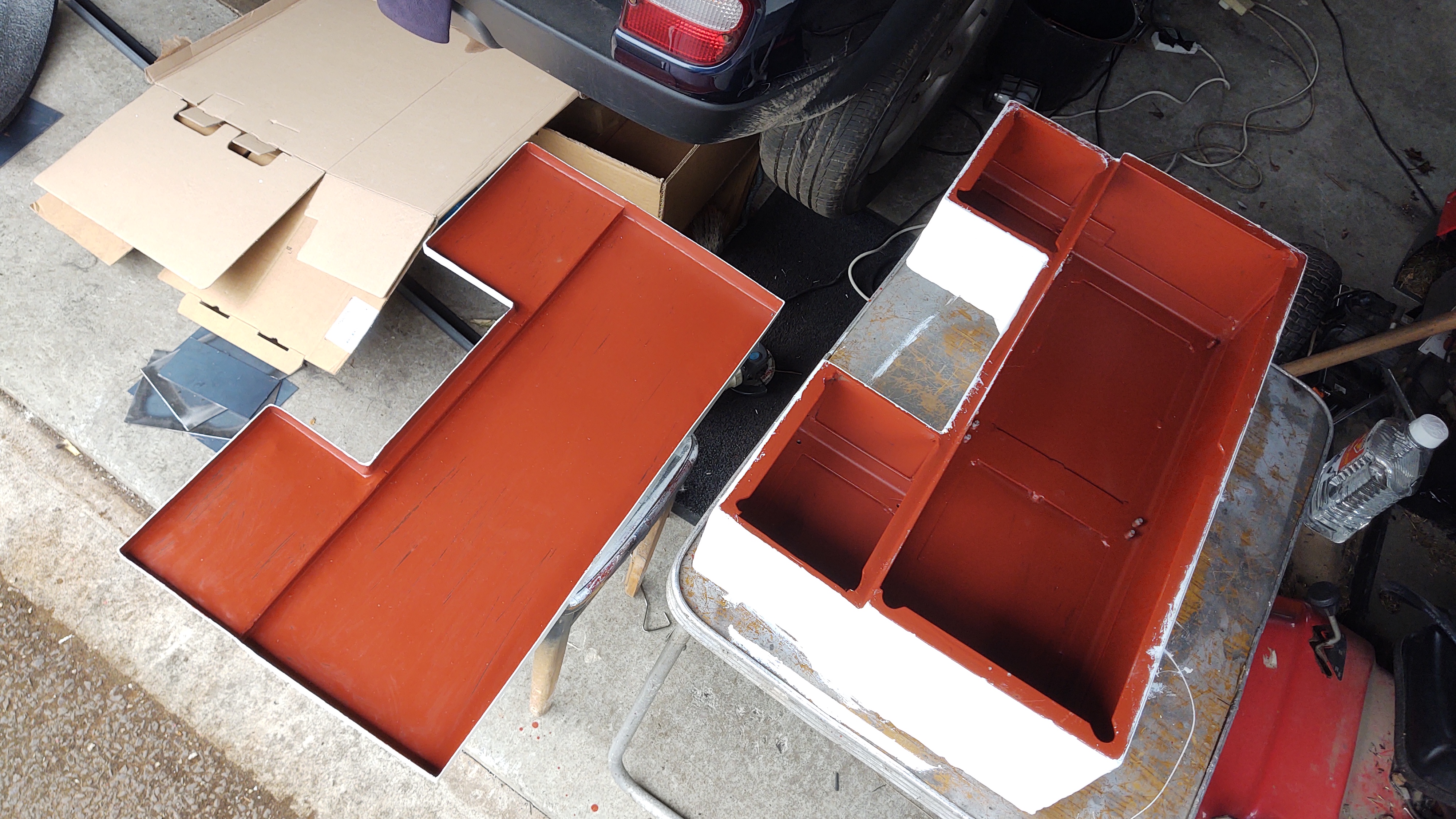

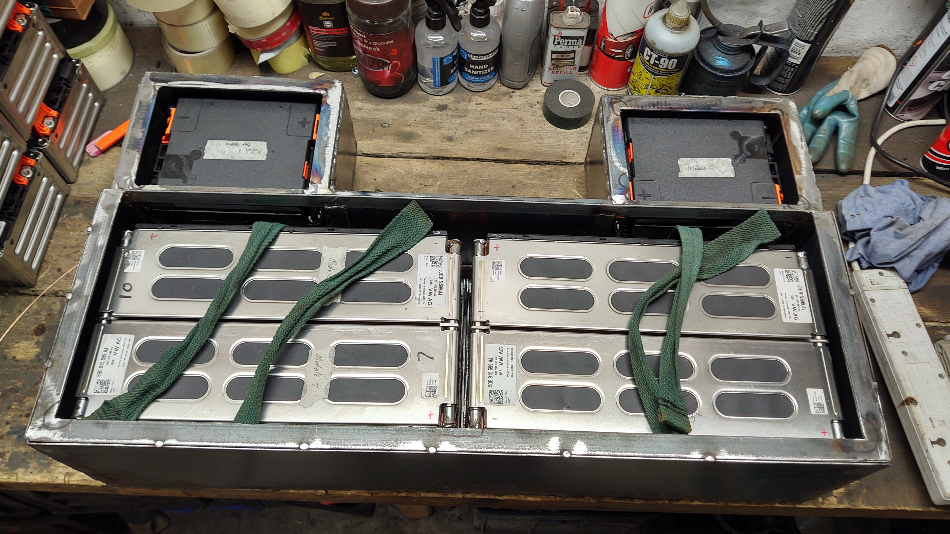

That's a very nice looking box.
My first two are made from 3mm steel angle frame covered in 1.6mm sheet. I haven't made the other two yet and may try to get the remainder of the modules in the boot to avoid having to make a fourth.
This is a box I made to go under the fuel tank but I didn't allow for fuses and/or contactor so this may need adjusted.
And this still has to have a lid made for the upper section but will hold six large modules under the bonnet I would like to have made mine with aluminium but don't have the welding skills unfortunately.
