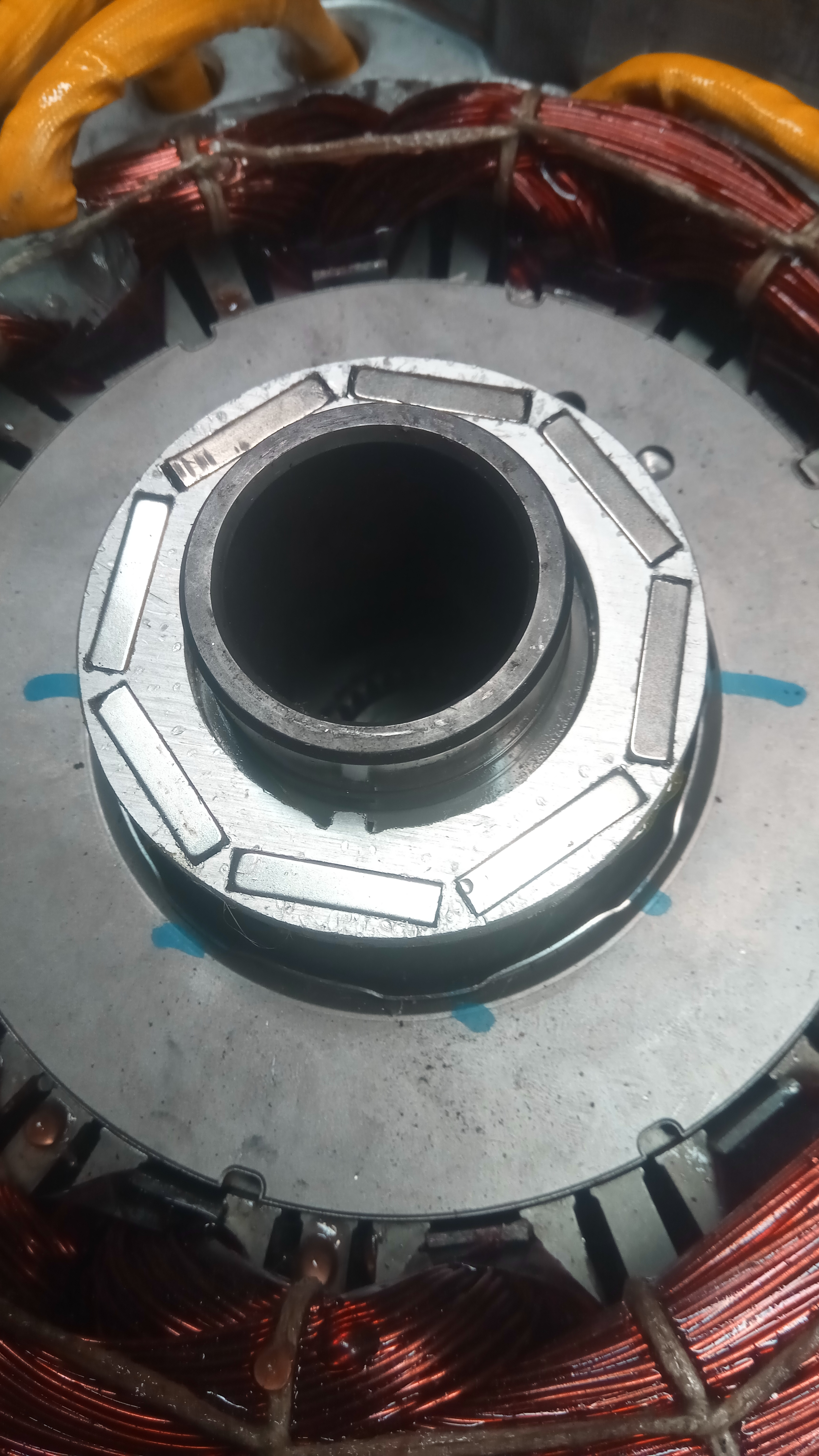

When this buggy started to be made from gasoline 800cc, I put there a prius gen2 mg2 motor rewound by 2 turns , modified by hall sensors and controlled by the kelly controller kls96600-8080h.
It drove like this and had two speeds:

Now I remembered about it, I installed a Nissan leaf motor + em57 gen2 inverter + Johannes board version 3.
All this works temporarily on a 32S nmc catl battery 120ah and has a maximum speed of more than 100km/h,
But the damn unpredictable mega regen broke my drive (watch the video, it was scary)

How to disable the flux weakening completely?
It seems to me that this will eliminate regen without control.

You can set fwkp=0. It will result in less maximum speed
At the same time increase curkp to 55

johu wrote: Sun Jun 26, 2022 10:48 pm You can set fwkp=0. It will result in less maximum speed
I tried to set fwkp=0 and curkp=55, the flow attenuation did not turn off. the prius mg1 motor is gaining furious momentum on a 40 volt battery, although it should not exceed 1500 rpm.

eee291 wrote: Thu Aug 04, 2022 6:44 pm No more issues with regen?
they disappeared as soon as I raised the battery voltage three times ( 360 volts instead of 120 ) and limited the motor speed to 450 hertz. this gives 120 km/h by satellite.
