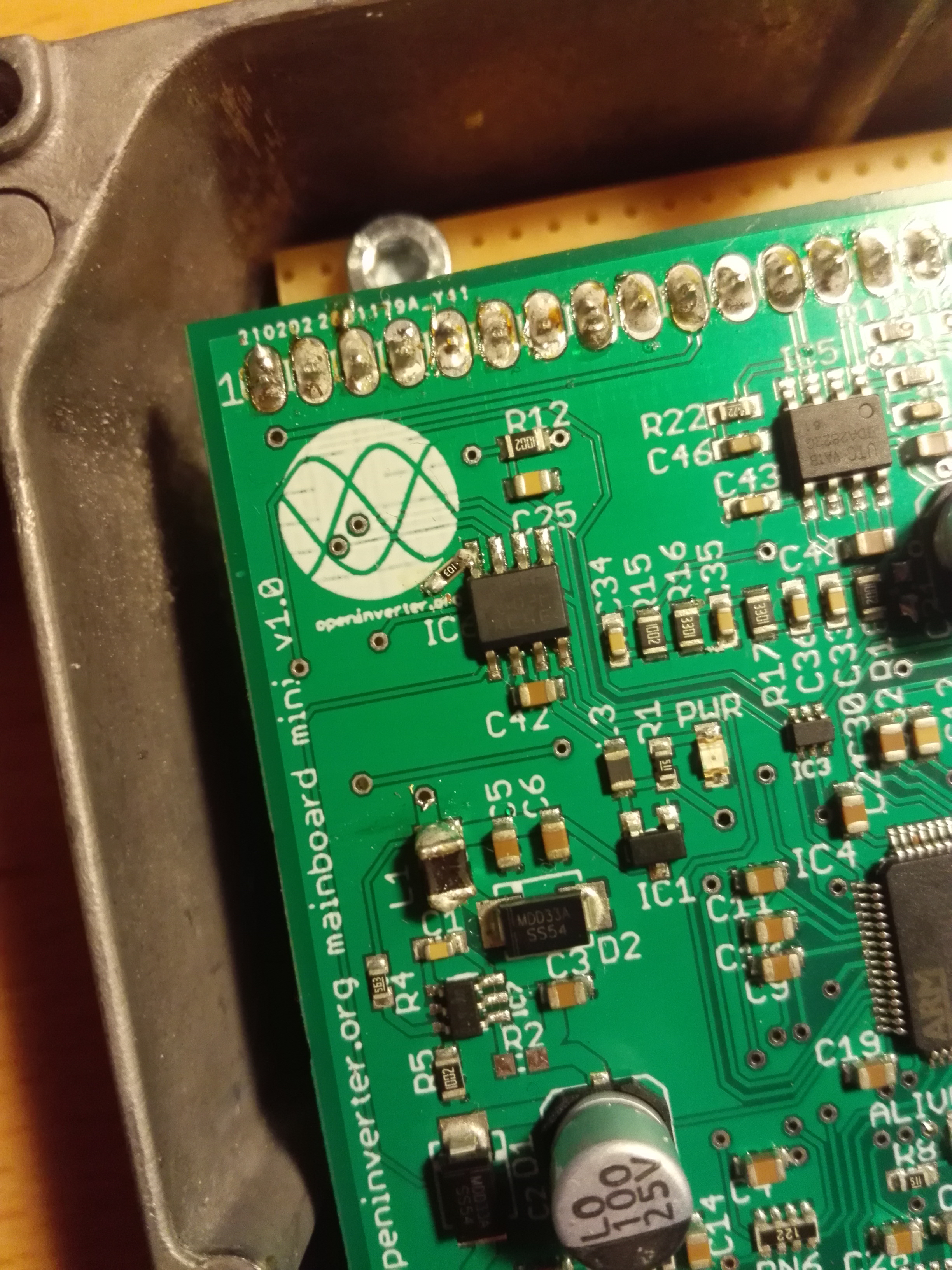

Lack of CAN communication new Nissan Leaf adapter board
Locked
Been thanked: 1914 times
I think there is an error on the mini mainboard resulting in lack of CAN communication. The slew rate pin is floating but needs to be tied to ground with a resistor. I scratched the GND plane a bit and soldered in a 10k resistor. Can be any value from like 0R to 20k whatever is in your parts bin (the value controls the slew rate)
