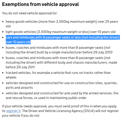

From here:catphish wrote: ↑Sun Sep 11, 2022 2:18 pm I informed the DVLA of my (2001) conversion 6 weeks ago. I finally got a response yesterday. It was essentially just asking for information I'd already provided. As expected, they are primarily just checking whether the chassis has been modified, and hence whether an IVA is required.
They've also asked for before and after photos of the vehicle, and confirmation of the chassis number. Nothing too onerous, but just another reminder to everyone: do not modify your chassis in any way!
I've send off the details they requested, so waiting again. I won't be expecting free tax, just making sure I do everything by the book.
https://www.gov.uk/vehicle-approval/exe ... e-approval
I was researching about 'if you modify the chassis you would need vehicle approval' can of worms - and noticed this list of vehicles EXEMPT from vehicle approval & it includes 10year + old cars!

Re: UK IVA Modifications
Very interesting, wonder what they will say if you send a copy with your application ?
They'll change the page and say that never stood there
Here's the Web Archive link, so at least THAT won't happen: https://web.archive.org/web/20221024140 ... e-approval
I looked into that already because on the face of it this seems like it solves our problem entirely. Unfortunately, it's been confirmed that this rule will only be applied to imported cars unmodified from their original form.SuperV8 wrote: ↑Mon Oct 24, 2022 12:54 pm From here:
Unless the rule actually says that then it would be hard for them to enforce it.
Unfortunately these "rules" found on the gov.uk site are not legislation, they're just a simplified version of the current policies.Scubascooby wrote: ↑Tue Oct 25, 2022 10:00 am Unless the rule actually says that then it would be hard for them to enforce it.
In their defense, I don't think it's reasonable to argue that one should be able to build a car, wait 10 years, then drive it on the road regardless of its construction.
It really is a shame that the regulations on modifications aren't more clearly defined in legislation.
