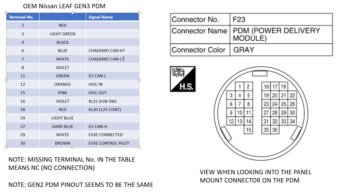

Being new to the site I thought I would first ask this question in this section because I may have missed the answer in the wealth of information in this forum.
Back in October last year Damien demonstrated the Leaf Gen 3 with the ZombieVerter VCU including charging with the PDM. Having looked through wiki and Github I believe it still says that only Gen 2 PDM is supported.
So does the ZombieVerter VCU support Gen PDM 3?
Does GEN 3 act the same as GEN 2, i.e. needs the same codes just different wiring to the plug?
Does ZombieVerter VCU still require updating to support GEN 3 PDM?
ZombieVerter VCU with Leaf GEN 3 PDM

Hello,
I have been testing and using the GEN2 PDM with the following pinout. I have the DCDC and charger running. I have not used fast charging so I am not sure about the signals needed for that. The Chademo CAN is easy to spot as it is with twisted pair wiring in the wiring loom.
The reason I am calling this the GEN3 PDM pinout is the fact that I checked the pinout and wiring colors from a GEN3 wiring loom and I have the GEN3 PDM waiting to go into my car.
If anybody knows the rest of the missing pins, I would be happy to receive the info.

Re: ZombieVerter VCU with Leaf GEN 3 PDM
I'm currently struggling to get ac charging to work using an stm32 zombie.. How do you get the zombie to switch to charging mode?Kelju wrote: ↑Sat Mar 19, 2022 1:32 pm Hello,
