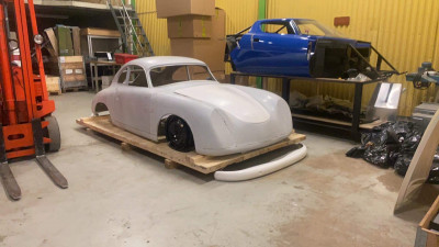

So the current status is:
Body aquired (frame for VW pan included, but will probably not be used)
Corvette C7 suspension aquired
Model 3 Battery Longrange aquired
2x Nissan leaf MY11 motors aquired
2x Chevy volt inverters aquired
Next week (cw11)
Making a 300V DC Link for the motors to test them on the bench (once I've made a new PCB)
We've been discussing at work if we should make a back-2-back rigg for the motors to be able to tune and test the capabilities of the chevy inverter. But it all comes down to how much "play time" we're allowed at work...
(Note the Lancia Stratos in the background, but that won't be an EV, will be running an Alfa V6)
