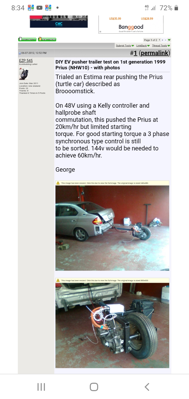

The other option is 2 Q211 motors in the front, double the torque and they are not so big...
Have locked differential in a Q111, a long time back, as was running as a pusher in an 1999 prius NHW10.

Have locked differential in a Q211, a long time back, as was running as a pusher in an 1999 Prius NHW10.
That solution is brilliant :)
For bigger power in the front use the Nissan Leaf setup.
Or 2 Q211 next to each other connected in the centre with the drive shafts and half the diff welded each side?
2 Q211's would keep the Inverter happy too.

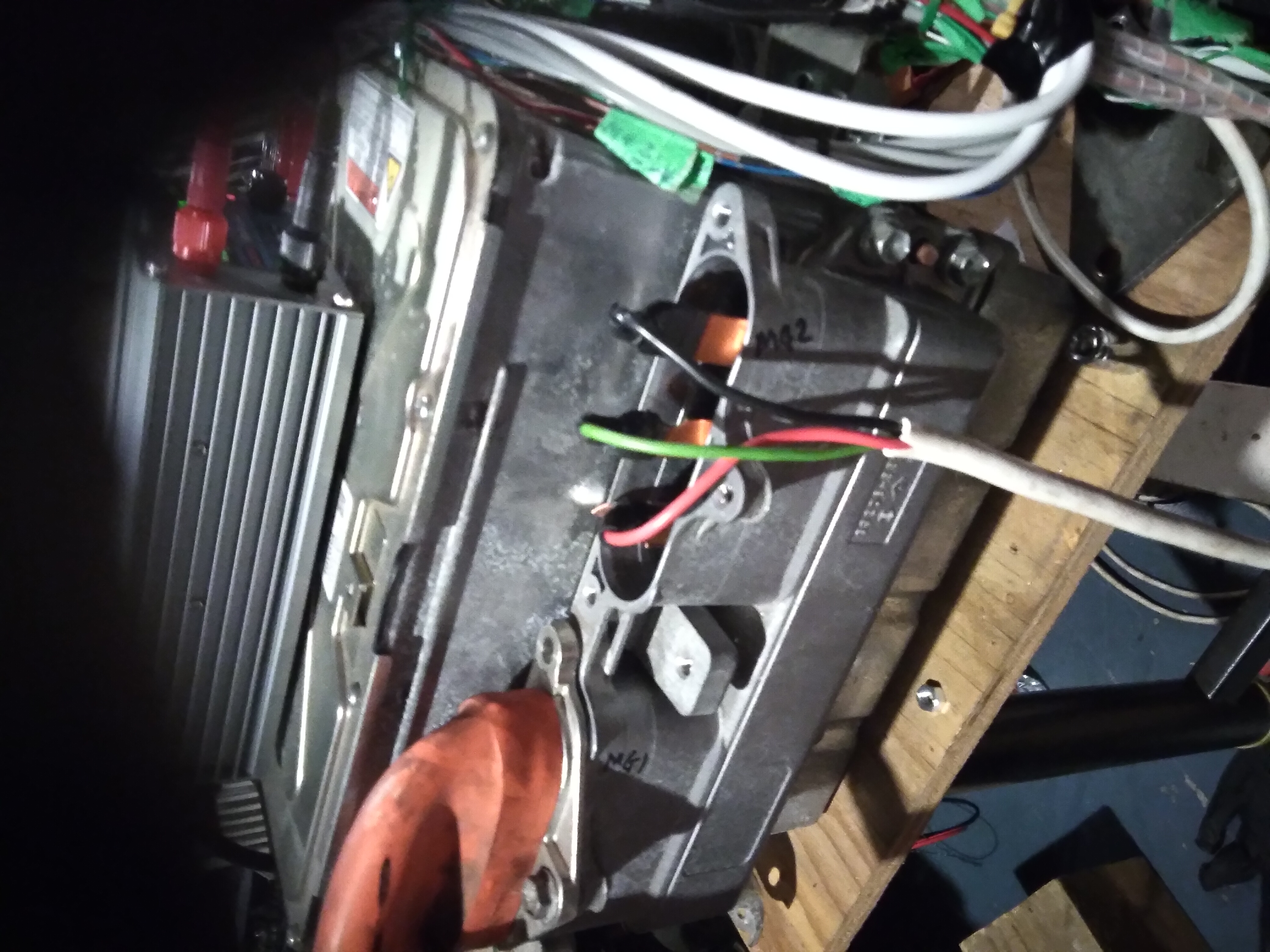

Revisiting running a single MG on thd Lexus inverter ,
Yes it would seem it can run by itself....as hoped.
The mechanical connection through the PSD with the input shaft stopped , is where the loading was apparent ,

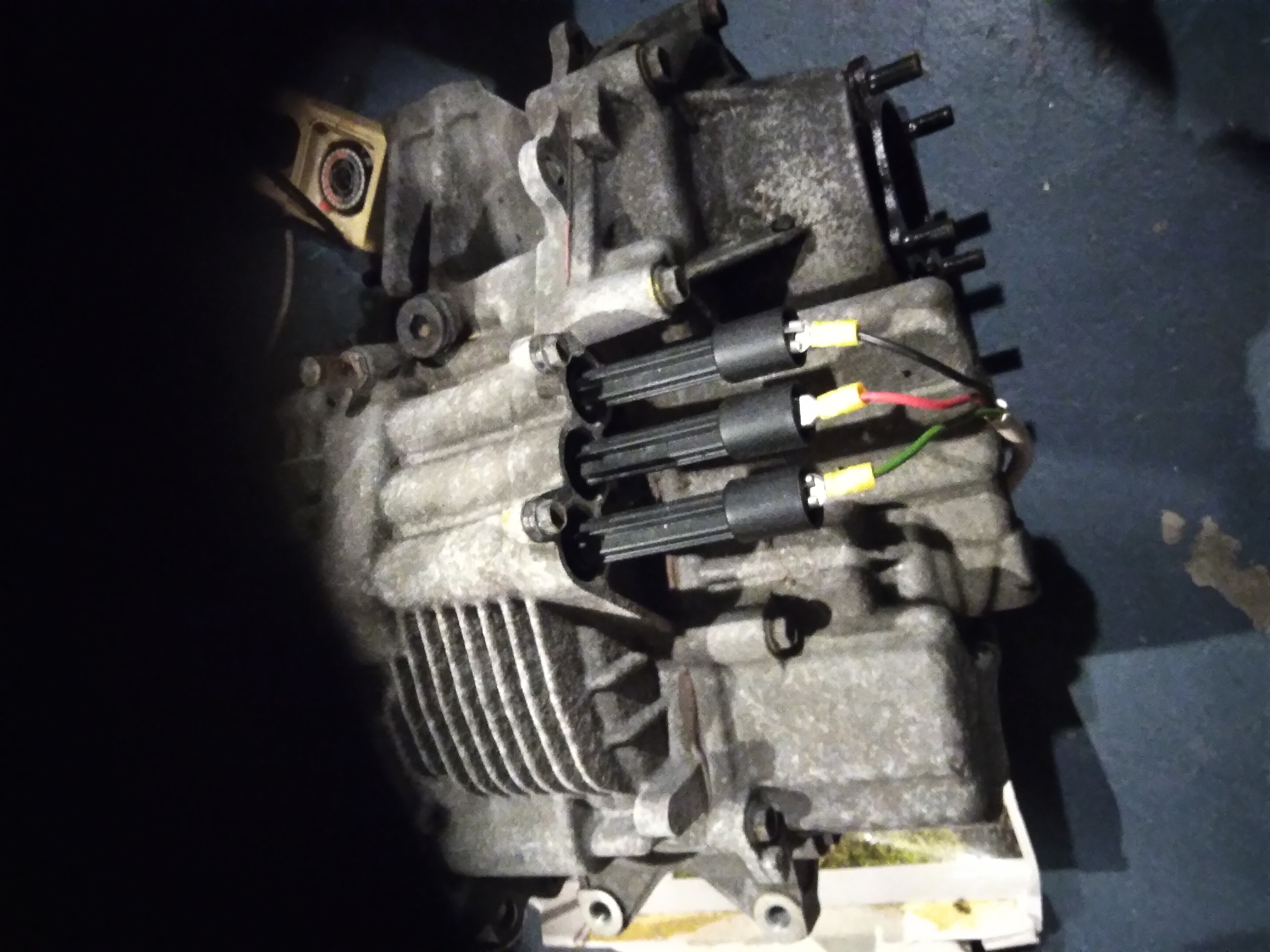

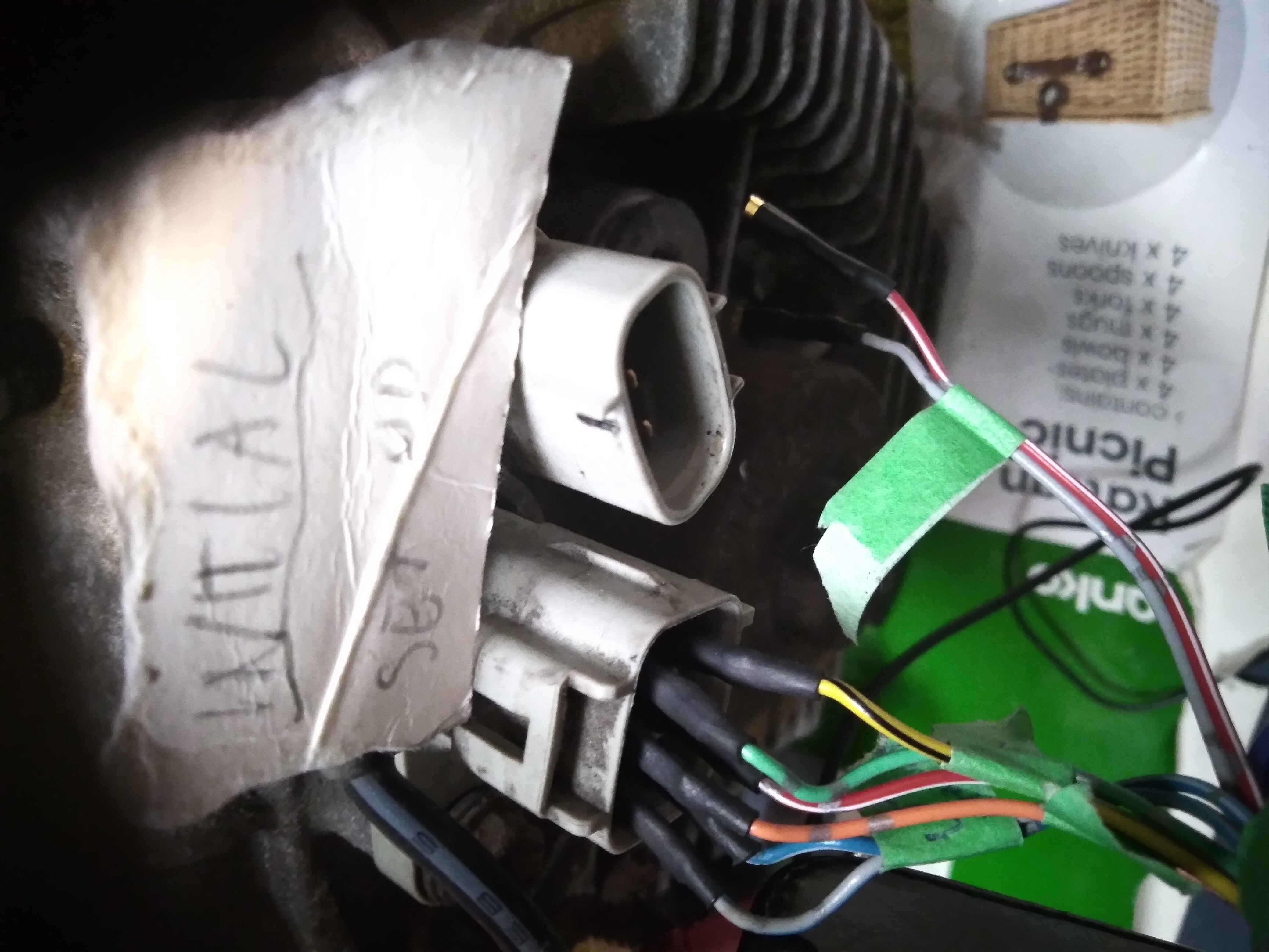

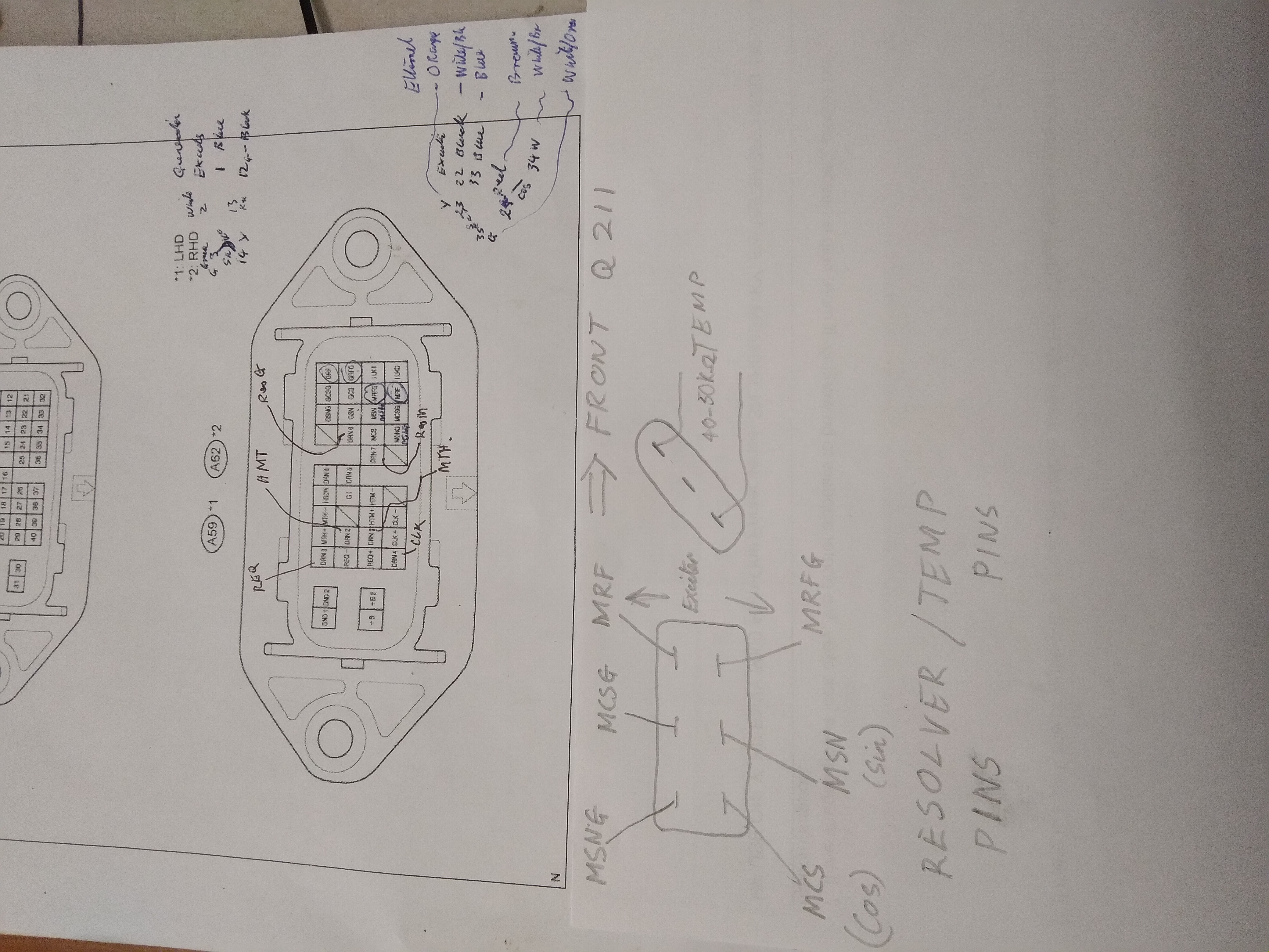

Have revisited the Lexus gs450h inverter and the MG2 driving Q211, from a Hylander rear Motor Generator. Using Damien's gs450h board, so I believe the Zombie board will do the same.
Here are the connections that gave fwd and rev .

Hi, unsure why some double picture entries occurred, apologies.

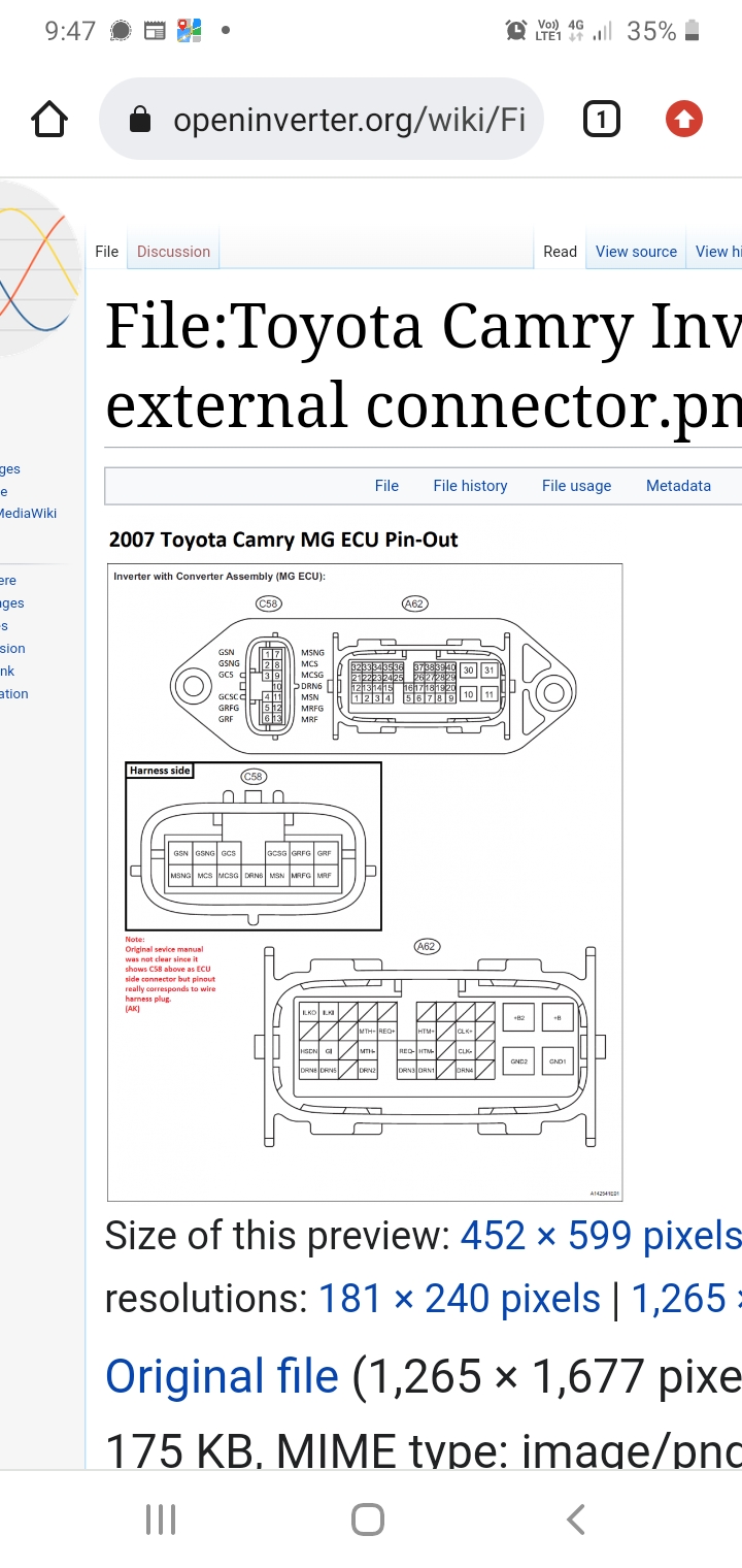

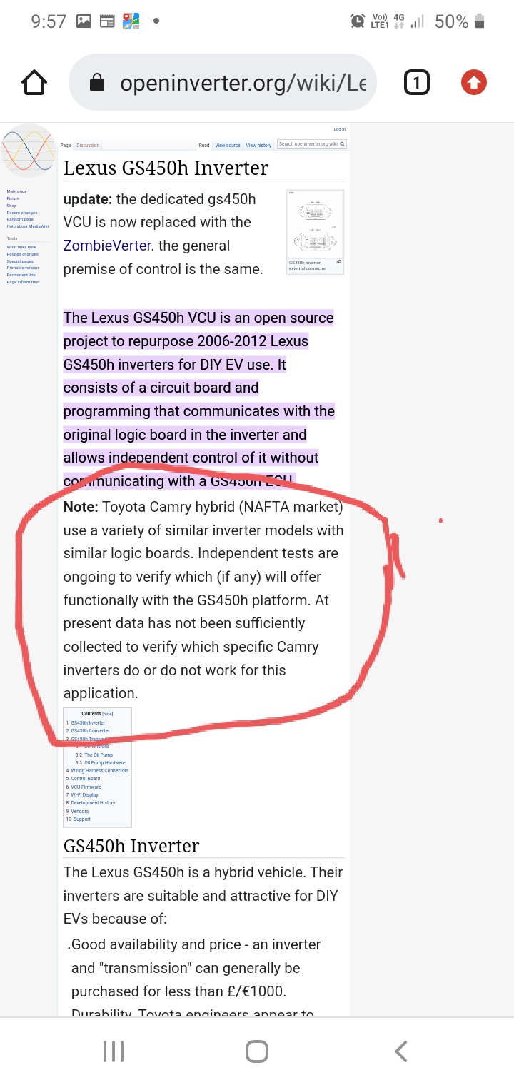

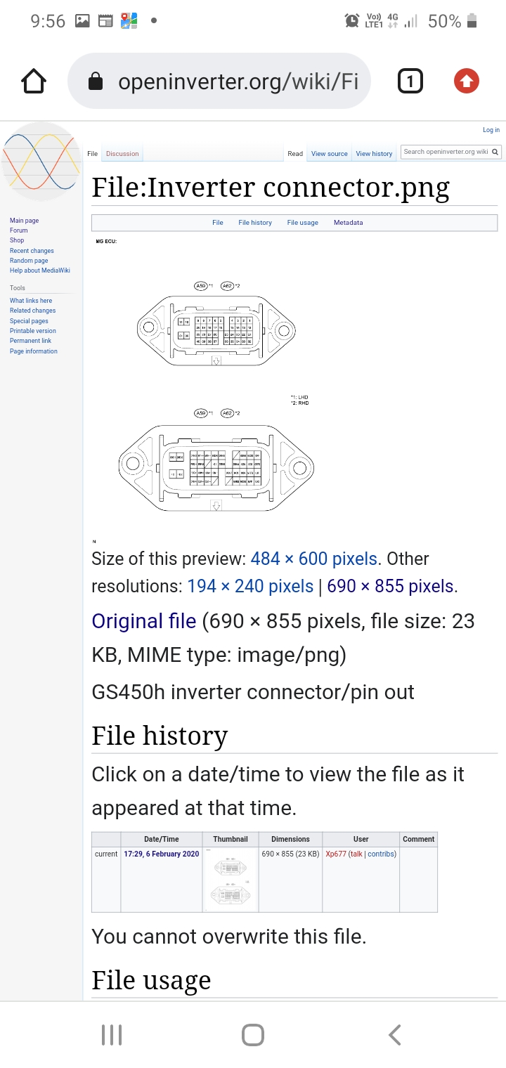

Why are the connections so vastly different from the Camry connectors?
https://openinverter.org/wiki/images/9/ ... con-et.png
Did you trace them back inside the inverter?
It does seam odd that Toyota/Lexus use the same type of connectors but with completely different pin connections
or am I missing something here?
A great job to get it working !
Woodfie
Posts: 164
Location: Auckland NZ
Has thanked: 116 times
Been thanked: 61 times
Re: Hyper car hybrid
Post by Woodfie »
Hi Dale, plug pin connections from wiki, which was my starting point. Seems that the Camray do have quite different pin connections...
daleread
Posts: 49
Joined: Sat Mar 05, 2022 3:59 pm
Location: UK
Post by daleread »
Wow, that is drastically different.
Where did you find the Camry pin out?
Woodfie
Posts: 164
Post by Woodfie »
Wiki Lexus gs450h open inverter.
Just a bit further down the page is this Camry pinout.
Seems all the resolvers are separate, probably for ease of assembly....
