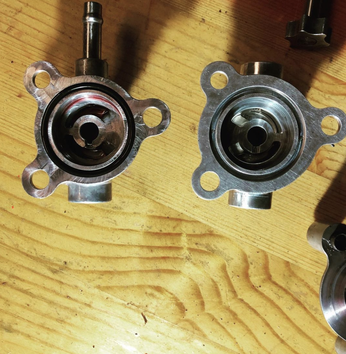

A side note: the Toyota RAV4EV and MB B250E drive units are based upon the similar Tesla Model S of that timeframe (2011-2012), but a LOT of the parts are not interchangeable. Notably, in the RAV4EV the whole unit is mounted reversed from how it's mounted in the Model S, with the axles behind the motor/inverter (the Model S mounts the axles ahead of the motor/inverter). Consequently, in the RAV4EV the rotor runs backward compared to the Model S. Which means they have unique parts with pinion and other gears running the helixes at a reverse angle to make the shaft loads the same as the Model S.
One of these is a Tesla LRU, the other a RAV4EV DU (I forget which is which), and while the orientation of the pics is bad, you can see that the gear helix angles are reversed between the two:
(click on image for larger)
Further discussion of this is here.
And the lubrication pump is different to accommodate the reversed drivetrain rotation.
Toyota insisted on an electric Park pawl, which the Model S doesn't have, so the case is different on the RAV4EV as well.
The inverter may be interchangeable, and some of the other hardware, but many gears and at least one case half is not. I suspect that the coolant flow path is also reversed between the two versions, from what I've seen.
Neither Tesla LRU of that era runs the oil pump when driving in Reverse.

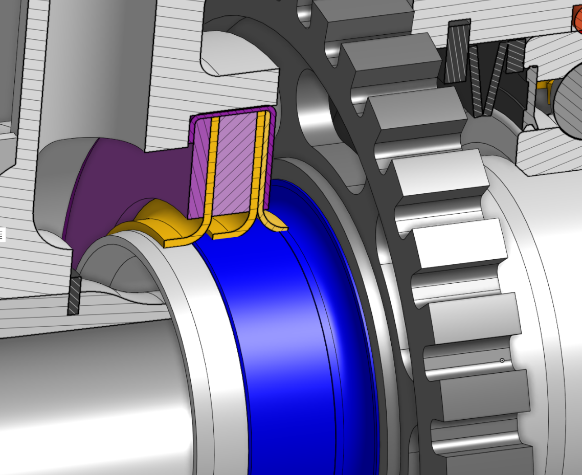

Q4: In case of a triple lip, two of the three lips are not cooled by direct contact with coolant. Is this a problem? Is this why tesla opted for a single-lip seal in (for example) my DU (rev G)?
Q5: Maybe the problem is not the seal itself, but wear (polishing) of the shaft surface, decreasing the surface roughness below e.g. ~0.075μm (ref: Parker PTFE rotary seals) or 0.050μm (ref: Trelleborg PTFE rotary seals). Maybe Tesla tried to reduce this by reducing the lip's pressure by adding the concentric cuts (see prev post in this thread) What do you think?

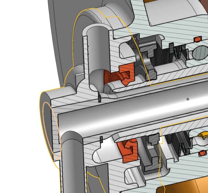

Remark: The right image is the RAV4 because it shows the four parking pawl notches in the rightmost shaft.

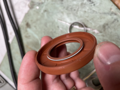

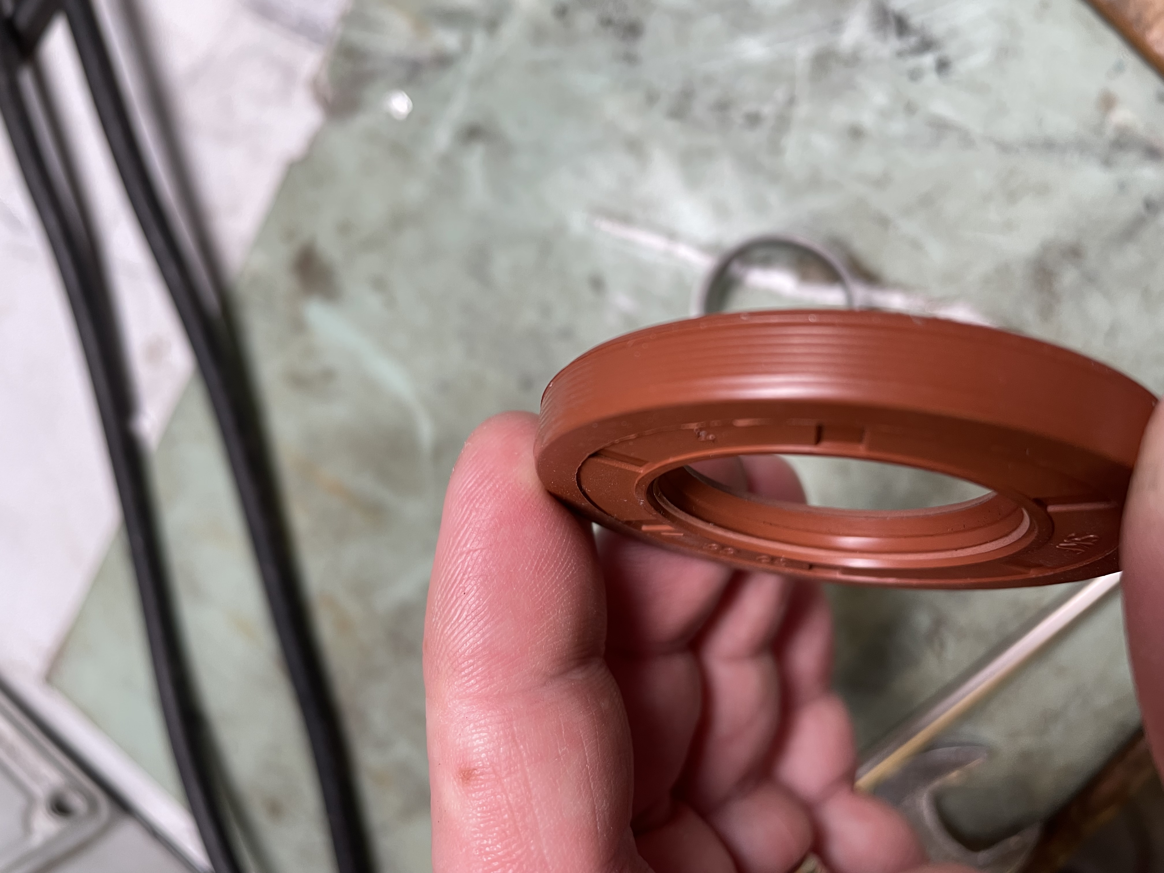

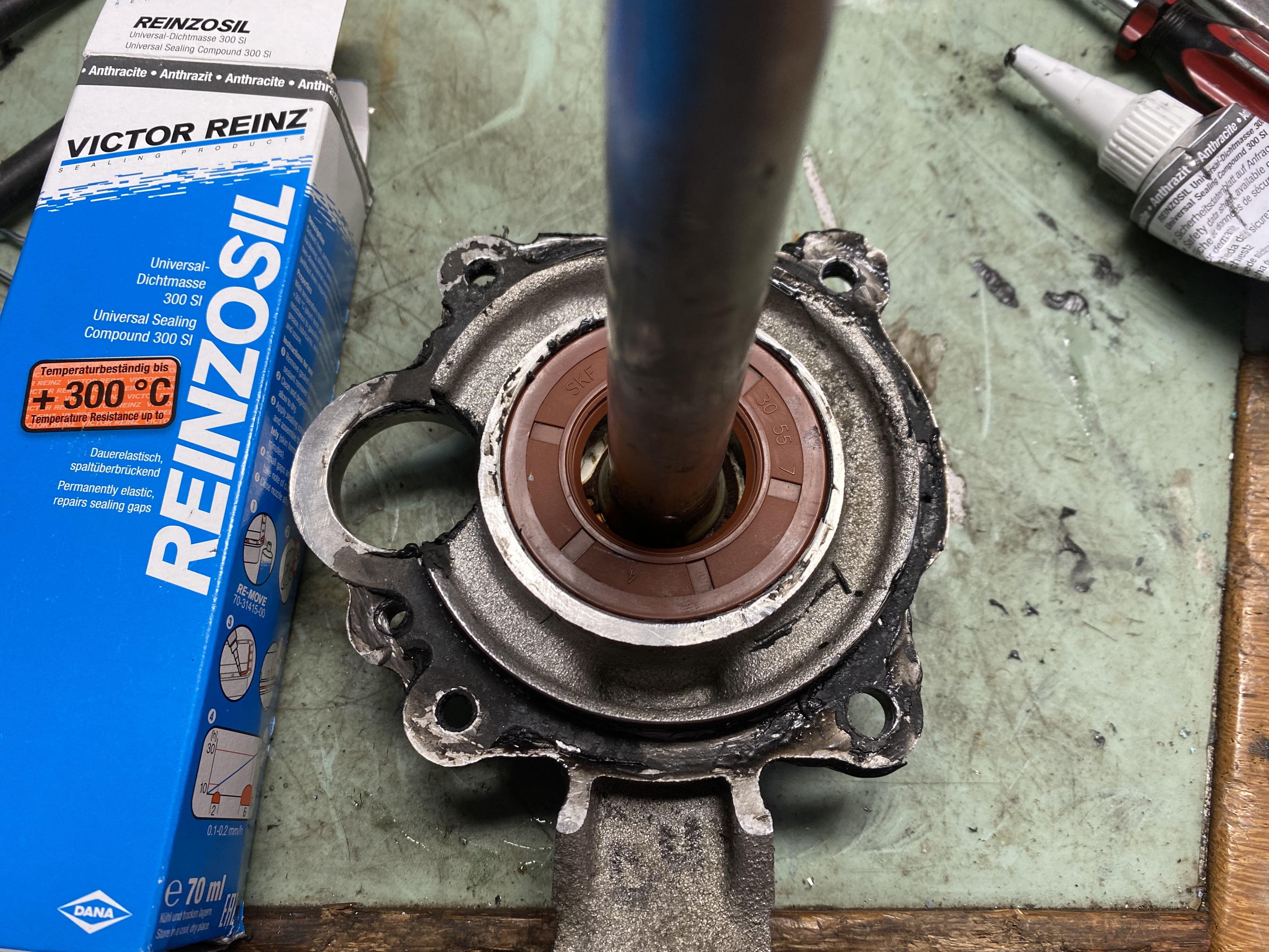

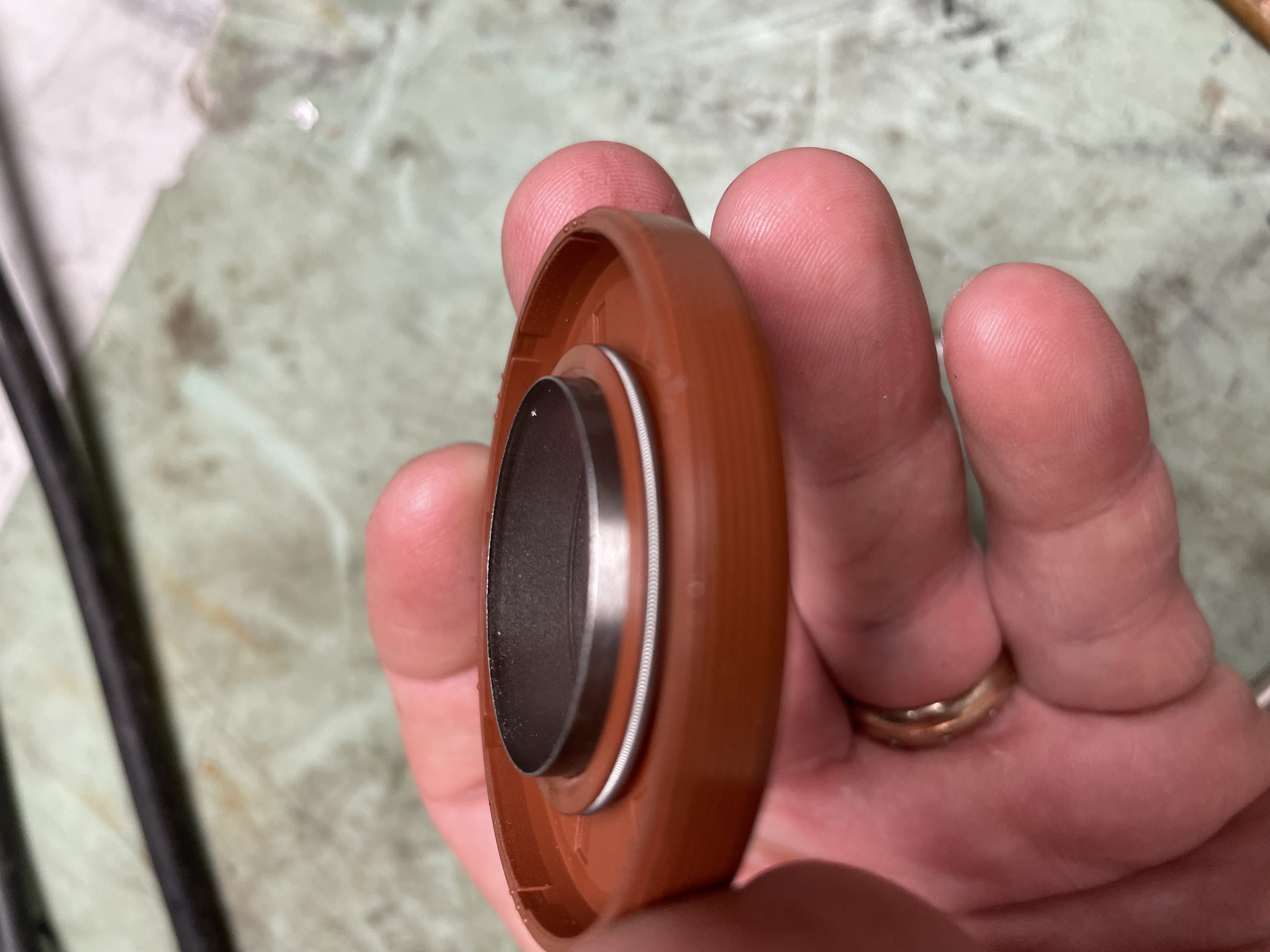

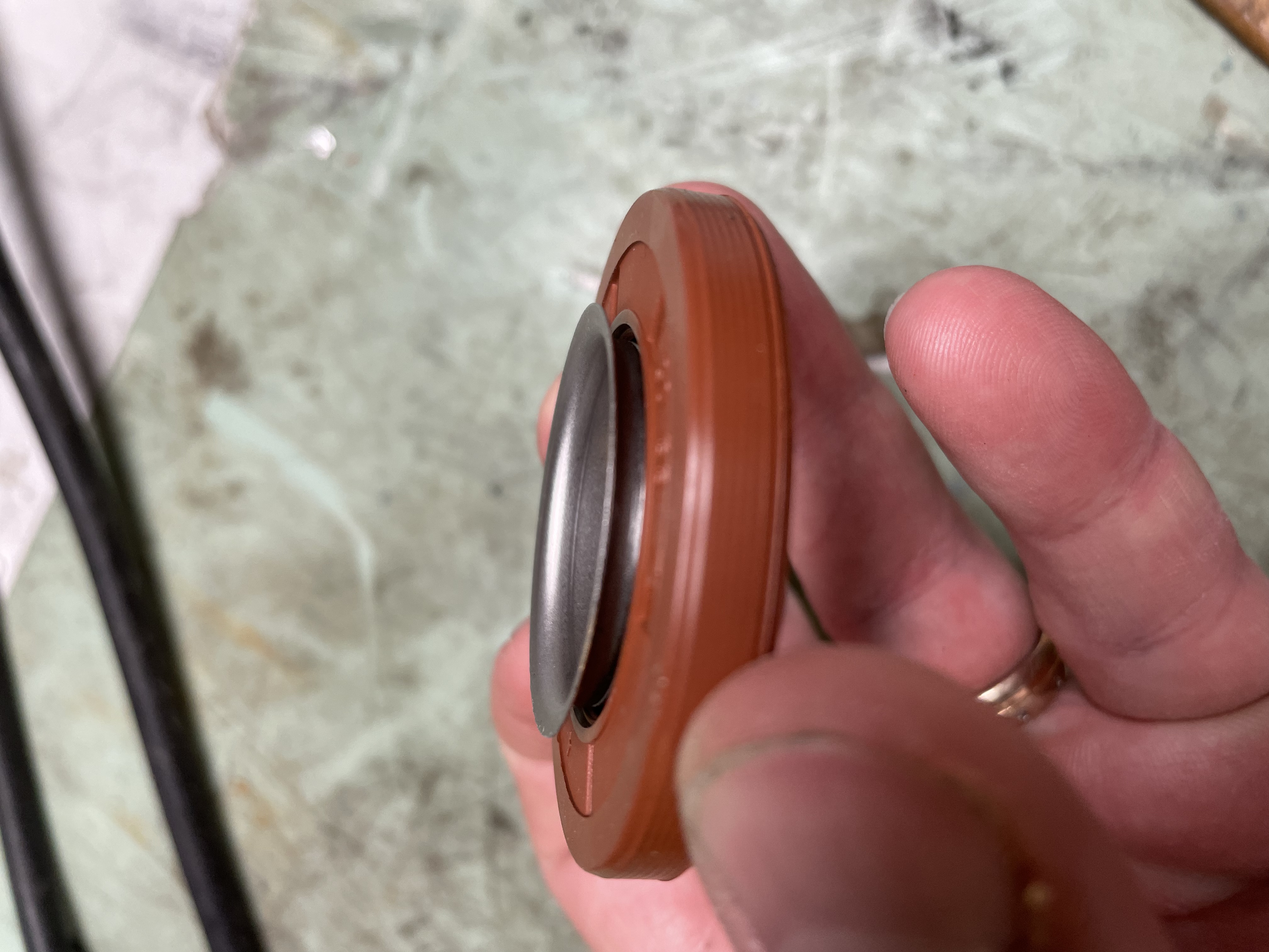

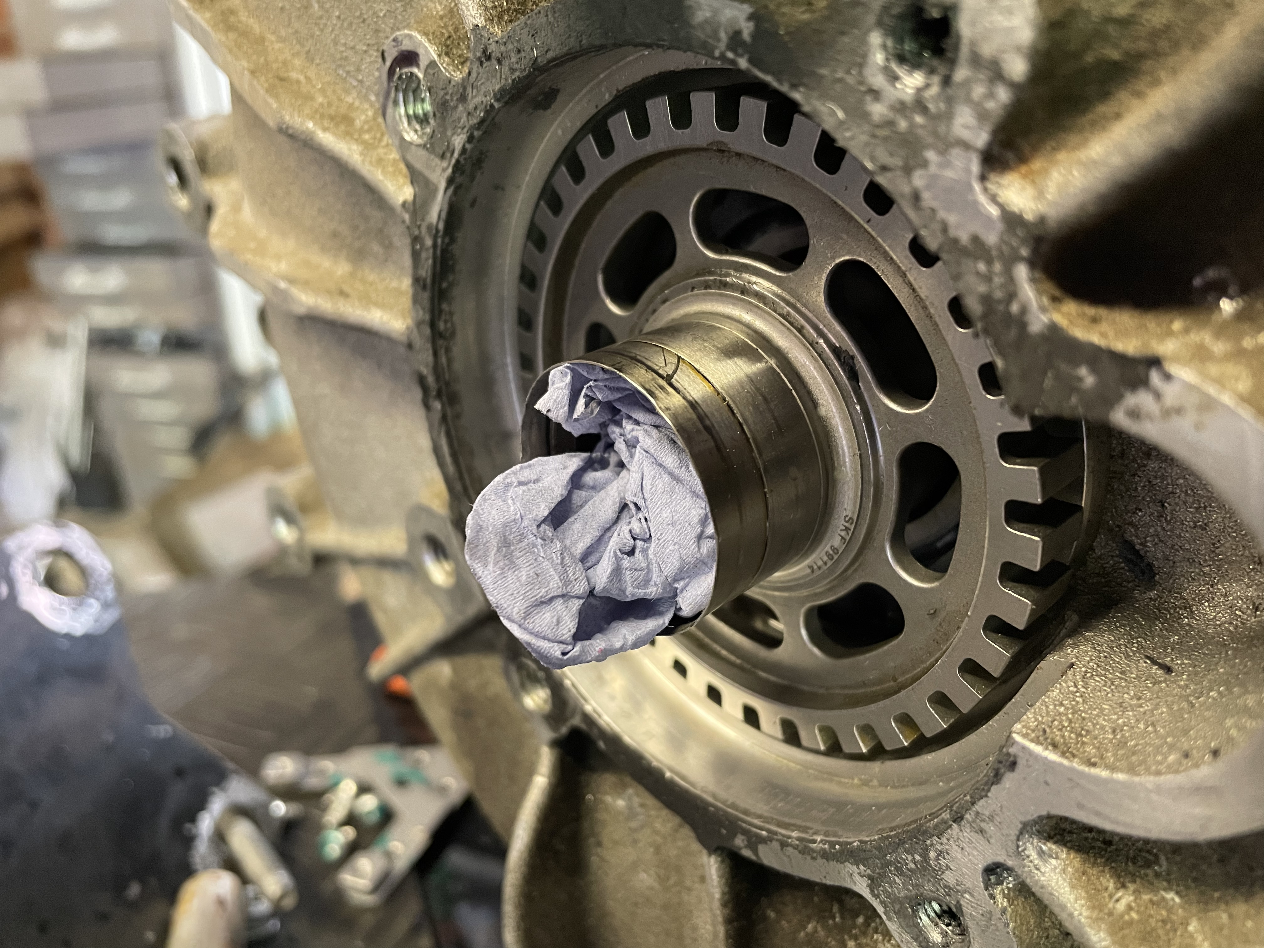

I have now fitted the aforementioned SKF seal. It will run on the Speedi sleeve.
I took the car for a blast last night and everything seems fine.
I’ll update any relevant long term feedback in this thread.
Edit: Johan kindly did some calculations ref RPM and seal tolerances. With my wheel sizes, the seal will be in tolerance to aprox 12500 RPM which equates to 100MPH.

I love the Speedi-Sleeve; I've used them going back decades, but never on a shaft whose speed approaches anything like the Tesla's rotor. Still, when I saw Boxster's corroded rotor, "Speedi-Sleeve" was my first thought.
Flame-spraying shafts to build them up prior to re-machining back to size used to be an expensive process -- 30 years ago -- reserved for large/expensive industrial equipment; perhaps it's now commonplace? Certainly, the Speedi-Sleeve has the advantage of cost and fast turn-around.

The HMS5 V seal will most likely make contact with Boxter's sleeve, because there is at least ~3.5mm left to the edge of the sleeve (estimation based on pics above / DU CAD model shown below / SKF seal CAD, assuming the DU dimensions match my rev. G DU). The great thing about those sleeves is that the surface roughness Ra = 0.250 to 0.500μm (source), something you cannot achieve/measure easily yourself in your average home garage. Note however that this roughness likely exceeds the optimum roughness range for PTFE from both Parker (0.075-0.300μm) and Trelleborg (0.050-0.200μm), I could not find SKF's range. Maybe that contributed to the relatively fast wear of the PTFE seal, who knows.

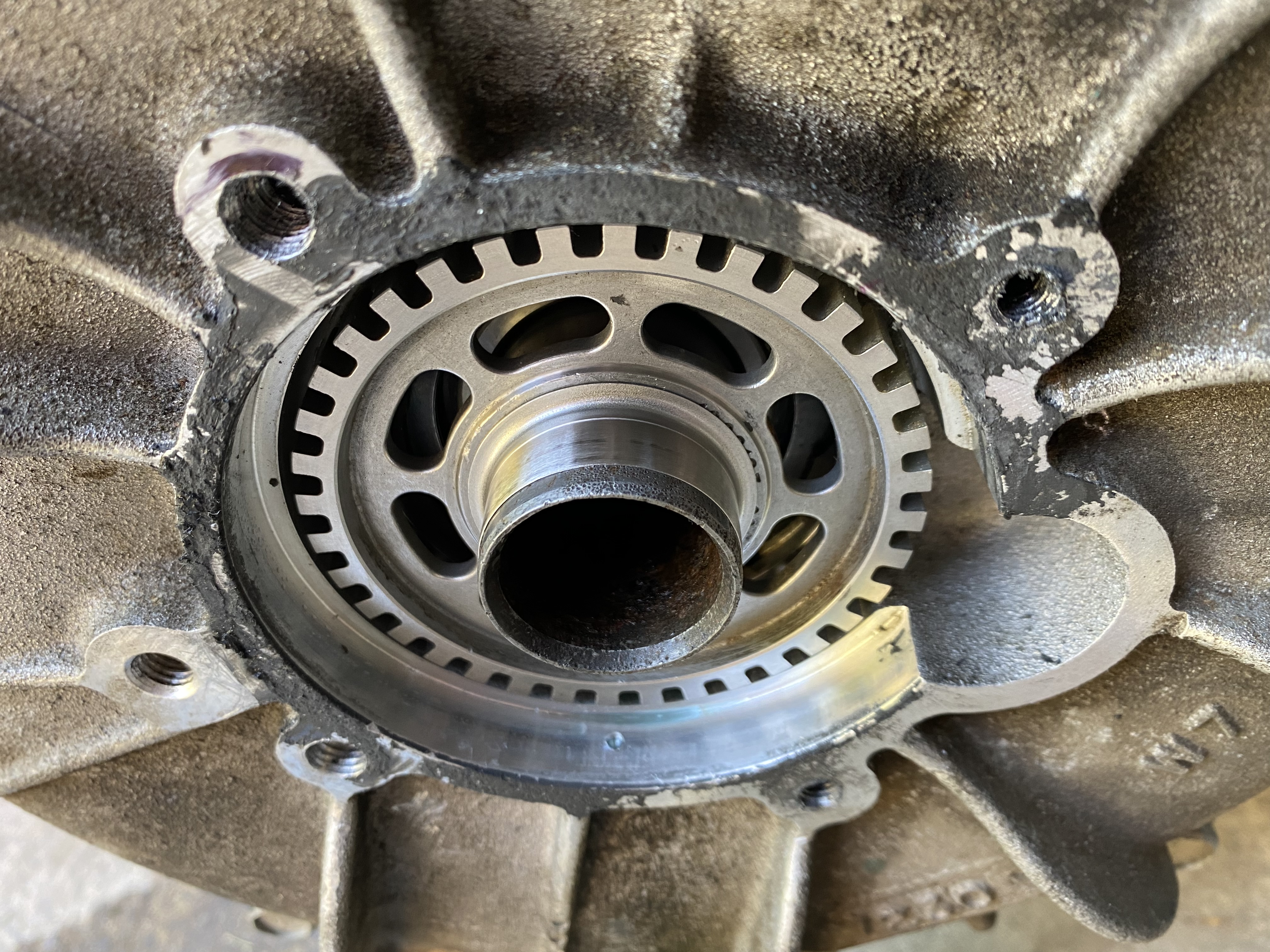

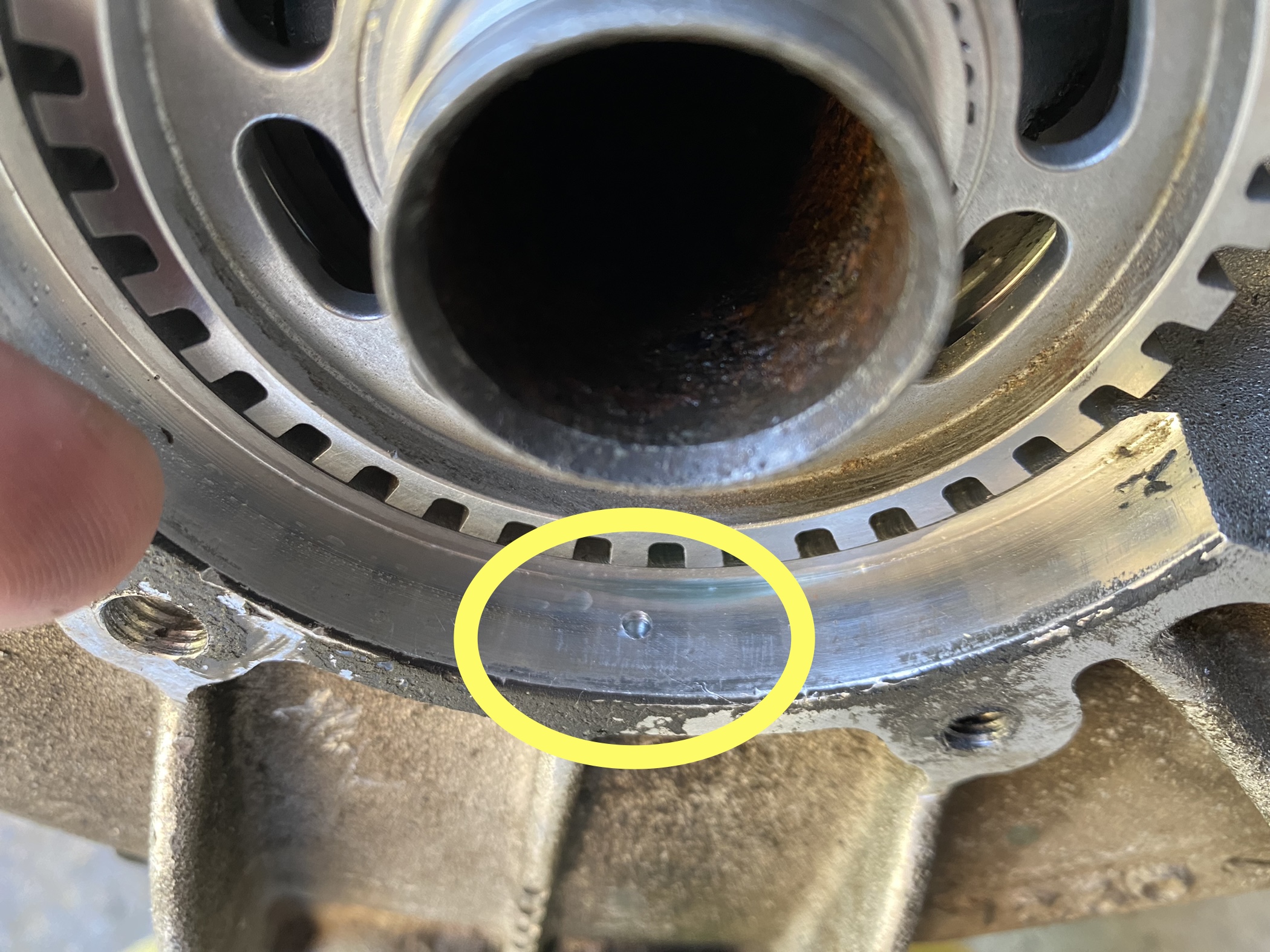

One lip failure from the Chenming seal may be explained by looking here:
Related to this: See how I tried to give the shaft the correct surface roughness for the Chenming seal:
The left lip made contact with the cratered shaft surface, not with the sleeve. That explains failure of that lip. But what about the middle lip? That one should have functioned, right? Then why not? Maybe the added thermal resistance of both the glue (or worse: air gap) between the shaft and sleeve and the sleeve itself, and the possible initial lack of direct liquid cooling made it wear out quick or overheat and fail? Also the excluder (right lip) seems right on top of the sleeve's groove and fillet, which is not optimal.Related to this: See how I tried to give the shaft the correct surface roughness for the Chenming seal:
Disclaimer: Despite all efforts, all (which I write) should be conservatively interpreted as a poorly informed, error-prone, non-expert opinion that is subject to continuous change, especially in this age of hyper-specialization and newly gained insights.

In my second 1000 mile test (with chenming seal and speedi sleeve fitted), you are correct that the seal was not running all three contact areas of the sleeve. Using two of the three lips with the third overhanging the sleeve is clearly not ideal.
However, as a very rough datapoint I also tried using two sleeves as pictured below - with the join resting between the second and third seal lip. Ignore the polished sleeve wear marks as they are not truly indicative of where the seal was running as I tried the sleeve in multiple positions. I never fully tested the double sleeve option as I wasn’t comfortable with the arrangement as firstly I couldnt get it out of my head that the Chenming seal is rubbish and secondly I would need to cut the outer one down to size. Also, the SKF option was presented at this time so I gave up on the double sleeve chenming set-up.
You are right to highlight the challenges of fitting the manifold without damaging the seal. It’s very easy to fold over the first lip or tear the inner ones when putting it on. The big issue is that it’s almost impossible to know whether the chenming seal is correctly fitted.
Hope this flakey update helps a little. Although I think the various methods I’ve tried is confusing the situation.

This is another Rev Q, the label is a little different, the seal is different, and the shaft has this sharp lip on it.
Not sure how useful this information is but I figured I would capture it here

Is the red seal original or refurbished? And have you tried following the qr code on it?

Upon removing the cover, a LOT of brown nasty water came out. It was obvious now that there was rust and coolant material building up between the rotor and housing which was seizing the rotor at low speeds. The rotor did NOT want to come out. It was almost rusted in place. This bearing is a little rough but has not completely failed. Seems coolant has washed all of the grease out of it.
The rotor teeth are in great shape and the rear bearing is still good. Cleaned everything up as best as I can - I'll be using one of the Cheming triple lip seals and SKF BB1-3793 bearings. They came from Ukraine via eBay - we shall see if they appear genuine - I'll contact SKF once they arrive and see if they are authentic.
Lucky for me - the inverter was pretty clean. One or two drops of fresh coolant. No brown rusty water.
When the bearings and seal arrive, I'll report back.
