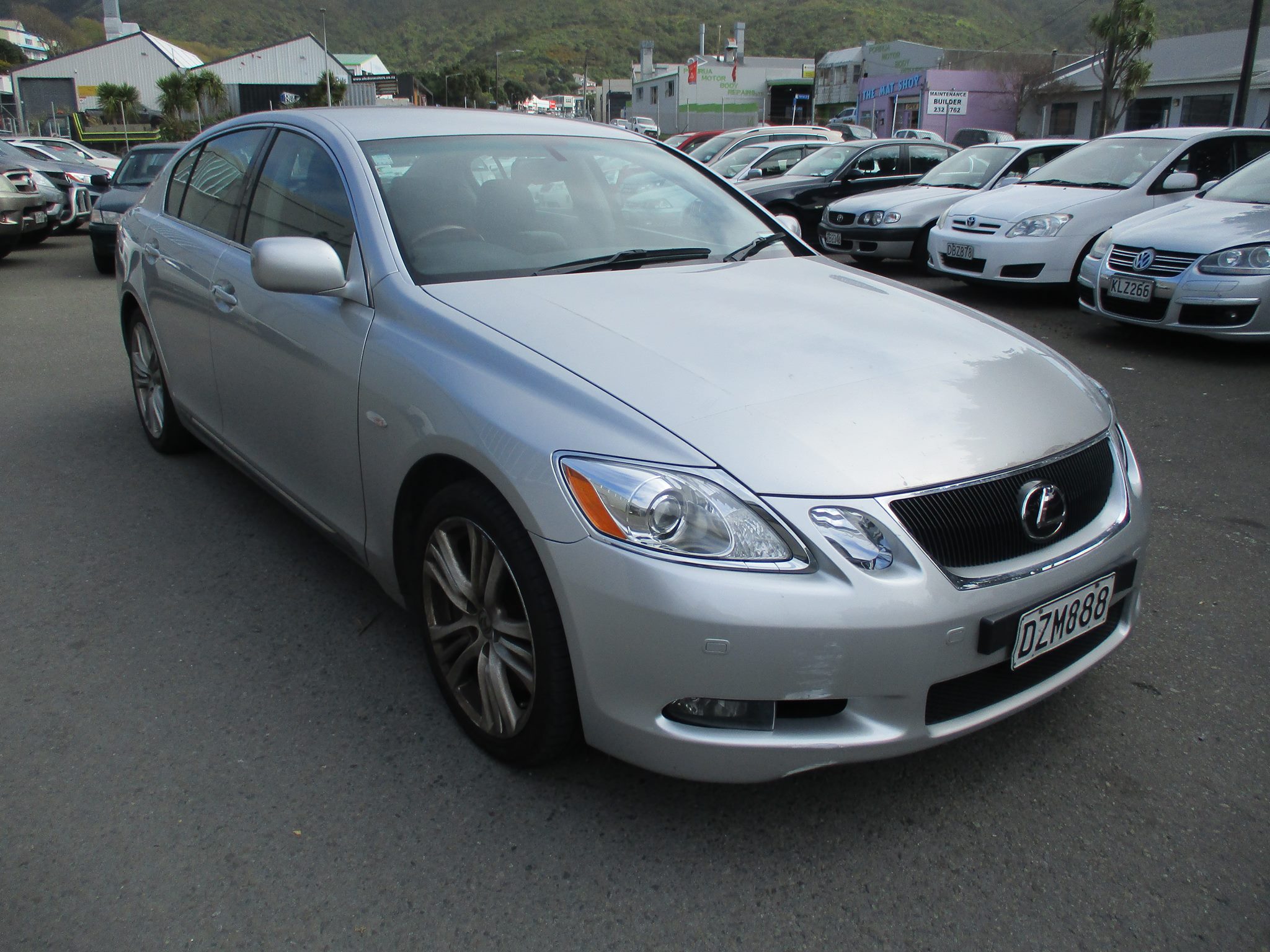

My Organ Recipient continues to wait for a Donor.
I've pretty much given up hope finding a Lexus GS450h in this country (New Zealand). They are rather uncommon to see on the roads here. Probably because they were fairly expensive to buy new and even when imported used from Japan they are still pretty expensive to buy. $12K for a 12 year old Lexus??
So it's not a matter of being able to find one, there are many in used car yards around the country, but just not a lot of them being sold and thus not a lot of them being crashed.
They are available from private sellers for a few thousand dollars less but it just doesn't feel like a great idea to take a working and road legal car and break it to pieces. A bit irresponsibly wasteful even.
So I've been looking to import parts from Japan. And the cost of freight has made my eyes bleed.
If you look on Yahoo Auctions there is plenty of great gear at bargain prices, but you need a Yahoo Auctions account, probably a Japanese bank account, and it would help to speak Japanese. Then you still have the issue of receiving the parts (most won't send overseas, especially bulky things like transmissions). There are Proxy Bid services that take care of the bidding, and receiving problem, and also sending overseas, but not bulky items, and their handling fees can get excessive.
I enquired with a logistics company here in NZ about using them as an agent to handle all the pickup, packaging, customs and freight. They wanted NZ$2200. Considering the gearboxes are around NZ$500 that really jacks the price up.
Recently I found a forwarding company in Japan that seem to have access to all the same parts I've found on Yahoo Auctions. A bit parts consortium is called Used Parts Japan. They have the same gear listed in many places. I recognize the same photos in different places and similar prices. Generally they airfreight parts using DHL. But this is where it gets a bit complicated. I can have an entire GS450h transmission air freighted to me within 10 day for NZ$863 but a smaller lighter inverter is NZ$1156?? A rear differential which is 1/5 size of the trans cannot be air freighted and has to go by sea for 1-2 month and cost NZ$1567.
Then I noticed if I had the inverter on my list and added the transmission the freight cost stayed the same. And if I had anything that required sea freight, I could create a big list of items and have it shipped for 1 price. It seems that you're paying for what must be a cubic meter and as soon as you go beyond the limits the cost of another cubic meter is added to the freight.
I need to check with the company that these freight charges are legit and not erroneously calculated by computer. I don't want to have unexpected charges part way through the transaction. And I suspect customs charges at my end are not part of that price, nor transport from the South Island to the North Island (the only destination port available as an option is Timaru). I suspect only a little port like this is willing to handle odd small volume cargo like this.

Well I have a working, driving and road legal Lexus GS450h now and have been using it as my daily driver while evaluating it's performance, considering things I like about it and things I would change.
I plan to collect a complete library of CANbus events for future analysis and reference including -

I have been driving my GS450h over the past few months and there are only a few occasions when it will allow electric only operation and it's not always obvious when. I do a 160km round trip to work and back. Mostly highway speeds but a few reduced speed zones, some stop/start traffic in town and a slow climb up with rapid downward run going in to work and the opposite on the way home.
I car's display reports an average of 8L per 100Km which has been confirmed with my own fuel economy calculations from fuel refills and odometer readings. There are no warnings on the dashboard and from the battery test I did there are 2 cells (out of 40) that are a bit weaker than the others but not bad enough to cause errors. However, I can't say how these effect the performance of the car.
From my observation the GS450h will use full EV mode when -
- the battery is above 50%
- the KW consumption is below 10KW (according to the dashboard KW usage gauge)
- generally not above 60kph (driving at this speed requires more than 10KW on the flat)
Travelling at 100kph on a level road with AC and heated seats on consumes around 25KW so I assume this car would consume 25KW/h travelling 100km distance. Which makes me assume it would require approx 50Kw/h battery pack to achieve the daily range I need. Less if it was lighter.
If the car has been running previously and still warm and there is a reasonable charge in the battery and you go easy with the throttle and keep your speed down, it will drive in electric mode. As soon as you want to go a bit faster, or the battery gets a bit low, or you start to climb an incline, the engine will kick in.
My car won't do more than about 500m on pure electric mode. These cars only have about 1.2KWh batteries in them, and the car won't allow the voltage to get very low before recharging again with the petrol engine. The recharge will stop when the battery pack gets to about 60% to ensure there is a bit of capacity to capture regen braking energy. I'm not sure if this is about as far as you can expect to go in EV mode as I can't really say what condition the battery pack is in. Car has done 135,000km so not new.
When I get home and stop at my gate the car will do my 500m driveway in EV mode in low speed. Next morning the battery pack will be too depleted to go any further so the engine will start and stay running until it is up to operating temperature.
The engine is never not running on the motorway at 100kph. It's always sending power to the rear wheels according to the power consumption diagram in the display, but also sending power to the battery pack (which I assume is for running the accessories). There is a short level stretch of road at reduced speed. It's about 2km long and the car will do about 500m in EV mode at 60kph on the flat before engine has to start again. There is also an extended downhill run with decent grade of about 2km. The car goes into full regen and the battery capacity is maxed out halfway down the hill, thus wasting any further energy recovery.
