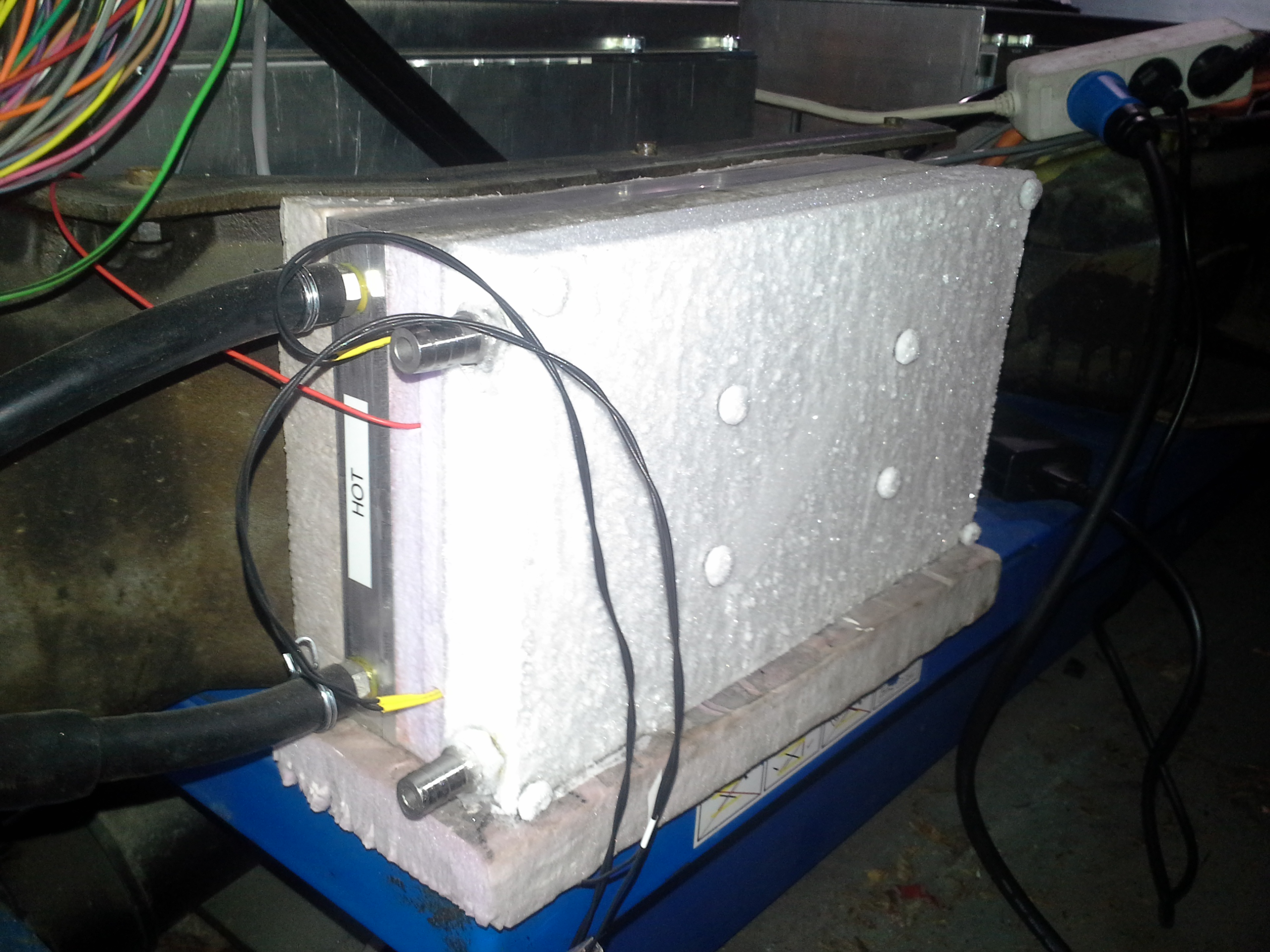

Made a new topic on the TEC battery heater/cooler. Because it may not be very interesting or a little off topic.
Have used this for a few years now.
Did actually expect it to fail, but no, it works!
I first ran it directly on HV turning it ON/OFF with a SSR, but it gave to much stress on the peltier elements. They don't like PWM either.
So I went for a adjustable 250VDC PSU, this way it can be run directly on AC when plugged in, and from battery pack when unplugged.
The power is rather small 1.5kW pluss the peltier added "free" energy.
There are two water loops, one for the battery and the other is using the original cooling loop for motor, inverter DC/DC and Tesla charger.
Had it for two winters now, and It keeps the battery warm from day to day with very little power.
This is first test setup:

I made it from 20mm aluminium.
Isolated around the TEC with some PU plate.
Conductive "sheet" added. And mounted temp sensor on the first and last TEC.
Mounted the TEC's in series.
Test connected to battery pack, the ising was a problem, the first TEC's died after a while.
Probably because of wet and 300VDC don't work well :) And to much PWM test, they don't like that either.
Mounted in water tight enclosure. No condensing at all. Also put in some Silica dry-packs.

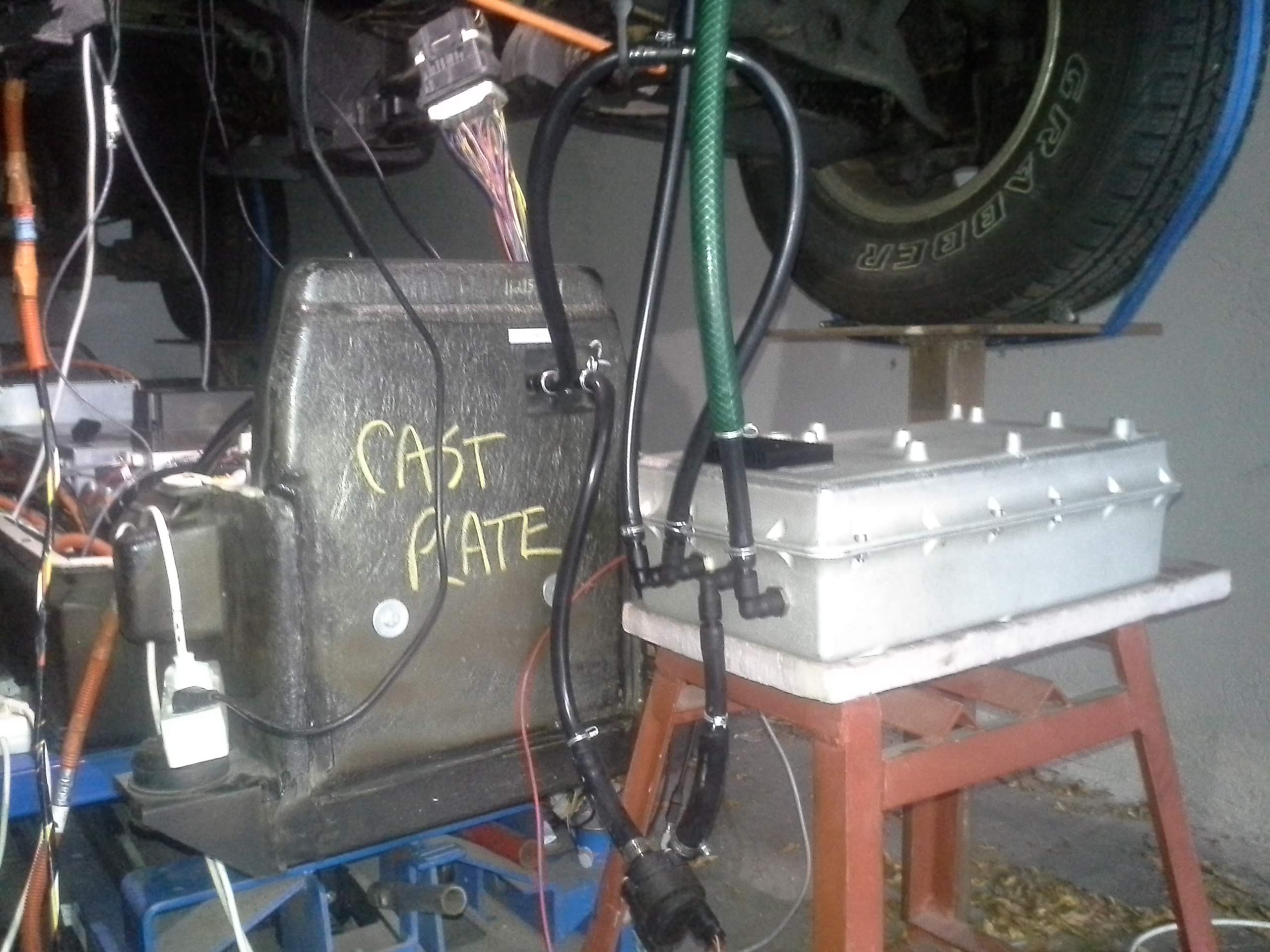

Some efficiency consumption test:
There is 10C outside, and I increase the temp to 20C in the battery pack.
Have a AC wattmeter on the perltier heater PSU and on the 12V PSU for the water pumps.
This draw 650-700W for 15min, and then it stabilizes on 35-50W.
I think this is pretty acceptable!?
I don't know if a'm going to have it on all time or just before charging.
The temp is not very often under zero degrees Celsius outside.
I have not run the main fan (engine coolant radiator) yet, because that uses huge power, 15A/12V on LOW!!!???
On full I can probably use it as traction if the main engine fails :)
The best would be to have a waterflow/temp gauge to find the efficiency of the peltier elements (COP)

It's mounted where the original charger was, together with a small coolant reservoir.
Tesla chargers are installed inside the truck.
