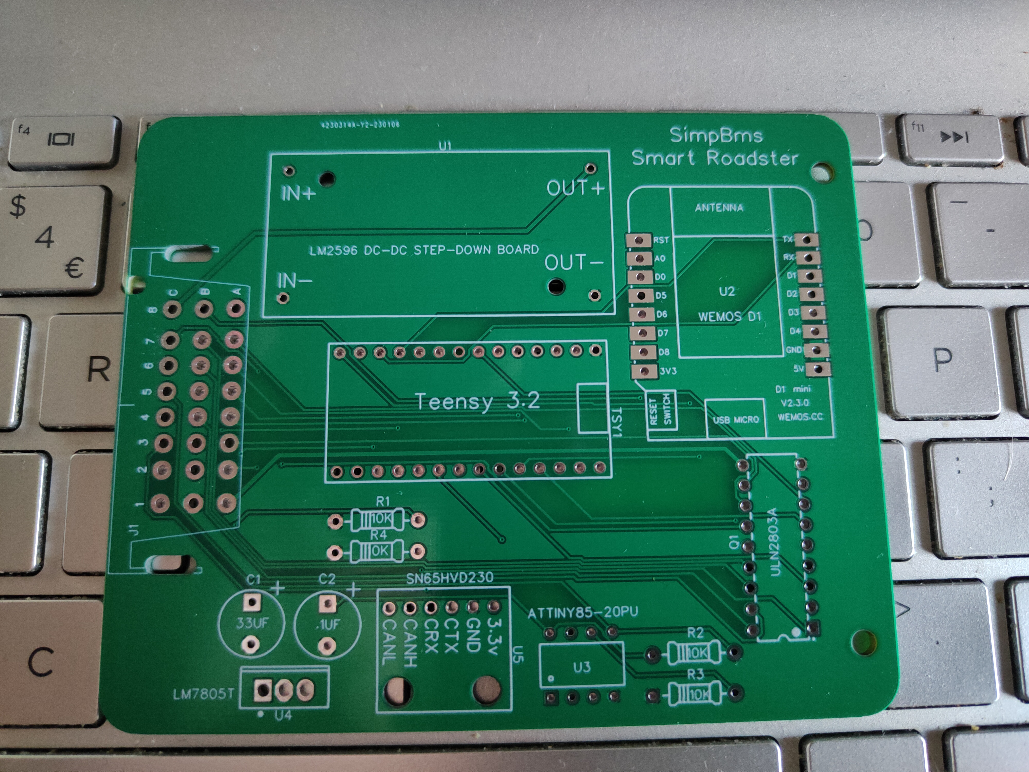

Look what just arrived.......Now just hope the Teensy that I ordered materialises and that it is not a piece of paper that says Teensy 3.2 on it!

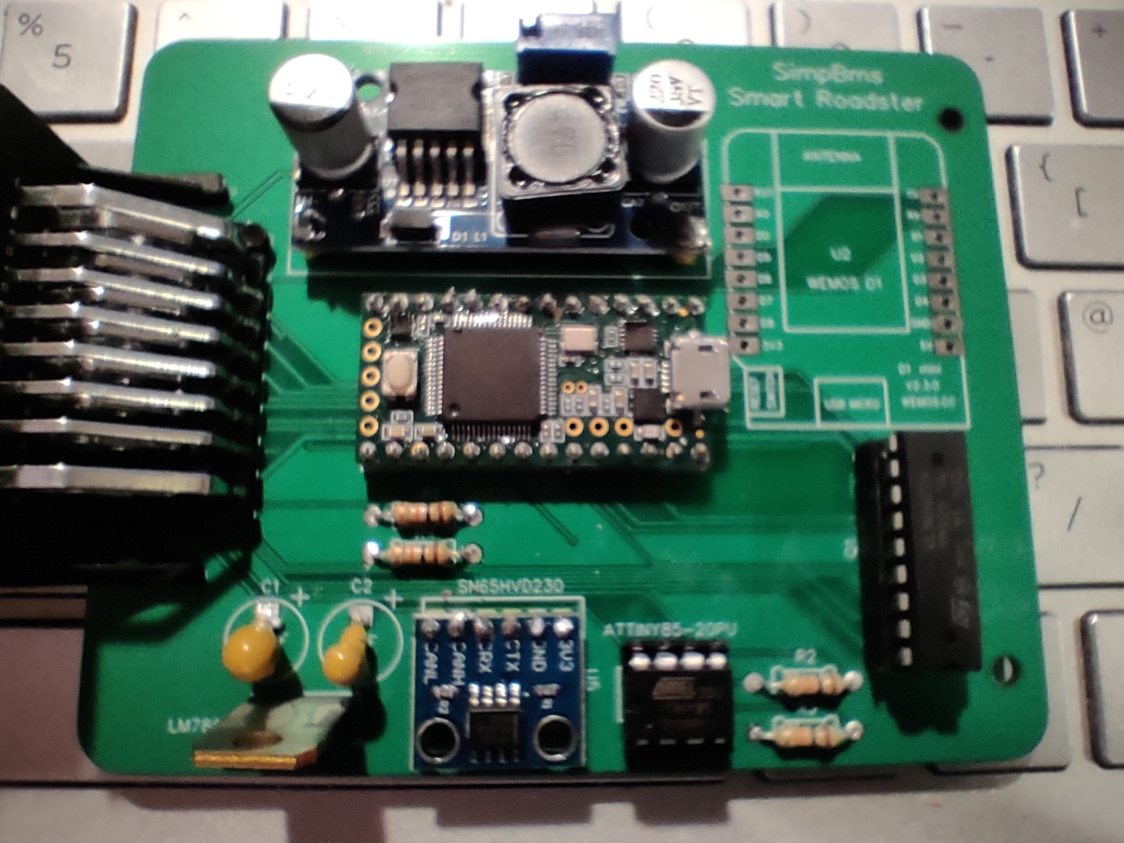

Also spent some time at the weekend fault finding the VCU that I previously had working. The mini360 converter seems to have an issue that wasn't resolved when replacing it. Killed the optos and darlington arrays. Most annoying!!

Yeah, I replaced it twice and showed the same problem. Dropped to 2.5V at the input and no output. Connected one directly to a 12v supply and in to the output and it worked fine. Put it on the board and no joy. It made very little sense to me as the input connects to the same 12v supply I was using directly. Need to check the board and the wires. Or just bypass it with direct 5v to the Teensy
Pretty sure I will figure it out.

Back in business, dodgy ground, but now we are all good. Just waiting on a replacement opto

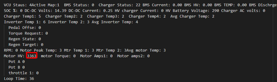

Some progress on the bench.
Wiring to the Charger is done and I am getting CAN data on the BMS bus, just need the BMS making now.
Have an odd issue with the VCU CAN misreporting HV (in red).
And YES, it is that cold in the garage!!
- aot93
- Posts: 198
- Location: UK, West Sussex
- Has thanked: 6 times
- Been thanked: 43 times
Have you made any torque request to the inverter?
HV is only reported correctly before a torque request is made, so it's useful more for pre-charge.

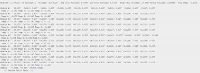

Well it only bloomin' works - sort of!
For some reason I have 11 modules registering, I am assuming that this is because I have left the connection to the termination resistor in CMU7. Should I remove it?
This is what I get in the debug.....and YES it is still that cold in the garage!
- aot93
- Posts: 198
Do you have anything else on the can bus, I know for instance the ground fault detector will show up as a cell. ?
- Posts: 51
- Joined: Fri Mar 04, 2022 11:46 am
- Has thanked: 5 times
- Been thanked: 5 times
The current sensor is plugged in......I stripped everything else out
- Posts: 51
OK,so I removed the current sensor......no change. I snipped the wires for the termination resistor......no change.
Then I disconnected the dcdc converter......
Down to 10 cells and a Ready status
However getting a !!! Series Cells Fault !!! which I will need to dig in to the code for.

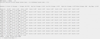

Last one for the night, promise!
Poking in the code it seems like the settings are for 12 cells in series
Via the menu I changed this to 80 and the !!! Series Cells Fault !!! has gone away!
Now, just need to figure out what is the deal with the phantom 11th module when the DCDC is plugged in to the CAN bus
settings.Scells = 12; //Cells in series
