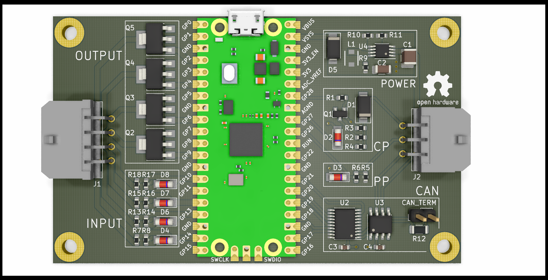

I'm in the middle of developing a device to act as the charge controller and general central power management unit. I've had some trouble working out what input / output will actually be required, so I thought I'd make a post to tidy up my thought process, and potentially get input from others. My project is intended to be CAN centric, so I'm attempting to keep wiring light, but I don't want to miss anything.
Battery modules
* Slave modules have proprietary daisychain interface
Master BMS
* My own design - handles balancing and makes cell voltages available on CAN bus
* viewtopic.php?f=13&t=2123
Ovartech charger and DCDC converter
* Charge control via CAN
* DC-DC converter enabled by 12V interface - wire to ignition switch
* Battery lines fused direct to battery - no contactors
Current sensor
* Currently looking for a current sensor with coulomb counting and CAN
Charge controller - design in progress
* CAN interface - a single CAN bus to talk to BMS, charger, current sensor and gauge cluster
* EVSE PP and CP lines
* Low side switch to drive coolant pump during charging
* 12v digital input, either to enable charging or a charge stop button - I'd be interested to know how other people start / stop charging safely
Am I missing anything that will be needed to facilitate charge control or is otherwise essential to battery / charge management?
* Possibly a second low side switch for type 2 connector locking solenoid?

To answer my own question here - I have decided to build a charge management board with the following connectivity:
* 12V supply
* CAN
* PP / CP
* 4 x 12v digital input
* 4 x 12v low side switch outputs
This is enough to allow a variety of IO as needed.

Re: Connectivity for battery / charge management system
Very nice layout with the various areas highlighted.
I think this is going to work. Nissans BMS outputs two essential values: a discharge and a charge power limit. The discharge limit seems to be the result of a simple calculation: derate if battery overheats or undervolts, reaching 0 at 2.5V. Maybe there is also a low temperature derating but I've never been there.
The charge limit seems more sophisticated, taking into account ambient temperature, cell temperature, cell voltage and state of charge.
Note many fuel gauges are analog, so at least one of your digital outputs should be PWMable.
Maybe use one 2.4in ii2c oled display with rotary encoder and push button. That would be a good I/O interface. Also oled is very robust display insensitive to UV light.
Thank you. I'm hoping this IO will cover everything. In the case of my project vehicle, most things you describe can be set with CAN (openinverter for Tesla SDU, CAN controlled charger, planning to replace analog gauges with CAN ones).johu wrote: ↑Mon Dec 27, 2021 3:17 pm Very nice layout with the various areas highlighted.
One benefit of the RP2040 MCU is that any pin can perform time sensitive things like PWM using the PIO, so PWM output is definitely something that can be added to any of the digital outputs if needed.
Temperature and cell voltage is available from the BMS master over CAN, so hopefully I can use this to derate the other components under some circumstances. Similarly, one of the outputs will control PWM of the coolant pump for he batteries and charger, so hopefully lots of options are possible with this hardware.
