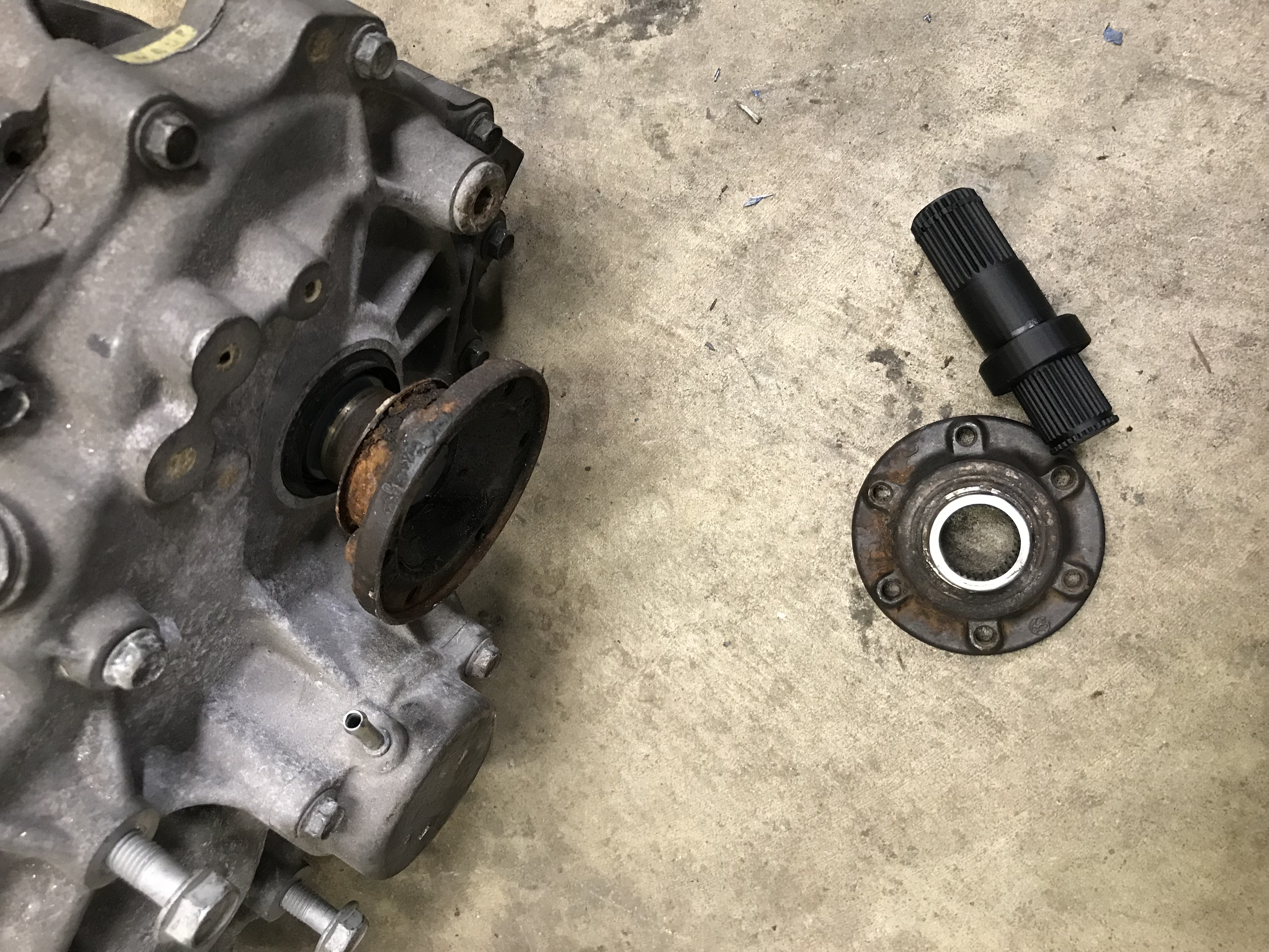

Gearbox stub shafts and flanges:
The leaf gearbox is a small, and strong gearbox. Though its not often it's utilized in conversions.
This for most part, appears to be the issue of cv axles.
me and janik have been discussing about cv stub flanges.
we've started developing a set of stub shafts flanges for the leaf gearbox.
they are going to be a 2 part assembly, this is to increase use case and reduce manufacturing cost.
1: the stub shaft has leaf splines on one end, and 25 spline Subaru on the other.
2: the flange will be a female 25 Subaru spline with a 108mm and 100mm cv joint bolt pattern.
vw type 2 use the 100mm and porsch 930 use 108mm style axle flanges. these bolt patterns are used on virtually all European vehicles. With plenty of material available to machine in custom patterns if required. flanges like these are already available from suppliers like http://www.subarugears.com/
The gearbox has a offset diff in relation to the motor, resulting in different leaf axle joint lengths, accompanied with a bearing support. for simplicity and cost, the bearing support and longer axle joint wont be utilized. One replacement stub shaft design will be used for both sides of the gearbox.

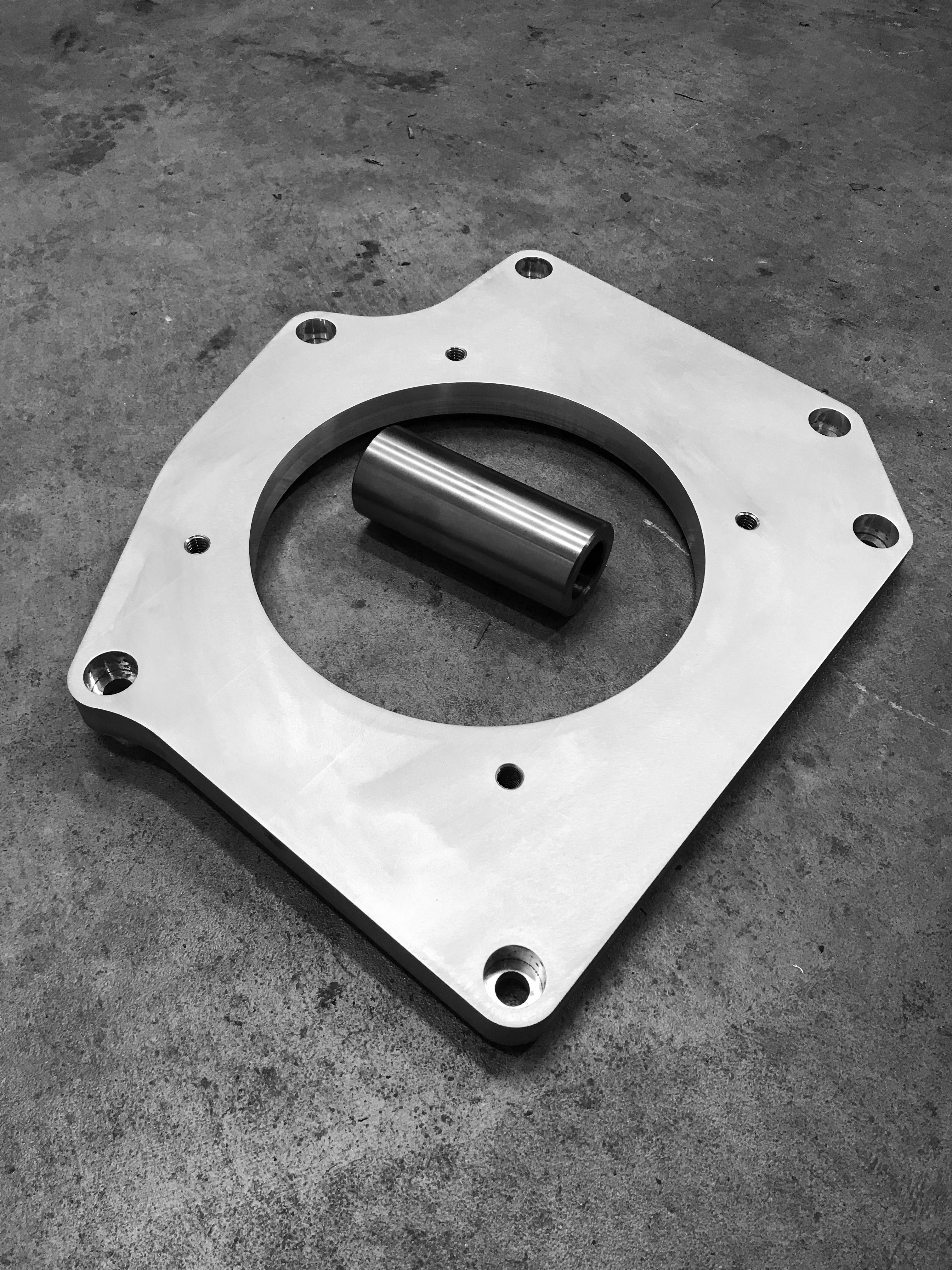

some updates if any one is following:
Gen 2 leaf motor (em57) adapter plates with NEMA B-face bolt pattern are entering production!
Looks like I’m hitting cost targets bang on! they should be available for 330$ cad soon. Ye haw!

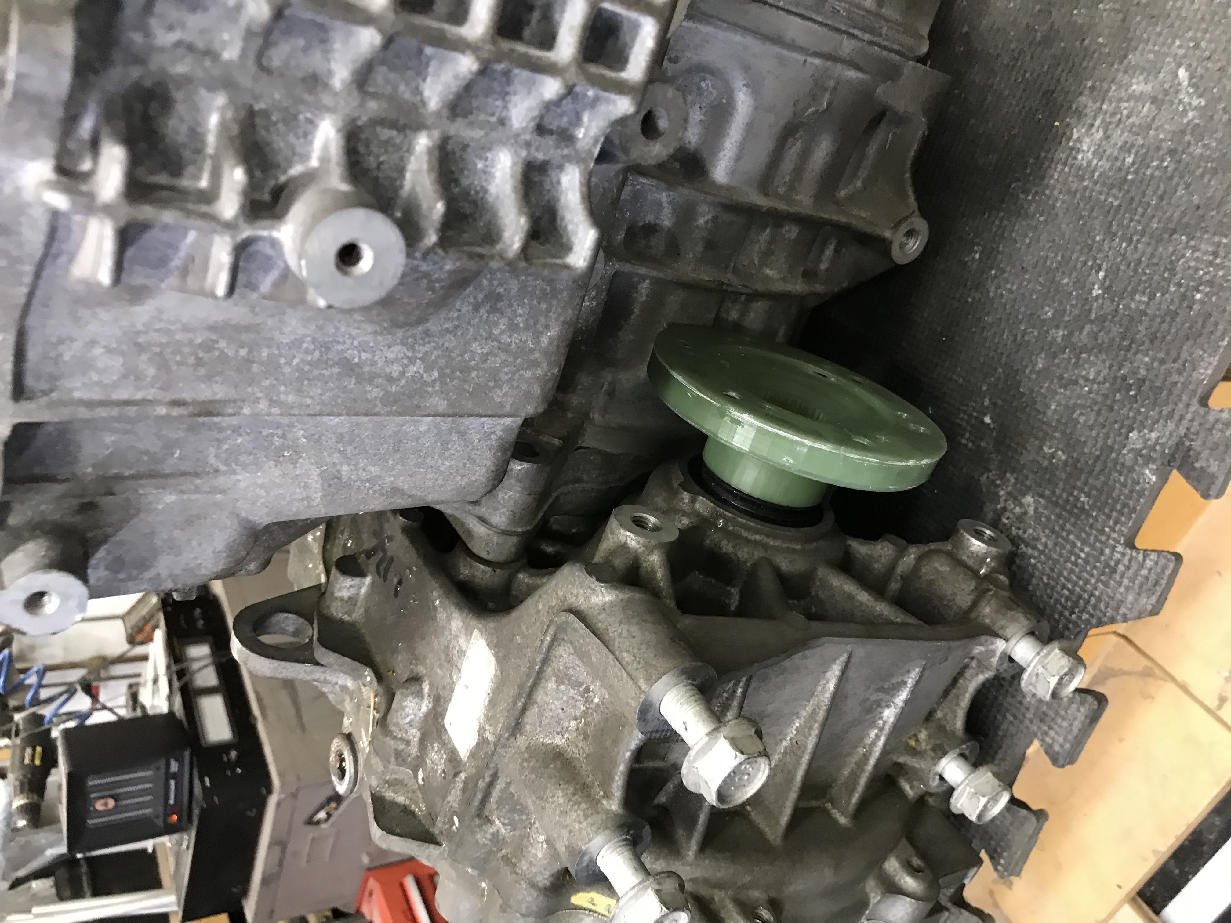

Posted: Sun Nov 28, 2021 10:48 pm
by Bratitude
First mock up print of the stub flange assembly.
Just enough room!
tight between the flange and the motor, but ample room for a 108mm/930CV joint

em57 universal adapter plate drawing
Re: Nissan leaf hardware: adapter plates, couplers, axles, etc
Posted: Sat Jan 08, 2022 2:50 am
by Tremelune
Well that's lovely. Has one been installed in a driving car yet?
Posted: Sat Jan 08, 2022 2:59 am
by Bratitude
Tremelune wrote: Sat Jan 08, 2022 2:50 am Well that's lovely. Has one been installed in a driving car yet?
Cheers.
not this revision with the NEMA B-face pattern, but the older design, which has the exact same mounting position for the leaf side, is in use in as variety of vehicles

I’ve been working on the stub shafts for the gearbox. They have gone through quite a few iterations. Again around the goal of making them easy, inexpensive and universal. what I’ve landed on is a leaf-to-33 spline VW stub shaft.
There are 3 different flanges available from many different suppliers for this vw spline: type 1(90mm), type 2/4 (100mm) and the 930 (108mm)
Using 930 flanges and joints will require shaving the motor casing, as they are just so big. even then, they might not fit.
the last final detail I’m working on is the seals. My original plan was to use the original leaf axle seal. this would result in a flange distance greater than what is on the original vw transaxle.
To Mitigate the odd flange spacing, the design could utilize the VW flange seal surface.
luckily there is a seal that fits both the leaf box and the vw flanges: OD 56mm and 36mm ID
using the flange seal surface will allow a tighter fitment, and will match the spacing of the flanges on a original vw trans axle.

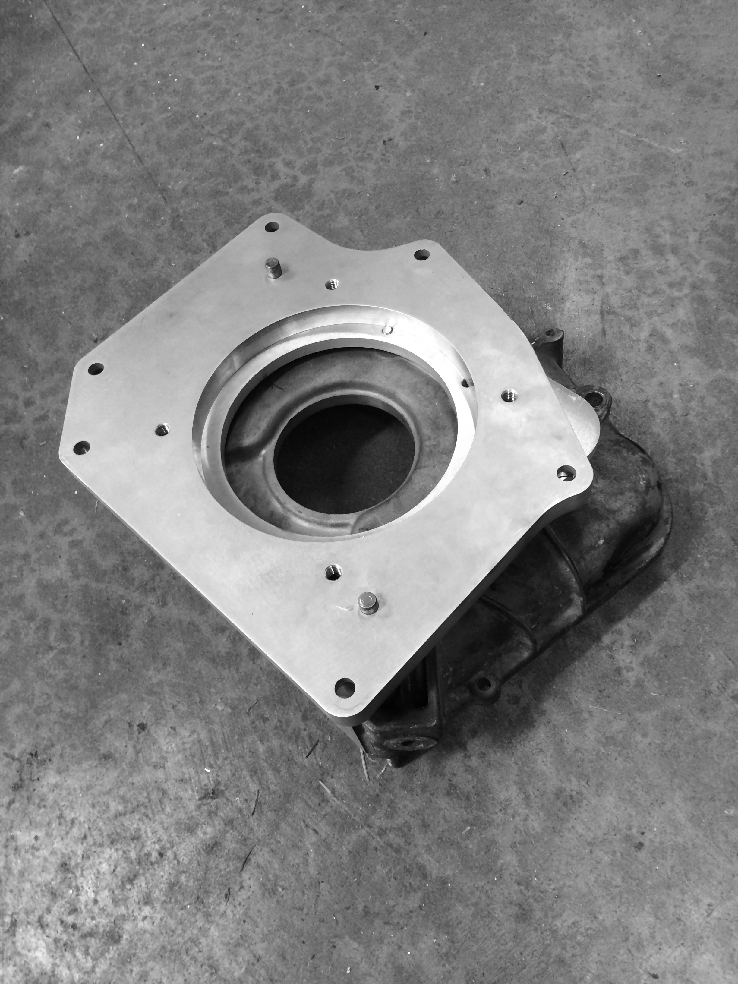

some updates;
stub shafts are in final phase. off to production soon!
adapter plate kits for old vw beetle/bus transmissions and nissan 5speeds.
intermediate bolt pattern is all nema b-face.
next is machine mockups, verify fitment, then off to production!

Good work on the adapter plates, just checking a couple of bits on the VW plate. The two lower fixings on a VW gearbox are studs, is there enough clearance to allow for these. Also, the standard engine is not aligned by the bolts, but by a small lip on the engine ( now adapter plate) that goes into the bell housing. Is this present as I can not see it on the drawings. Hope this helps
Posted: Fri May 20, 2022 1:28 pm
by Bratitude
VWJoe wrote: Fri May 20, 2022 9:30 am the standard engine is not aligned by the bolts, but by a small lip on the engine ( now adapter plate) that goes into the bell housing.
Yup! That is present. The first screenshot shows a lip on the plate.
