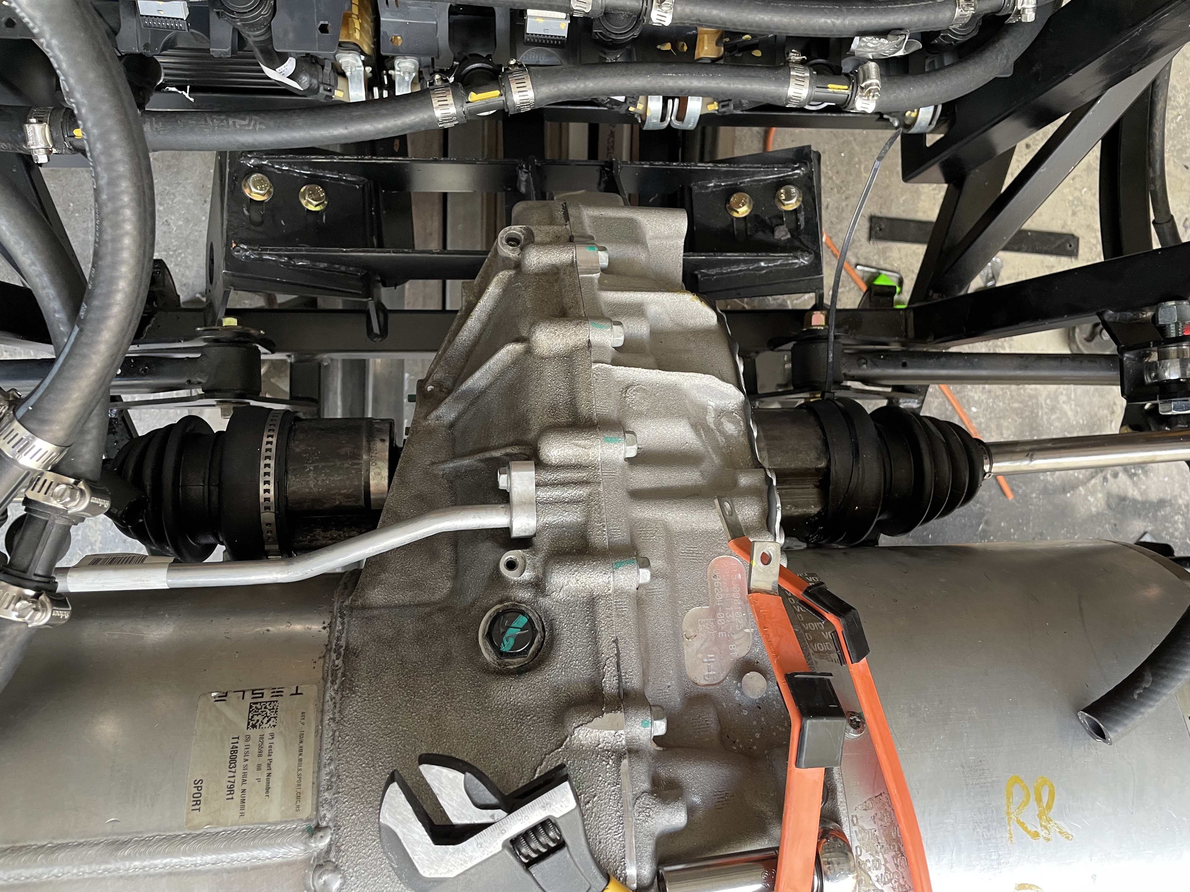

818C + Tesla Sport LDU
After seeing EV-Control make an 818C a few years back I have always wanted to do my own spin on it. I started the project a few months ago but figured it would be worth documenting my progress here in case someone else wants to do a similar project.
Specs:
FFR 818C
Tesla LDU Sport 2014 - From a Model S
2x Chevy Spark EV 2016 batteries (LG Chem V2 based batteries) - (41kwh)
Orion BMS V1
CHAdeMO
Hopefully, CCS support in the future using the LIM!
2x LEAR 3.3kw chargers
Advantics VCU for Tesla LDU control
Delphi 2.2kw DC/DC (please let me know if you have experience controlling it through CAN I can find any DBCs for it)

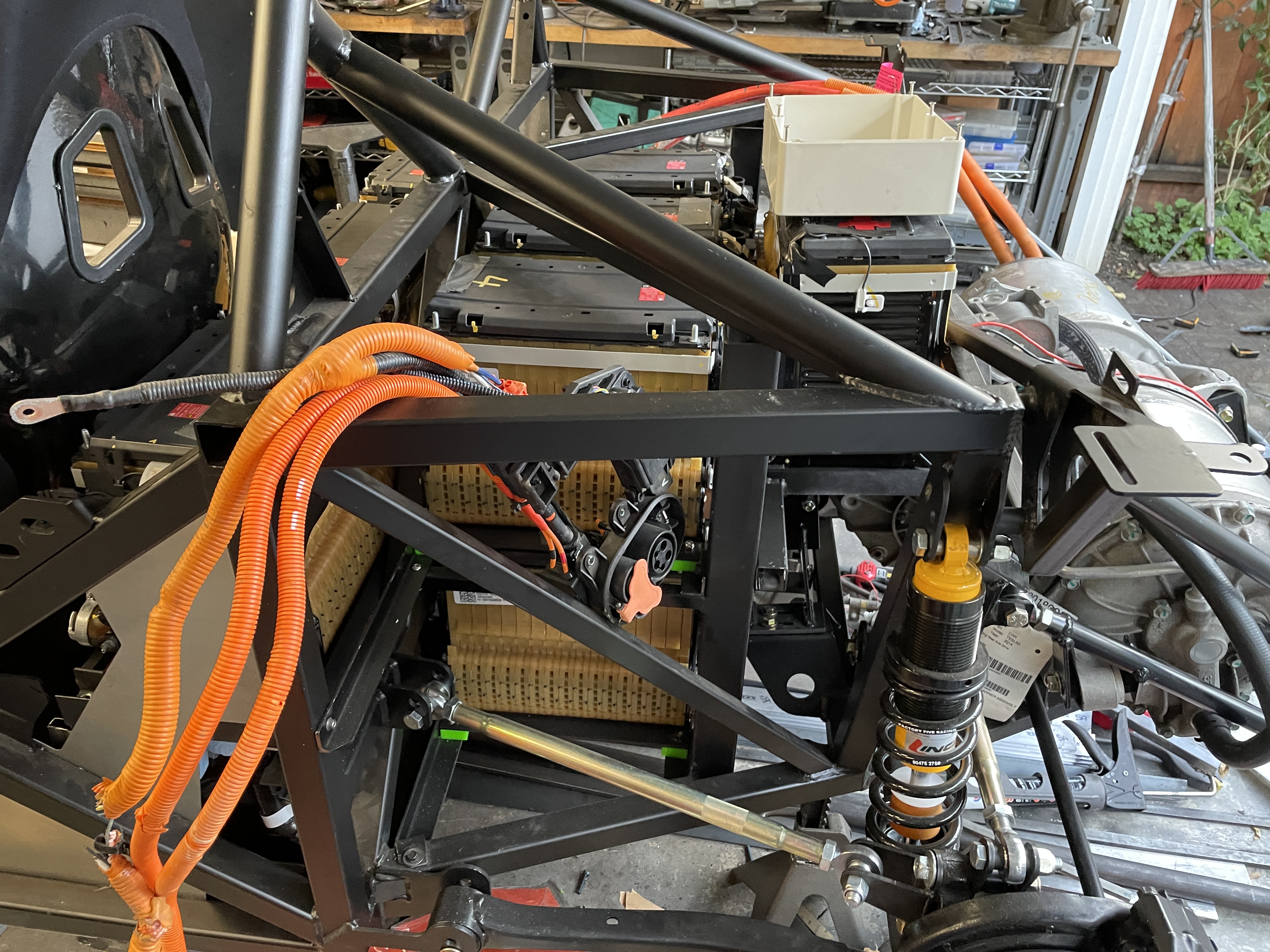

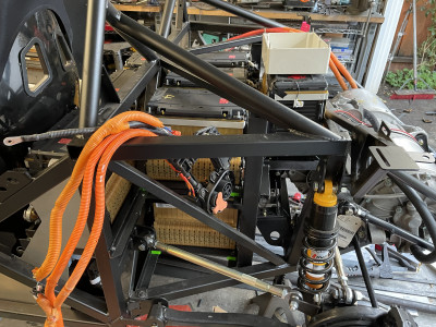

UPDATE:
I have been working on the project pretty steadily so far. I have mounted all of the batteries (54 kwh in total!)
I was able to score a chevy volt 2017 battery pack for $1000 and it only had 65k miles on the car so definitely a snag. I had to at least try to fit it in the car, lucky for me everything seems to work out.
If anyone has knowledge on the CAN DBC for the Delphi 2.2kw DC/DC I would super appreciate them linking me it!
Also picked up a Chevy BOLT CCS port so I can get CHAdeMO and CCS Combo on the car! I was tempted to pick up the K190 module (PLC comms) but I already pushed the wrecker so hard on the price (I got him to sell me the CCS port and HVJB + all HV Aptiva connectors for $180) that I didn't want to annoy him anymore. I plan on repurposing the HVJB to hold all my HV contactors (4) for my DC fast charger junction box.
I found the service manual for the bolt online and have a full pinout of the PLC module I'm curious if it's easier to reverse engineer than the LIM. My parents got me a Saleae Logic 8 for christmas and I'm really itchy to find someone with a fast-charging BOLT that would let me tap into the K190 boxes comms.

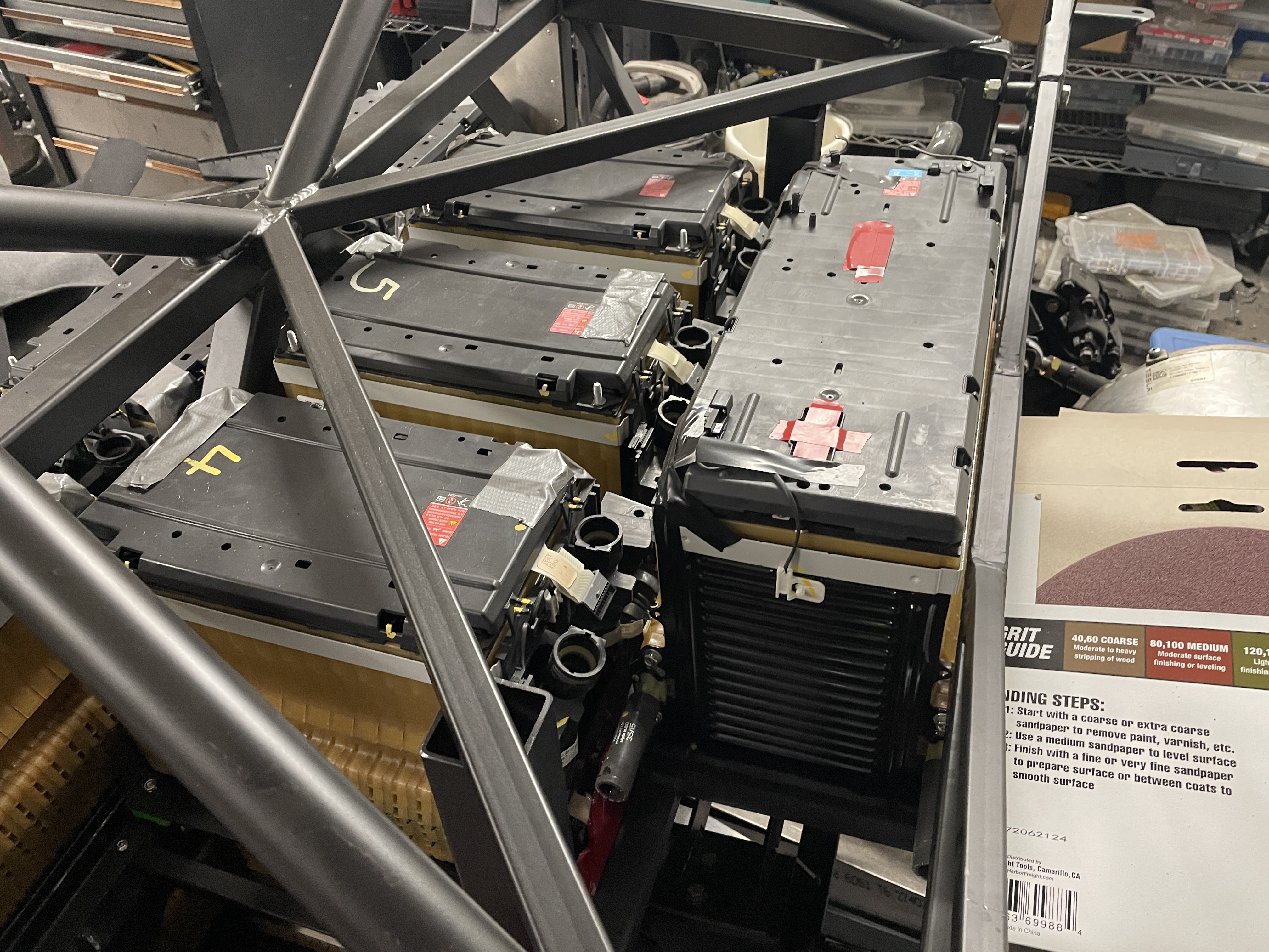

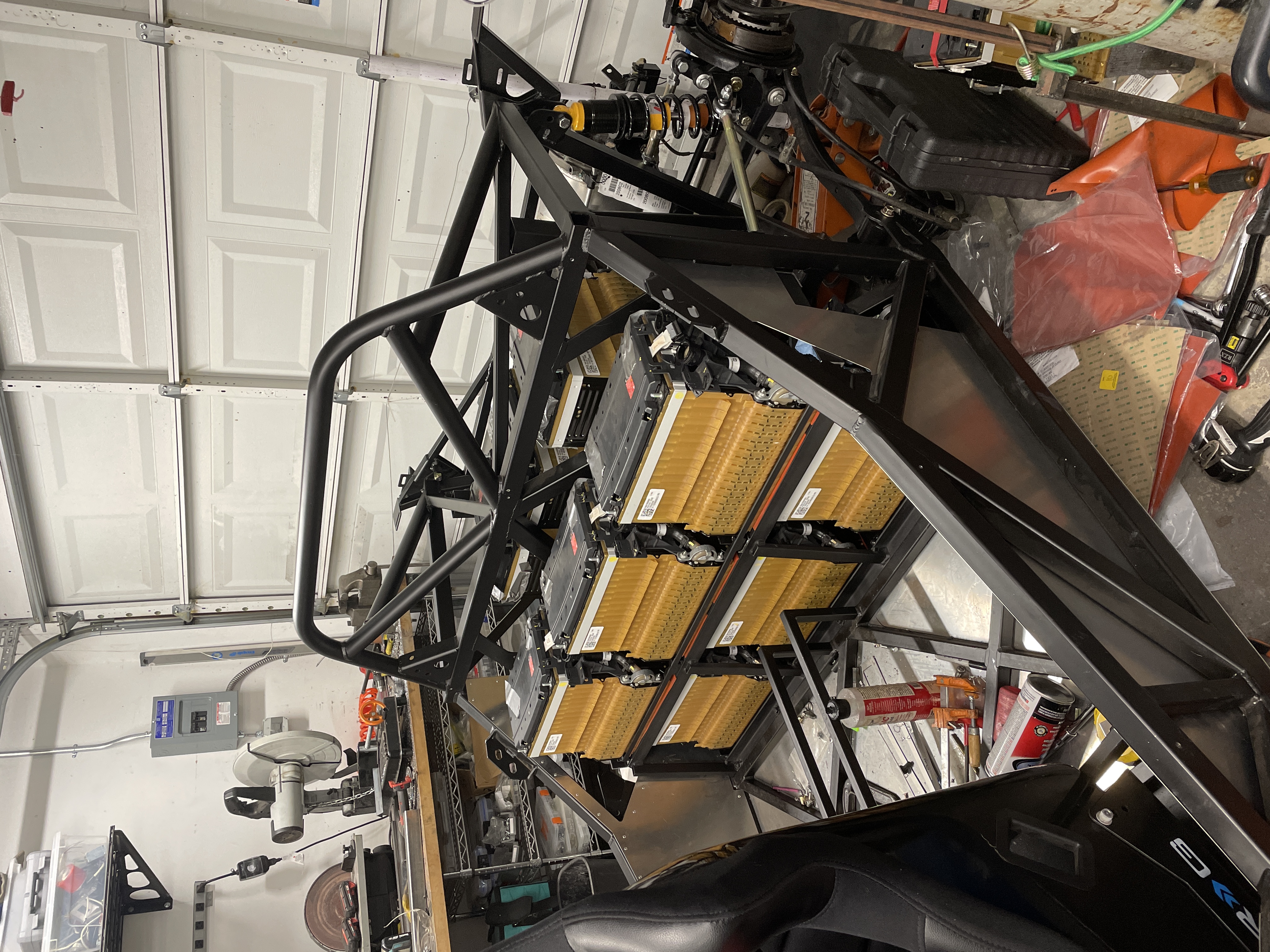

the great thing about the Gen 2 volt/ spark Modules is they are the same + stacking them together is quite easy.
if you get some threaded rod, you’ll be able to remove all the backing plates inbetween the modules to make on big one. You’ll save a lot of space and coolent plumbing.
https://openinverter.org/forum/download ... &mode=view
ratch strap the modules as you take them all apart and make sure you purge all the coolent out. As don’t want coolent leaking between the pouches.

thanks for the tip, However, I don't want to mess with dealing with BMS plugs flex PCB going out at weird angles so I'm just going to keep them as stock modules. I took most of the plumbing from the original pack so it was essentially no extra cost anyway.Bratitude wrote: ↑Wed Jan 05, 2022 3:48 pm the great thing about the Gen 2 volt/ spark Modules is they are the same + stacking them together is quite easy.

There’s no effect on the bms taps on the cells. it’s just the side plates your swaping/removing. they stack like Lego.
Less coolent fittings, less chance of leaks/ failure!

If I fit the modules together like that I would need to bend the BMS taps upwards. Also, I would have to remake the way I hold battery modules down It's a great idea, I just don't feel comfortable modifying that part of the battery pack for now.

upon looking closer at the photos of the spark modules I see what you mean. interesting to see the slight differences between the volt and spark packsKimchiKimKim wrote: ↑Wed Jan 05, 2022 11:26 pm

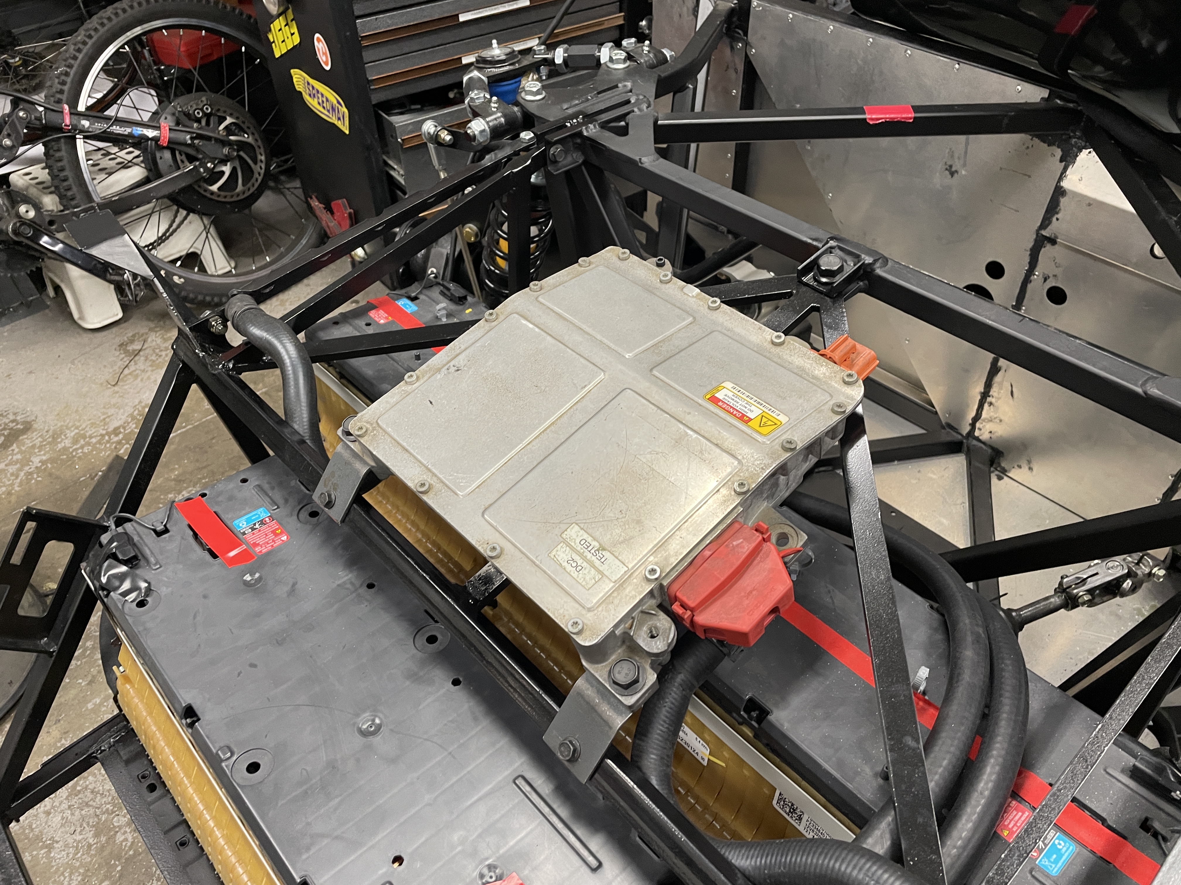

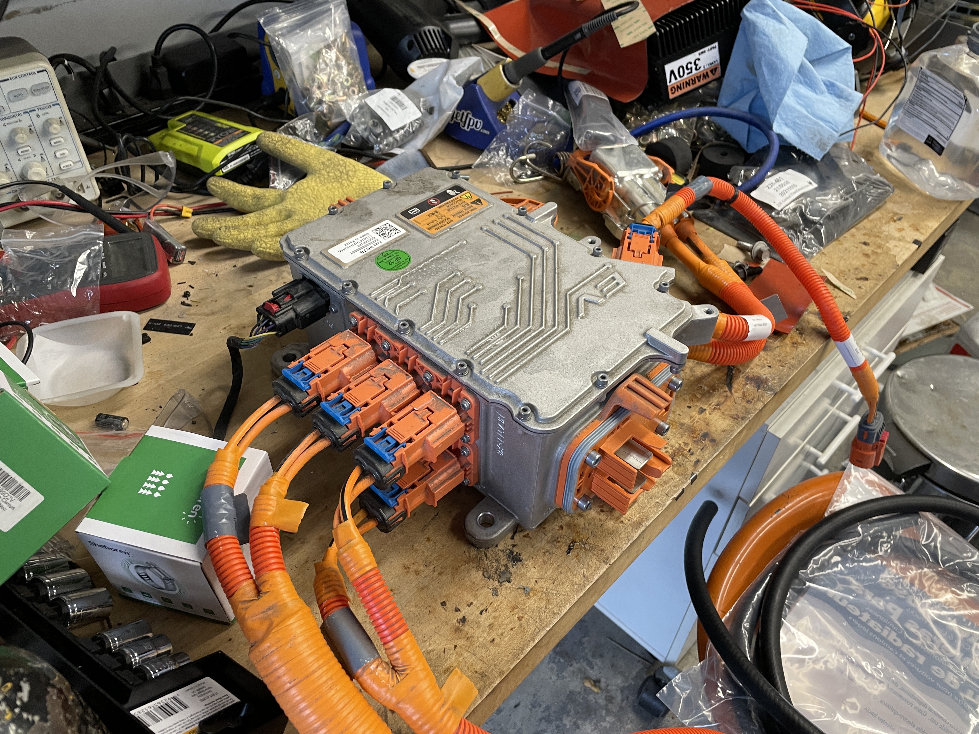

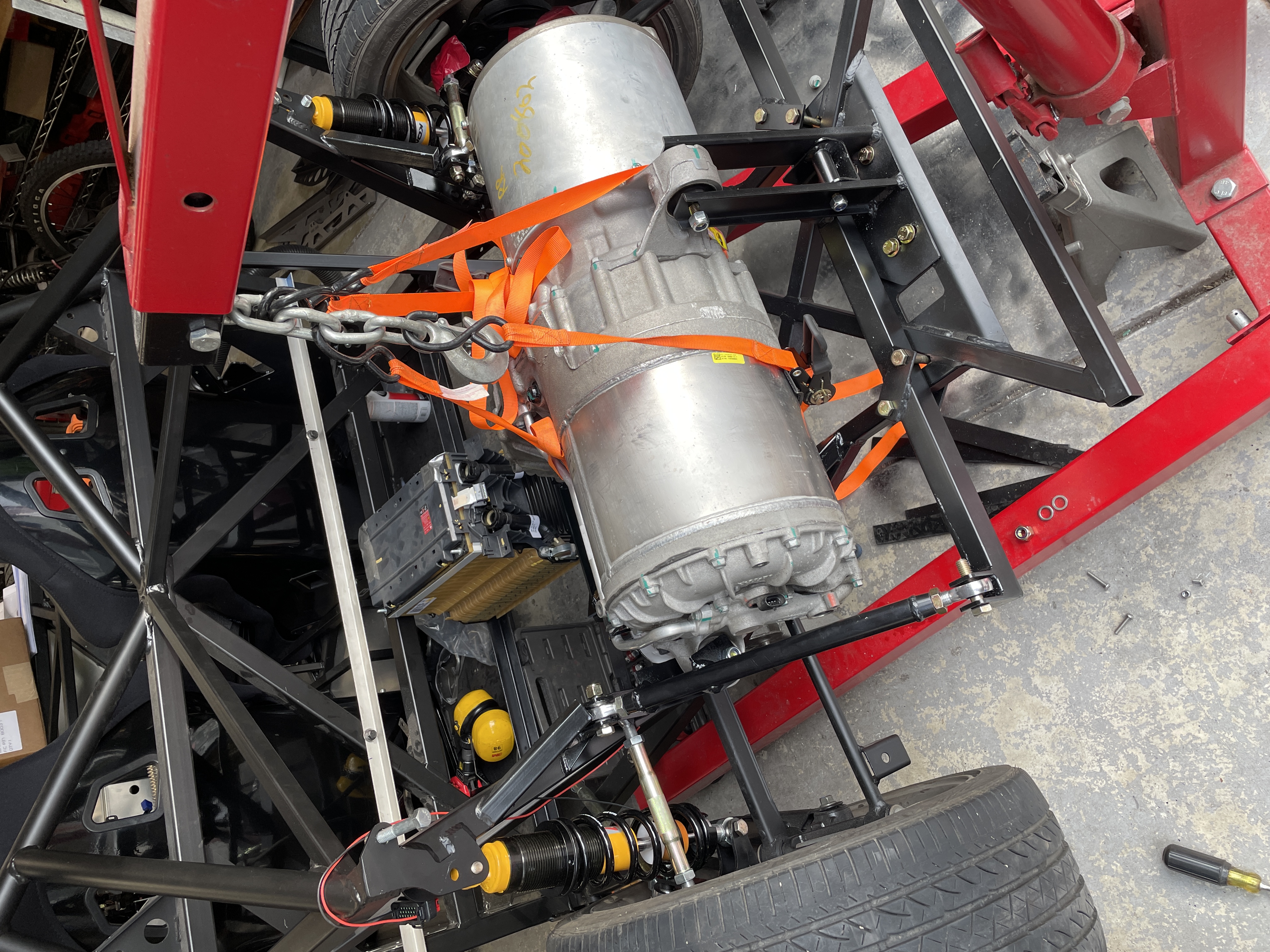

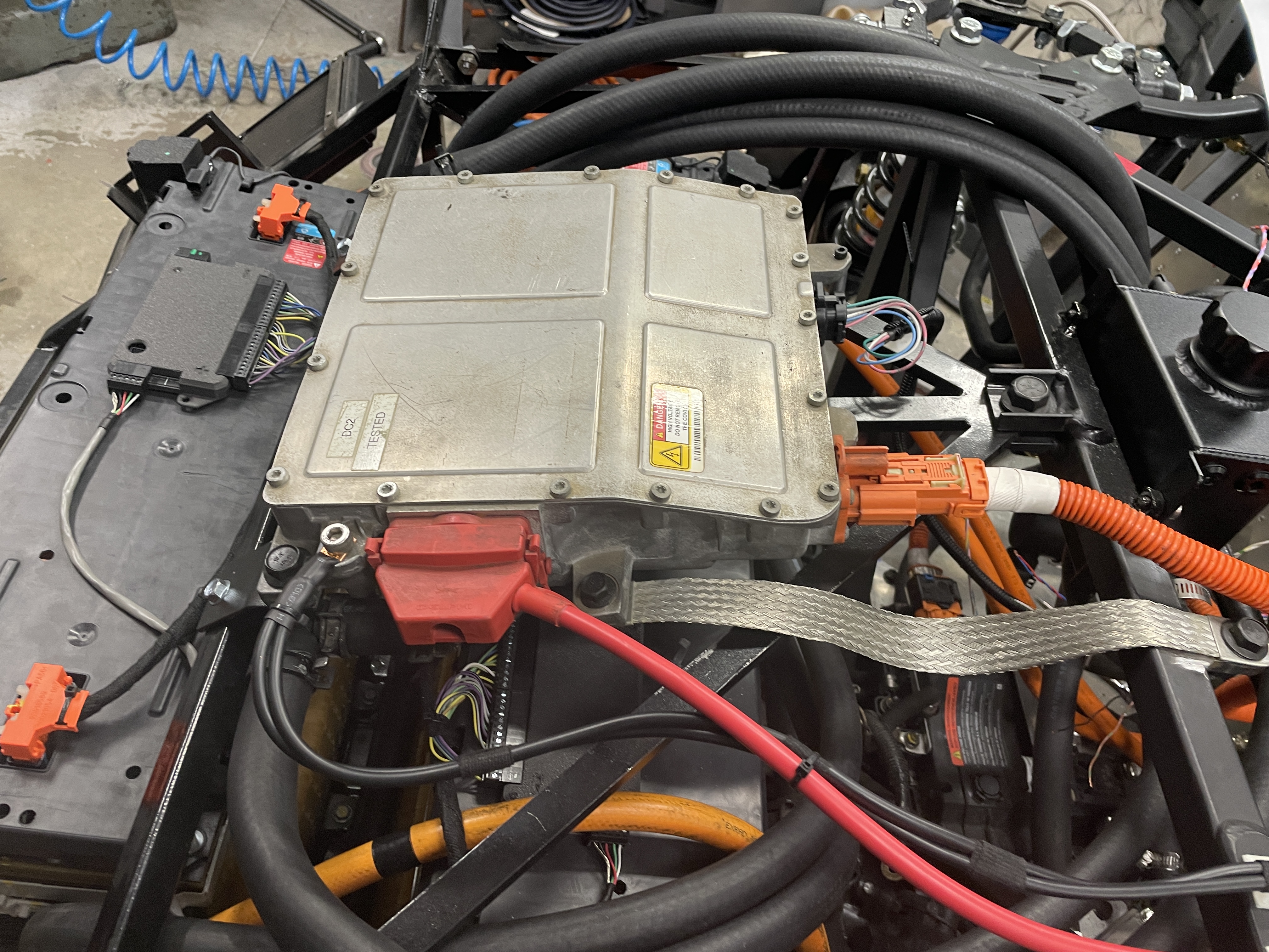

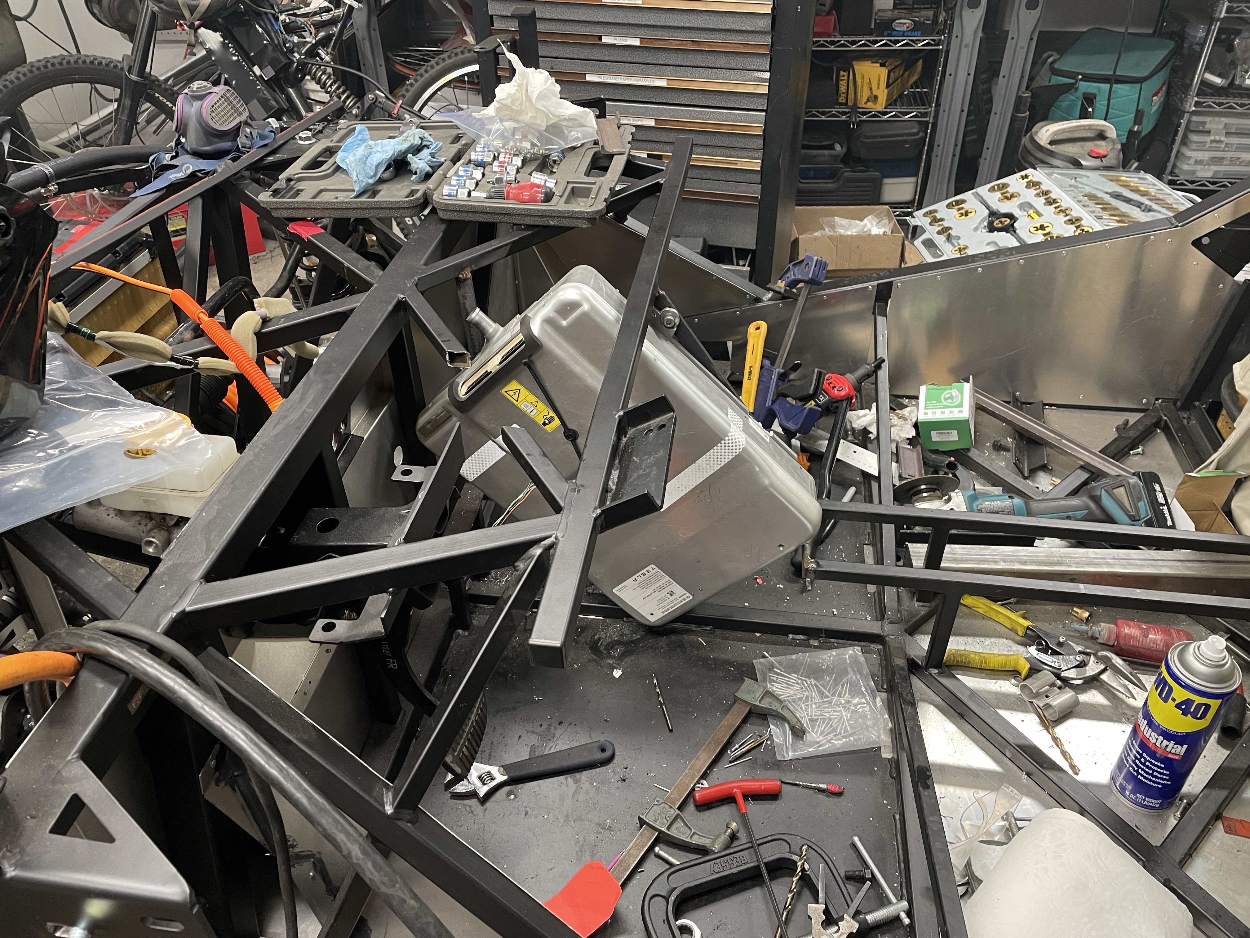

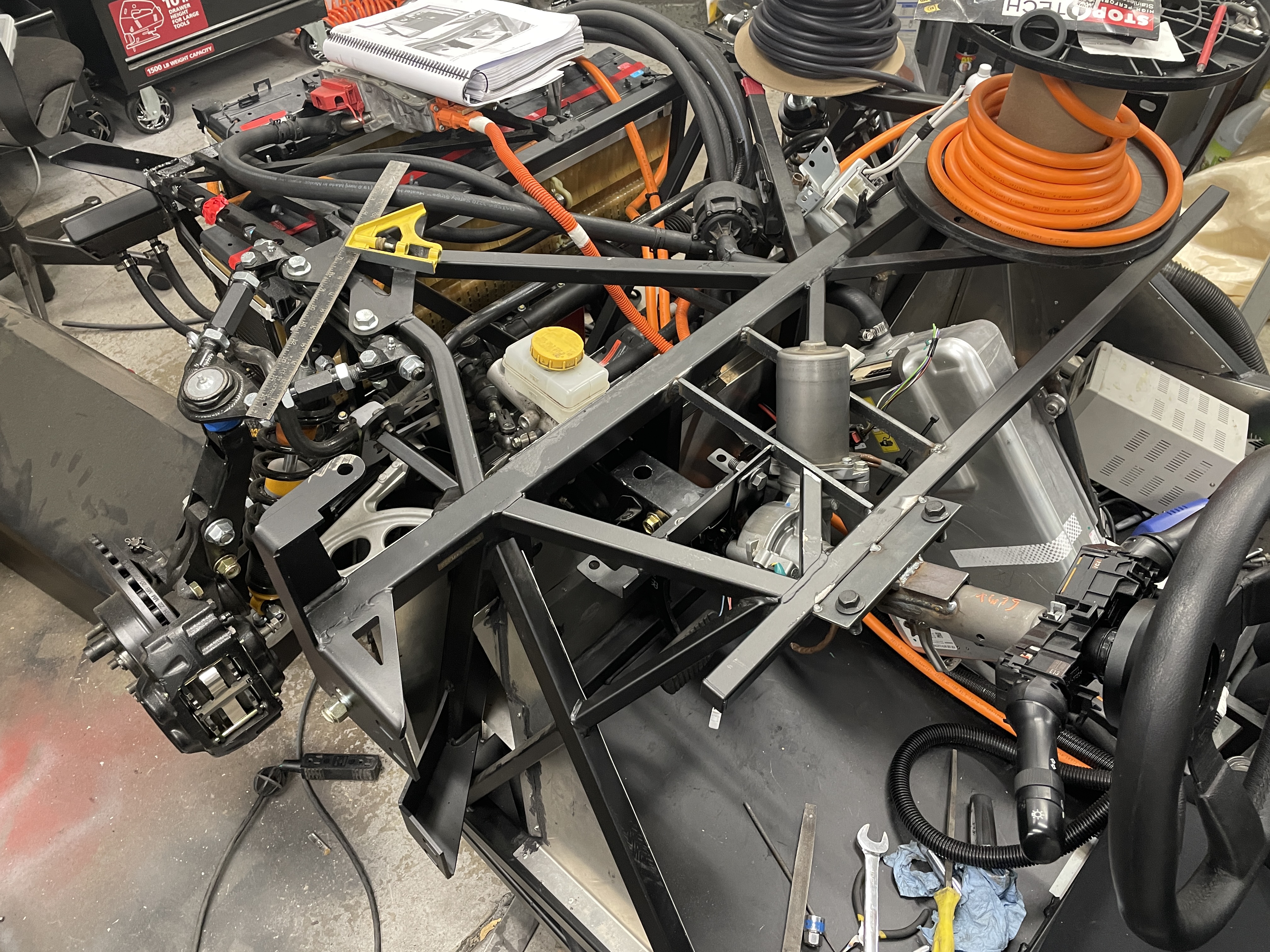

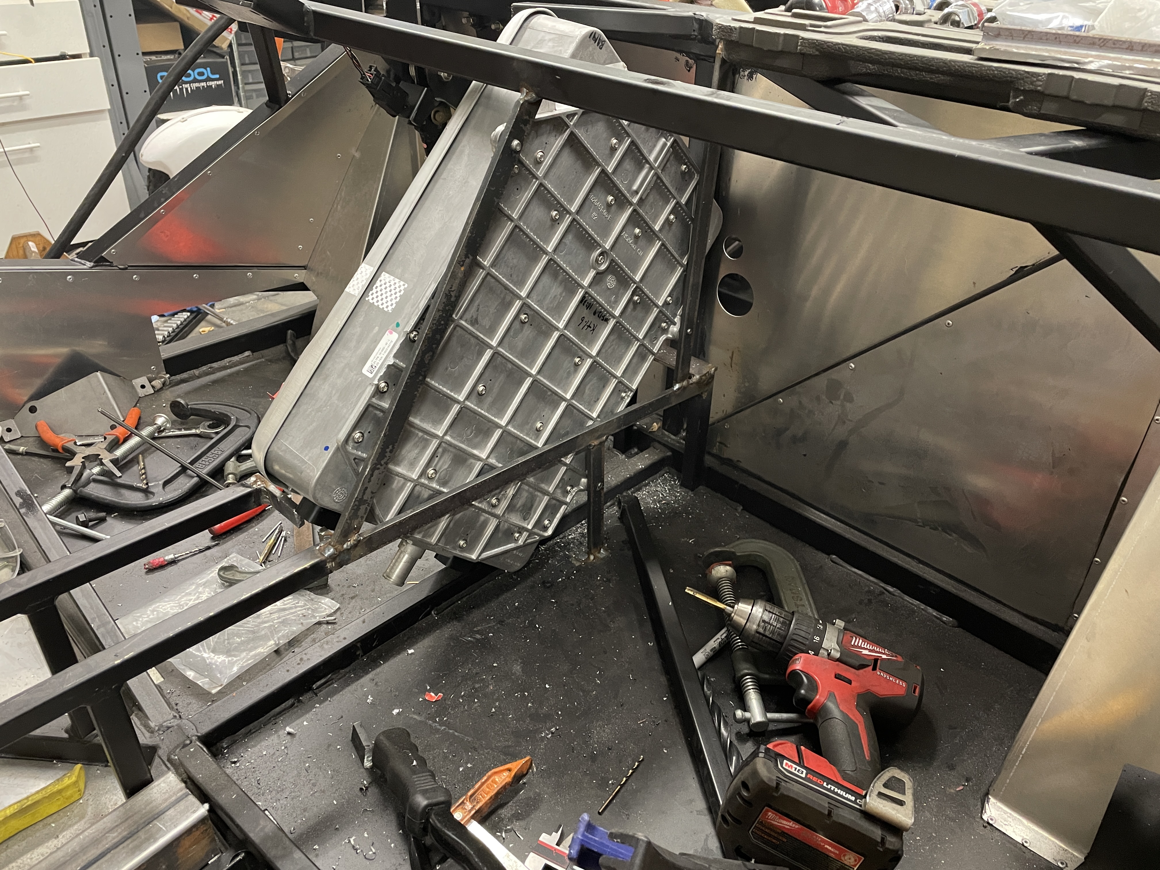

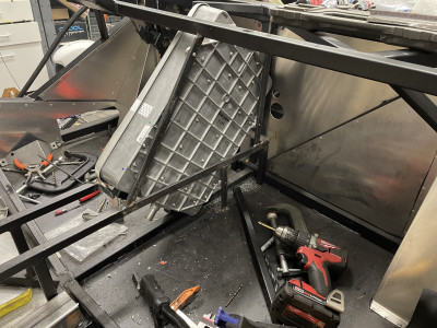

Got the Tesla gen 2 OBC (onboard charger) mounted in the vehicle! I probably spent 4 hours drawing up ideas for where to mount the charger but I'm pretty happy with what I ended up with. A big part of its location is the fact that the gen 2 charger is not weatherproofed (as it sits under the rear seats in a model s. I don't have room under seats and I didn't have enough money to get a waterproof enclosure so it basically had to be mounted in the interior of the car.

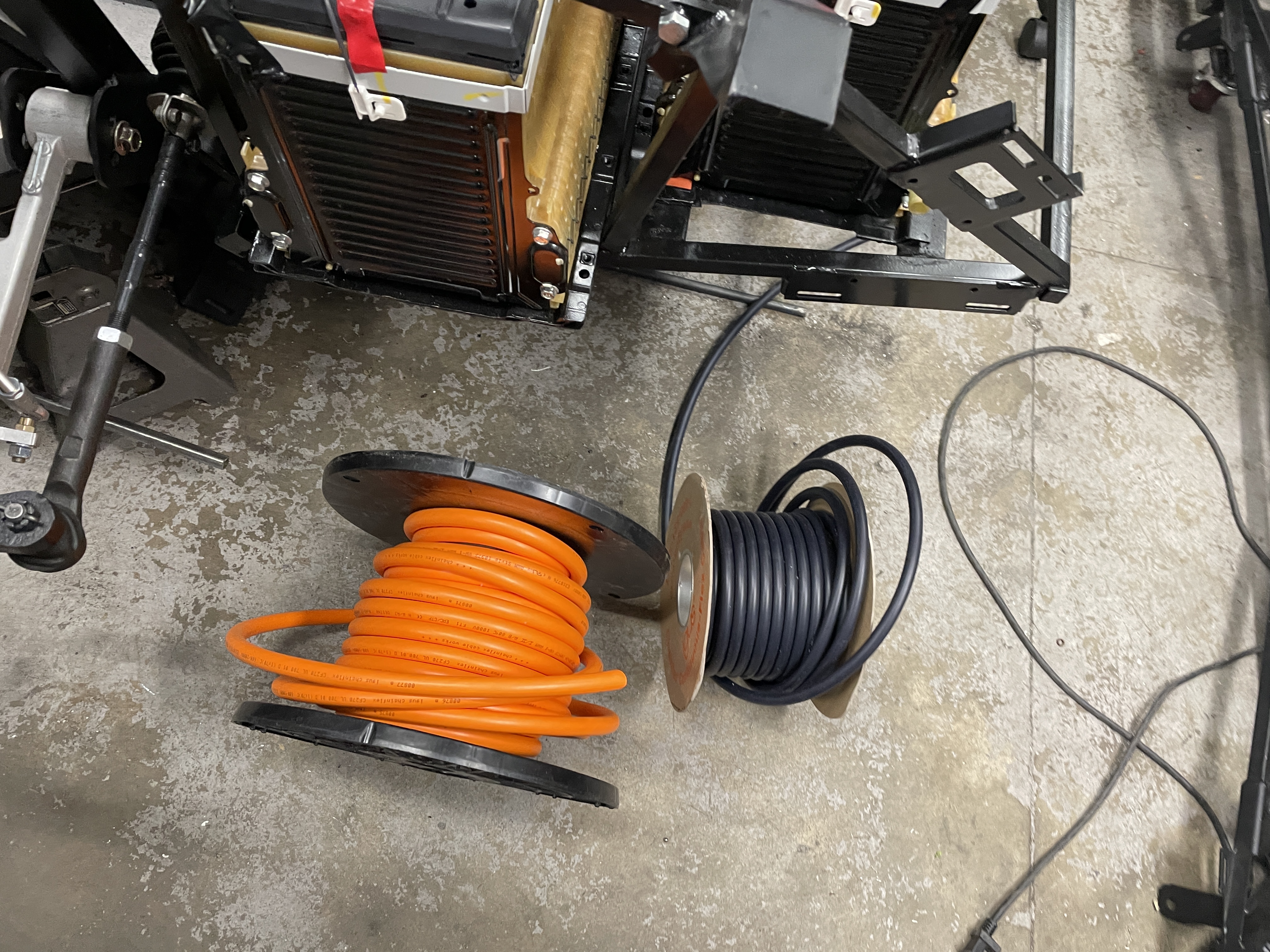

The Igus cable came in the mail today. Super high quality and the RAAL 2004 orange looks super nice brand new! Both SKUs of cable I got are fully shielded.

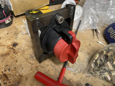

Starting to fab up the emergency HV disconnect mount. I'm making this super overbuilt as the last thing I want is dangling HV.

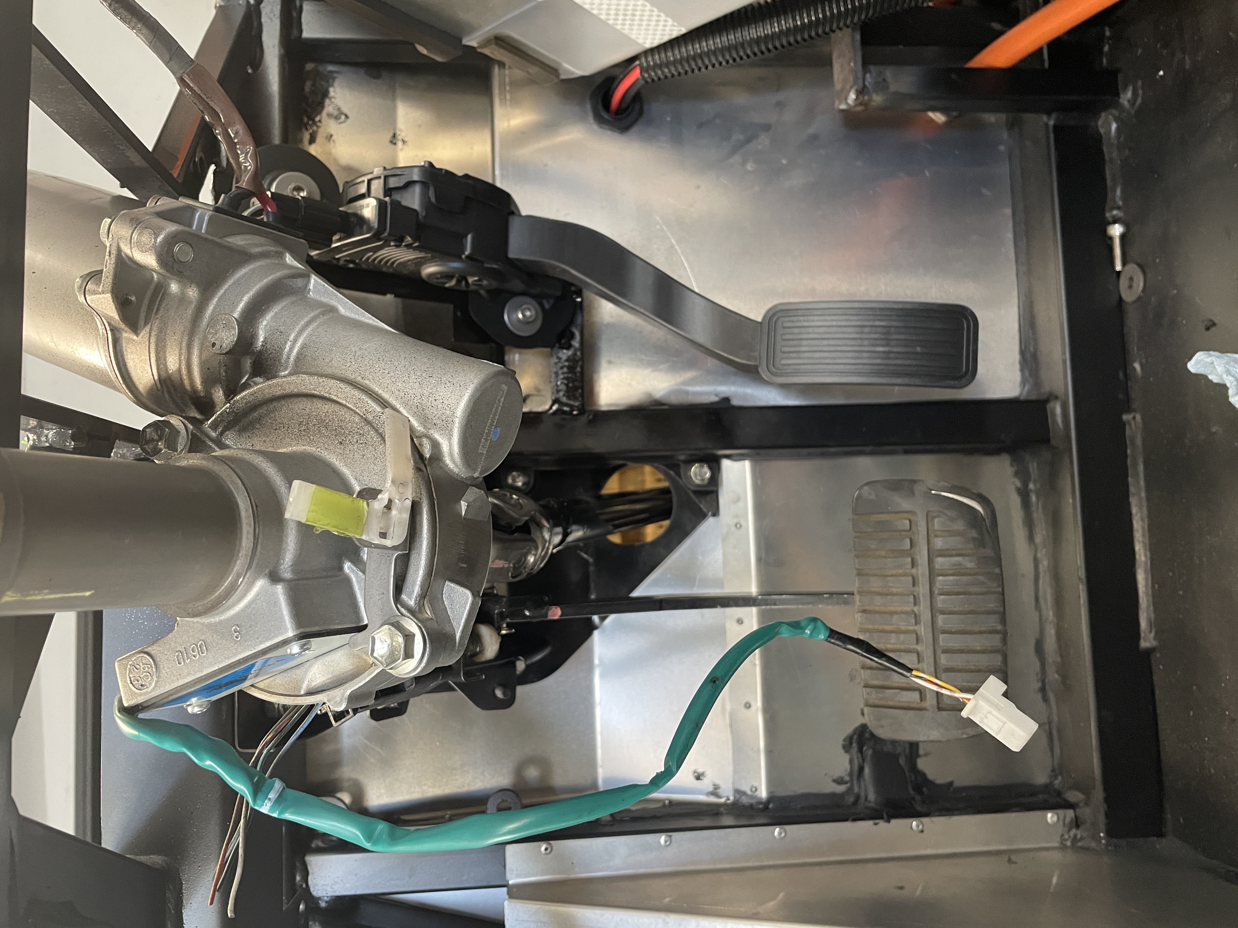

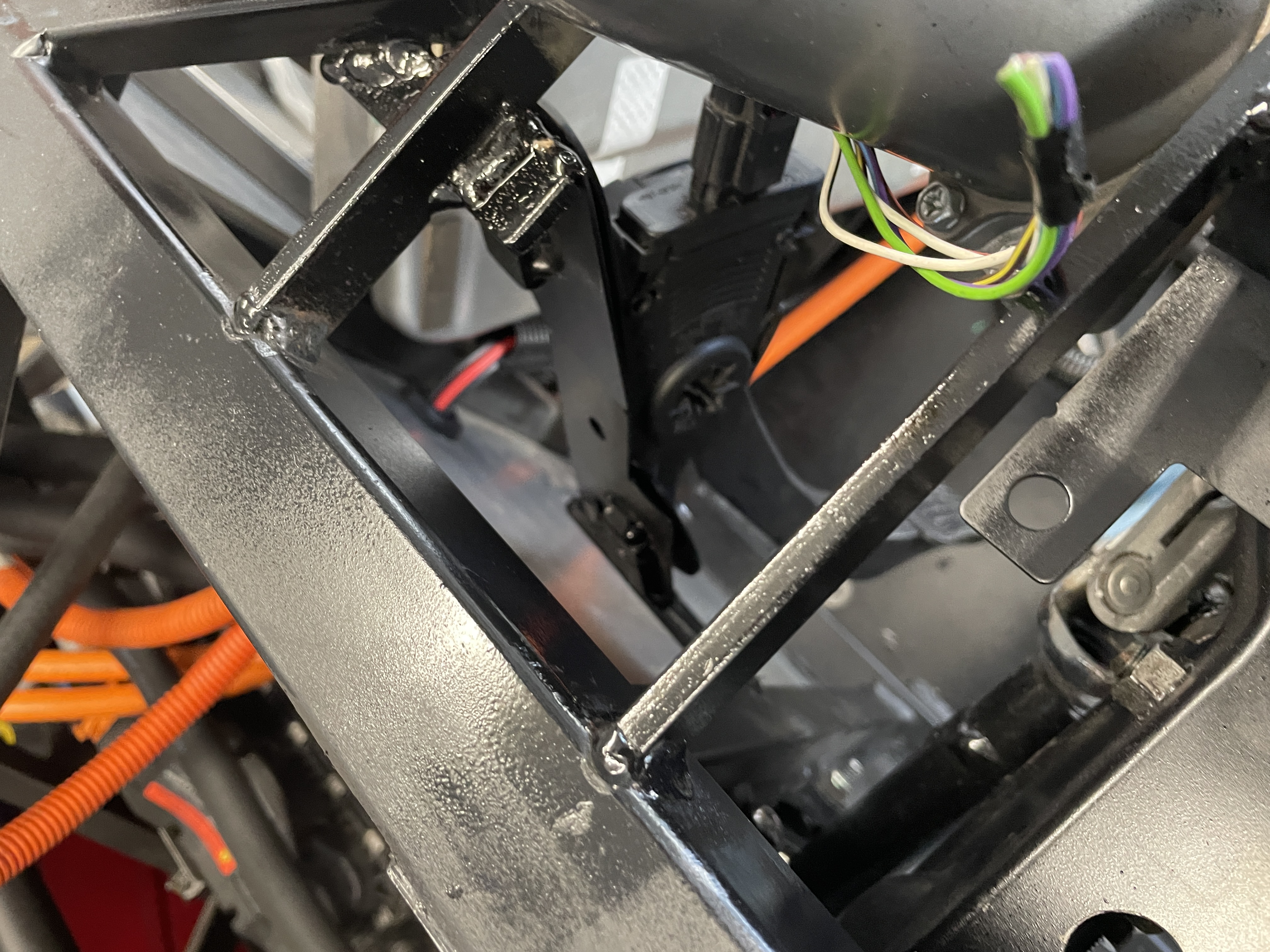

I got my hands on a Prius electric power steering column at pick-n-pull (I also got an inverter gen 3). If anyone is looking for cheap inverters the Prius gen 3 inverter is absolutely beans cheap for what it is. It was $51 for the inverter and $42 for the steering column + control module that goes with it. The column uses the same spline as the Subaru rack I got off my donor, Perfect! I just cut up the console spaceframe up to get the epas motor to fit. I plan on adding CAN control on the column but I need to use my logic analyzer to look into how the control module communicates with the rest of the car. I've been asking all of my friends but none of them have a Prius with the same year as the donor I got it out of. Just another tangent to go down...

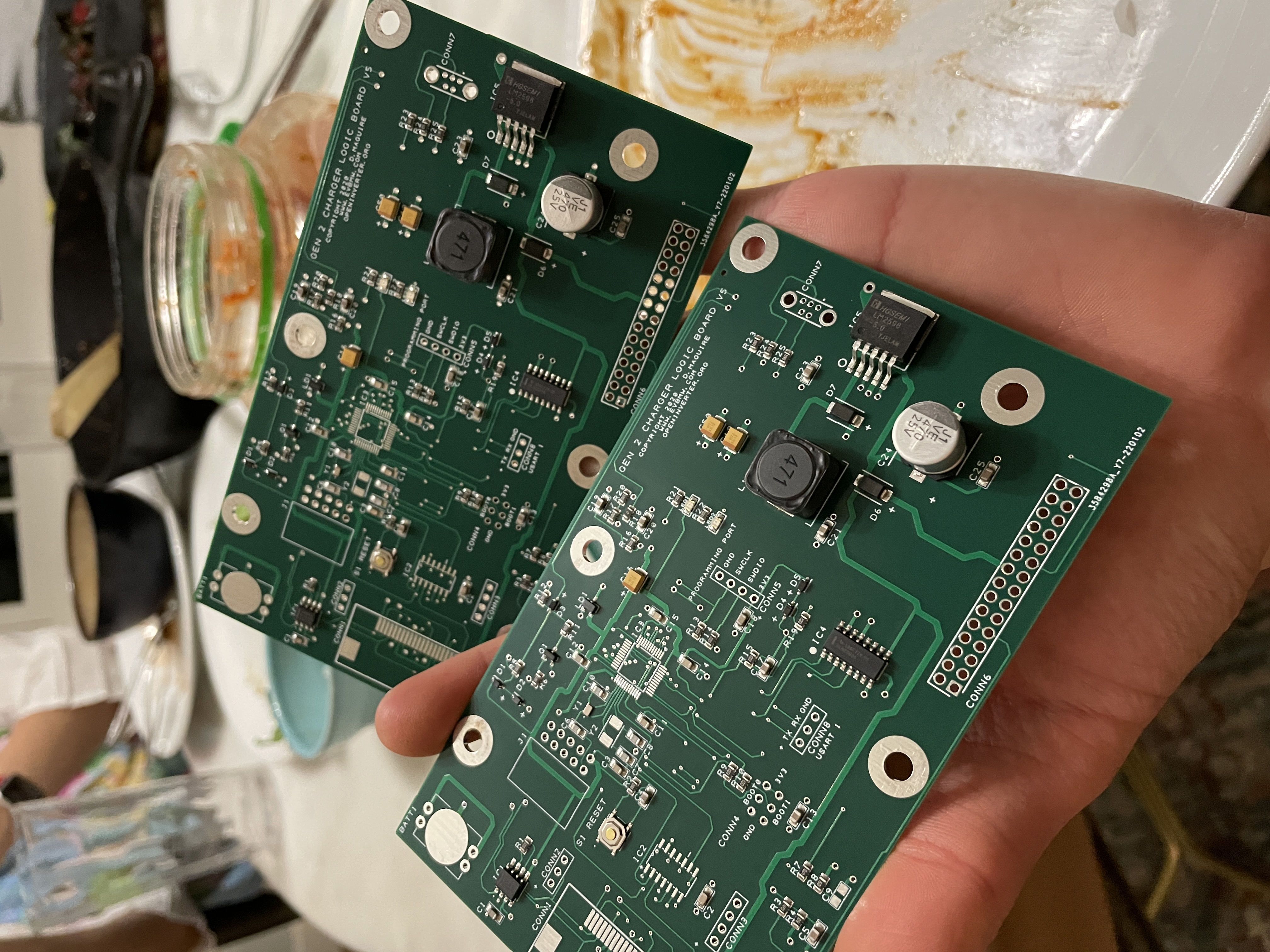

I also got my hands on my JLCPCB shipment of tesla gen v5 PCBs! I will be getting the Huebner firmware as soon as I can confirm that it works using the 5 min of charge time.
That's all for now!

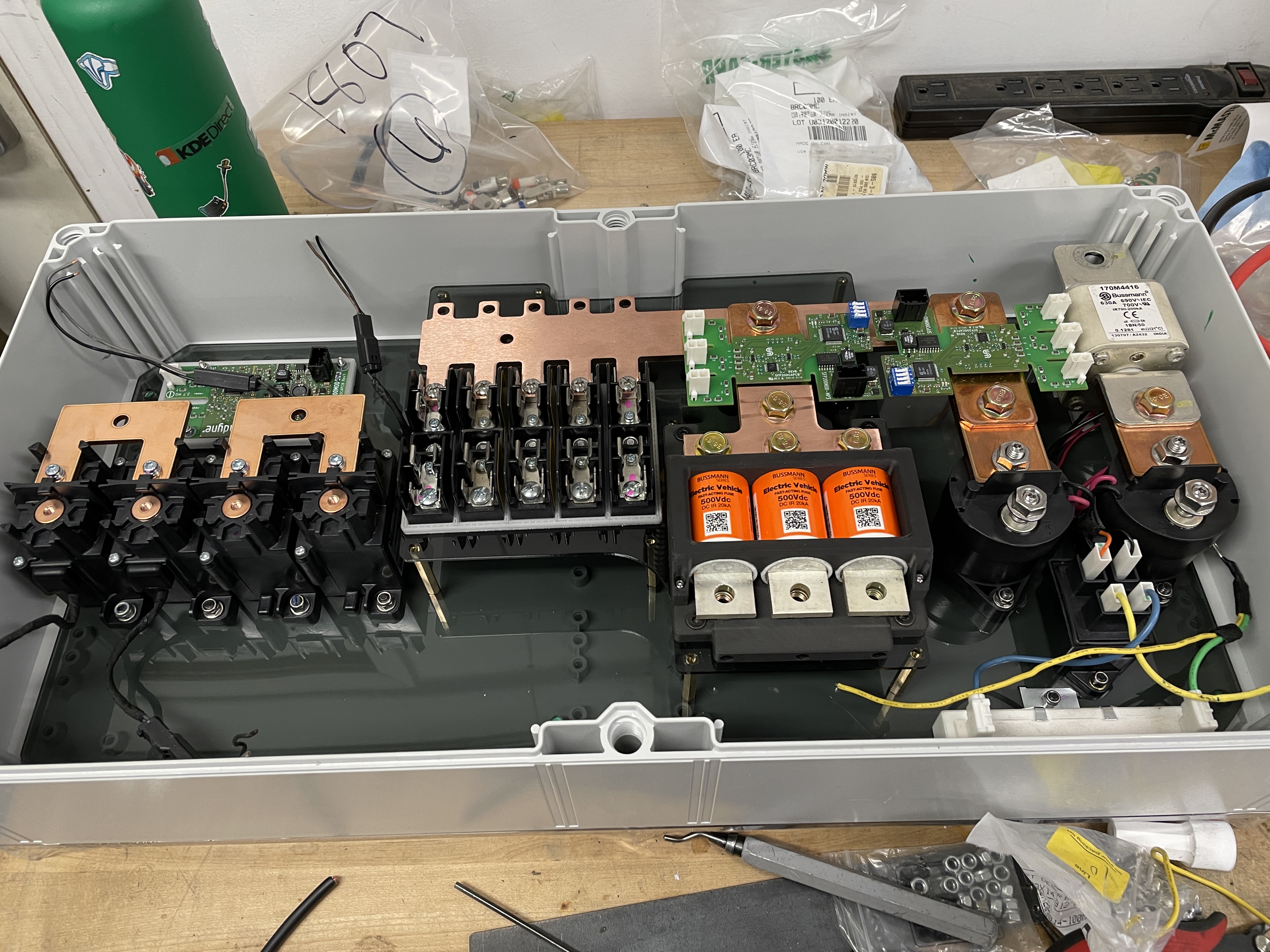

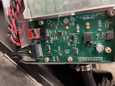

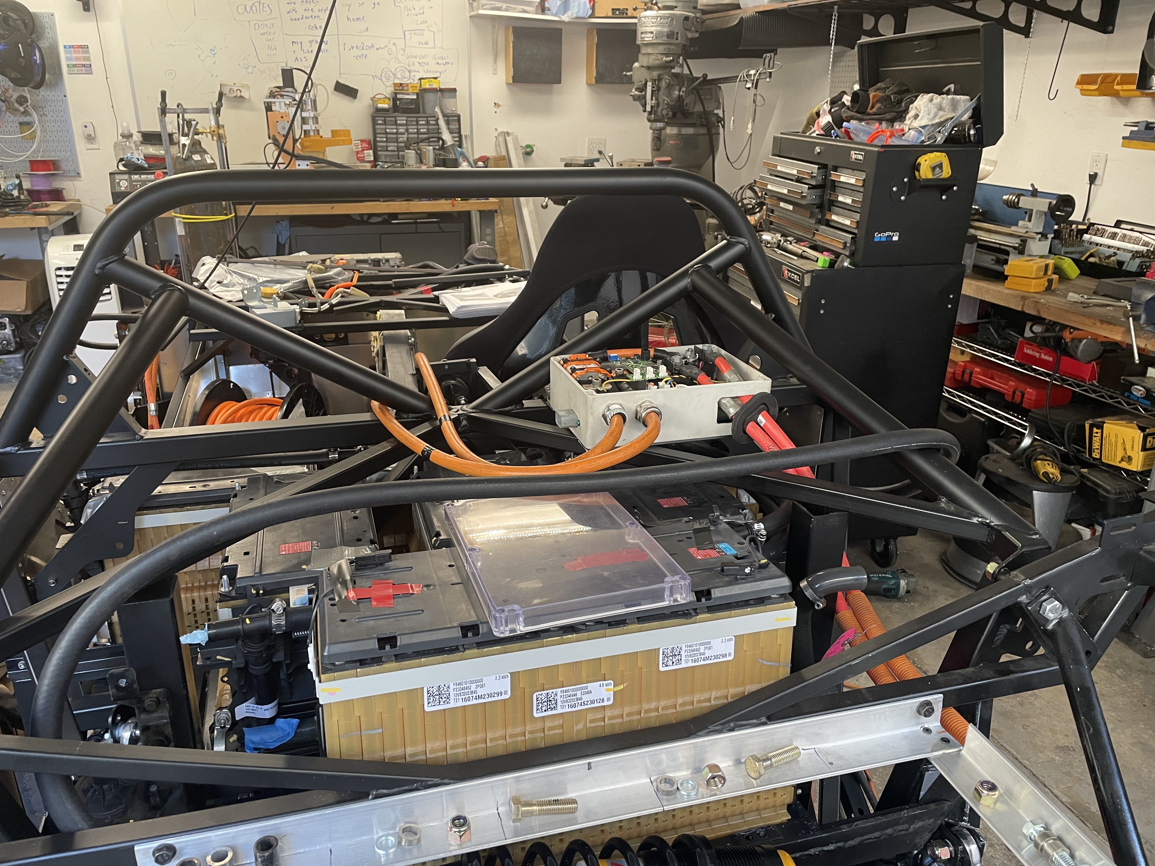

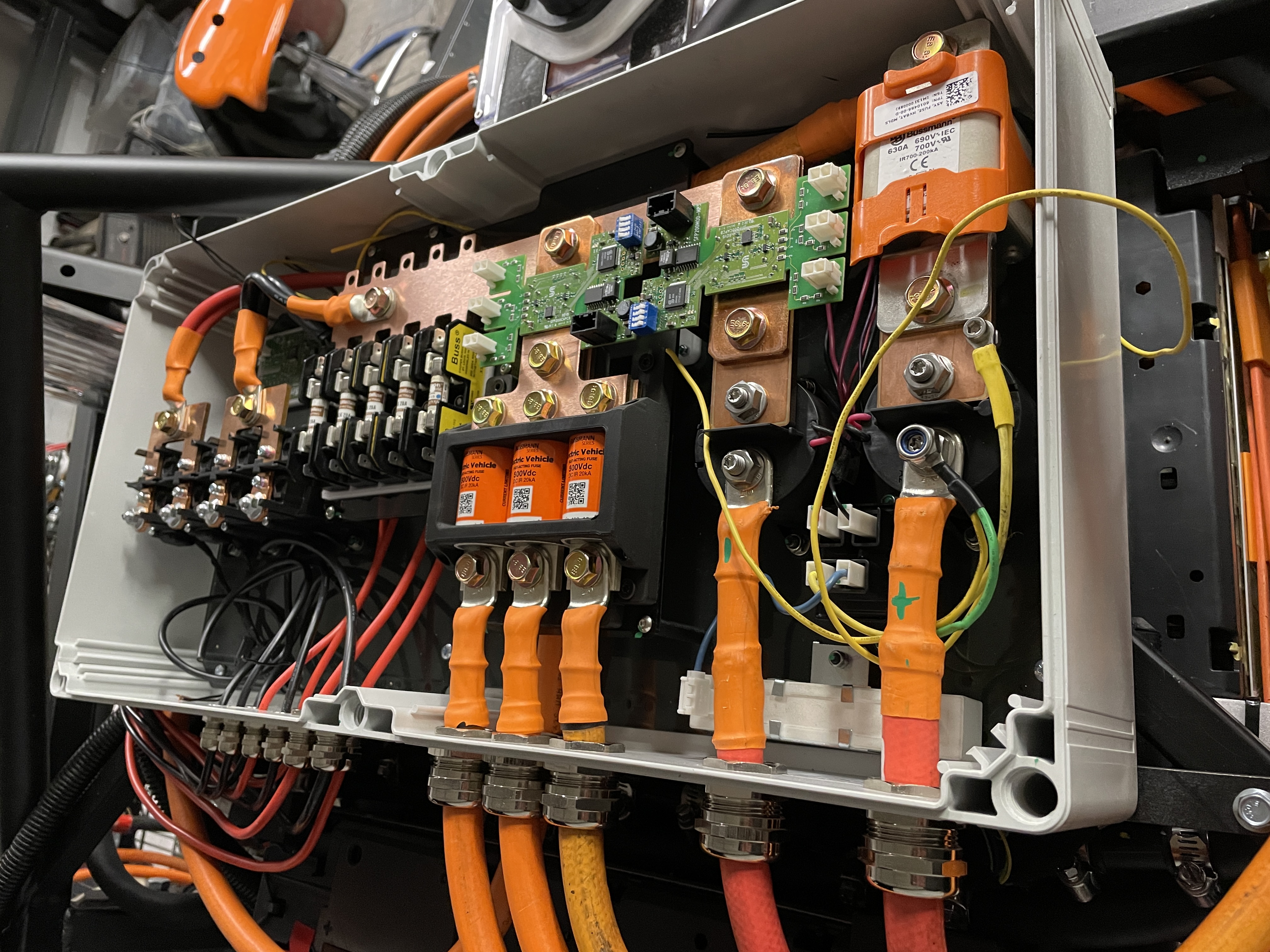

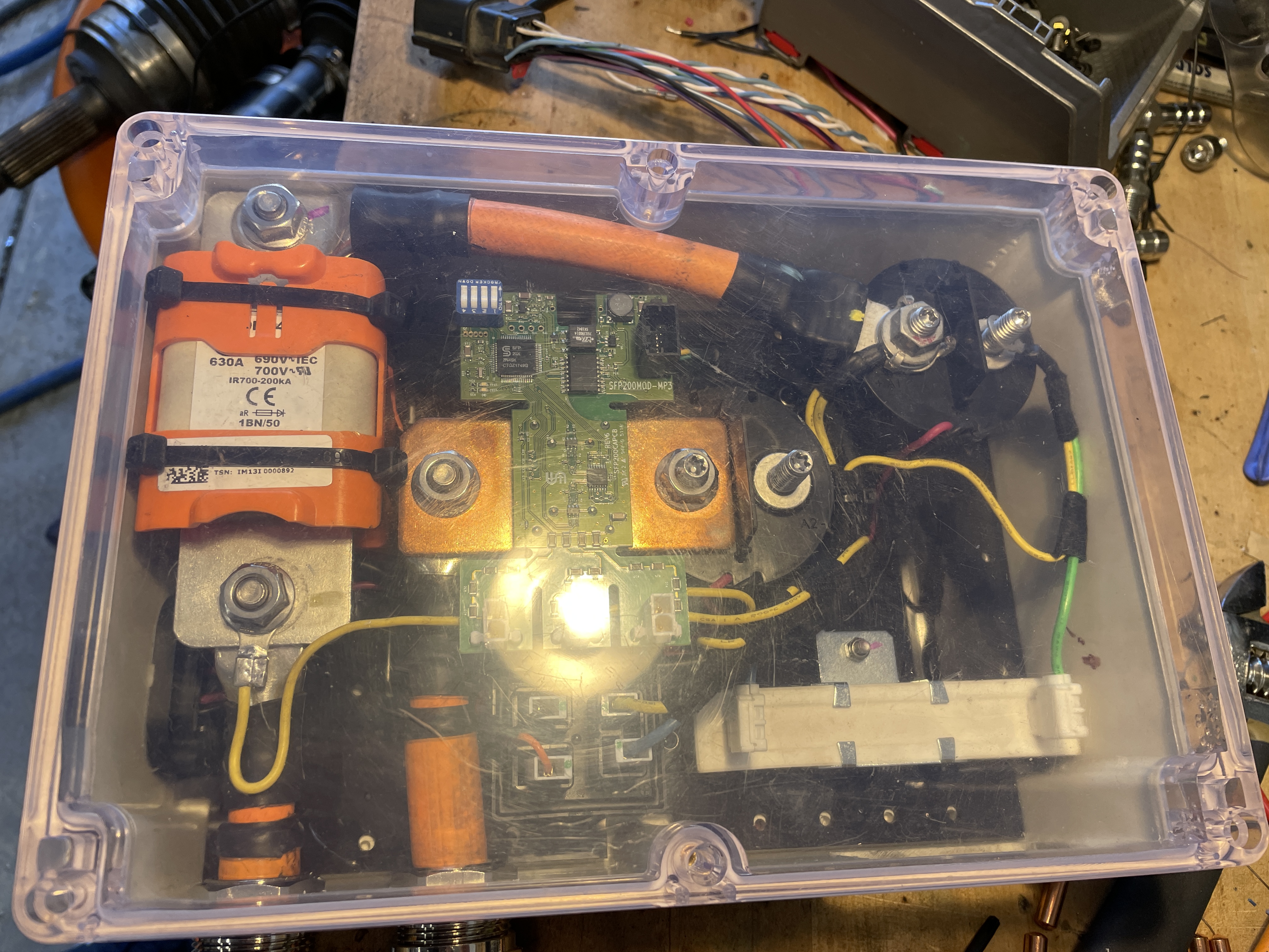

Worked on the HVJB for the Tesla drive unit as well as got the charger logic board working. I sadly need to add a few parts to I had to pull it after I took that picture. I'm also building the negative HJVB (since I am using 3 separate parallel strings. This means that I need to move away from the Orion BMS and instead will be using ZEVA BMS24 as well as some custom firmware that I will have to write up to support 3 parallel strings since that is not incorporated.

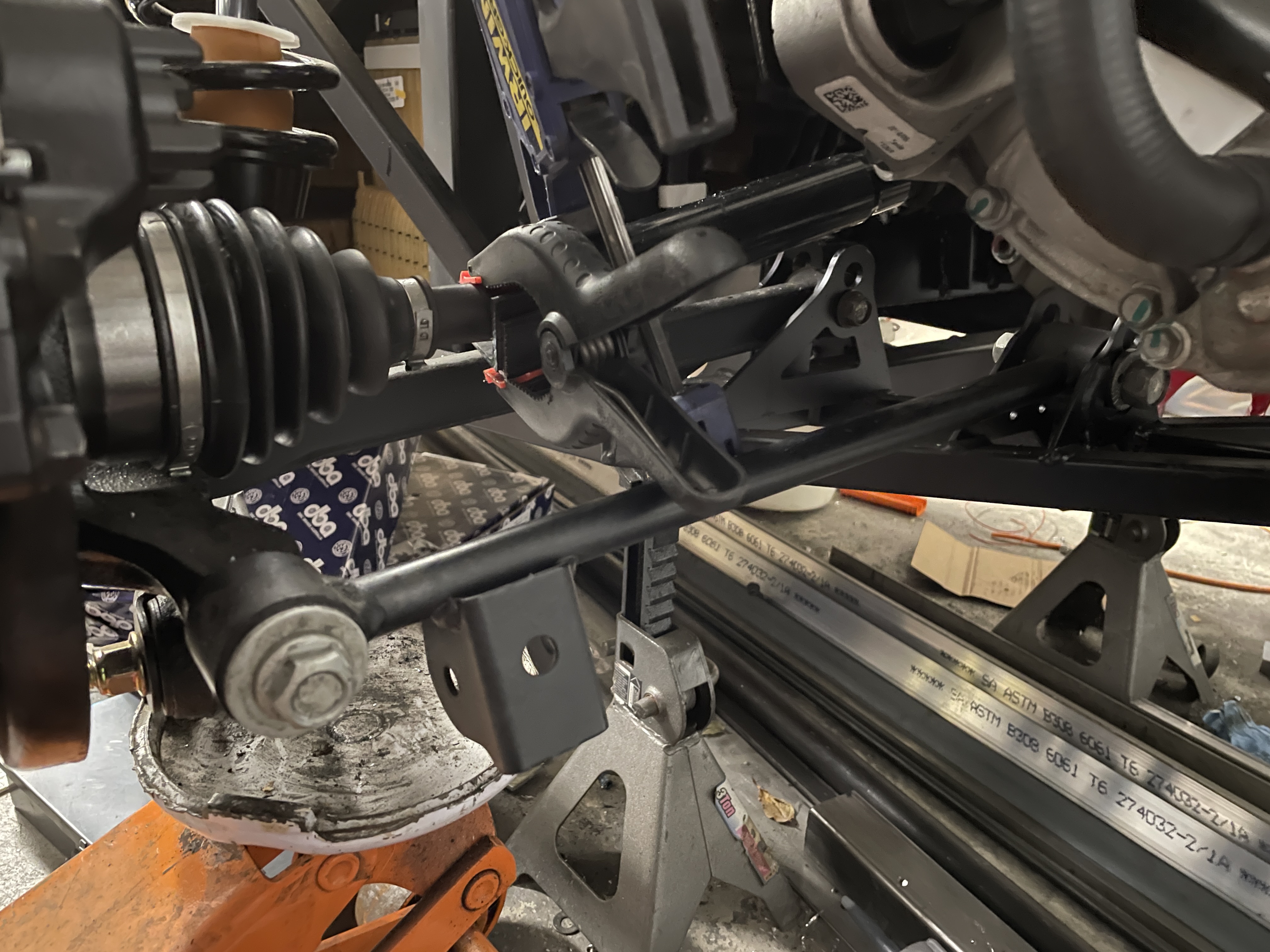

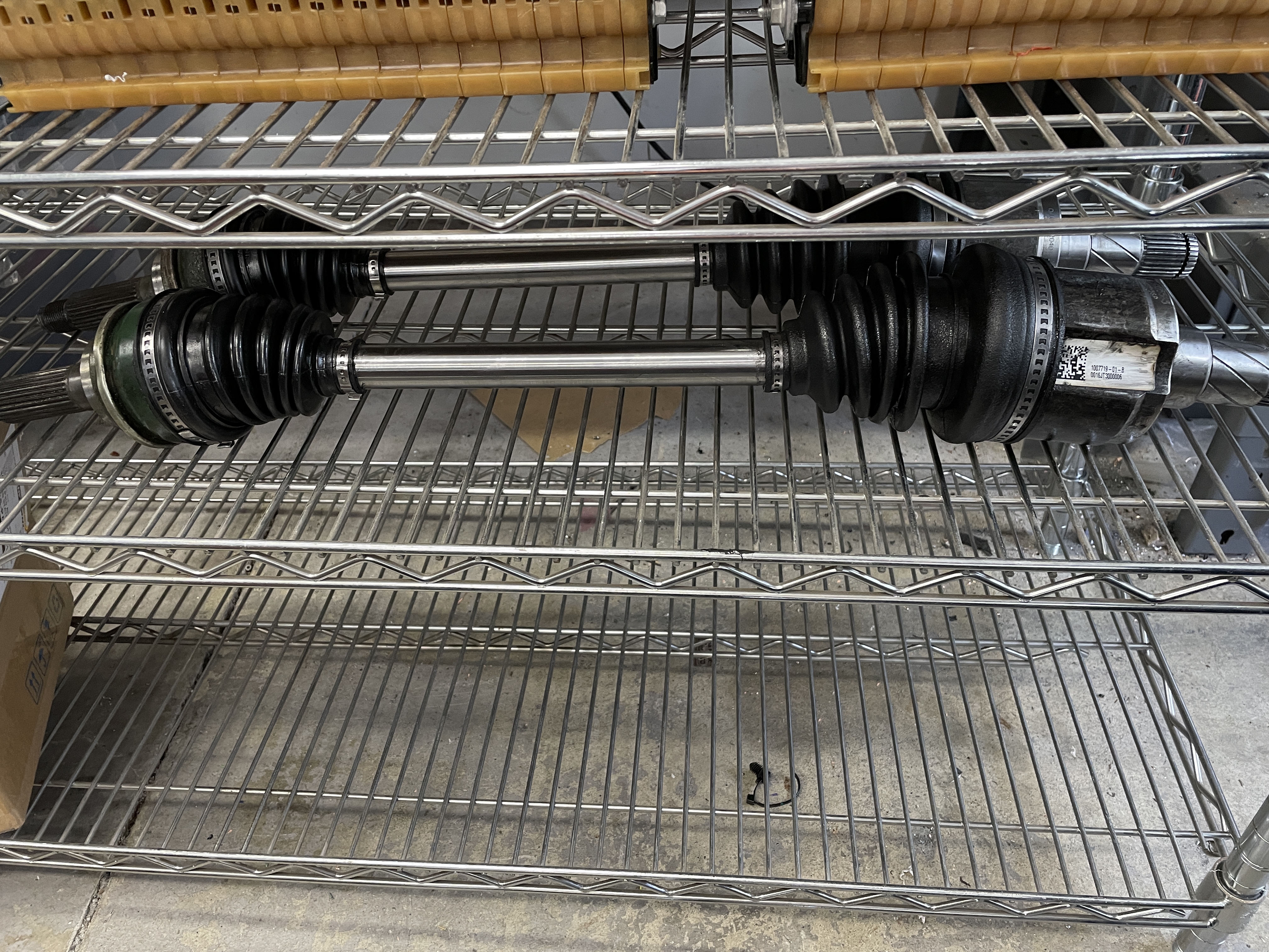

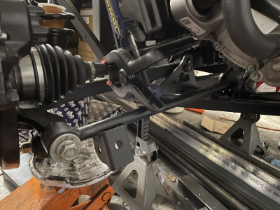

I sent the CV half shafts out to get a custom hybrid. This saves me a bunch of money since a set of custom full axles would set me back $2K from the driveshaft shop. Dutchman Axles should be about $1K all said and done (including the axle stubs).

- EV_Builder

But I did spot something are your relais correct? I would expect A1 and A2 at the battery or delivery side. Now I see two times A2. Thought these animals had polarity.

You are correct. I was so excited to finish the contactor box that I just threw them in without remembering proper polarity.EV_Builder wrote: ↑Fri Feb 11, 2022 9:38 am Very nice.
good eye and thank you!

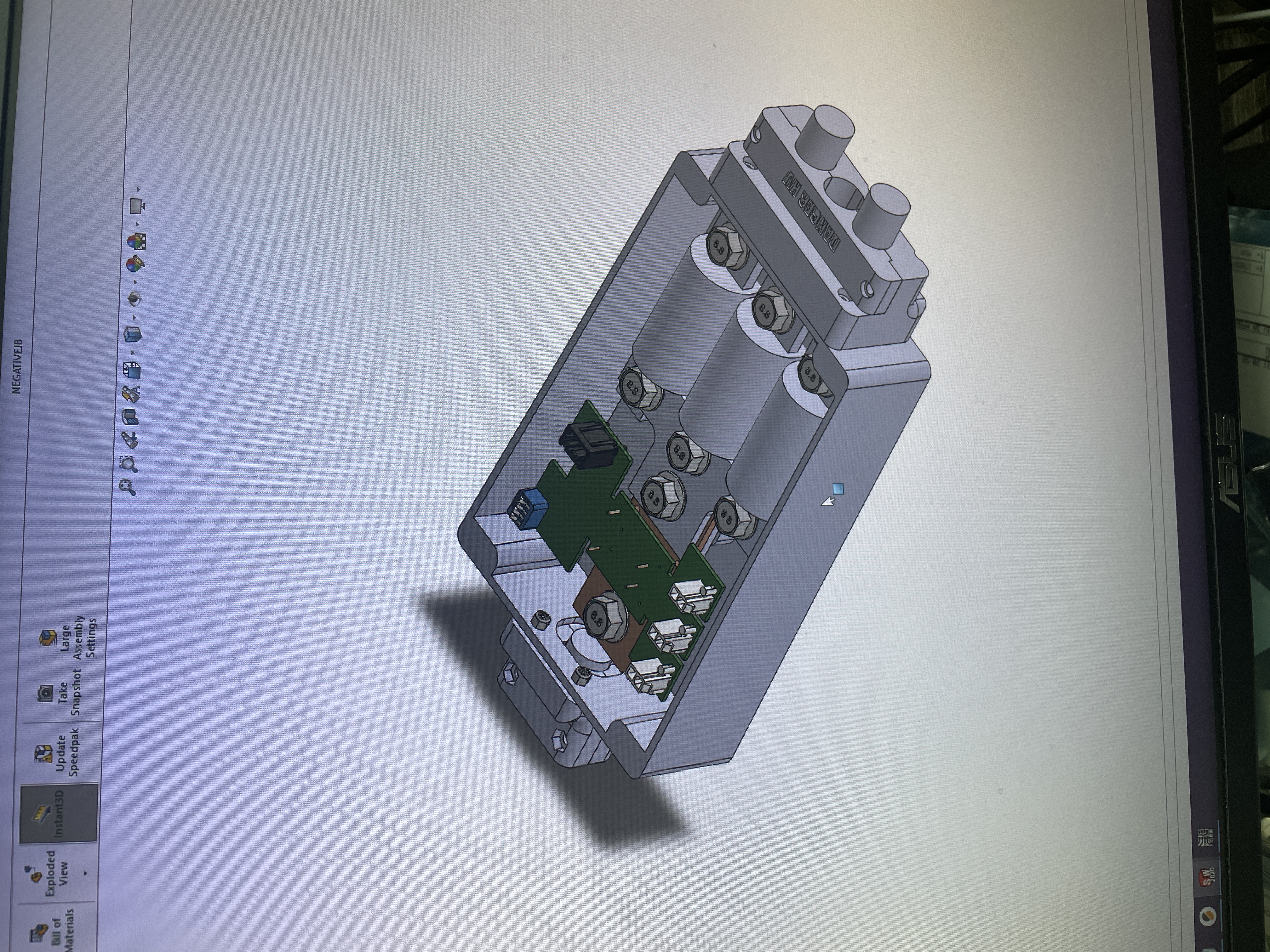

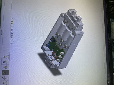

I redesigned the HVJB since I got a great deal on a large enclosure box on eBay. I added a bunch of goodies to it (like DC fast charging for CHAdeMO and CCS.) Took a while to CAD it all up but it was definitely worth the time. I built up the custom CV axles and they fit perfectly adapting Tesla inner cv to Subaru STI 27 spline rear CV. They are much beefier than the regular wrx spindle and should be more appropriate for the Tesla LDU. Here are some pictures of it so far. I'm also wiring up the HV and torquing down the chevy volt/spark gen 2 battery HV cabling to spec (80 inch-lbs according to the service manual).

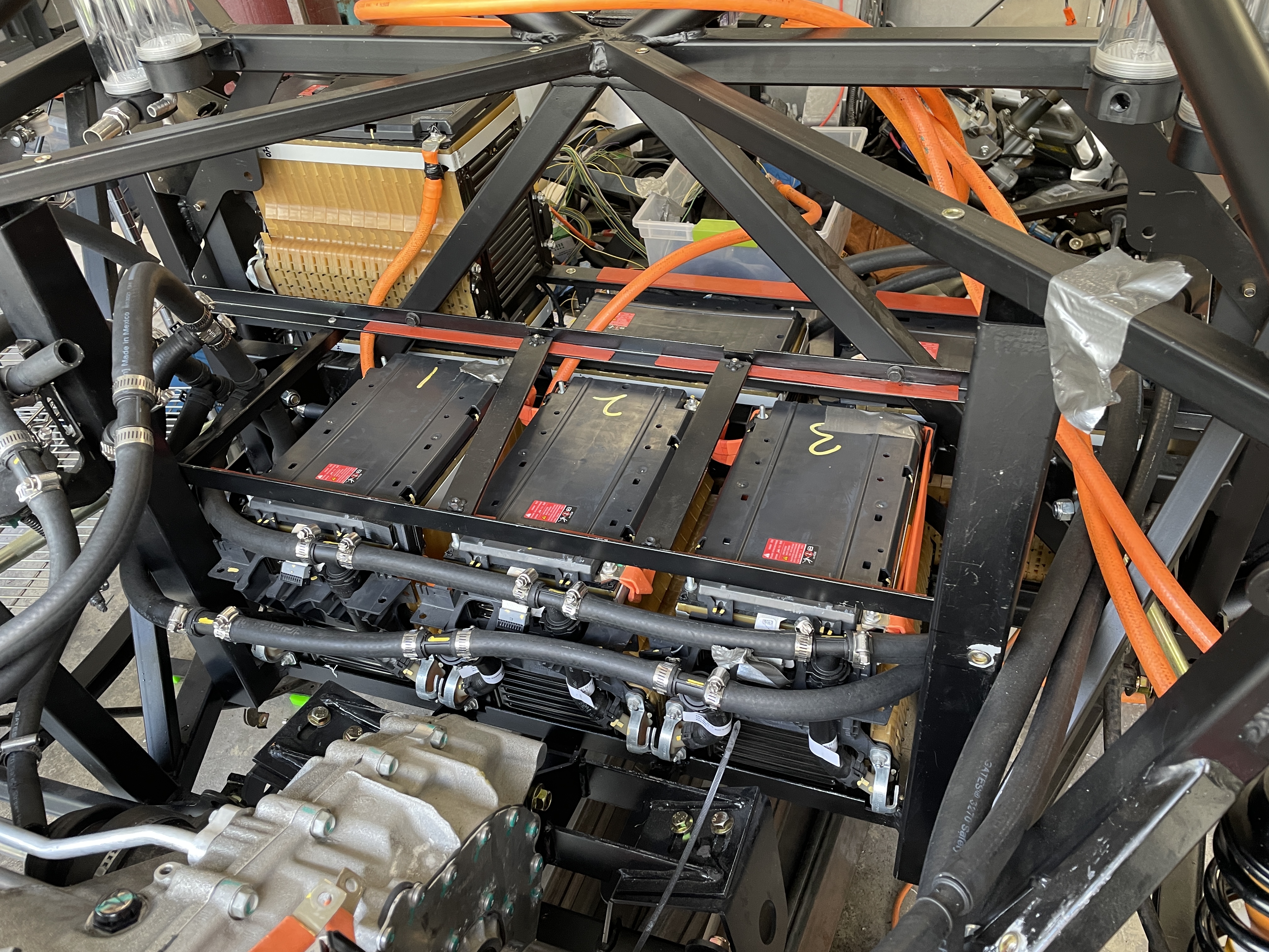

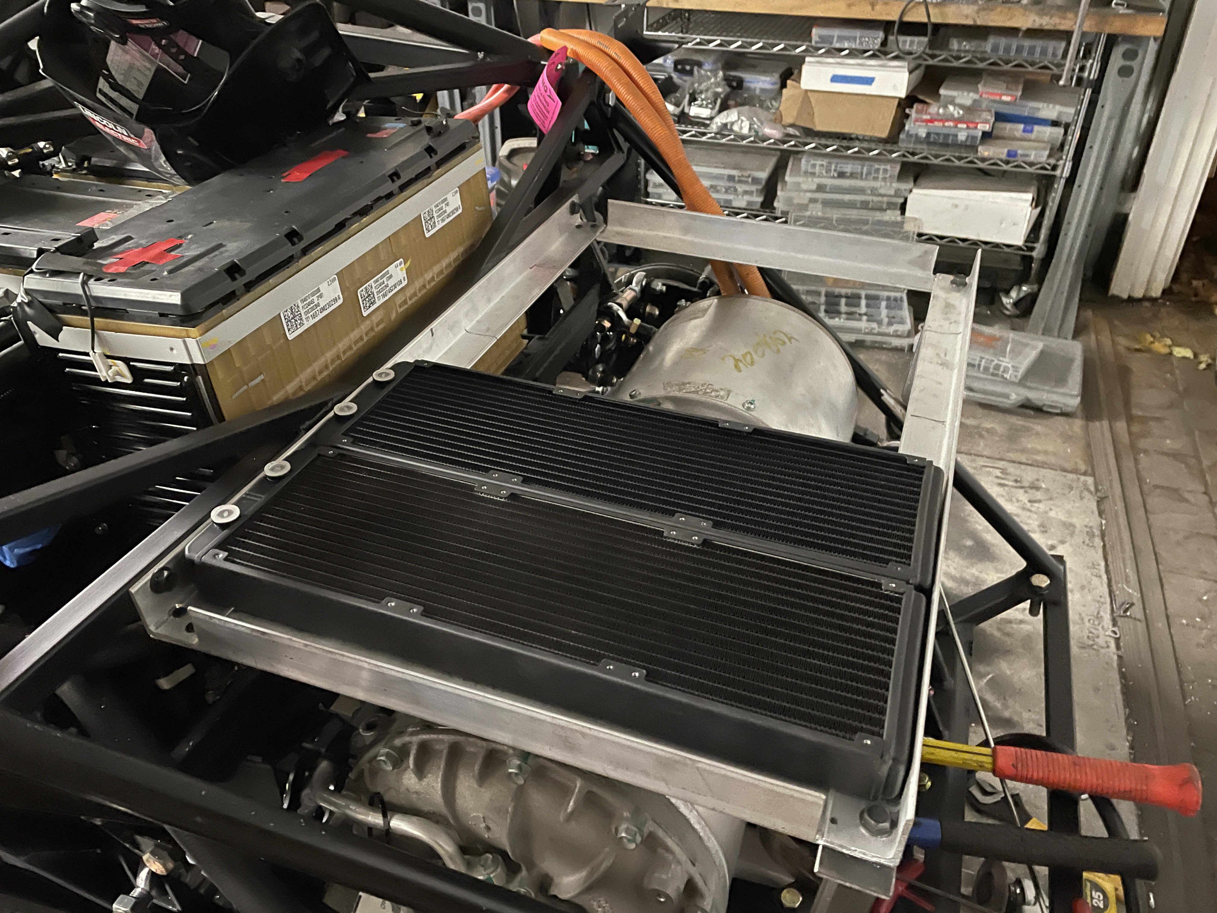

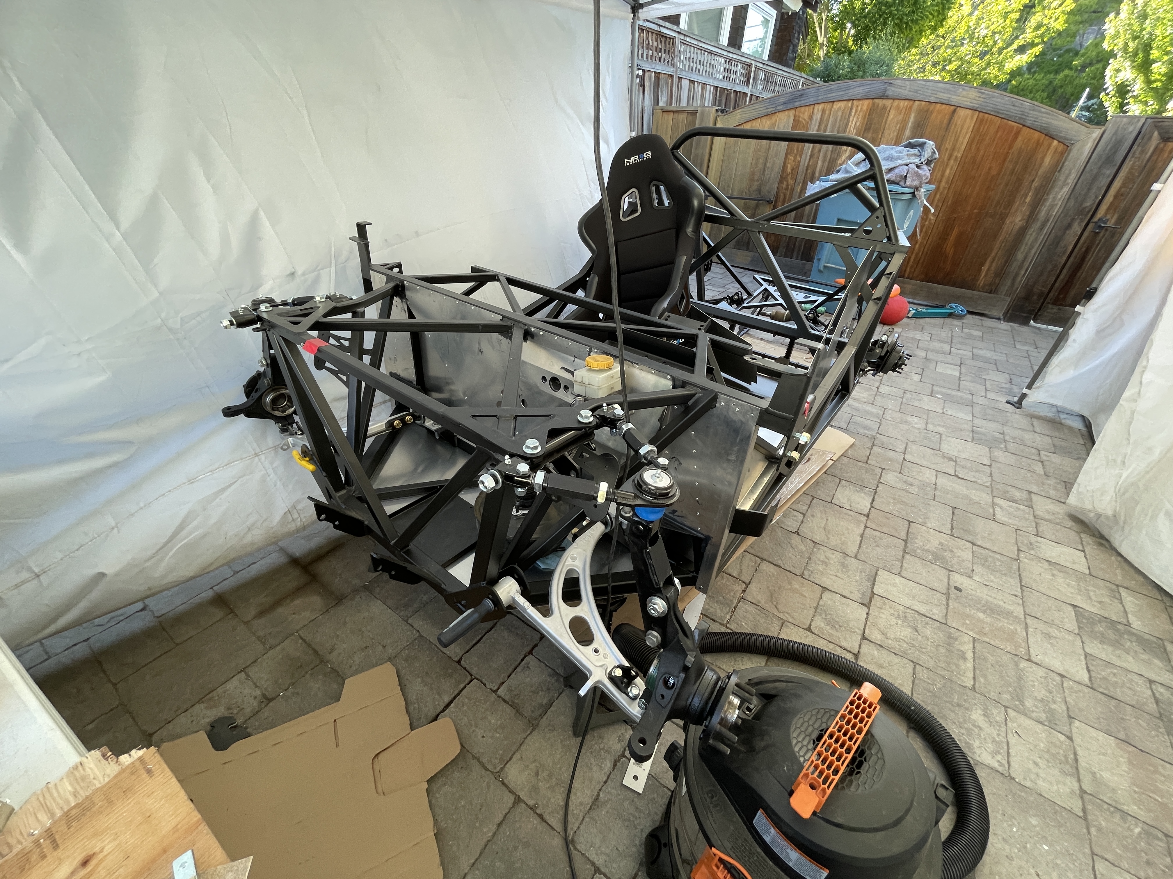

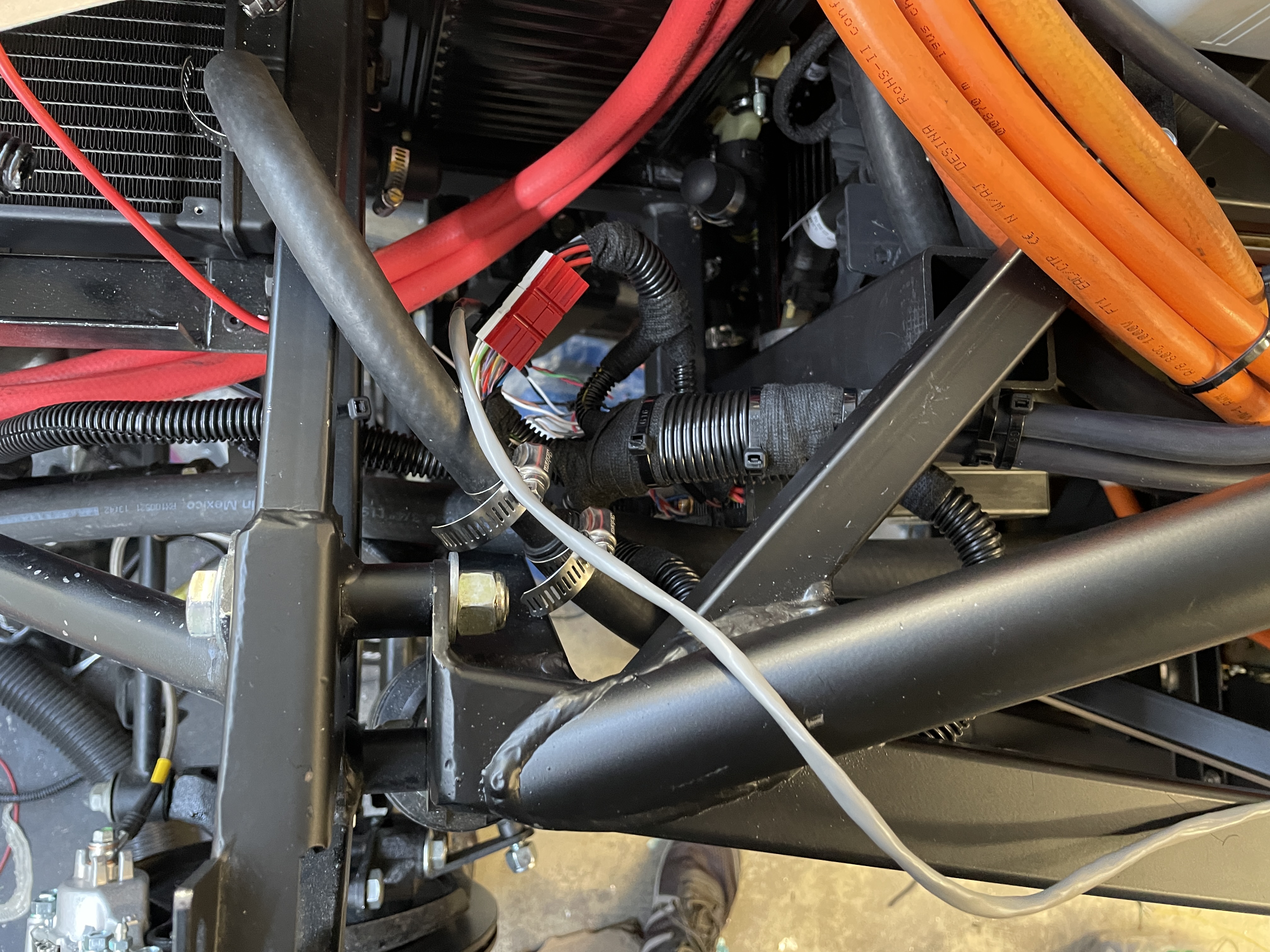

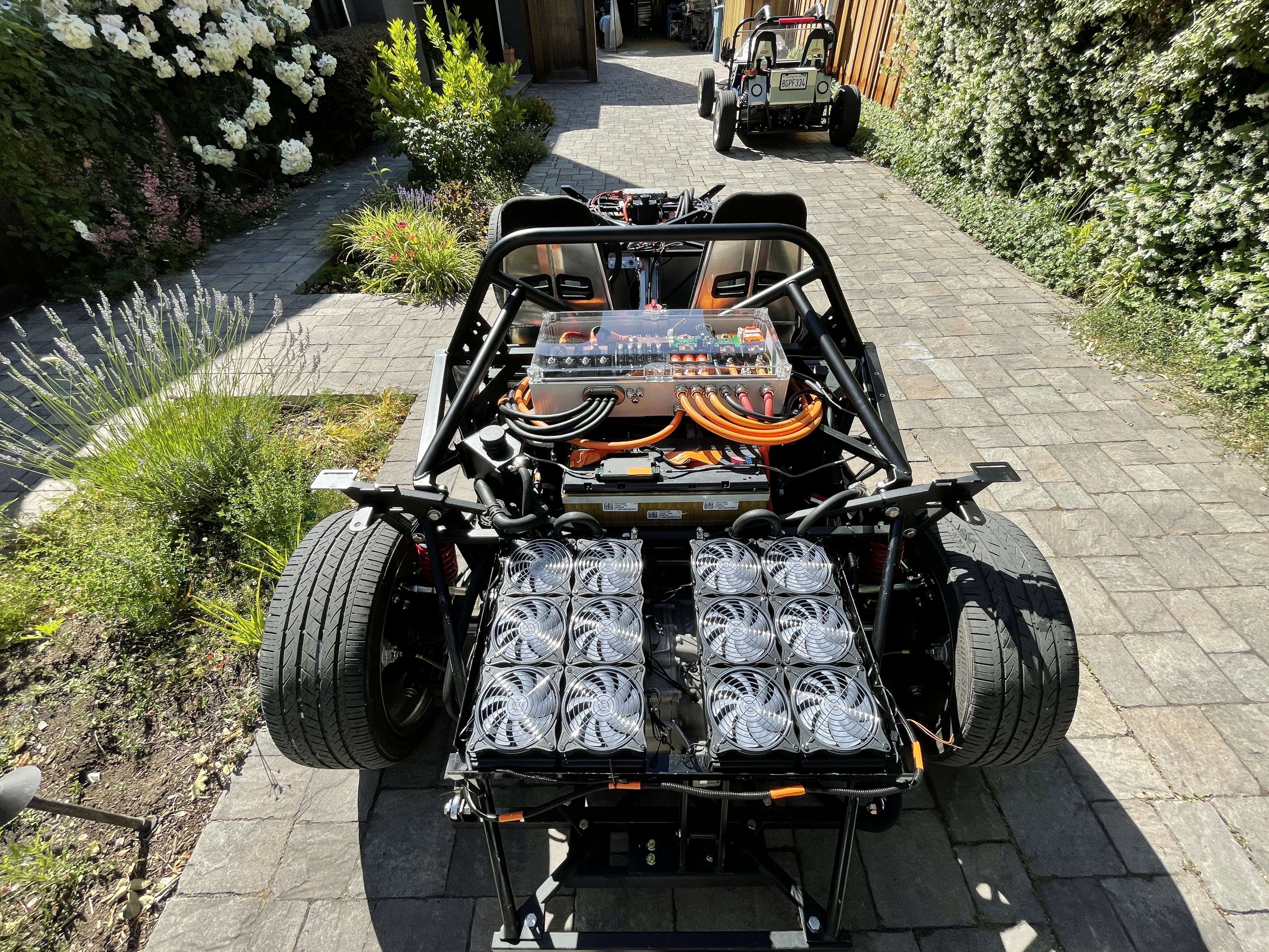

Working on the cooling system right now. I had to buy new seats since the NRG ones I got were too wide to center the steering wheel properly. Since I am using a Prius EPAS column, I needed to redo the mounting system for the WRX column. I'm pretty happy how it ended up but since I am using the stock AT Subaru pedal box (that is really wide compared to the manual one, I needed to hack it up to make the u-joint fit. Even with this mod I still can't center the wheel perfectly in line with the driver seat space so I ended up getting some Kirkey Seats. Although they were expensive they were much thinner in x y and z so I'm definitely going to enjoy the extra legroom as well as the ability to offset them inwards to be centered with the steering wheel.
After the cooling system is tested in a vacuum I will proceed to fill both the power electronics loop (with G48) and the battery loop (deionized dexcool). I'm hoping to be able to fire up the motor then and get my VIN! A bunch of features that I want on the car are being skipped right now in the interest of time such as the battery conditioner logic as well as a majority of the CAN bus system including the BMS integration with an ECU that I will have to design down the road.

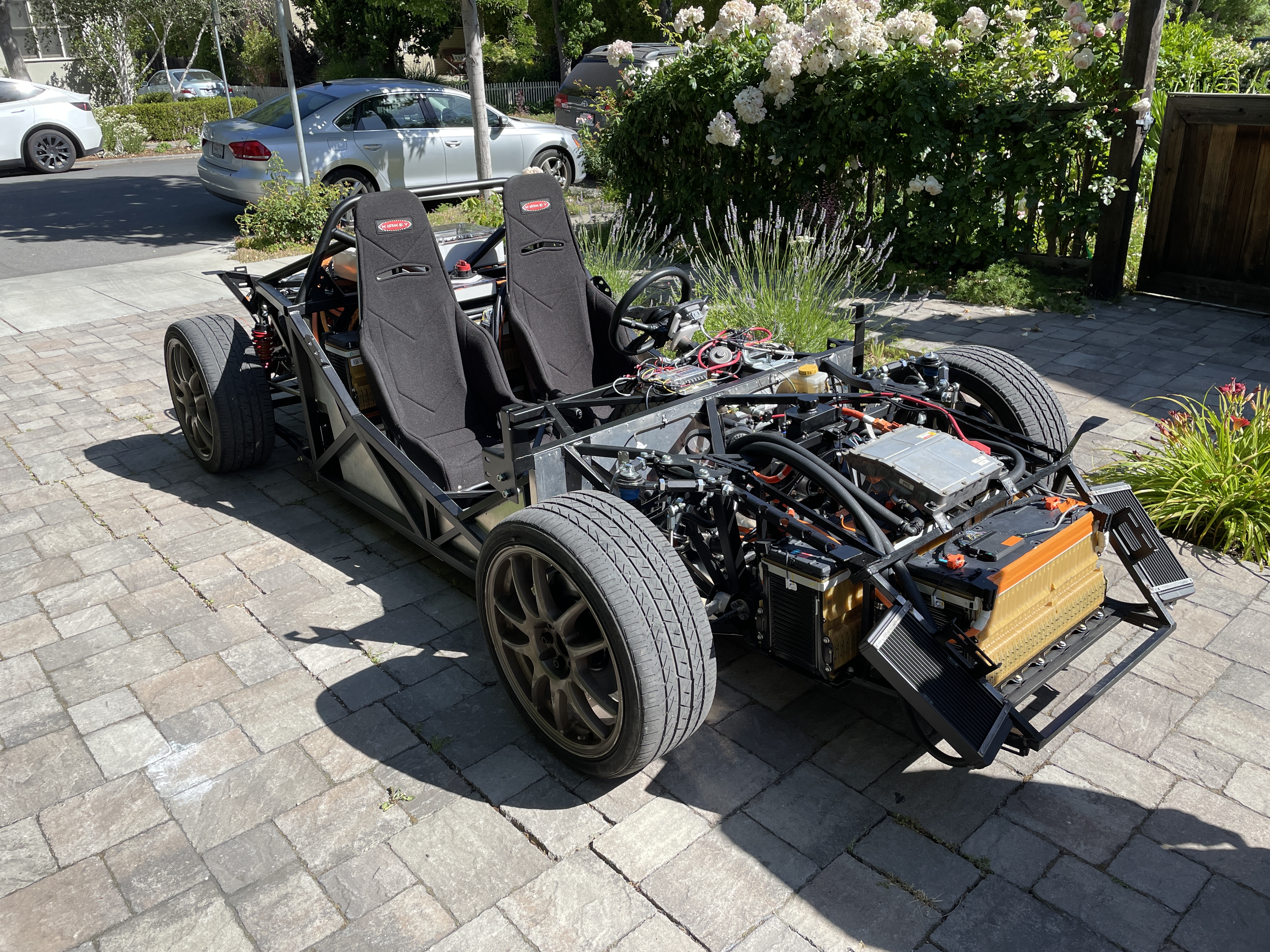

The motor finally is spinning! I really wish I knew how the can emulation works for the Tesla drive unit. I don't know how they are able to flash a firmware on the board sadly but it would be cool to be able to get this working for the masses to open source this. I thought that the mcu was locked and not possible to flash over JTAG.

UPDATE
I got a VIN! Luckily the CHP didn't care much for body panels and just riveted on the VIN no problem.
I've been really quite since I'm diving really deep into embedded systems coding. I decided to redo the BMS system and instead leveraging chevy volt gen 1 BMS modules (since the CAN network is completely reversed engineered). I bought most of the LTC6802-2 ICs on eBay and lets just say that although most of them worked have some had some pretty wack mem register values when reading cell voltages this reliably issue caused me to swap. I have 3 months before college starts so realistically I don't think I can finish with how much more I have to learn in the coding department. I'm now using a TMS570 MCU with 4 CAN peripherals. Its a really cool chip that has dedicated ECC memory for each CAN message box as well as super robust watchdog/hardware level clock protection. CCS and HALcogen is still super confusing to me so don't expect any sort of serious leap forwards anytime soon haha.
