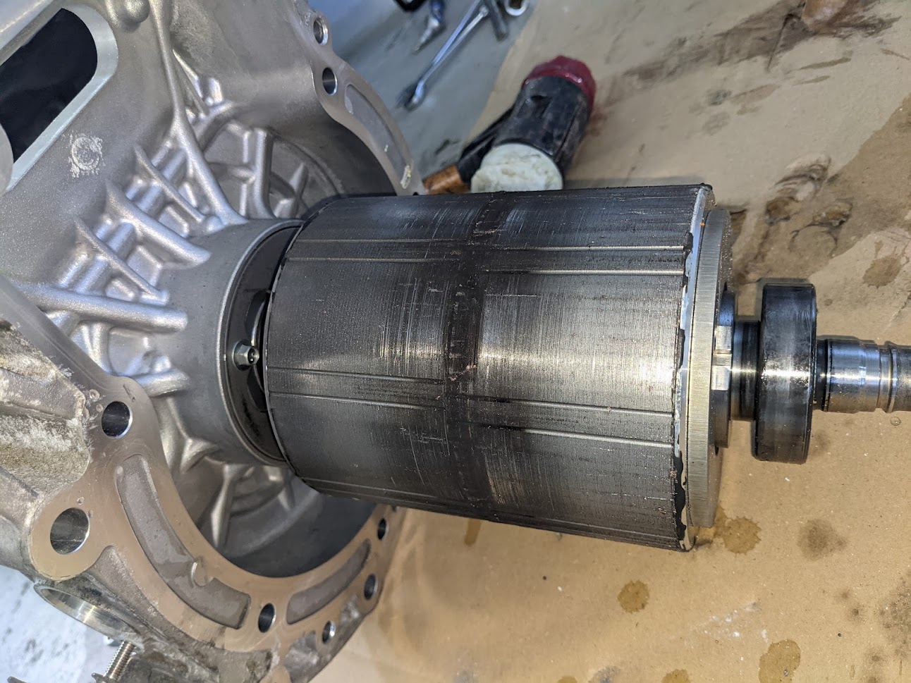

Yes, syncadv does the job and also the linear increase of fweak instead of a steady value. Johannes sent me a beta firmware that i tested yesterday - succesfully! The car had no more torque loss after 4000 rpm and pulled strong up to 7000 rpm. Power output was now constant high throughout the rpm range. Regeneration was still an issue that need so be solved!
Incident: Unfortunately the first firmware had no RPM-lilimter. That and the fact the syncadv acts strange the higher you set it according to how the engine spins led to a fried motor. The rpm went for a second around 25.000 or so - now i have sparks between the motor and the chassis, i think the rotor didn't like it. The car doesn't drive anymore, i'm just able to rev it once and then when the rpm is zero again i can rev it again. Motor is definately fried Bought another one that should arrive next week.
I sacrificed a motor for the cummunity
Reminds me of some of Damiens videos though

Well, that's what you get when the thirst for power is too big
The whole story here: viewtopic.php?f=9&t=1960
