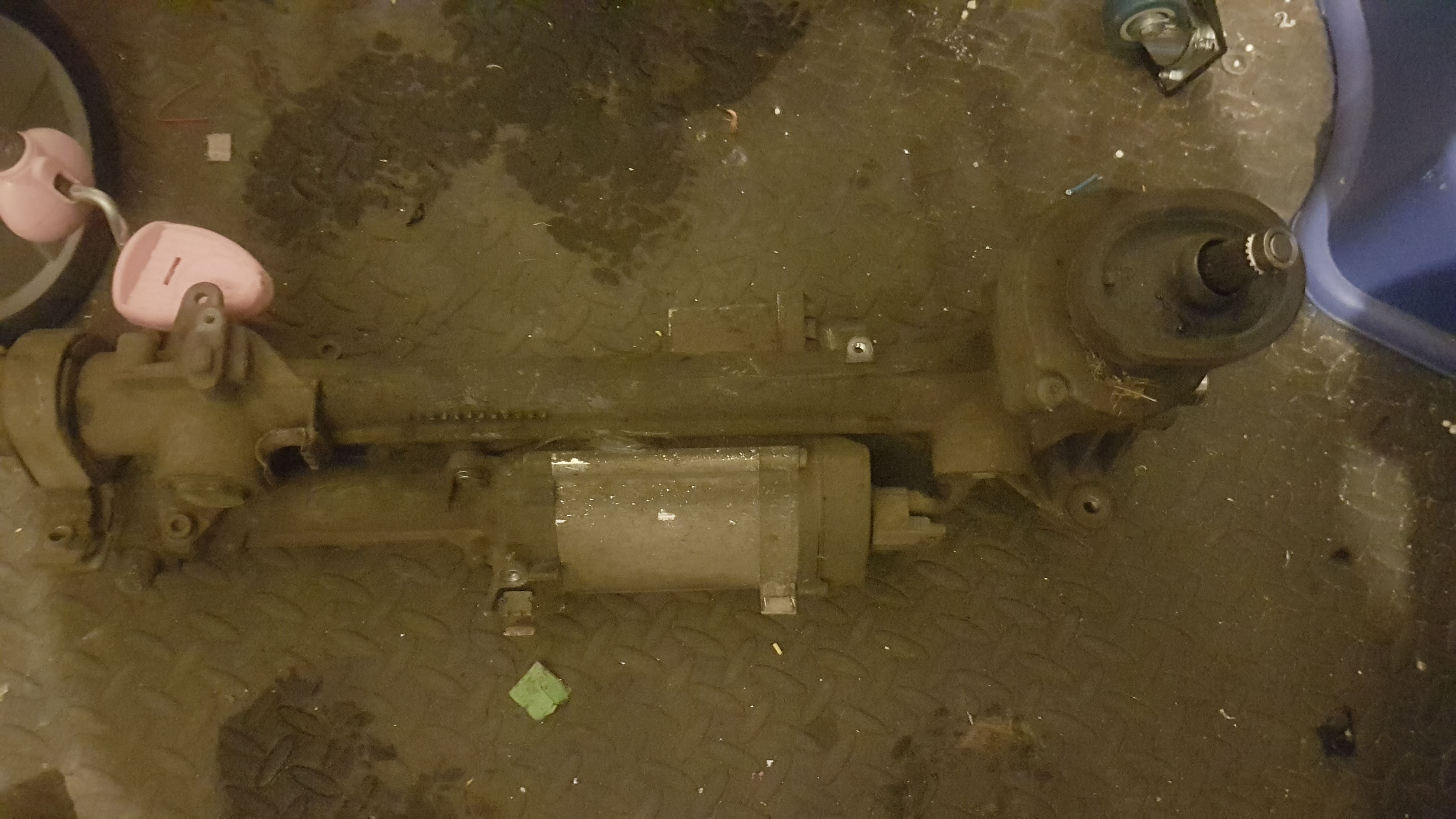

I've been given a VW electric steering rack from a later model Beetle, I'm hoping it fits without any modification. I've read it has a failsafe mode, but I'm hoping all the can messages I already have will be enough to make it happy.
VW Beetle 2003
Outlander front generator
Outlander charger
3x Golf GTE batteries
Chademo Charging
Outlander water heater
Outlander charger
Chademo Charging
- Posts: 5768
- Has thanked: 157 times
- Been thanked: 1009 times
Re: Electric Power Steering pump from Mini
Yes it works without CAN or with the 0x280 message containing engine rpm. If so, rpm must be greater some threshold (600 or so) for it to work.
- Posts: 1593
- Has thanked: 75 times
- Been thanked: 303 times
Don't suppose you know the pin out? My googling isn't coming up with much

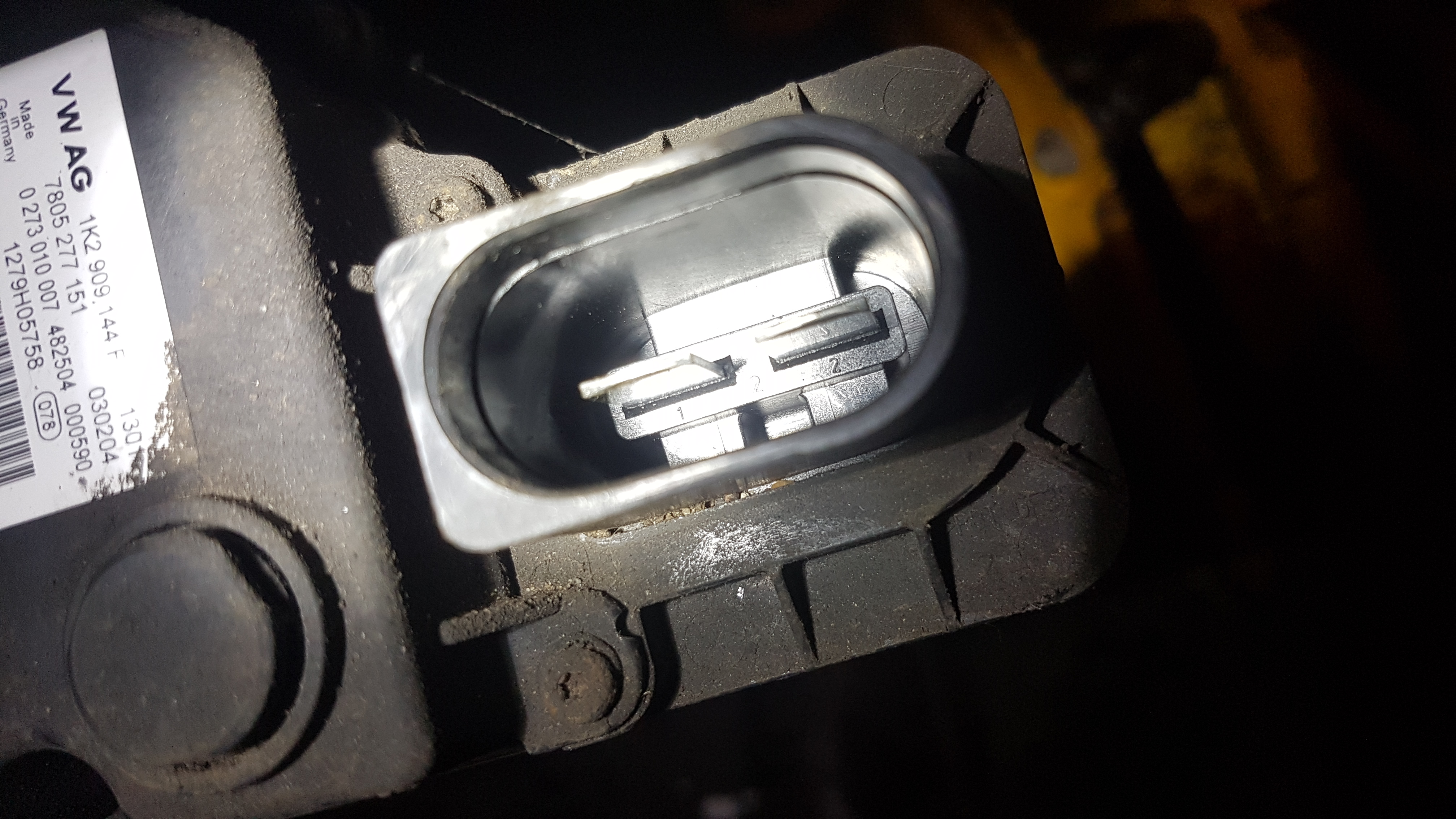

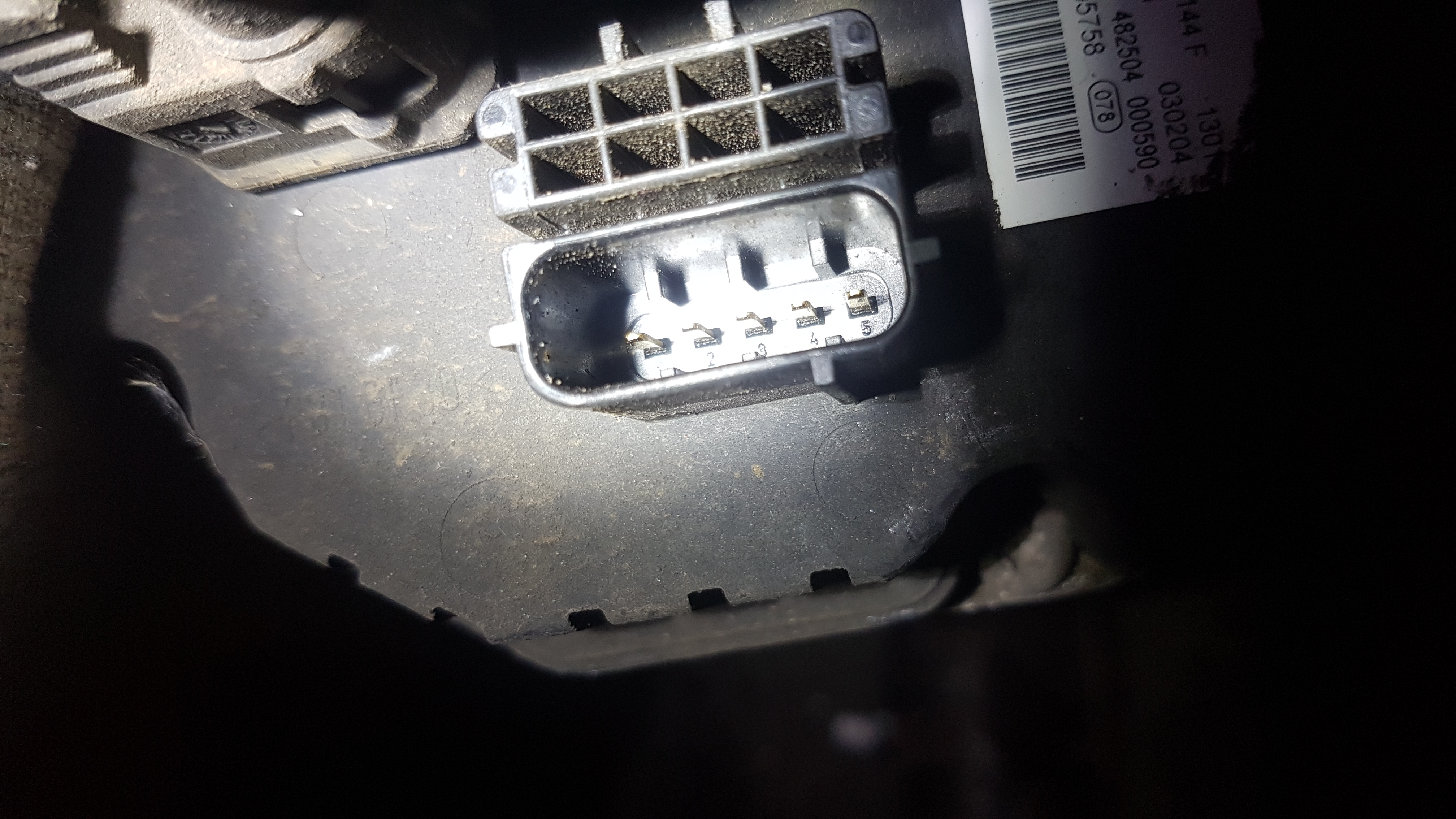

Can you take a shot of connectors on the rack? I will see if 5hey are the same on my Ampera epas. I have wiring for that.
- Posts: 1593
Found some info, I'll not paste an image as it's probably copyrighted.
Of the large 2 pin connector 1 is GND, 2 is 12v through an 80 amp fuse.
Of the 5 pin connector, pin 1 is CAN L and 2 is CAN H, pin 4 is ignition 12v though a 10 amp fuse.
It connects to the powertrain CAN.
*EDIT*
I applied 12v to the big connectors and to pin 4 and no failsafe mode, will see if anything comes out of the can pins tomorrow..
* EDIT *
No can coming out, I noticed the manual has the pin numbers opposite to marked on the socket for the 5 pin, either orientation yields no can or failsafe mode.

Also got the VW rack working. Will document on the wiki.
