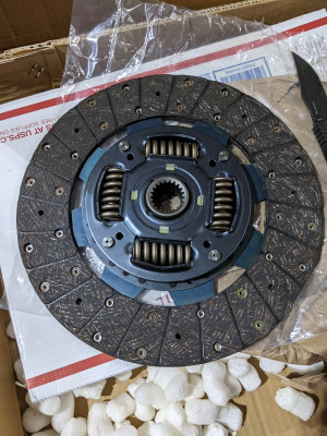

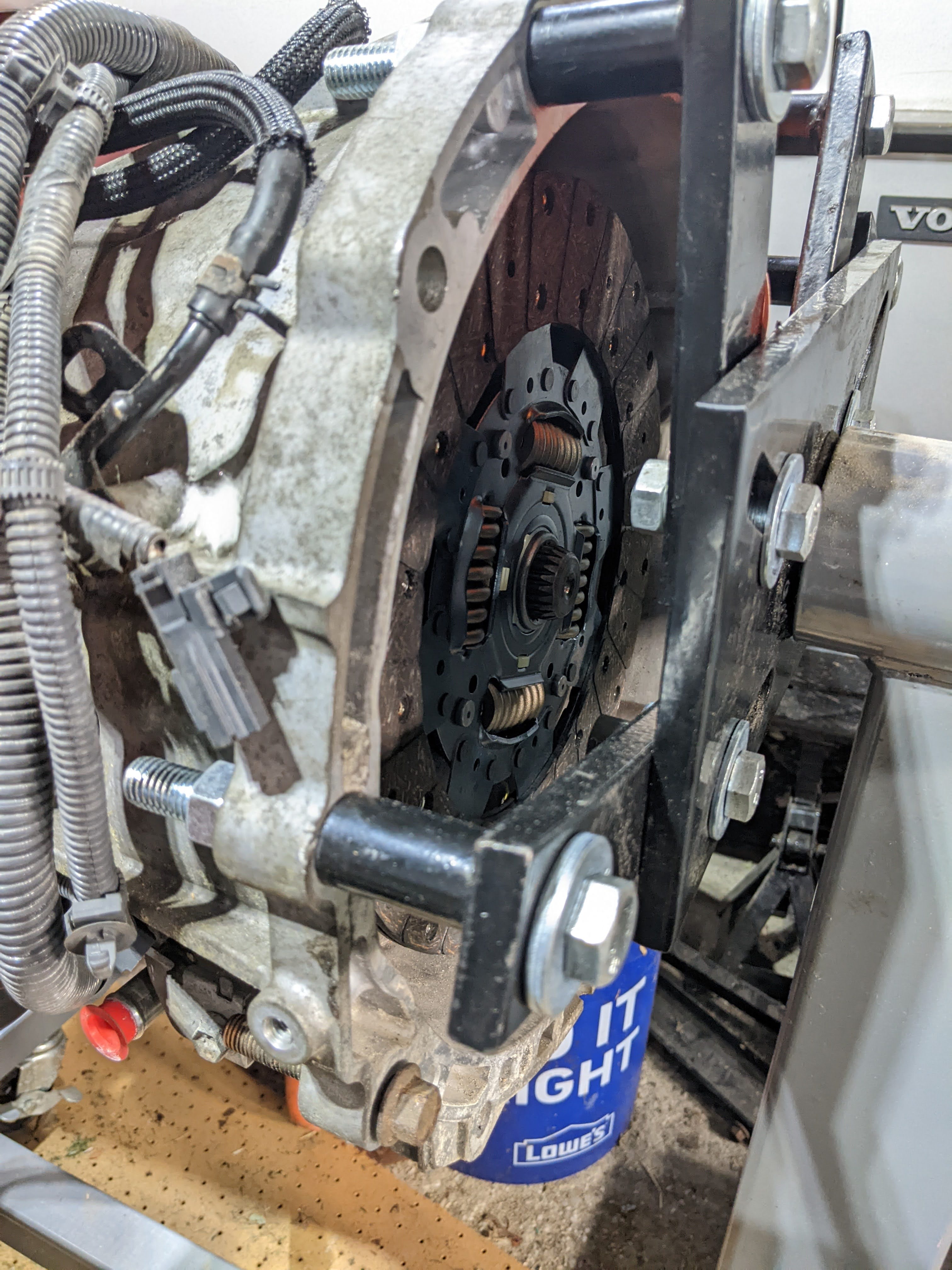

Bumping this up to see if there's been any additional information gathered in the past year.
I found one seller on ebay for the Toyota disc, currently under $50 shipped (in the US), and they accept offers:
https://www.ebay.com/itm/170969759918?h ... R4K6tPWLYQ
Surprisingly, not that many used ones available on car-part.com, and none as cheap as that ebay seller.
EDIT: My clutch disc arrived today and it's a perfect fit. And for future reference, the seller accepted an offer of $44 shipped.
