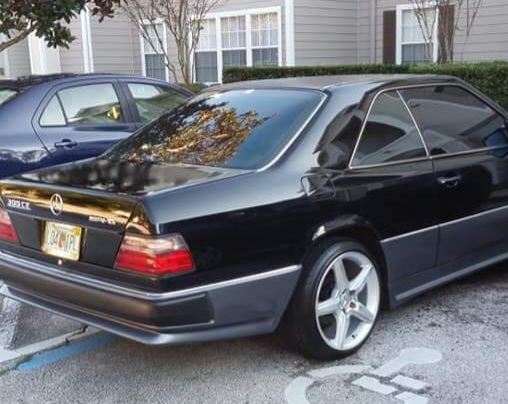

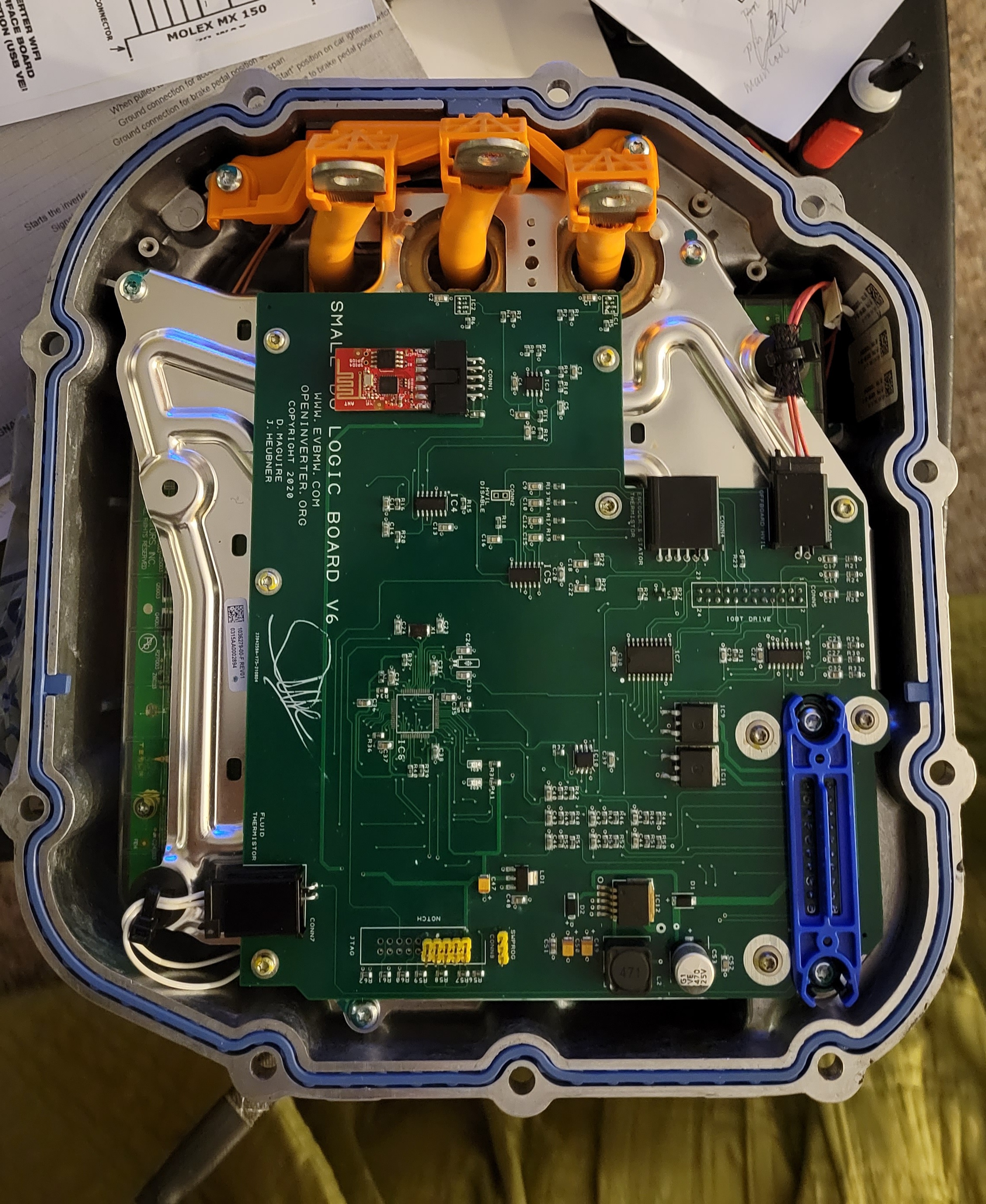

1991 300CE Mercedes conversion with Tesla LDU

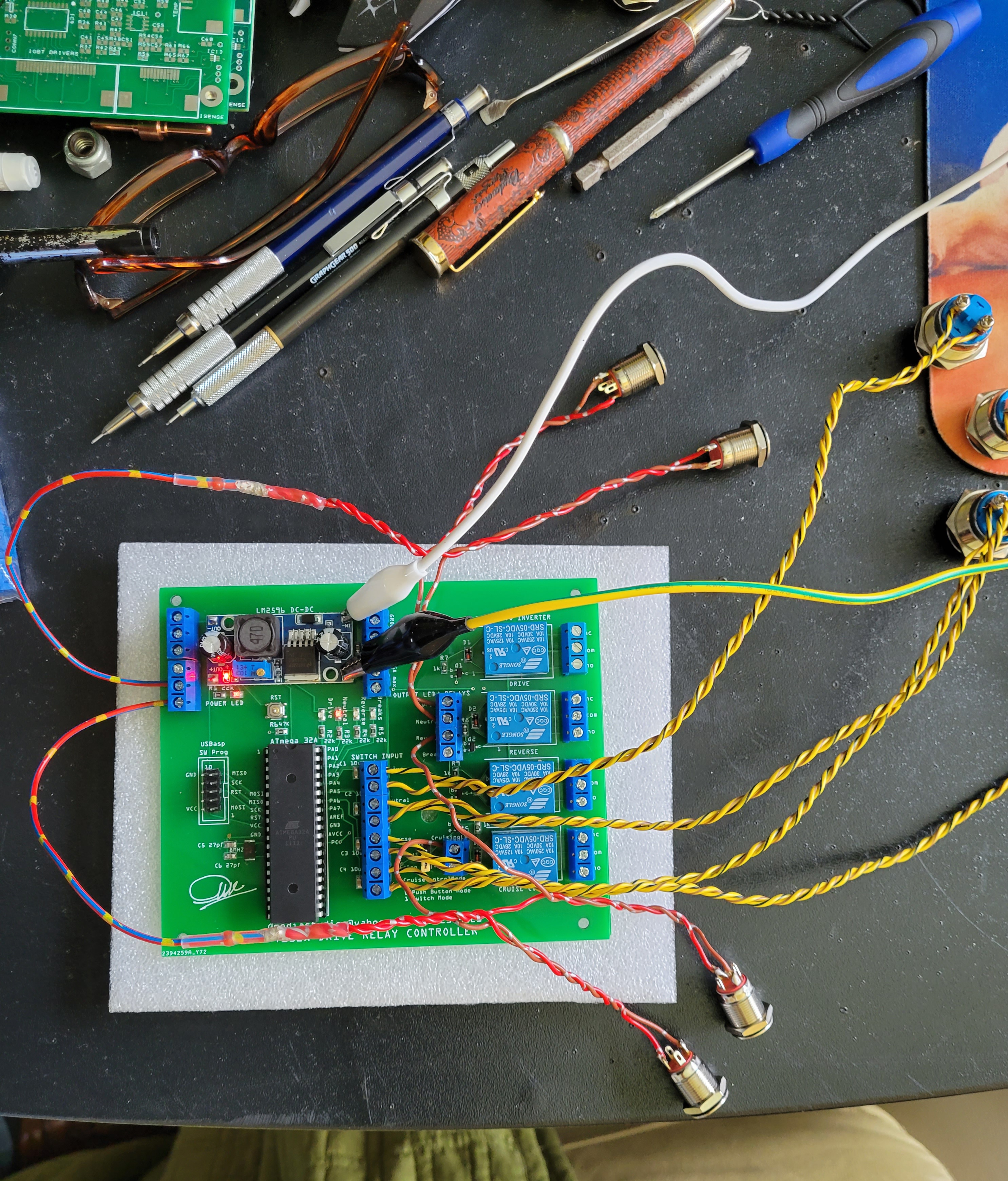

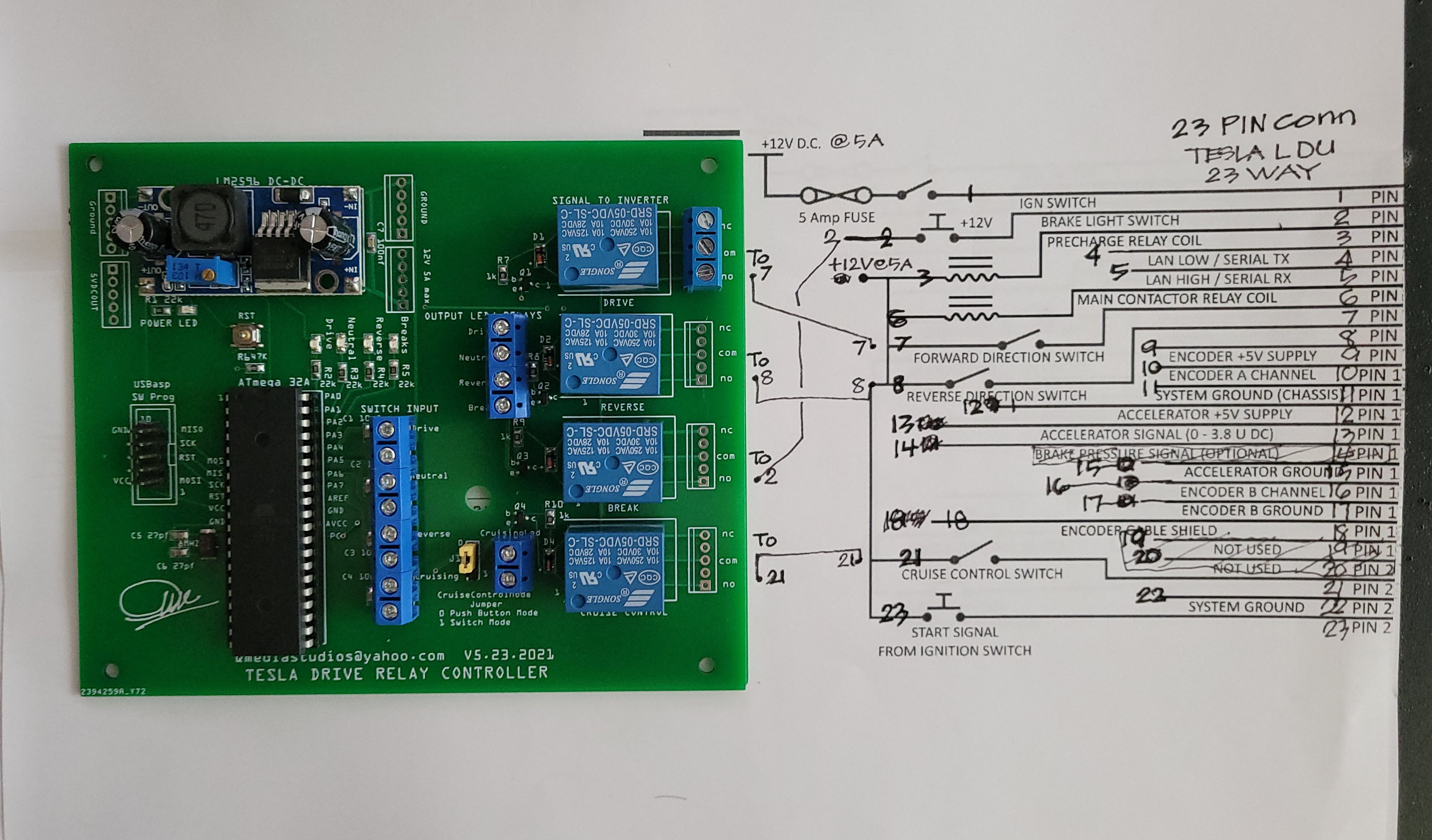

new update on Tesla direction relays for SDU and LDU

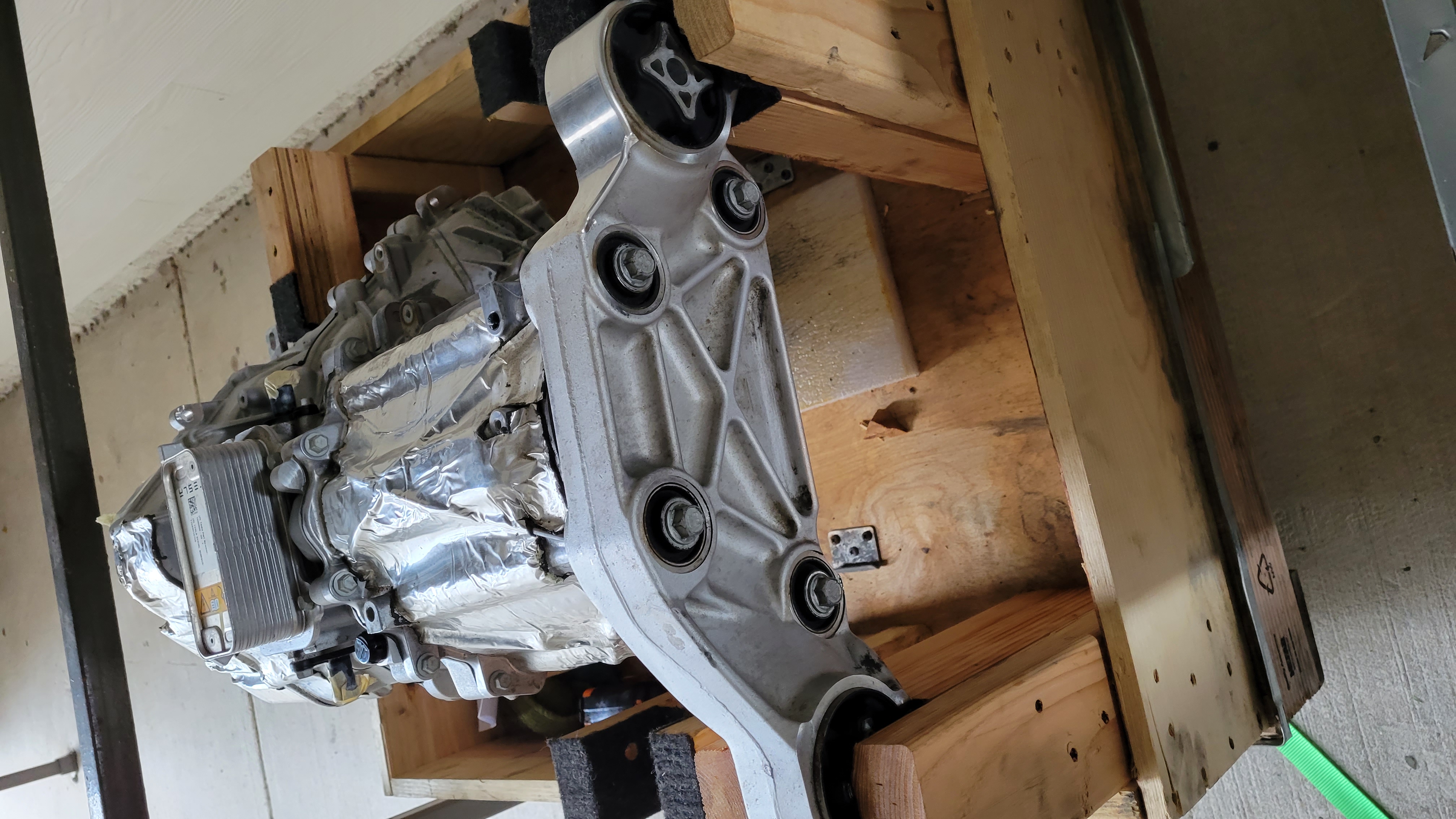

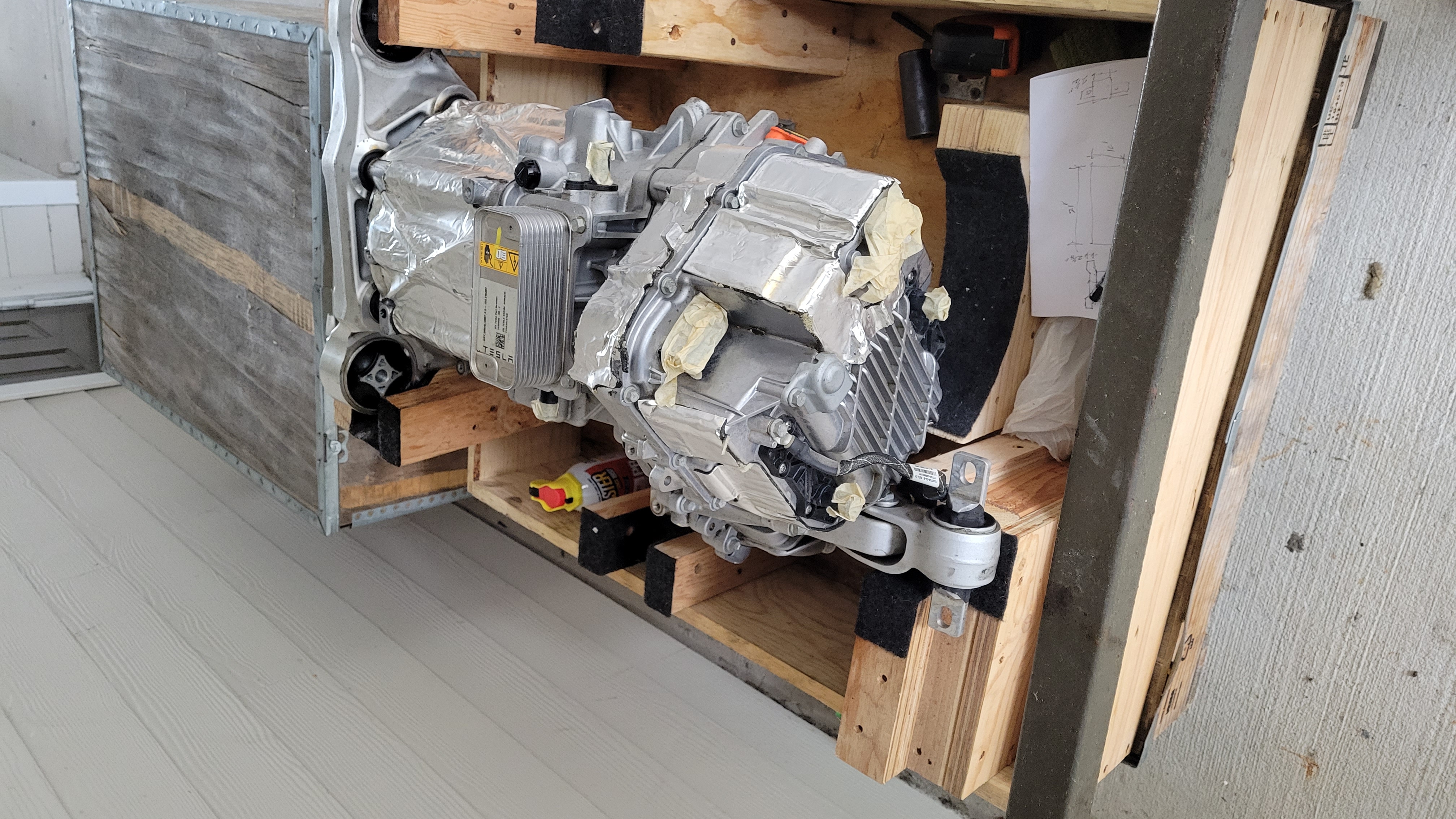

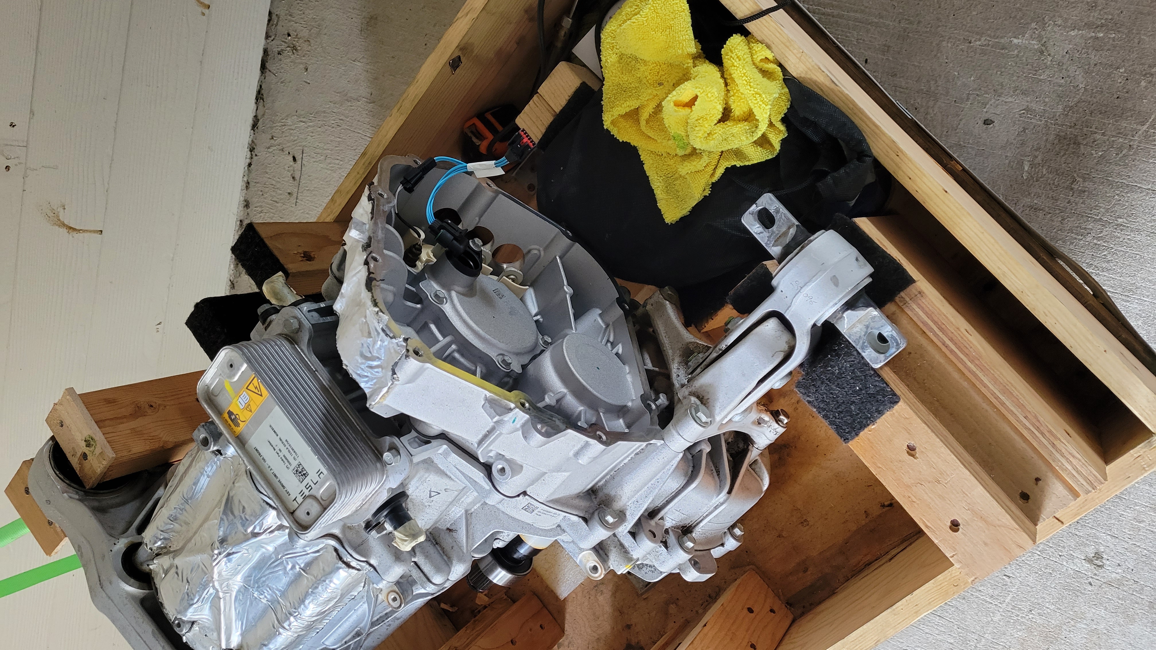

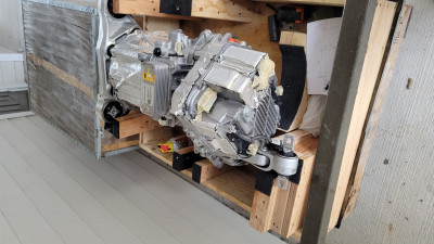

Just received my tesla motor August 10 2021 still in crate had to go with the SDU instead of the LDU.
Ordered SDU logic board from JLCPCB to start installing.
Got into some problems in taking it up to the 3rd floor but will try again.

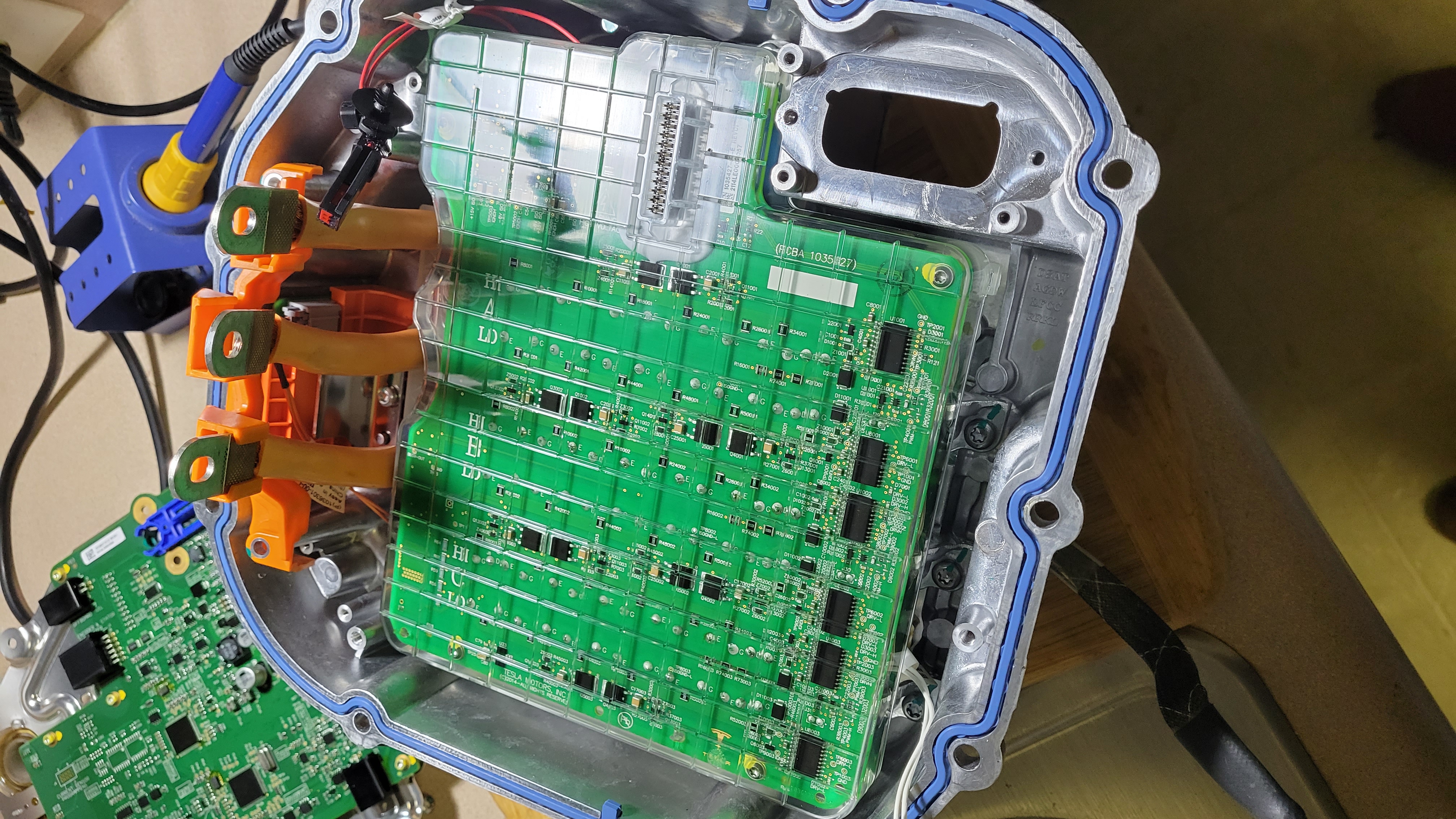

Finally got the tesla OME logic board off the sensors. Now waiting for PCB from JLCPCB
Car to be electrified.

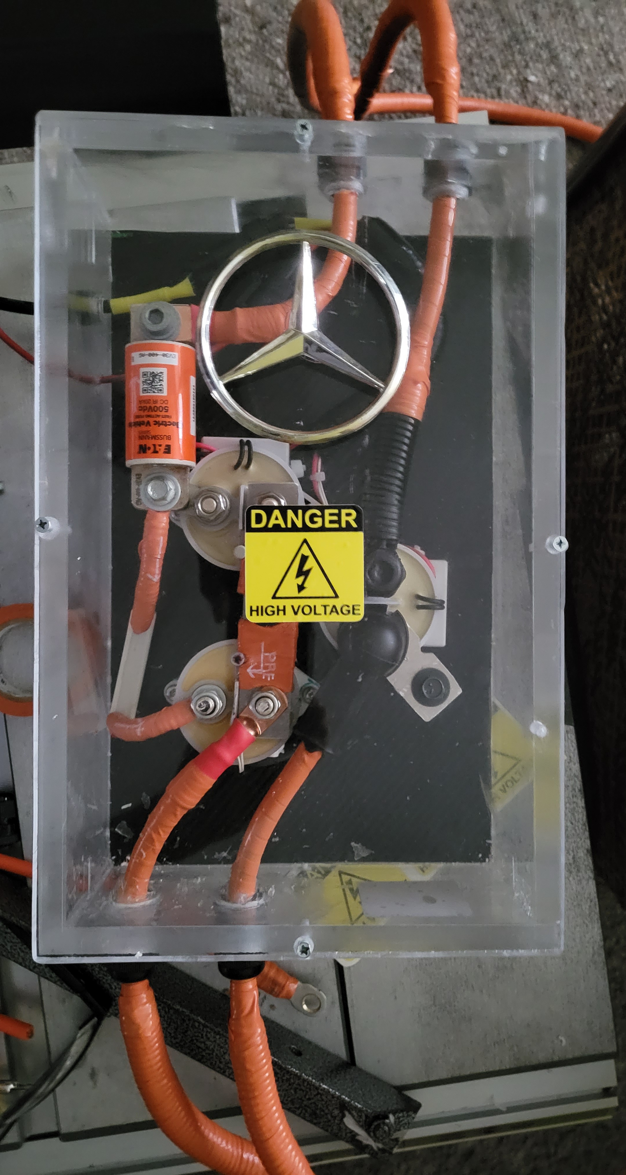

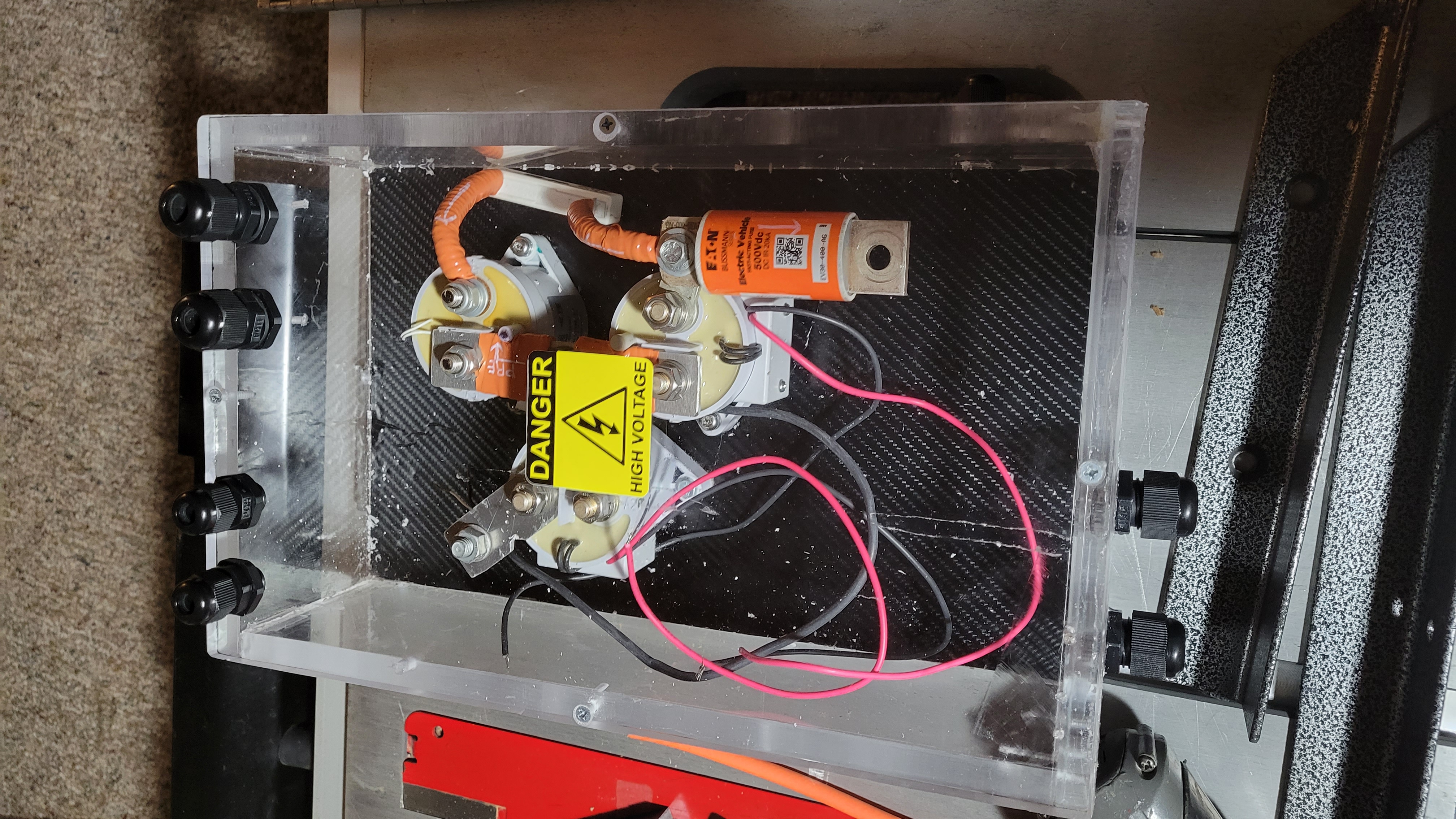

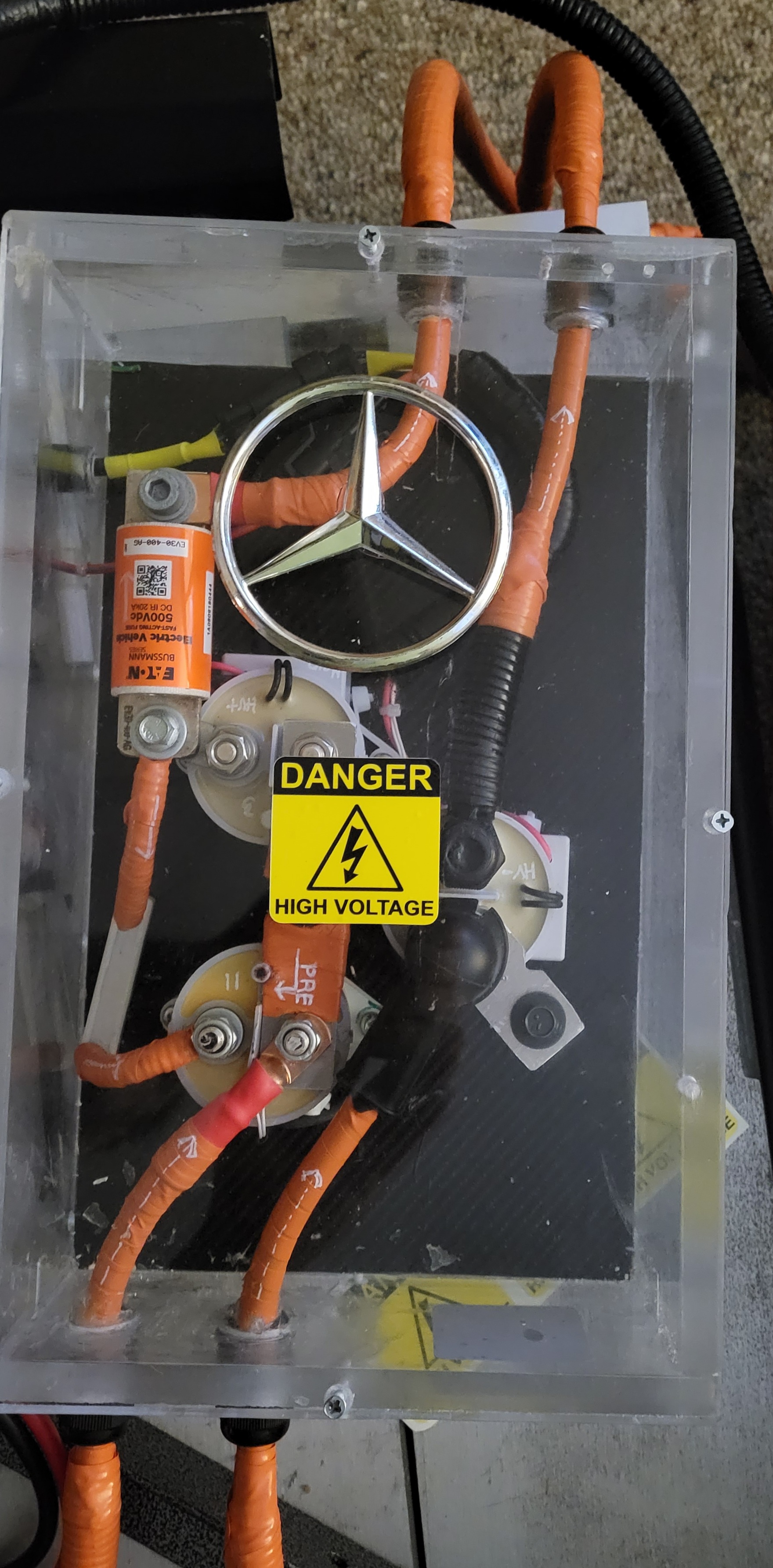

High voltage box almost done

Need to take motor up to 3rd floor another project

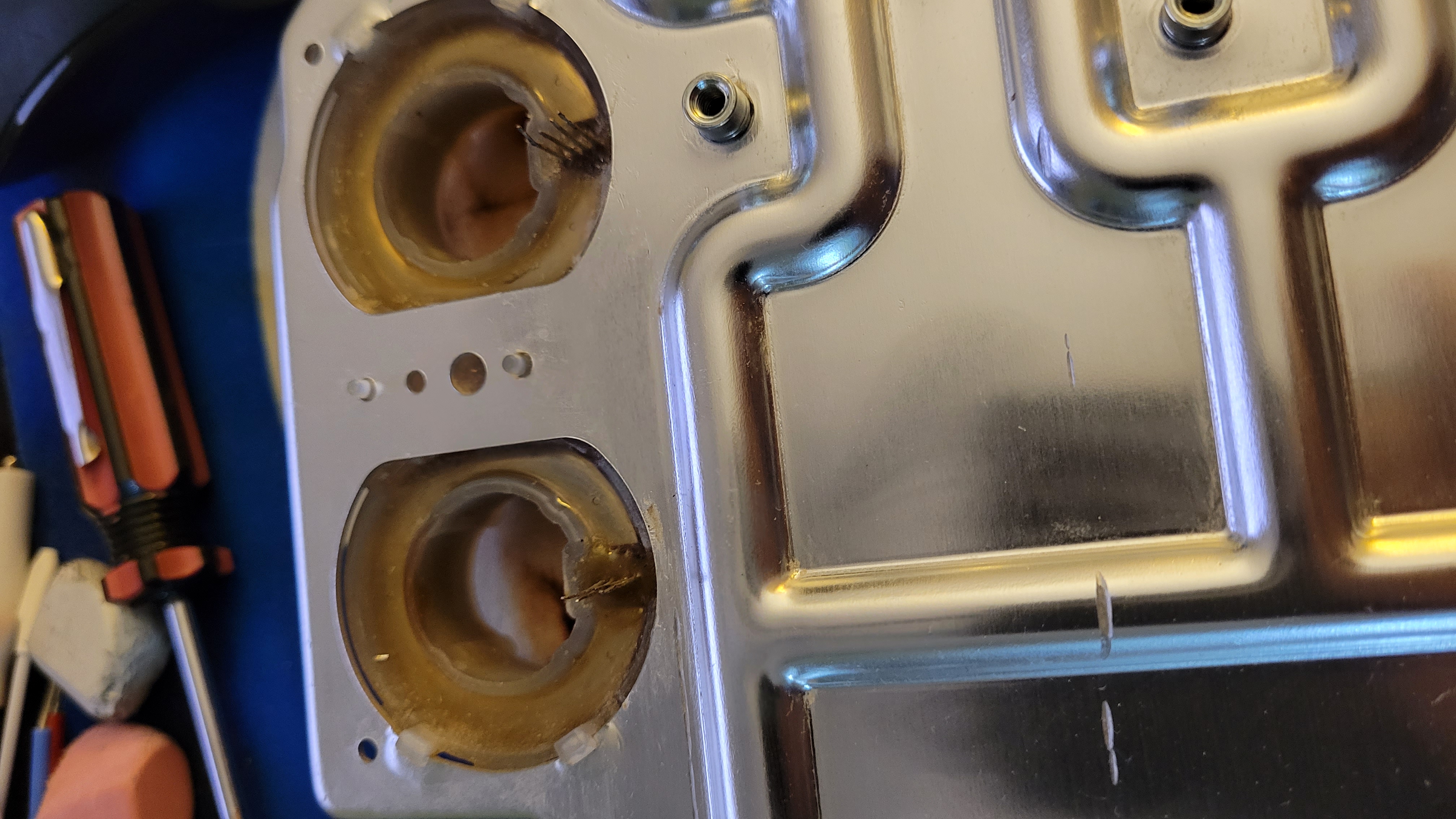

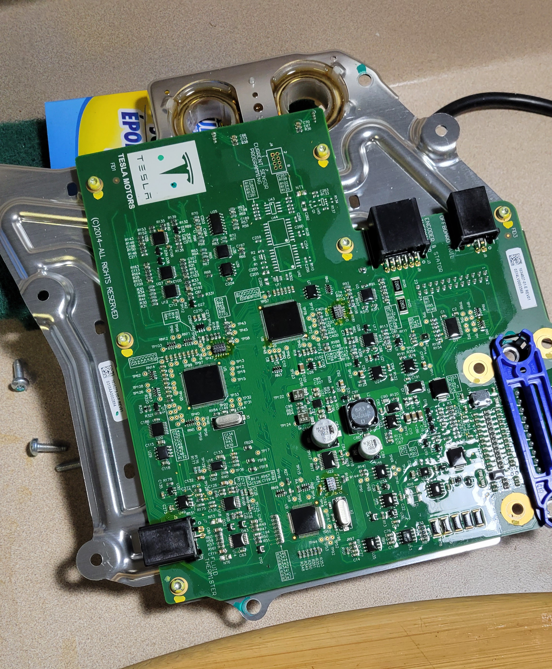

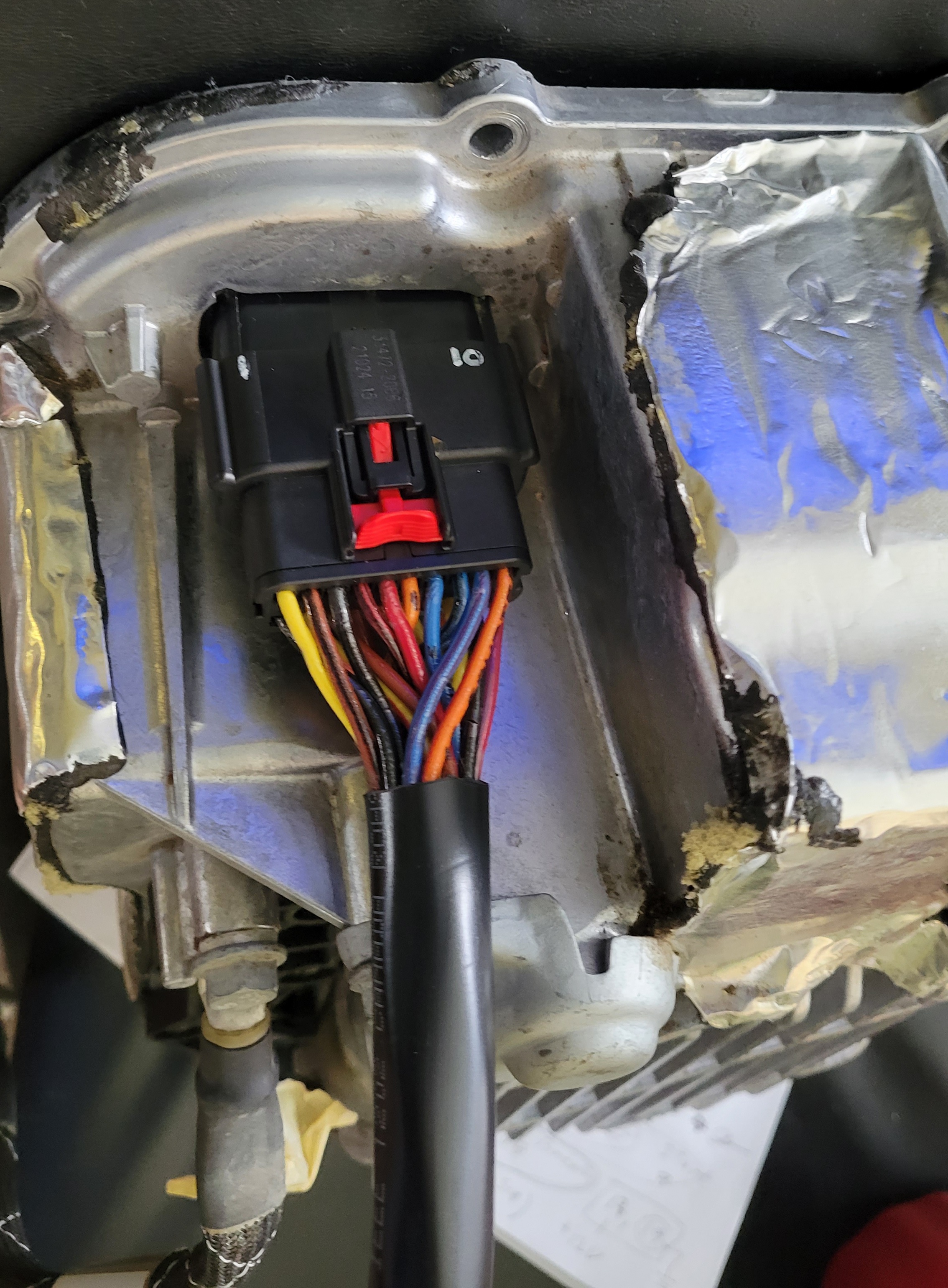

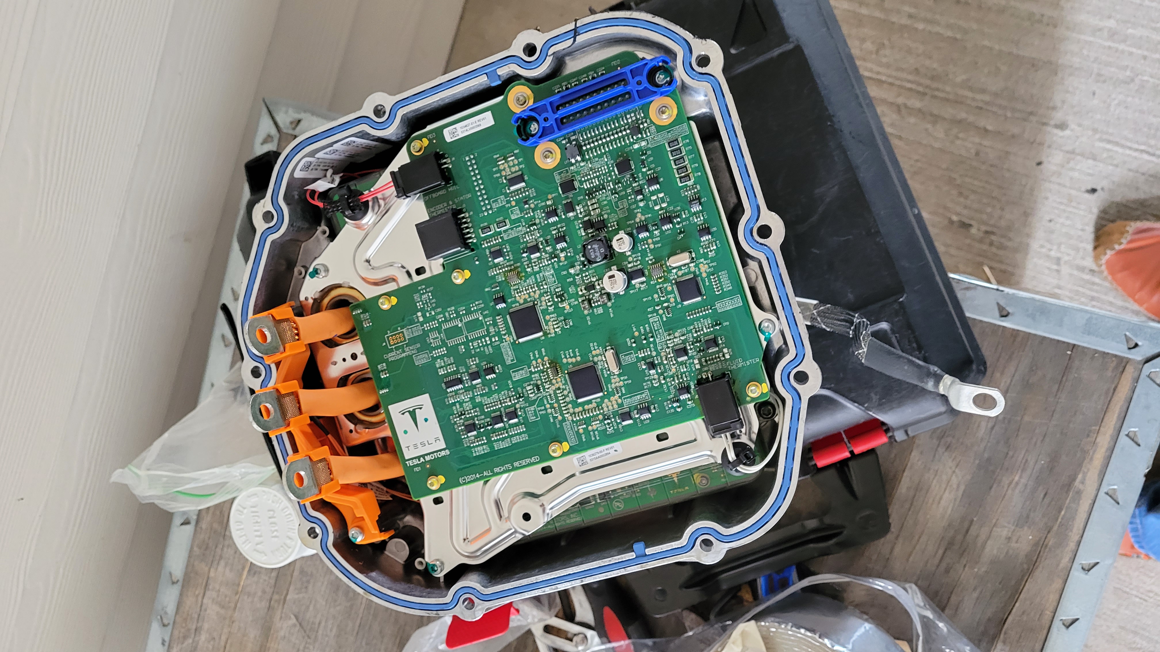

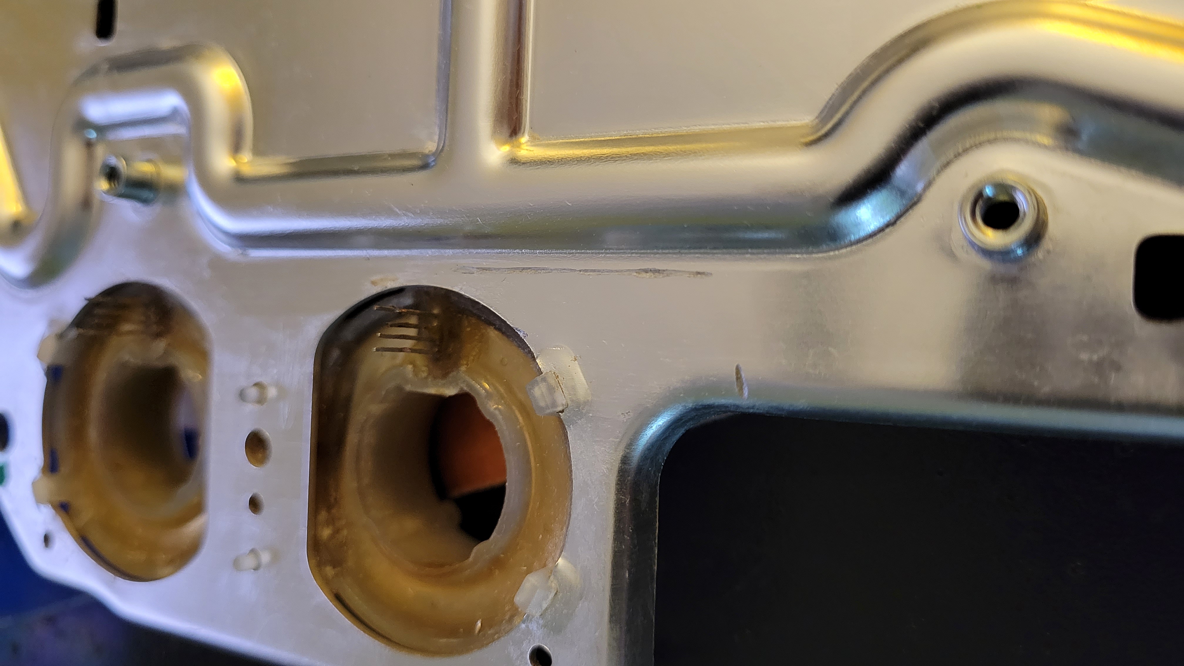

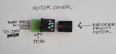

Removed inverter now having trouble removing logic board from current sensors.

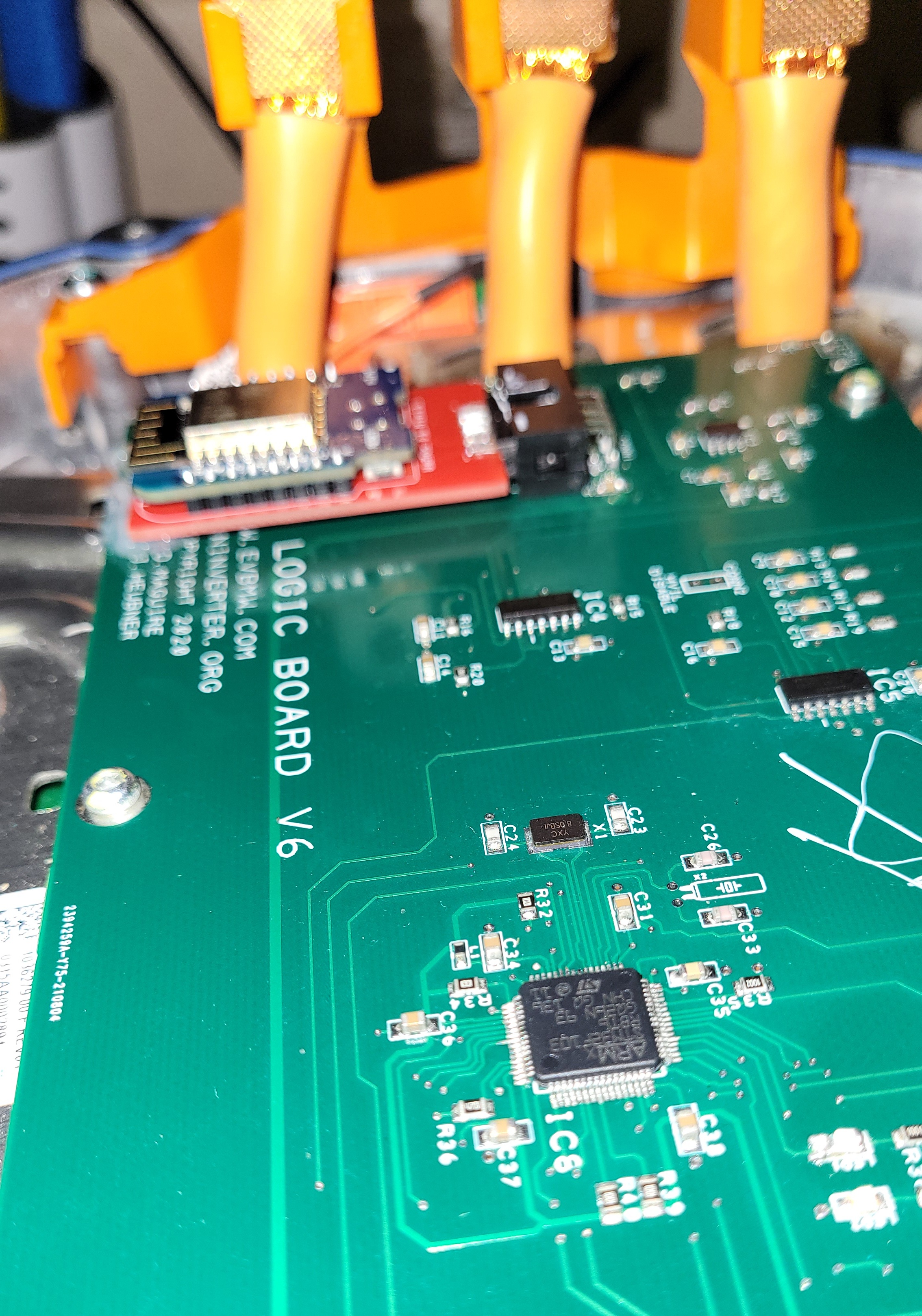

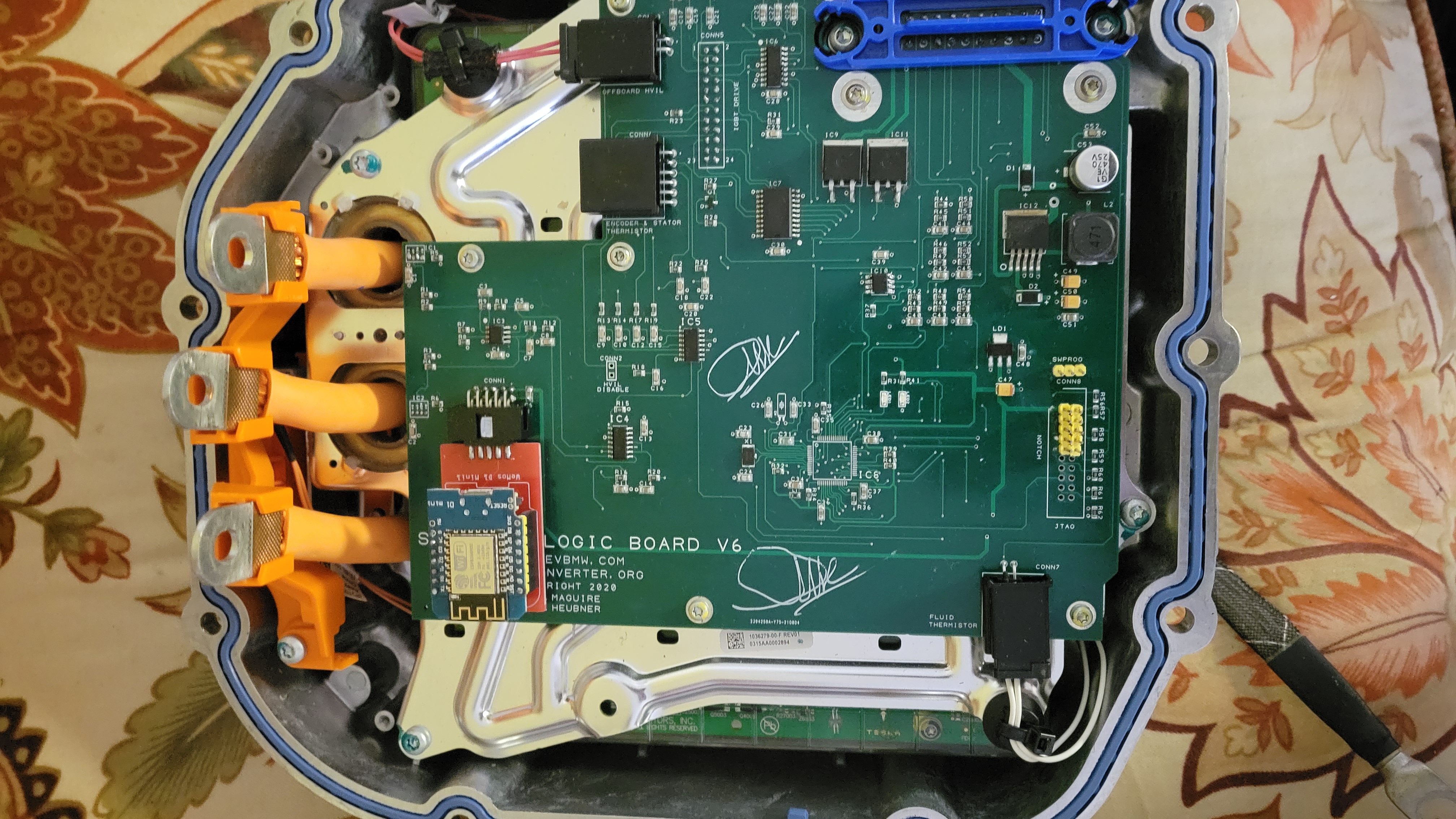

New update completed drop in logic board.
Waiting on the STM32F103RBT6 processor.

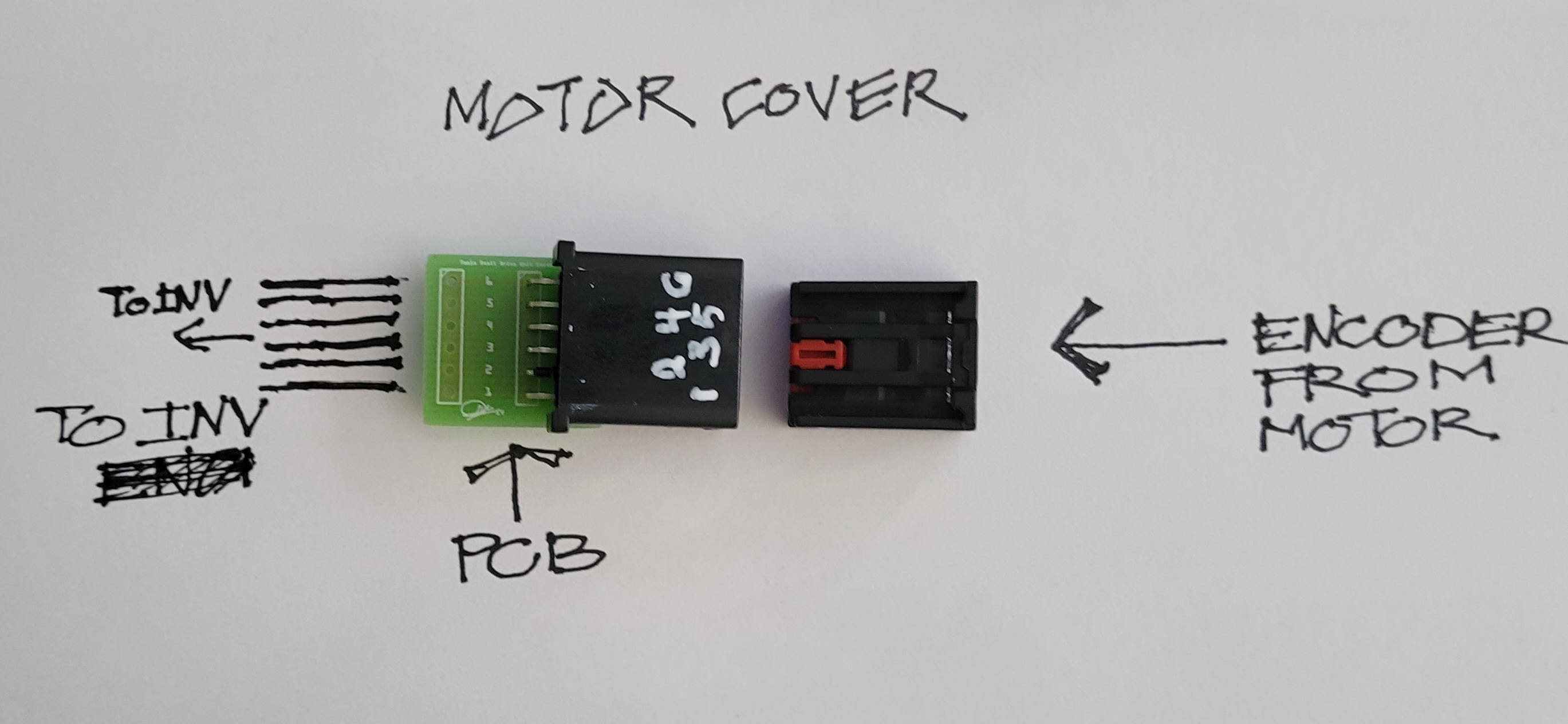

20 pin sensor connection completed.

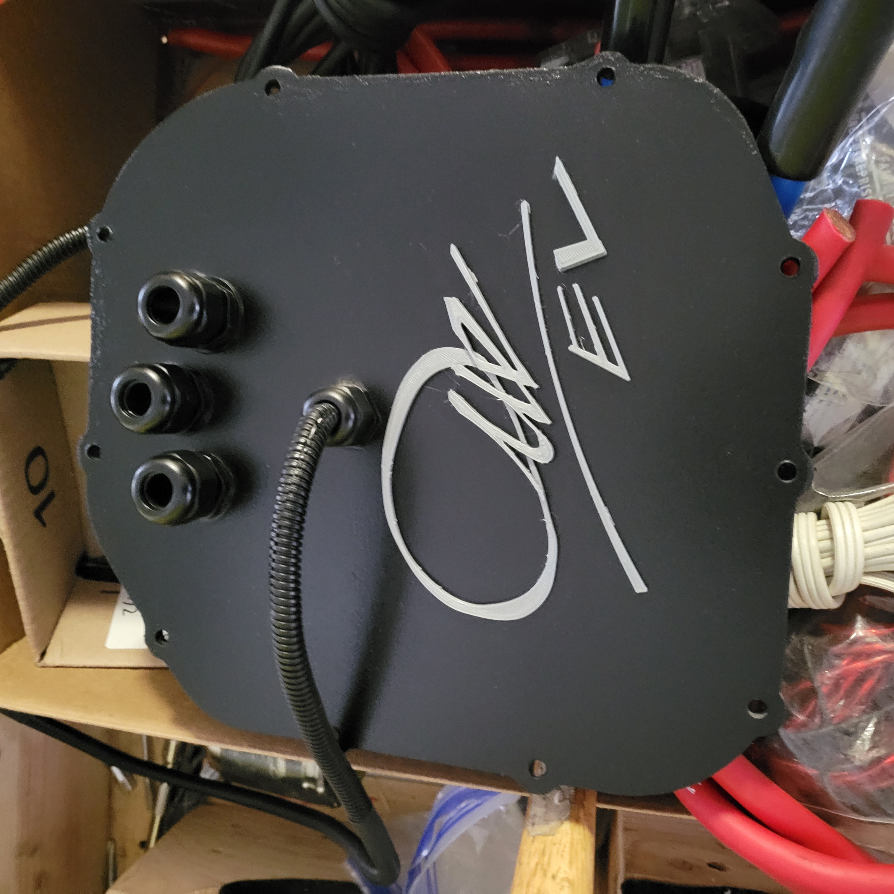

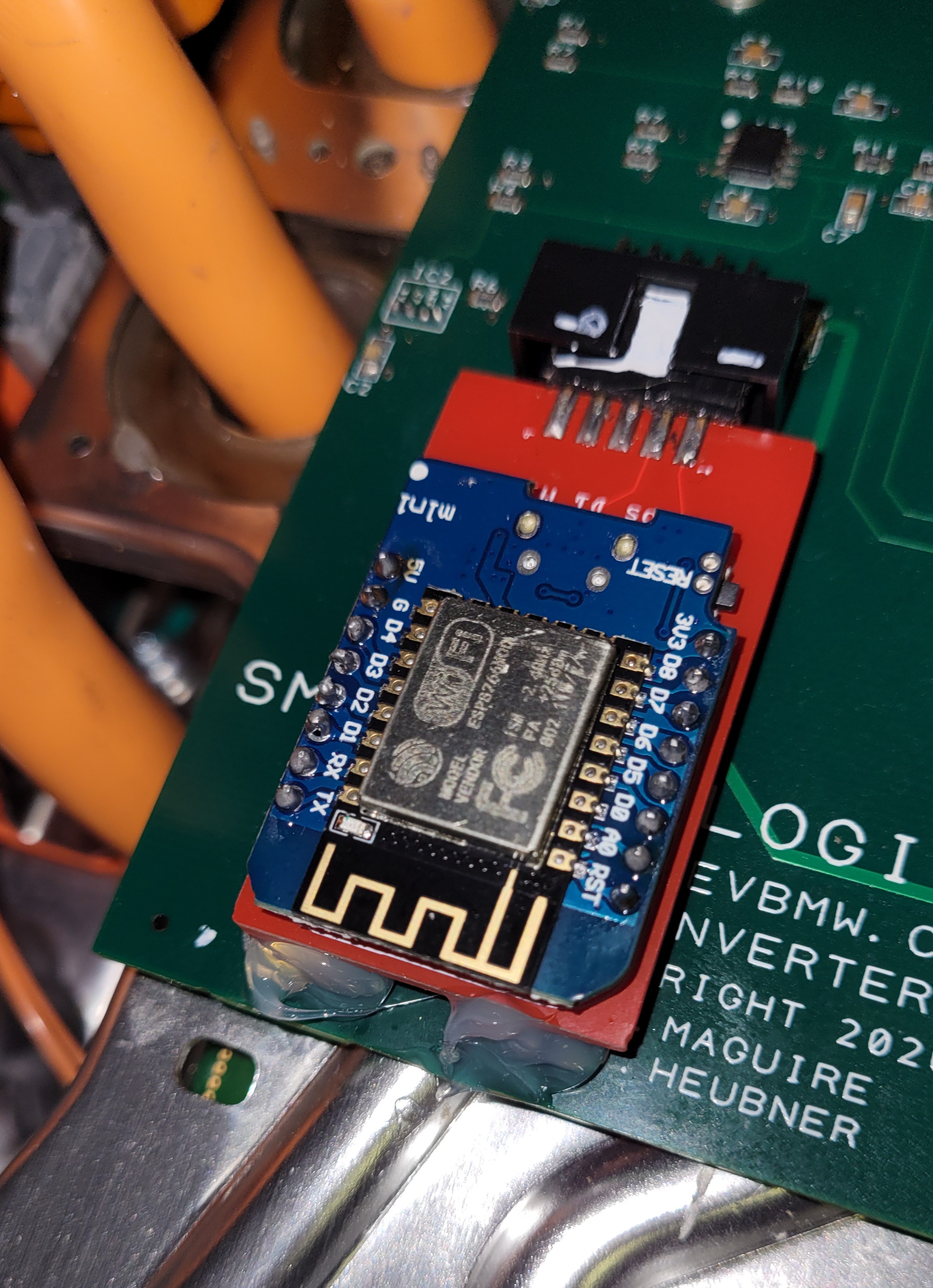

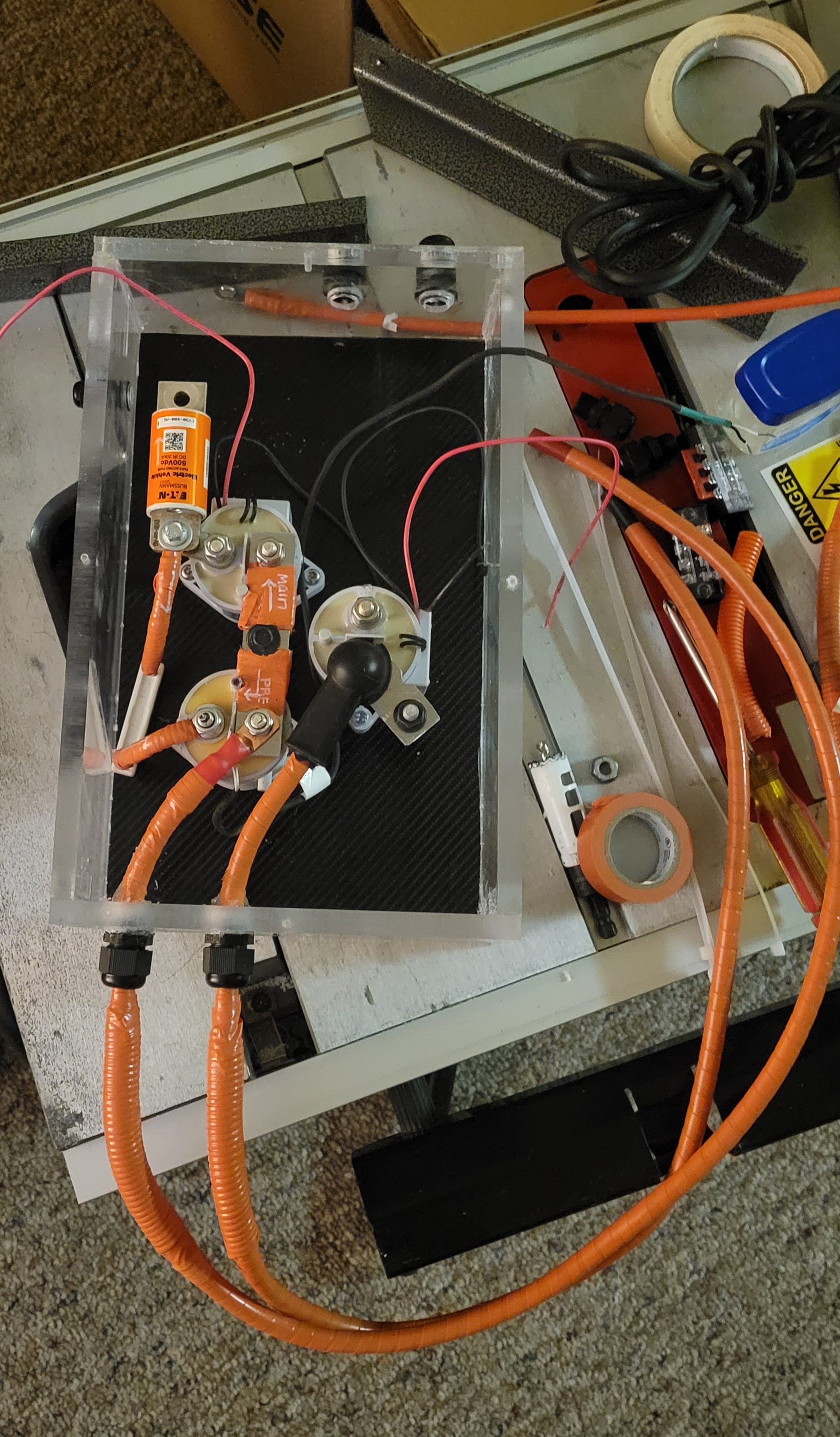

Working on the high voltage box.

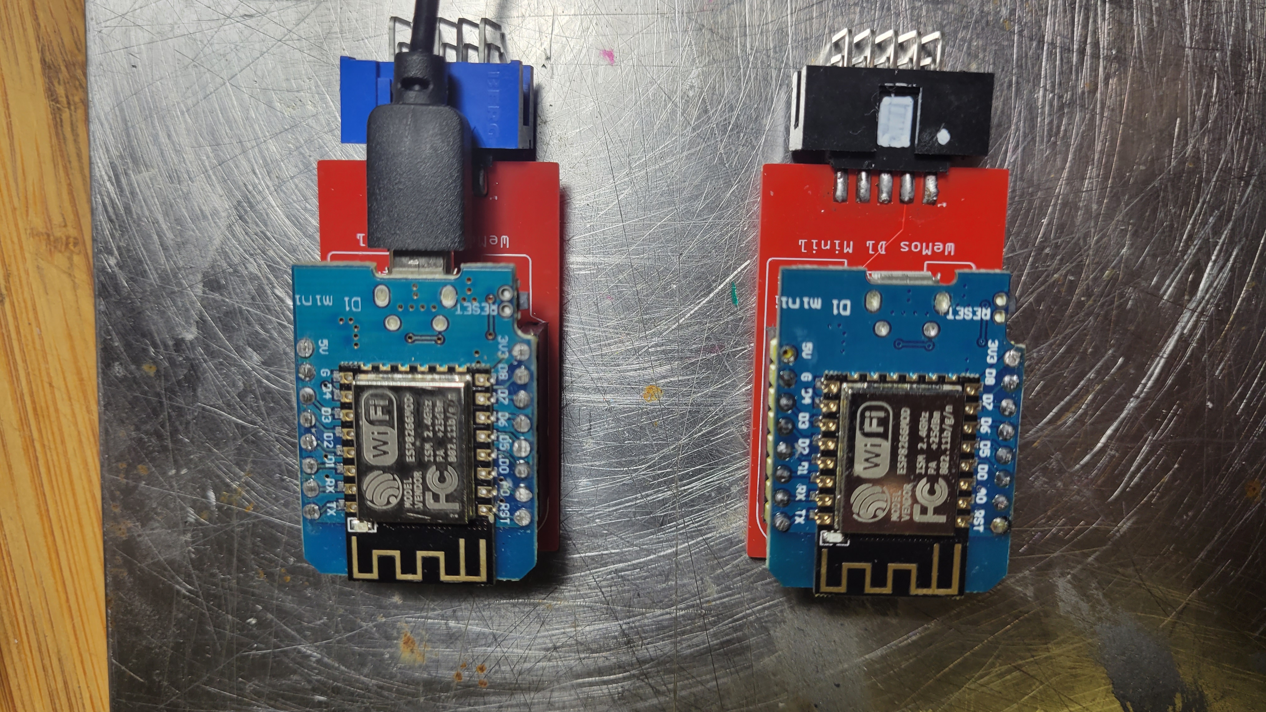

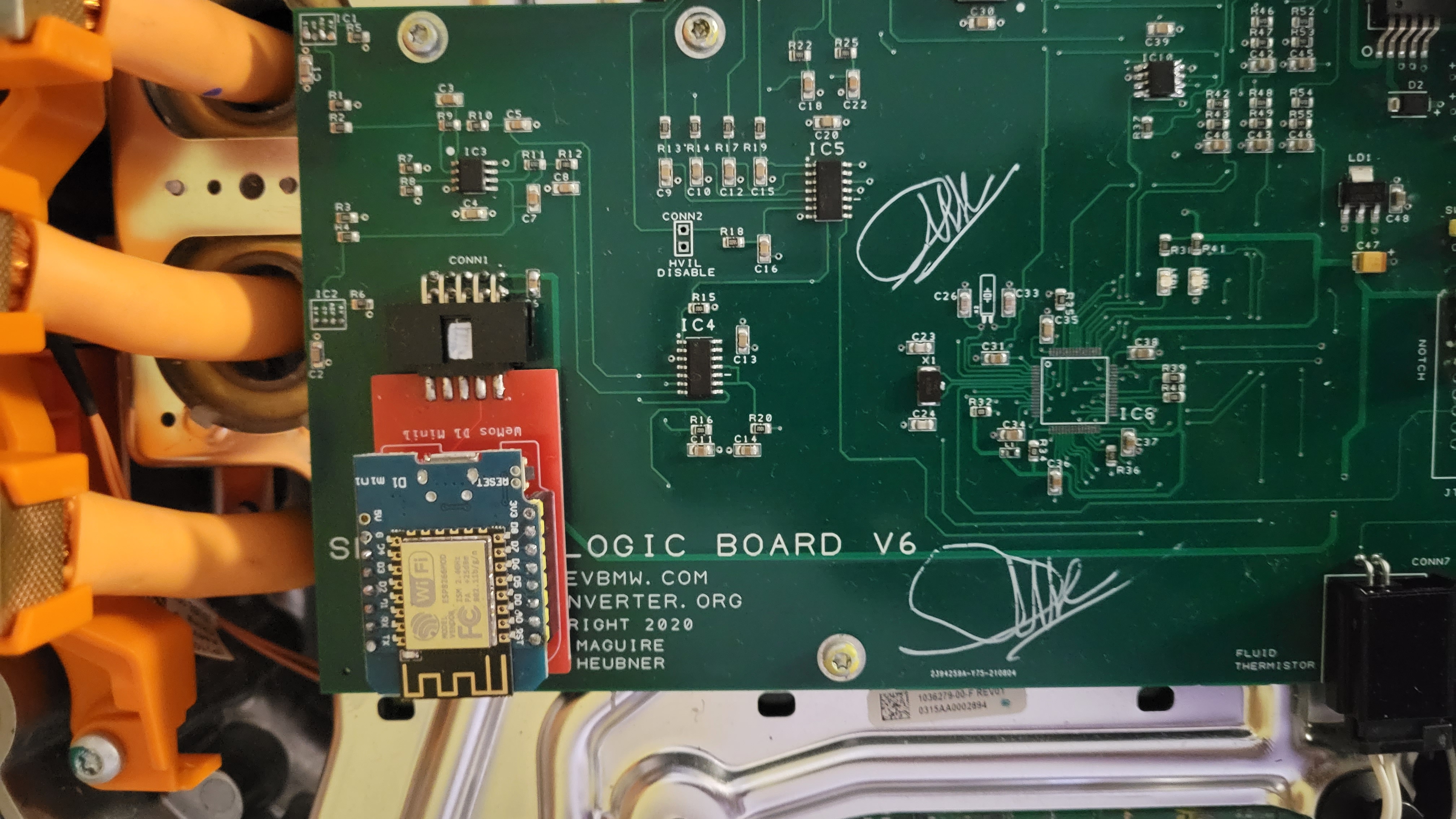

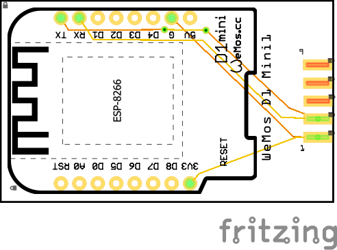

Got my wifi working with my wimos di mini
If you need Gerber file for shield please email me at qmediastudios@yahoo.com.
Logic board with my wimos di mini wifi.
Needs to be powered with 5v usb
Usb only for programing.
Board will provide 3.3v to power Wimos WIFI
You can download the gerber file for the Wimos shield
High Voltage Box Completed
See my Wimos Shield
Gerber_file

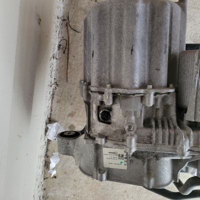

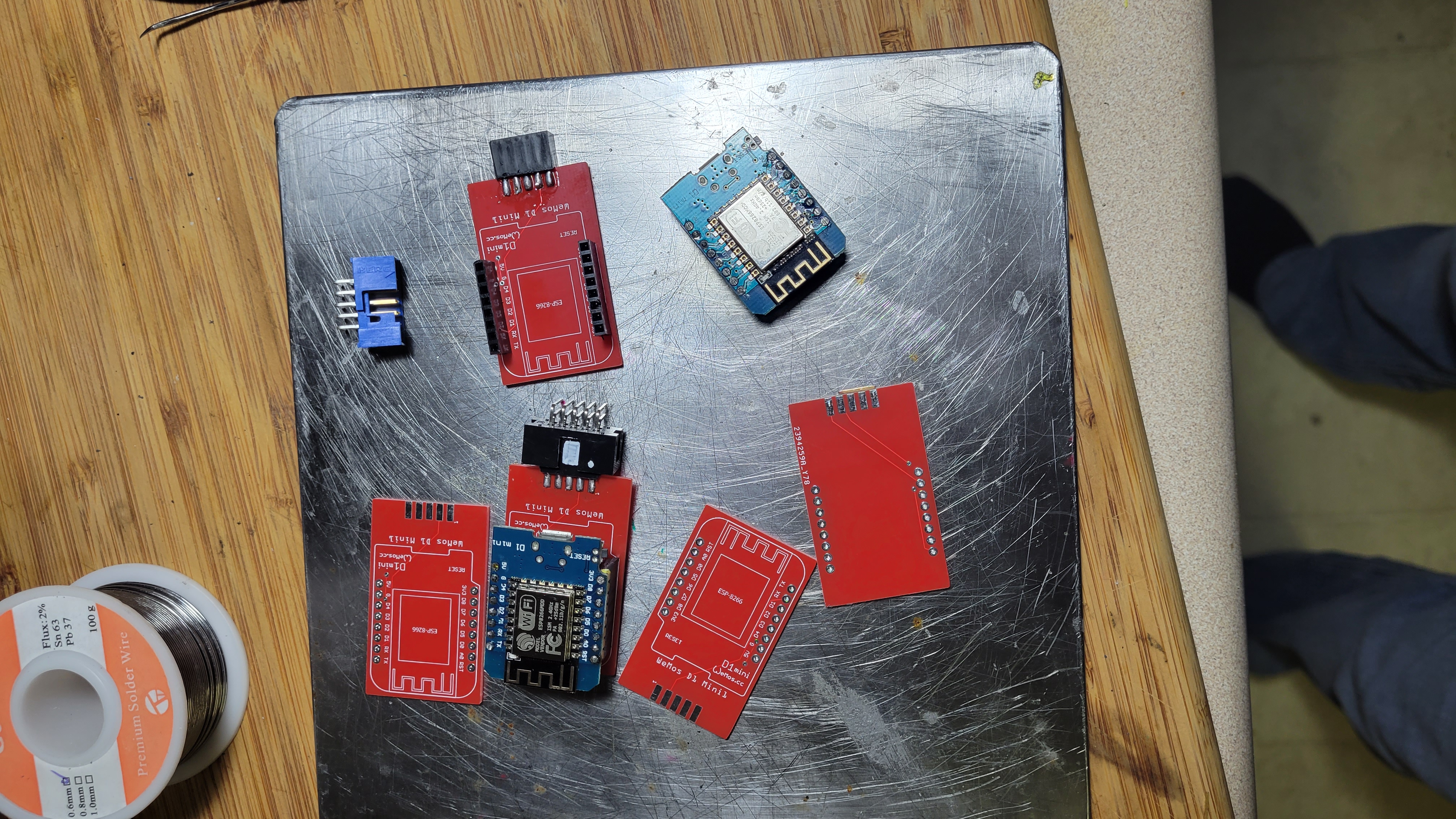

New lower profile design for wifi using Wimos Di Mini wifi.
See picture

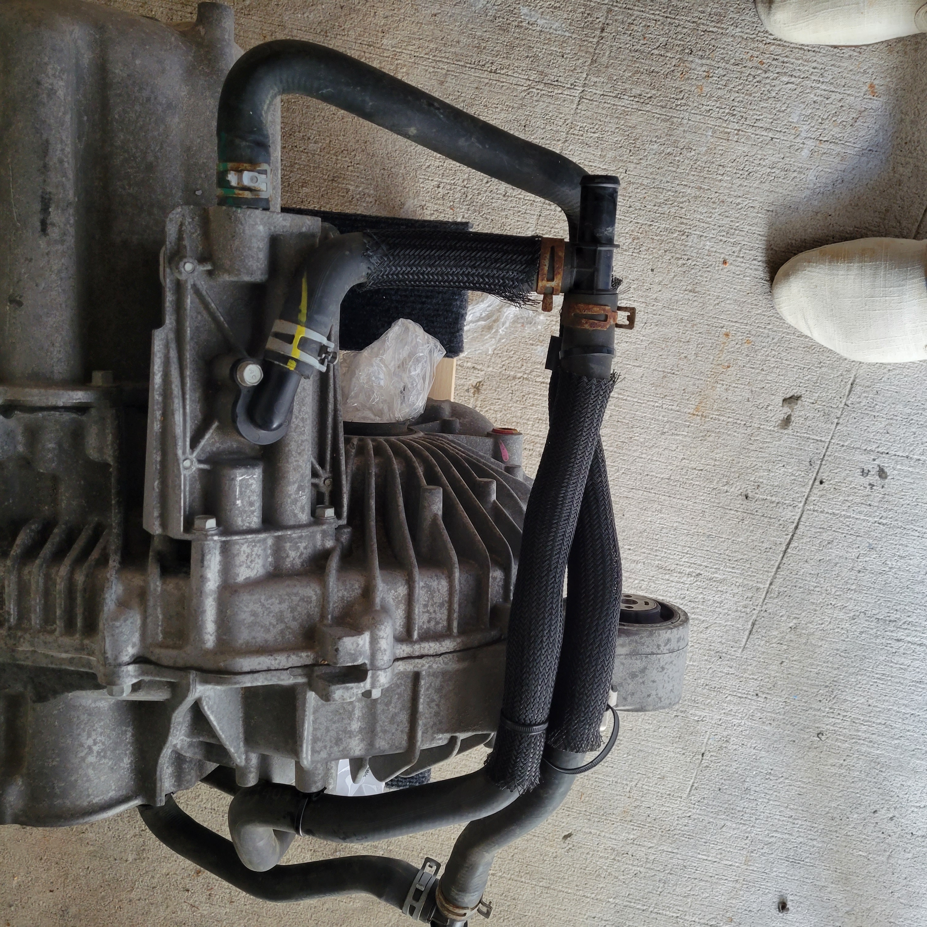

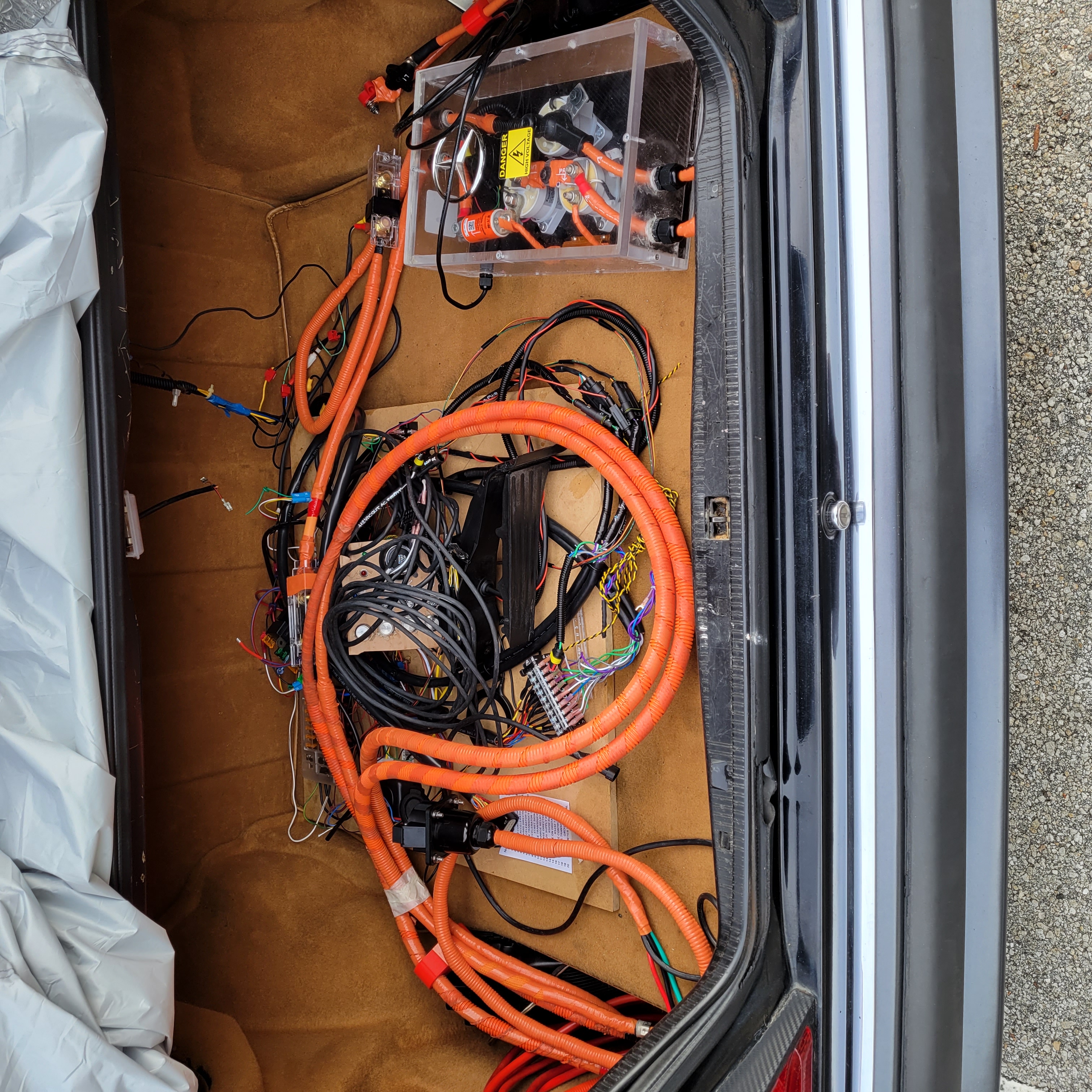

Finally got all electronic in car ready to install.

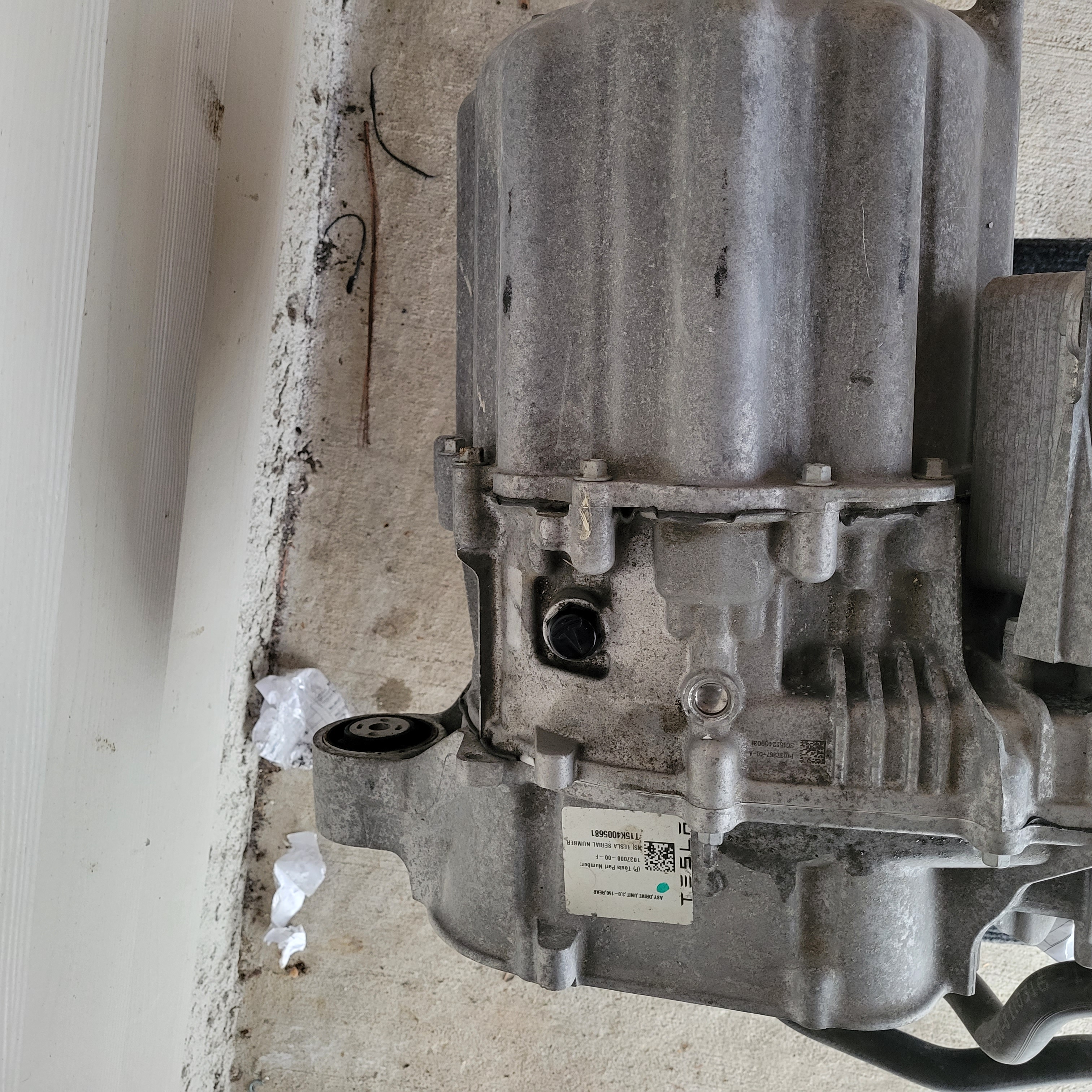

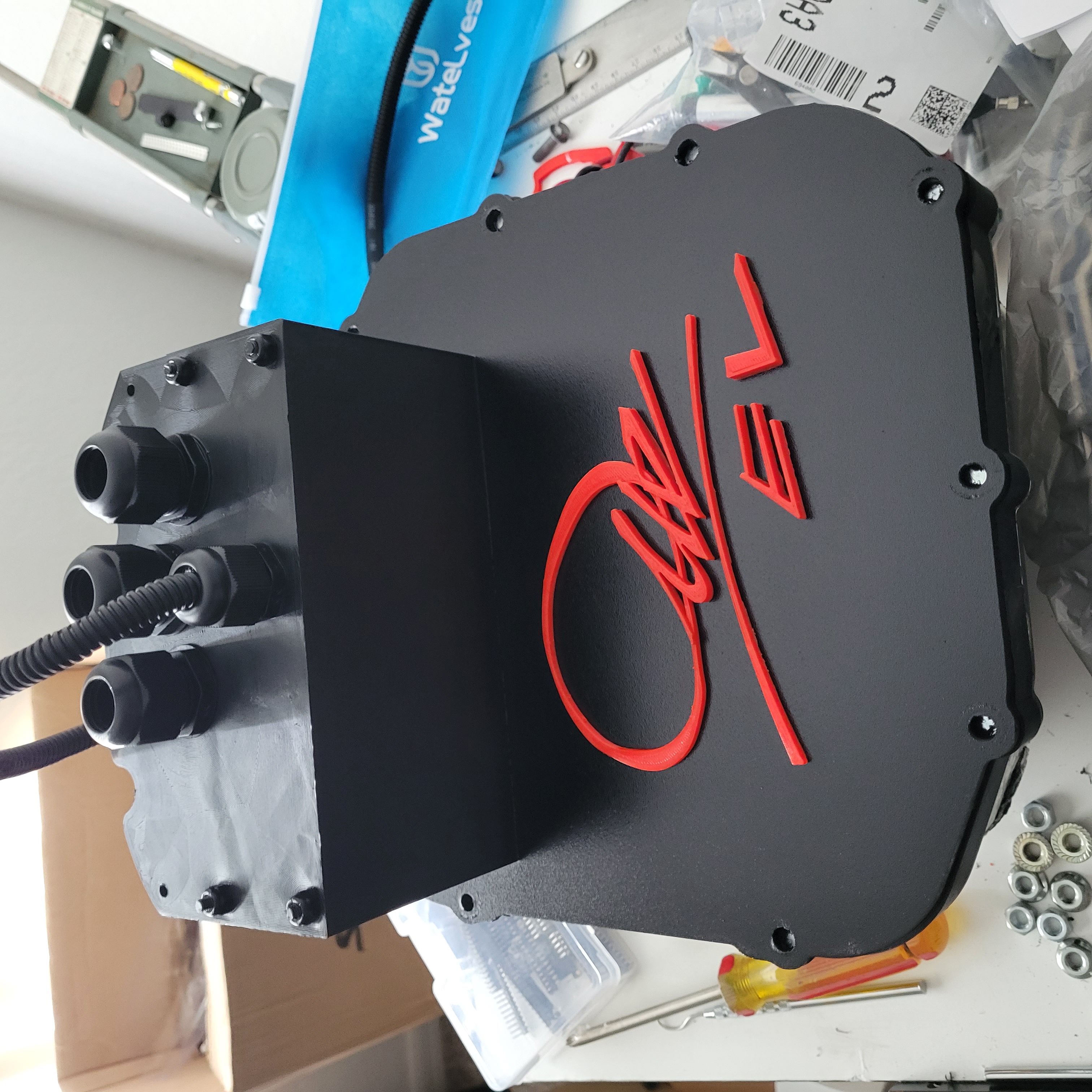

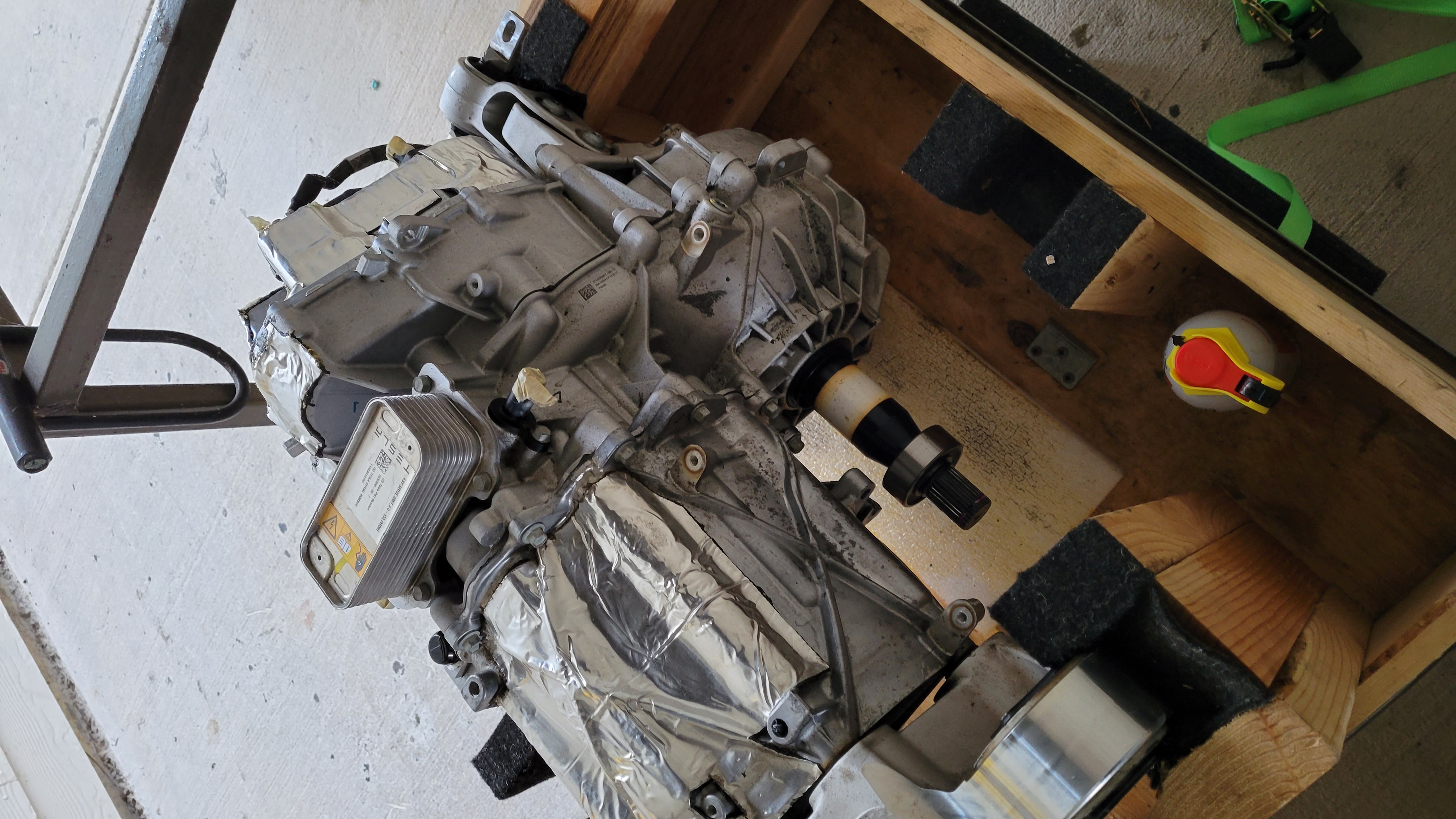

Had to buy a rear drive unit due to mounts .
See picture.
New update rear SDU INVERTER relocation have only 18.5 inch space sdu without inverter 17 inch.
Had to relocate inverter in the trunk.
All done on my 3D printer and designed with Fusion 360

Nice project. Do you have some pictures about the mechanical integration of the SDU to the rear axle of the Mercedes?
Seems to be a tight fit as you mentioned you had to relocate the inverter housing.
