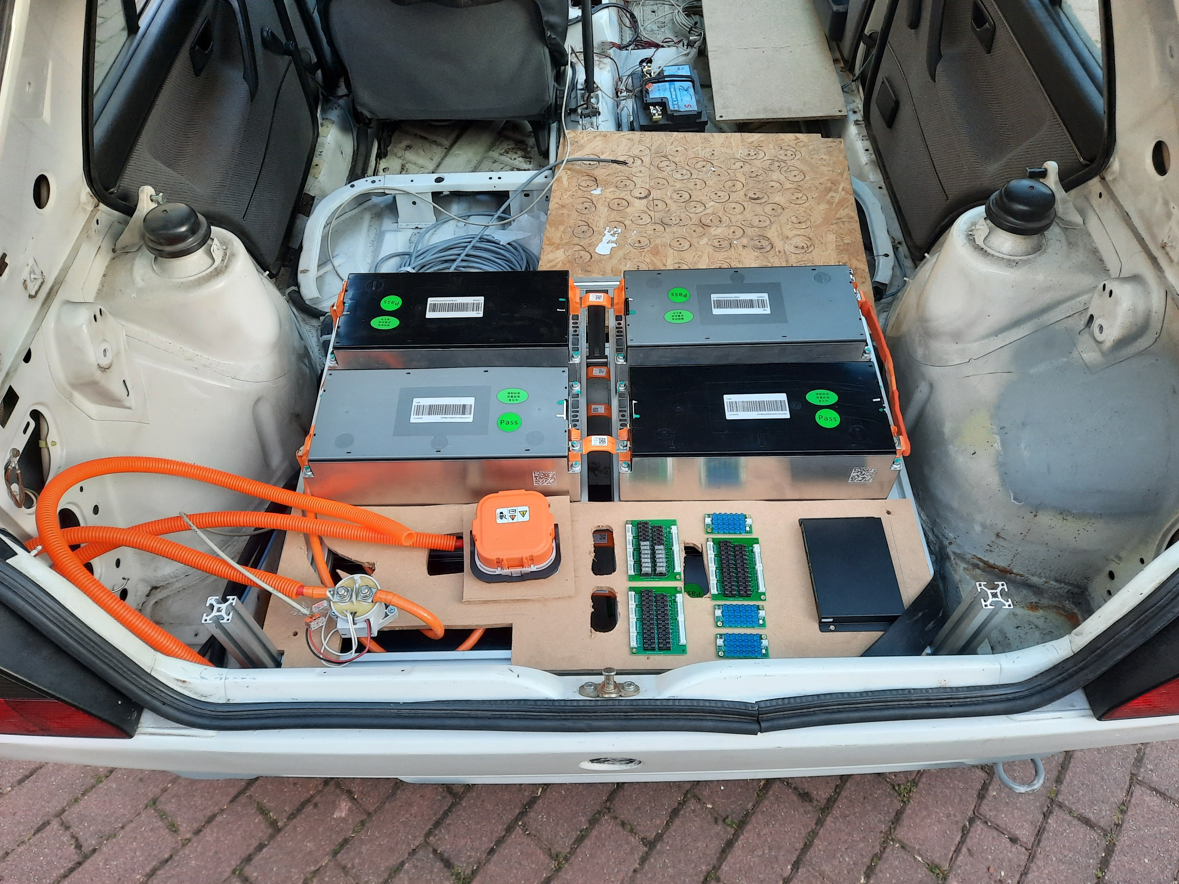

Trunk battery box is now in a “not finished, but ready for a test run“-state:
Besides the 12 battery modules there is an EV200 main contactor and a Tyco service disconnect with a 350A fuse.
BMS is not wired yet and I will do the first test runs without it. The pack is in a nicely balanced state and I will charge and discharge it within rather conservative limits.
HV wiring to the inverter is next and then the car should be ready for another test drive, this time at full voltage.
