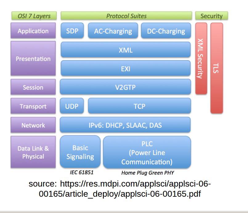

Jack Bauer wrote: ↑Tue Jun 01, 2021 2:28 pm
Step 2 : ???
Oh that's easy :
Find QCA700x datasheet without having to sign NDA
Write/port complete 7 layer network stack
Implement CCS protocol (includes making decisions on stuff that's ambiguous).
Repeatedly stab a voodoo doll you made of the IT dweeb who thought that as it's a "power" application, it would be appropriate to use an insanely complex, un-sniffable, un-scopeable wierd-ass protocol for a system that needs to have two devices talk to each other over a short, hardwired connection, just to agree how much current is needed, when 1-wire CAN would have worked just fine and saved everyone a whole ton of trouble.
Try not to look too suspicious whilst dicking around with a breadboard and laptop at your local charging station. At night. In the pouring rain.
Test on every different brand ( and firmware revision) of CCS charger you can find, trying not to die or need to call the fire brigade in the process
Deal with queries from noobs who've lashed up something with some 2.5mm twin & earth and are now wondering why things are melting
Step 3 : Profi.... Oh, hang on it's Open Source...er, bask in the glory perhaps?
Here's a diagram to get you started....

mikeselectricstuff wrote: ↑Tue Jun 01, 2021 4:27 pm
Oh that's easy :
That's hilarious
But hey, some weirdos climb friggin Mount Everest for the fun of it. I'm thinking the death rate here could be lower. Though I'm not sure.
I would liketo crap on everyones doorstep that was involved in the design process. "So gentlemen, what is the most inconvenient transmission protocol for transmitting a few bytes?". "#1: How about FlexRay?" "Na, too easy". "#2: PLC?" "Not bad!" "A new variant of PLC so existing chipsets won't work?", "Yes! Perfect!". And it goes on. JSON? Bitbanging? XML? No! EXI! Every single design choice is just aimed at making developers life a nightmare. Amen.
