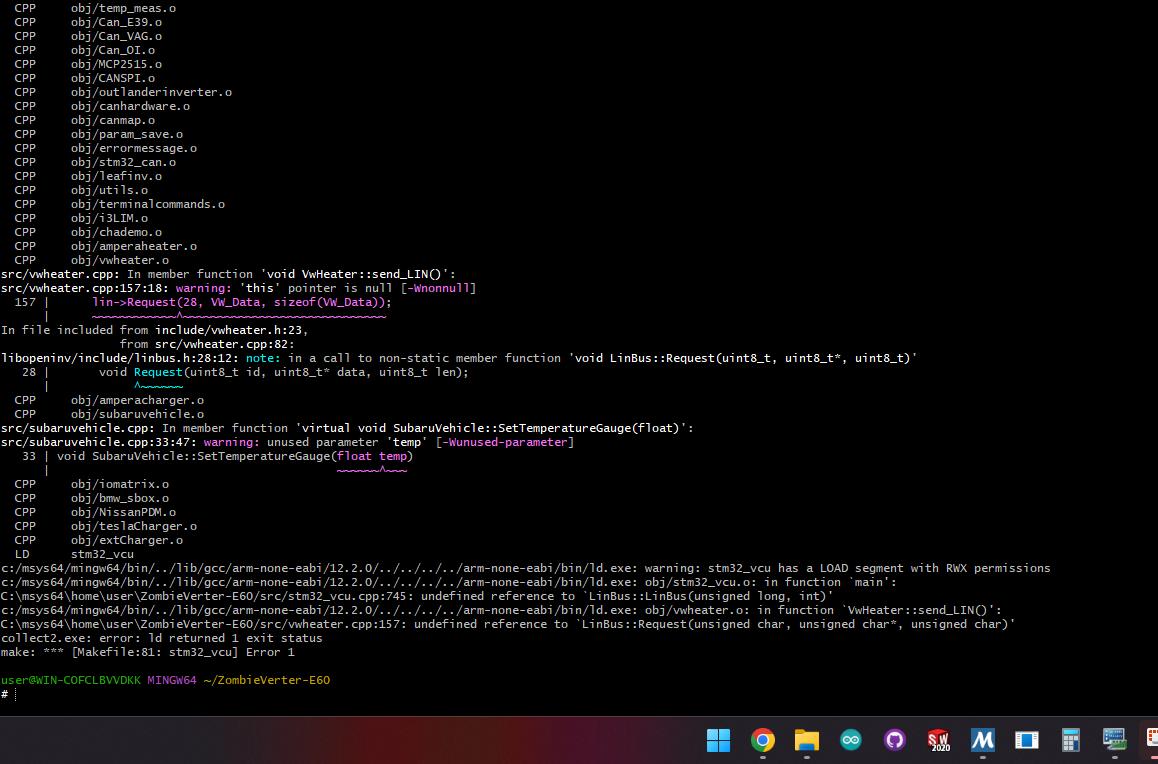

it looks like the Job is bigger than what i though. im so stuck and lost between the pointers. the Zombie is a little bit bigger than your Volvo.
so here where i`m. all the modified Files are attached everything else before this lin implementation was working, compiling and running on my VCU.
I needed to add vwheater.cpp and vwheater.h
I Initialized the USART for Lin it is connected to USART1 and wasn't initialized. I initialized it in hwinit.cpp
then i went to do it like you did on the example and i modified the STM32_vcu.cpp and STM_vcu.h to include inbus header. in the STM32_VCU.cpp i added :
static LinBus* lin; and LinBus l(USART1, 19200); and lin = &l; in their respected location attached the stm32_vcu.cpp and stm32_vcu.h
then finally the vwheater.cpp and vwheater.h both files are attached.
i wrote the function to implement control only of the vw heater. i can work on the feedback later but i need to send messages throw lin.
and now when i compile for some reason my pointer is goin to null. what im missing im personally not follwing the pointers.
here is a screen of the error.
any ideas? as soon as i can get the lin comms working the rest is easy. and BTW i know my actual control code might be off but my bench test code is working fine. that can be worked later after i get the LIN comms out of Zombie.
can you take a look over the header files, pointers locatiosn, initializeing and that sort.
thanks.
Karim

Re: Added LinBus class to libopeninv
Posted: Tue Jul 04, 2023 3:02 am
by royhen99
Have you added linbus.o to the OBJSL list in the makefile?
Posted: Tue Jul 04, 2023 8:43 am
by johu
In vwheater.cpp you have a static member LinBus* lin but that pointer is never initialized.
You need to pass a pointer of your LinBus object that is created in main() to your vwheater class
EDIT: you'll find that the inverter or vehicle classes all have a function SetCanInterface(). So you could do something similar for LIN.

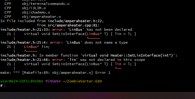

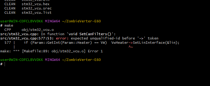

I took both of your advice and now we compile with no issues. I made a setlininterface in the vwheater and added linbus .o and we are rolling.
Unfortunately there is no lin comms going out. which after thinking about stuff, i didnt call SetlinInterface function to link the pointers.
so i went to stm32_vcu.cpp and added a conditional line to call setlininterface if vwheater is selected.
now it is complaining about classes.
here are my updated files.
any ideas how to call the setlininterface?
I need a crash course in pointers, * and & and how to pass them across the full code.
anyway im very sure that we are close. to get this zombie to spit Lin comms.
Posted: Tue Jul 04, 2023 9:25 pm
by johu
There are static classes which are essentially just C-files with a slightly nicer syntax. And then there are non-static classes which can be "instantiated". That's what you see on top of stm32_vcu where all possible inverters are created. But only of of them is linked to the pointer "selectedInverter".
You'd do the same for the heater, have a pointer of type "Heater" (the base class) called "selectedHeater and depending on user selection that pointer is set. Make sure you add SetLinInterface() to the base class, not to your specialized class. Again, check inverter.h/cpp on how this all plays together.
That way you can always call selectedHeater->SetLinInterface() (and selectedHeater->SetCanInterface() for that matter) and don't need nasty conditionals.
Posted: Wed Jul 05, 2023 5:37 am
by johu
heater.h needs to include linbus.h otherwise it doesn't know the type LinBus ;)
Posted: Wed Jul 05, 2023 7:21 am
by 7yatna
johu wrote: Wed Jul 05, 2023 5:37 am heater.h needs to include linbus.h otherwise it doesn't know the type LinBus ;)
Oh My god, i was that close. I just added linbus.h into heater.h and compiled with no warnings at all.
