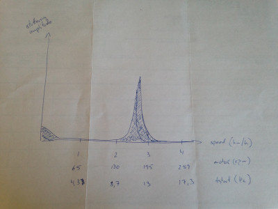

Re: FOC low speed stuttering
Posted: Sun Apr 04, 2021 10:51 am
by bexander
I have now tested setting both curkifrqgain and fwkp to 0. I can't notice any difference between default value and 0. Tested a bit back and forth.
I'm attaching a graph of when I experience the stuttering.
The first just above 0km/h is barely noticable (no problem living with) and then a quite steep peak between 2-3km/h (anoying, specially during regen brakeing to full stop), above this nothing. More noticable with slight uphill load. The same thing applies doing regen, steep peak at 2-3km/h.
EDIT: Just beeing very specific with what I'm experiencing so that if others have similar or not at all similar behavior.

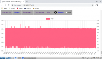

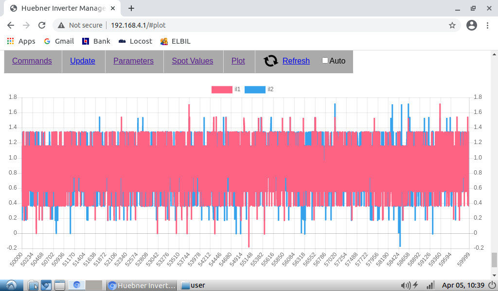

johu wrote: Sun Apr 04, 2021 4:30 pm Ok, too bad. I can post a screenshot of my angle and current plot to compare noise. It was like 3° jitter on angle and 7A on current.
Will try other filtering options next.
Is this what you are refering to with angle and current plots?
Both at standstill. No difference when in D, R or N. 10000 data points and burst length 1000.
Both currents are a bit offset but maybe within what you could expect?

Looks better than mine, will post later. And I don't have a bad stuttering problem, I really have to provoke it.
