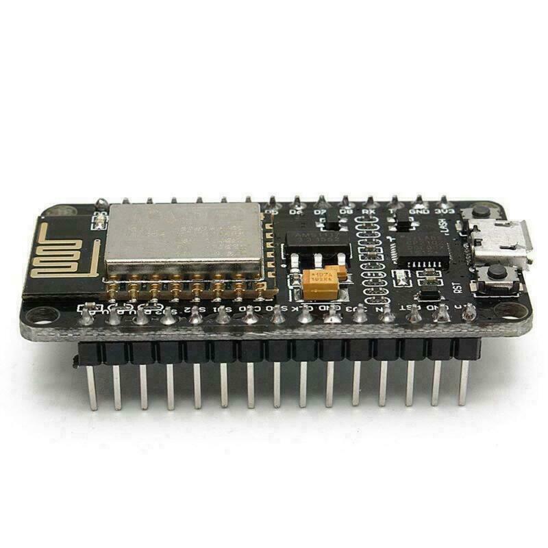

Tell you what, for anyone out there that has a LDU, and doesn't have one of the below; get one! Totally takes the stress out of playing with the params without needing to be right next to the rear wheel.
https://www.ebay.co.uk/itm/NodeMcu-ESP8 ... 2749.l2649
