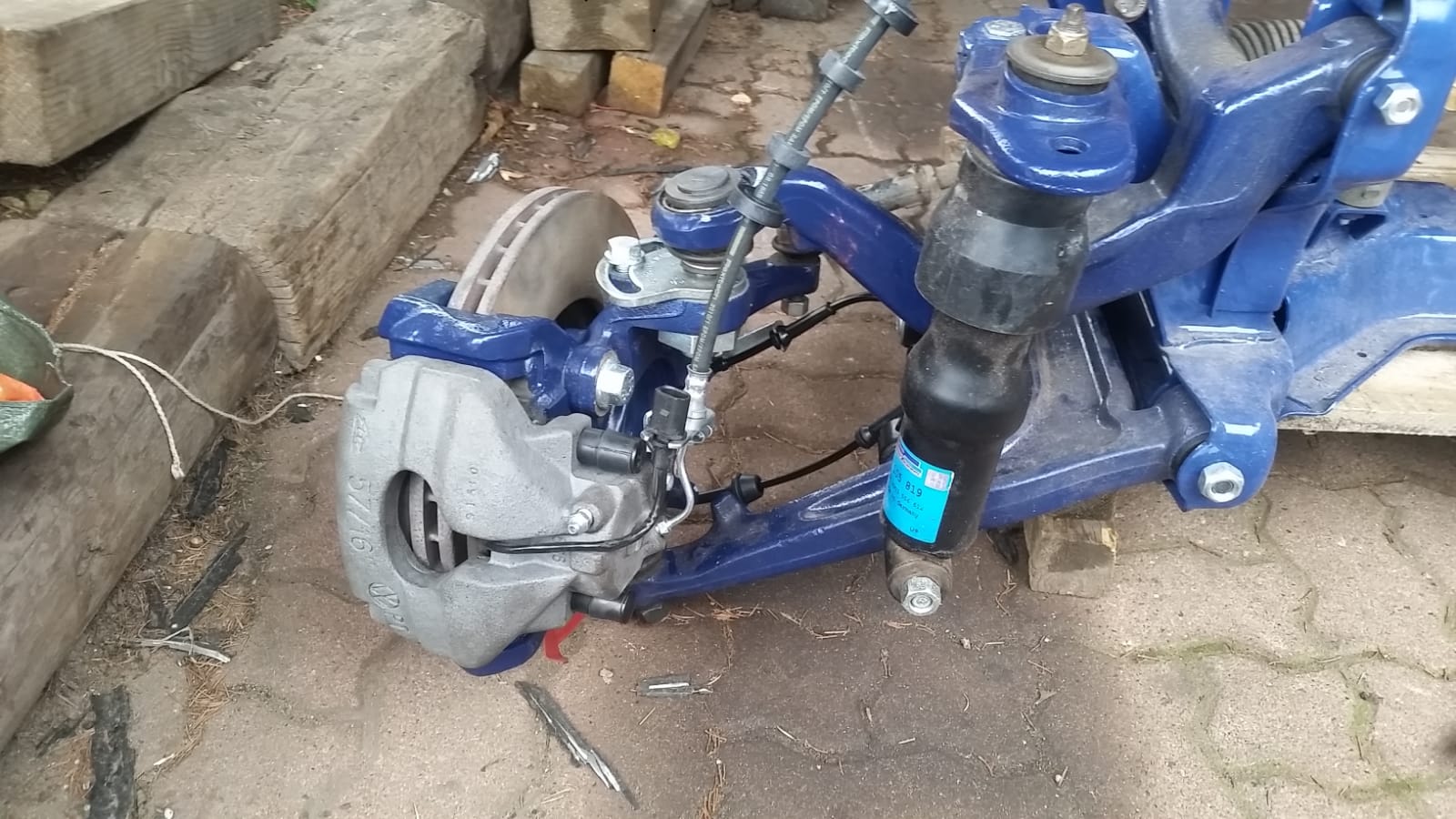

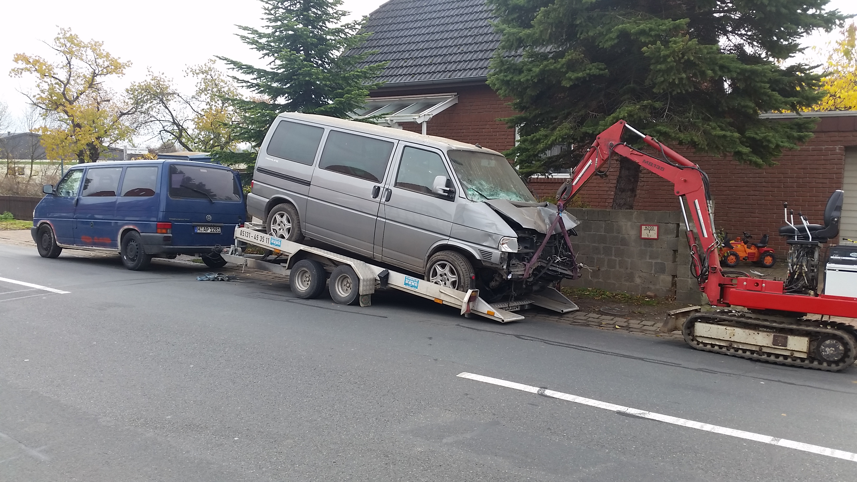

Hello Guys,
I am infected from the Tesla Virus , My Name is Alex im a Electrican, i have Study Energytechnic, i came From Hannover Germany, And for my Children i want to Drive without CO2.
I have an 2001 VW T4 Highline Bus Its Front is a Litle bit Crunshi but i have all Frontparts Allready. I want to put in a Tesla Drive Unit. Original the Car has 75Kw (102PS). 50KW is ok For me. I have also a 25s 33p Tesla Model 3 Battery Pack ~96V and 158Ah. I have the Idea To Split The Pack in have and Conect these to a 50s 16p ~192V 75Ah. I Will Update the Capacy Later when i became a good Pack.Actual i think as Daily Driver is 14,4KWh enouth. It Needs A Box under The Bus and a BMS. I Have Calculated that on 192V @50KW i have a Current of 260A what equals 16,27A on each Cell or ~3,4C. That i thik is OK for the Cells. But its only 192V/1,41=136Vrms i am not sure that i calculatet right.
That is what i have. Now i look at a Drivetrain. But what is the Best option ? I have no background on Tesla Drive Units his Variants and his Capebilitys.
What Drive is the Best to Convert ? At EV West i see all time The Model S LDU.

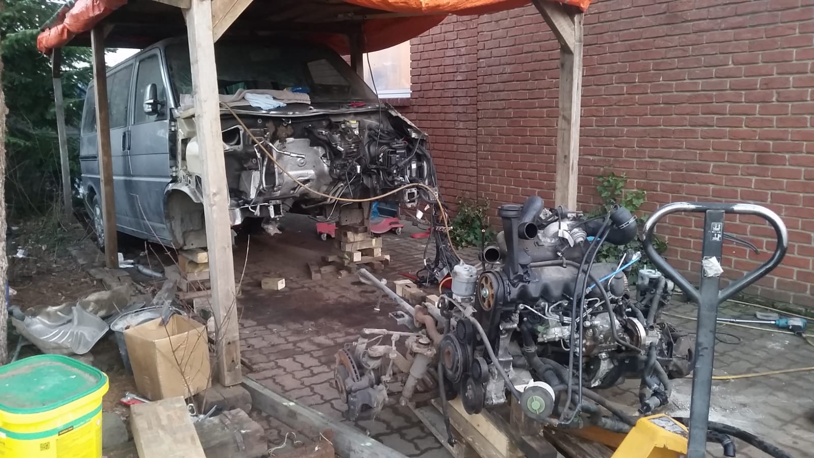

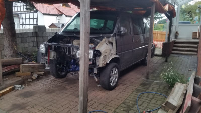

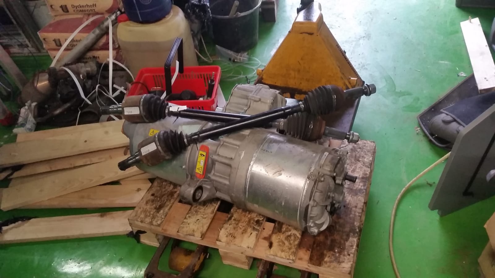

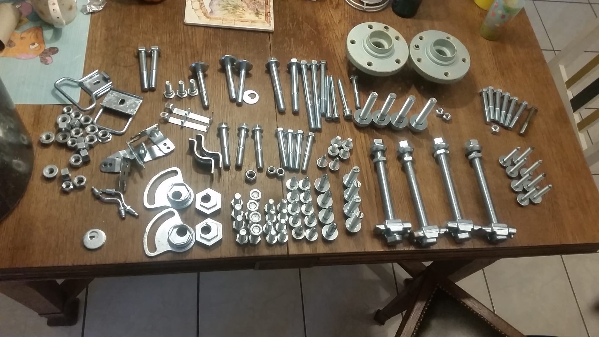

Jes the Highline is my Dreamcar, since 2010 I've only been driving T4 buses, it's my third bus. A friend had an accident with it and fatally injured someone with it, mentally he couldn't do anything with the bus and almost gave it to me for free. it has leather seats, two zones, AC back to back seats and a sleeping bench.
The right longitudinal beam must be straightened by 25mm and the lower window frame must be replaced.
Yes, that's right Kassel, that's almost around the corner, I grew up in Holzminden on the Weser.
How and where can I change this display with city / country? I didn't find it.
Yes, that's right, my performance requirements are currently low, but in the future, when I get a Model3 battery pack, more power should come from the motor. Because of the low voltage, the battery will not provide much power for the motor.

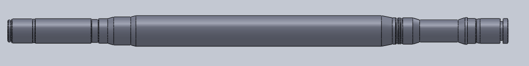

The original drive shafts will also no longer fit. What is the best way to do this ? a friend has a CNC company for mechanical parts. I also recently got a 4-axis CNC machine, but I am still very busy learning: D

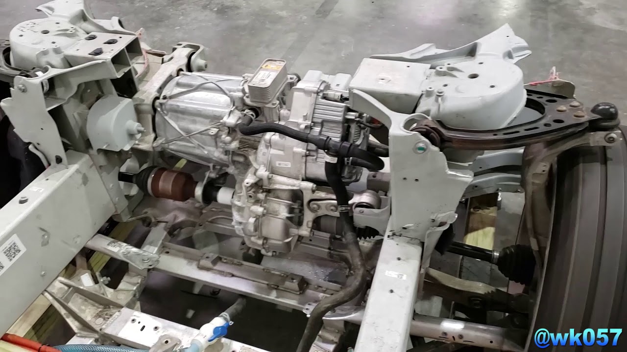

In terms of technology, I'm very interested in the motor of the Model 3 Drive Unit, due to the better operating behavior of the SynRM motor.
But I think in order to have a good success I should take the LDU from the Model S. Are there any special variants that I have to pay attention to?
I think there are different rear versions right?
I haven't read anything about the Model X versions, only SDU and LDU. i think LDU looks like this https://www.evwest.com/catalog/product_ ... ts_id=476
At EV West it says from 275V onwards it still works with my 192V?

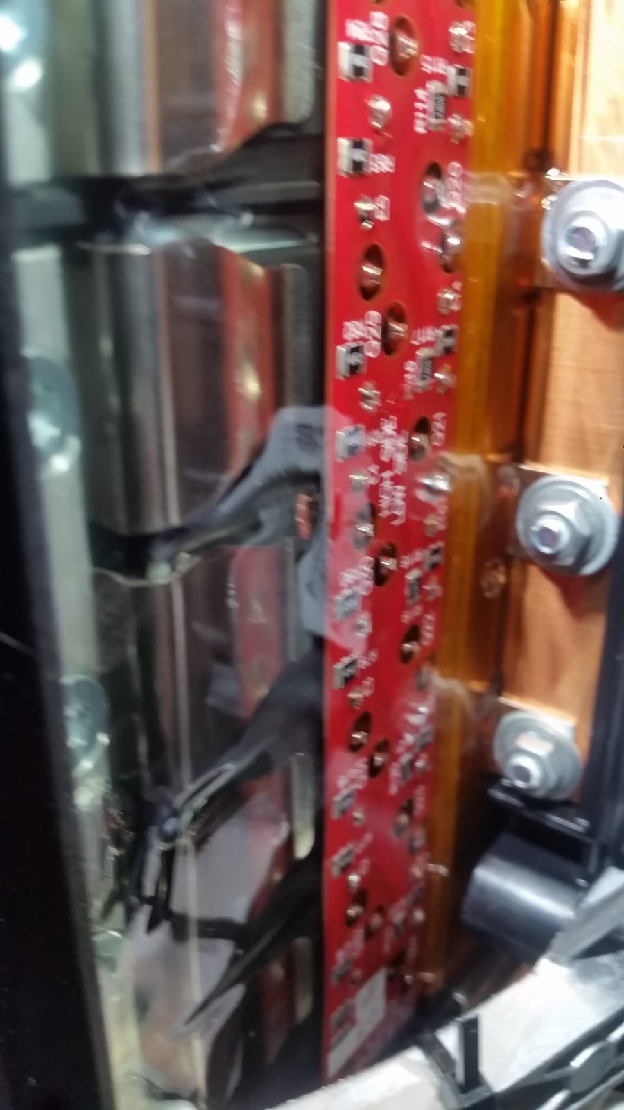

It will probably be difficult to reconfigure the Model 3 pack for the higher voltage, so you may need to look at something different.
With the Johannes board the motor can work with any voltage between 100v-400v. 192v is pretty low, I don't think I have seen anyone run the Tesla motors at that speed.
The SDU will likely be better for you, especially if you only need 50Kw; it can do 220Kw in bursts.
The Model X and Model S motors are the same. Just be sure to get a motor from before about 2019 and you should be just fine (in 2019 they changed the front motor in the cars for a Model 3 unit).
Model 3 motor control is still under development so that is not a recommended path; maybe in a few months the control board will be ready for general use.

For 50kW you could easily use Mitsubishi Outlander motor with original driveshafts. Motor is a nicely packaged 10pole PMSM which can turn to 12000rpm. It can be run by any FOC Openinverter, Lebowski inverter OR maybe use Mitsubishi original inverter with commanded torque through CAN bus. Another plus is that it has actually been used to power 2ton vehicle already.

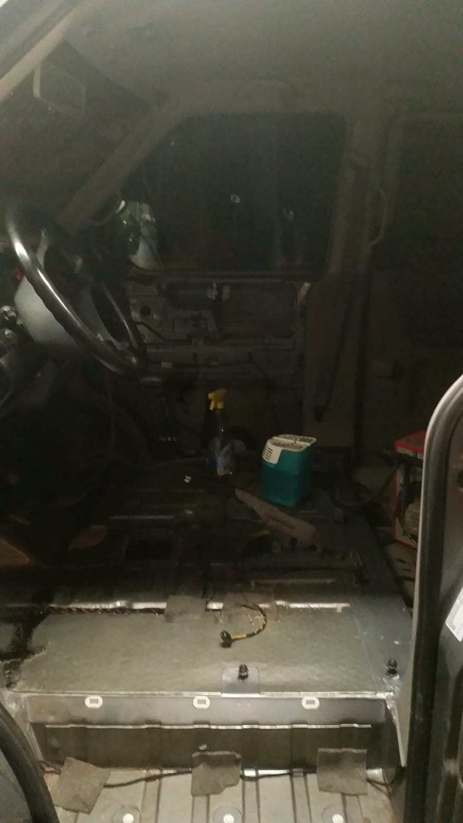

I can easily bring the Model3 Pack to 192V. I know that the voltage for the engine is very low, but for testing for powers of only 30-50kw that should be enough.
The motor should in any case later deliver 200-300hp with a different battery. At the moment I have very little money but still want to find a point where I can start with the renovation. and I think the engine is the most important point.
I think I'll take the LDU.
I would also have the opportunity to get a Siemens IPV 5135-4WS14-W11-Z fon a Sprinter for 600 €. But the inverter is also a Siemens and already 20 years old in contact with salt water.
Adapting would not be a problem, but I want to avoid transmission problems. A transmission repair also costs a minimum of 1500 €. then I can take an LDU for 2000-2500 €.
I really like the design of Tesla where everything is together and coordinated with each other. I think you can't beat the cost-benefit.
OK so an LDU before 2019.
Do you have occasional problems with LDU? If so, in which form ?
It's hard to see if everything is working when you buy it. are there still options?
what should i avoid ?
I will avoid engines with fire damage, that's clear.
Now one more thing.
what about the installation position of the engine. can i turn the motor 180 ° back to front?
the original direction of rotation is then wrong. You can simply say turn the motor the other way around, but is the gearbox with the helical teeth designed for this?
I think turning up and down is not possible because of the oil pump.

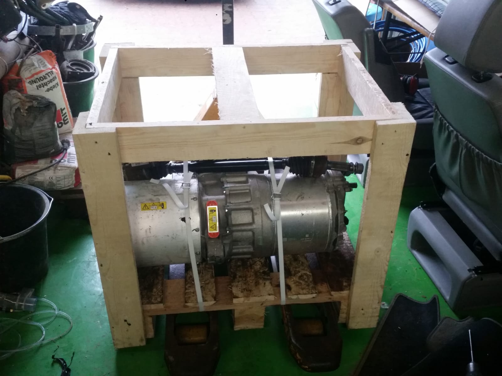

You can turn the LDU backwards if you need to. You'll just need a 'reverse oil pump' from ZeroEV.
viewtopic.php?f=11&t=210 Should have some good info on running the unit backwards.

Do you happen to know what to do with the gear bearings?
The transmission is only designed for 15kmh in reverse. and the helical gears then push with full force in the other direction.
Do you know which bearings are installed or where you can get the information?

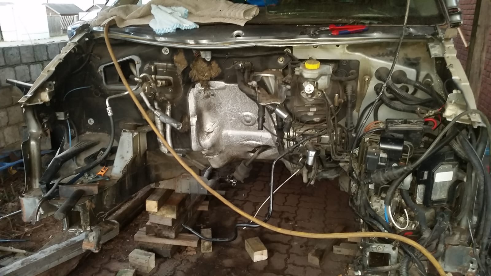

The conversion started yesterday, the next thing to do is to straighten the body.
Maybe I'll have a company do that or someone who has done it many times. I have to do the removal of the axle / motor on the donor vehicle Nr.2 again.

The TESLA stuff has been run in reverse rotation with success and for extended periods, the bearings are not the real concern, the lube pump IS. With the lube pump running backwards, no oil is delivered to the critical areas, which is why you need to change it as suggested above.tollerteppich wrote: ↑Thu Feb 25, 2021 9:23 am Do you happen to know what to do with the gear bearings?

Now it's going around: D
The LDU finally arrived yesterday. I also got drive shafts together for 2700 €, but the motor cables are missing.
Missing parts:
-LDU board - ordered
- MS3Pro ULTIMATE Center Harness from DIY Auto Tune
-Reverse Pump from ZeroEV.
-Encoder connector - from where?
-Motor cables - Does one of you have motor cables lying around for B + and B-?
-Precharge Relay + Resistor
-Main relay
Have I forgotten something in terms of hardware to get the motor to turn?
Damn it is expensive, i am Almost Empty ...
Many greetings

Today I removed my 63KVA generator with a 10L truck engine from the yard in order to get to the front axle of the second donor Bulli.
The 151PS TDI Engine Died in April 2017 https://www.youtube.com/watch?v=dUD97yN07K0.
No this is not the option for long journeys
it was too cheap not to buy. And Run how a Swiss Clock.
https://www.youtube.com/watch?v=9_c4gBOmlGU&t=72s
I put it on to my new storage Space, that i am build at least. so now i have space to work. after the storm and rain it continues outside.

The board arrived today.
I then quickly built a holder for the engine stand.
Soldered the plugs. So far so good.
now the plugs, cables, relays and resistor are missing
tomorrow I'll take the accelerator out of the second donor car.
my wife then wants a new wiring harness in her driver's door.
what is the best way to glue the wifi module?
i think i'm vomiting...

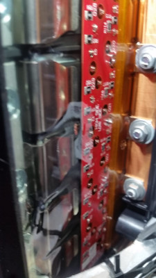

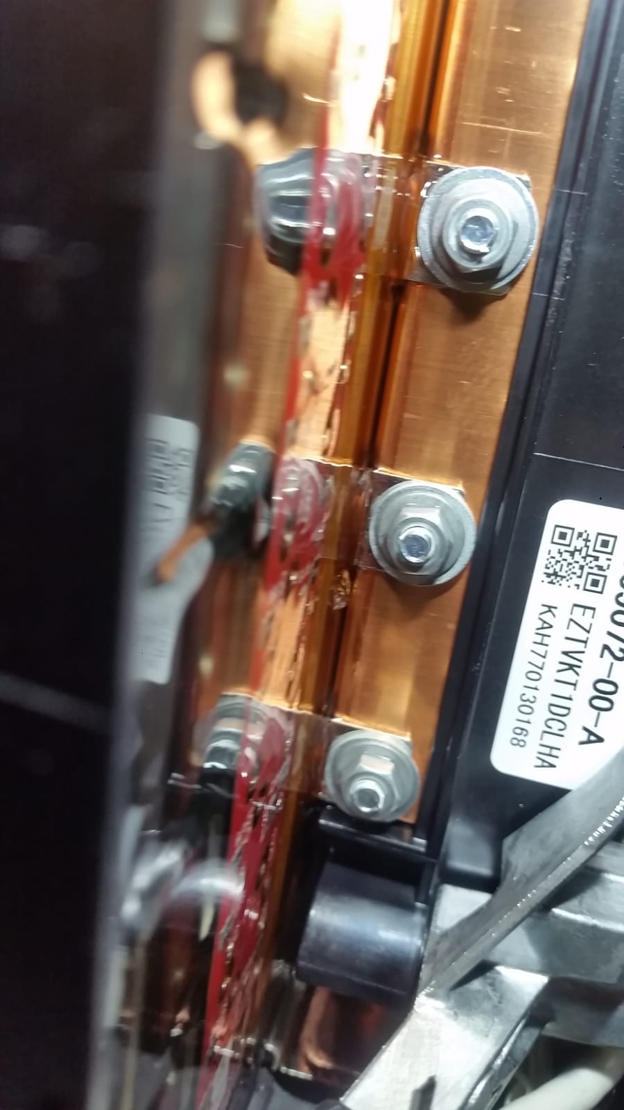

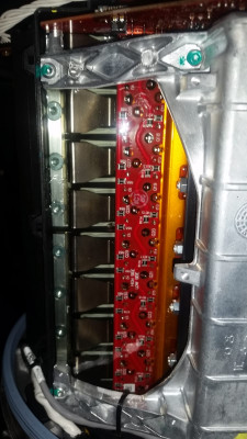

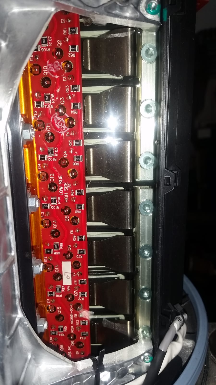

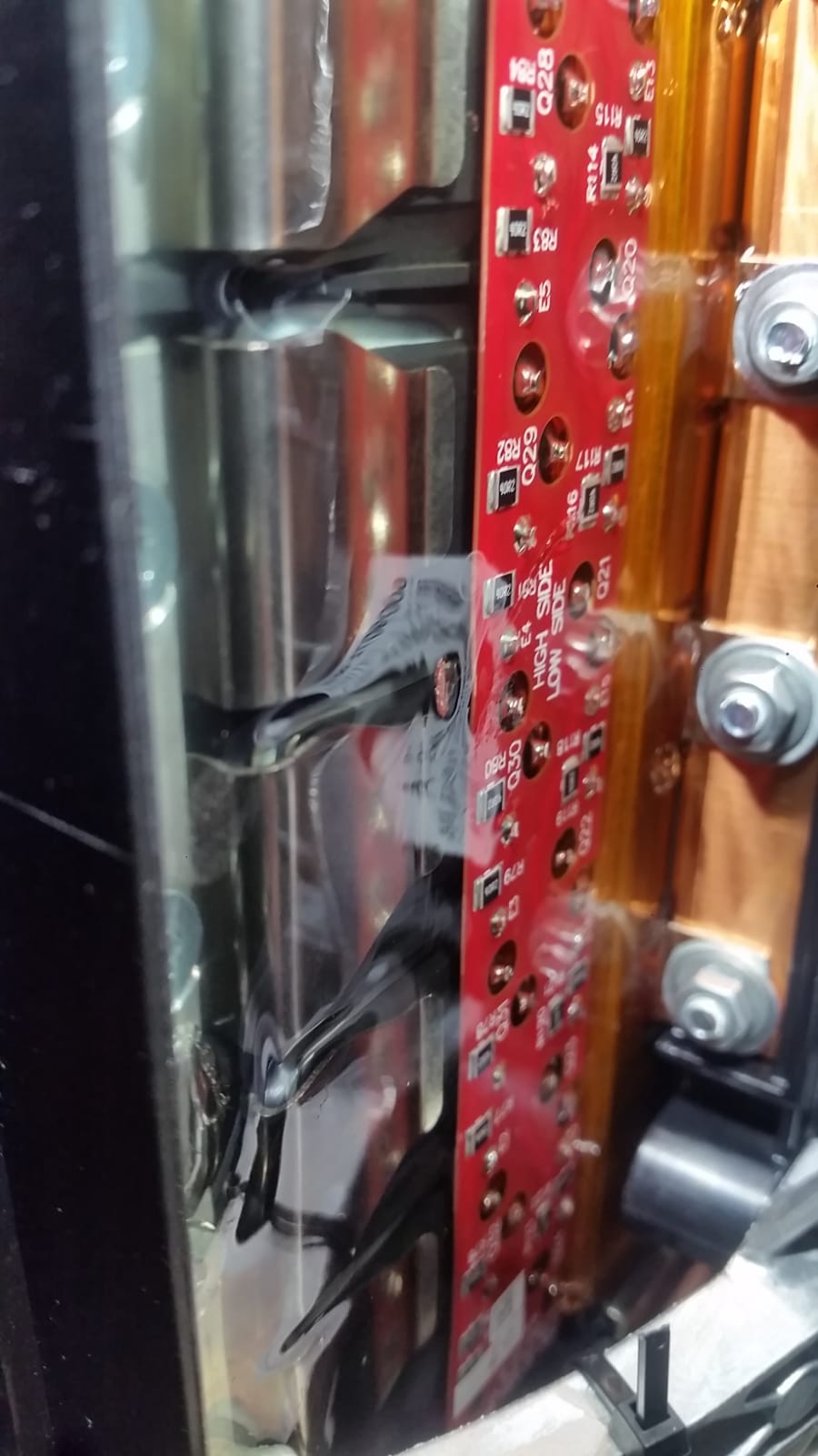

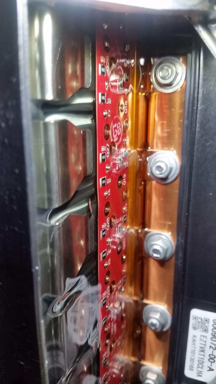

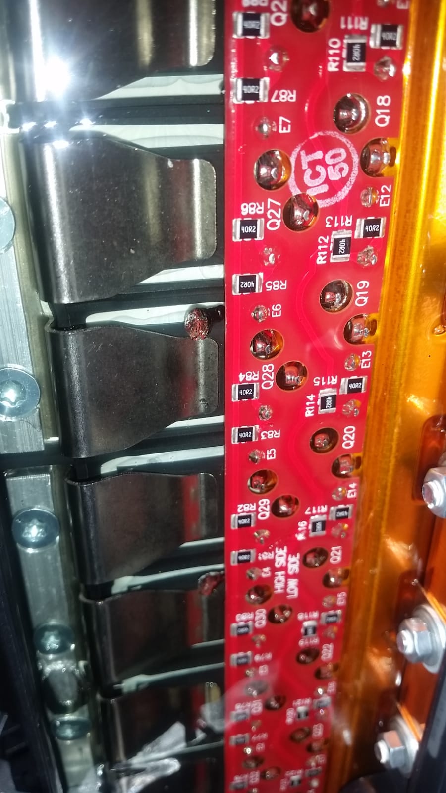

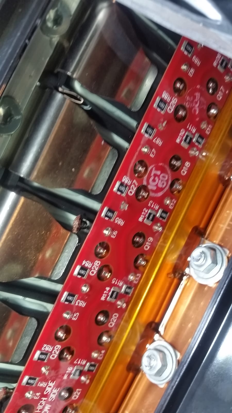

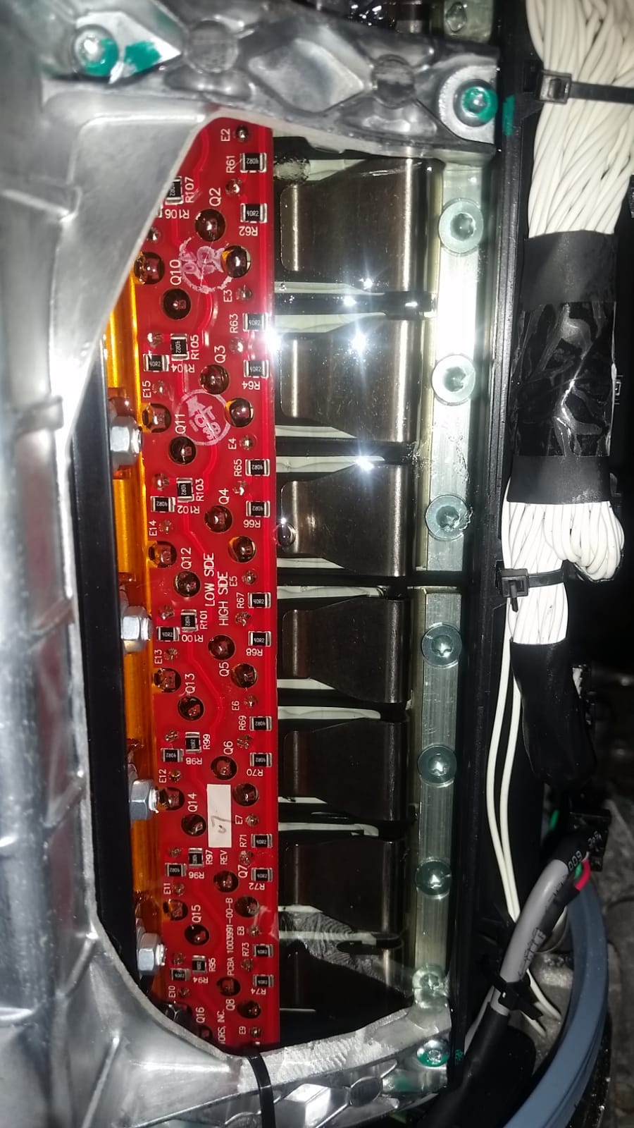

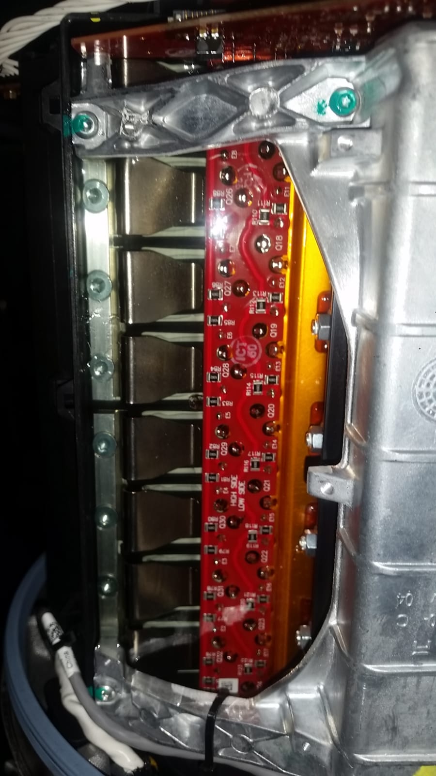

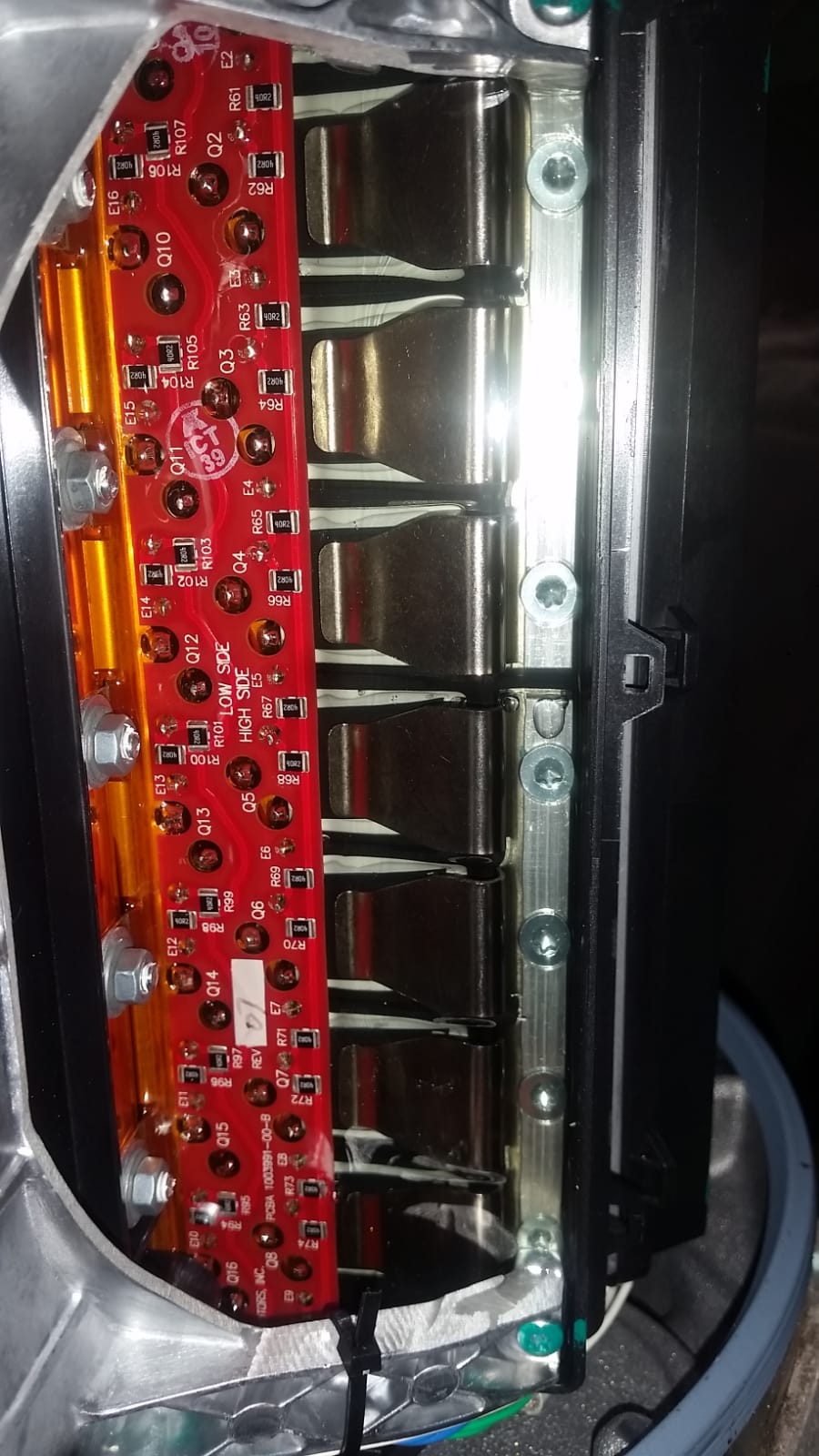

I just looked at the IGBTs after seeing a picture on page 2 in the LDU Threat.
Phase 1L
Looks OK Phase 1R
Looks OK Phase 2L
Looks like a blown IGBT in the middle Phase 2R
Looks like a Air bubble in the middle Phase 3L
Looks like 2 blown IGBTs Phase 3R
Looks OK It looks like life fucks me hard
what is the best way to go about checking the functionality?
test with low voltage i seen. witch voltage is good for save begin ?
I have the following power supplies available:
0-15V 40A
12V 40A
24V 40A
56V? 60A?
Model3 battery 96V
clear first structure according to the circuit diagram when I have the connector
Phase 1L
Looks OK Phase 1R
Looks OK Phase 2L
0-15V 40A
12V 40A
24V 40A
56V? 60A?
Model3 battery 96V

- tollerteppich
- Posts: 34
- Joined: Sun Feb 07, 2021 10:39 am
- Location: Hannover/Germany
Re: What Drive Unit is the best for Me ?
I got over the first shock tonight, I think.
I took a close look at everything this morning.
it gives the impression that there are only air bubbles.
the surface of the gel looks undamaged everywhere, that gives me hope that there are only air bubbles from the production.
Maybe jon volk can take a look at whether it looked exactly like that with him or whether it is different.
i took pictures and a video where i shine with the lamp from different angles.
I don't know exactly how to proceed.
Should I try to exchange the motor or give it back?
or to try to let it go first. Unfortunately I don't have the plug from ZeroEV yet.
if it is really broken and i don't get it exchanged i have turned a lot of money into smoke.
i checked the mouser website. The IGBTs alone cost around € 460 if all 96 pieces are identical. in such a case I would swap everything. questionable whether this is mechanically possible or whether the IGBTs are ultrasonically welded or something. i don't know i'm watching damien's teardown video.
a lot of questions ... it's really annoying.
i underestimated the emotional differences, from euphoria to excessive disenchantment. it is violent ...

It's the coppery throwout that looks scary. Did it come like this or did it happen to you?
With a multimeter in diode mode you can make some simple checks. You put positive lead on phase leg and negative on positive DC terminal. That should give you 0.3V diode drop. Likewise negative on phase rail and positive on DC-. Blown IGBT usually short circuits this path and you get 0V.
