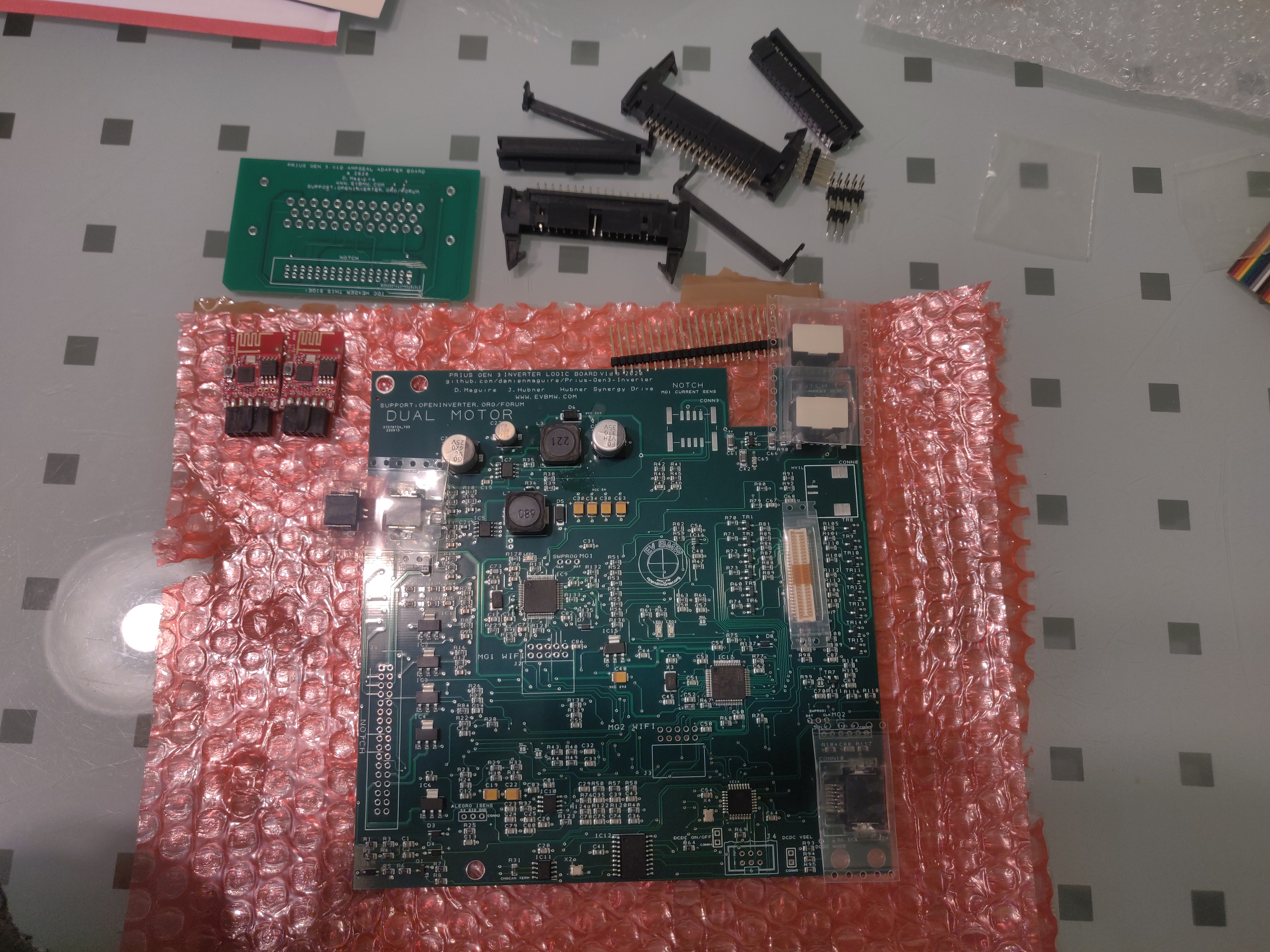

I have 2015 toyota prius C invertor part number on pic
can i use the control board ( Prius Gen 3 Inverter Logic Board Dual Motor Kiе Pri_G3_built_v1d ) with this inverter ???
Re: Help! Prius C inverter Dual Motor Logic Board ...
Posted: Tue Dec 15, 2020 3:25 am
by Abricosvw
i finished assembly brain board
and the size of the board is little big but that's not a problem

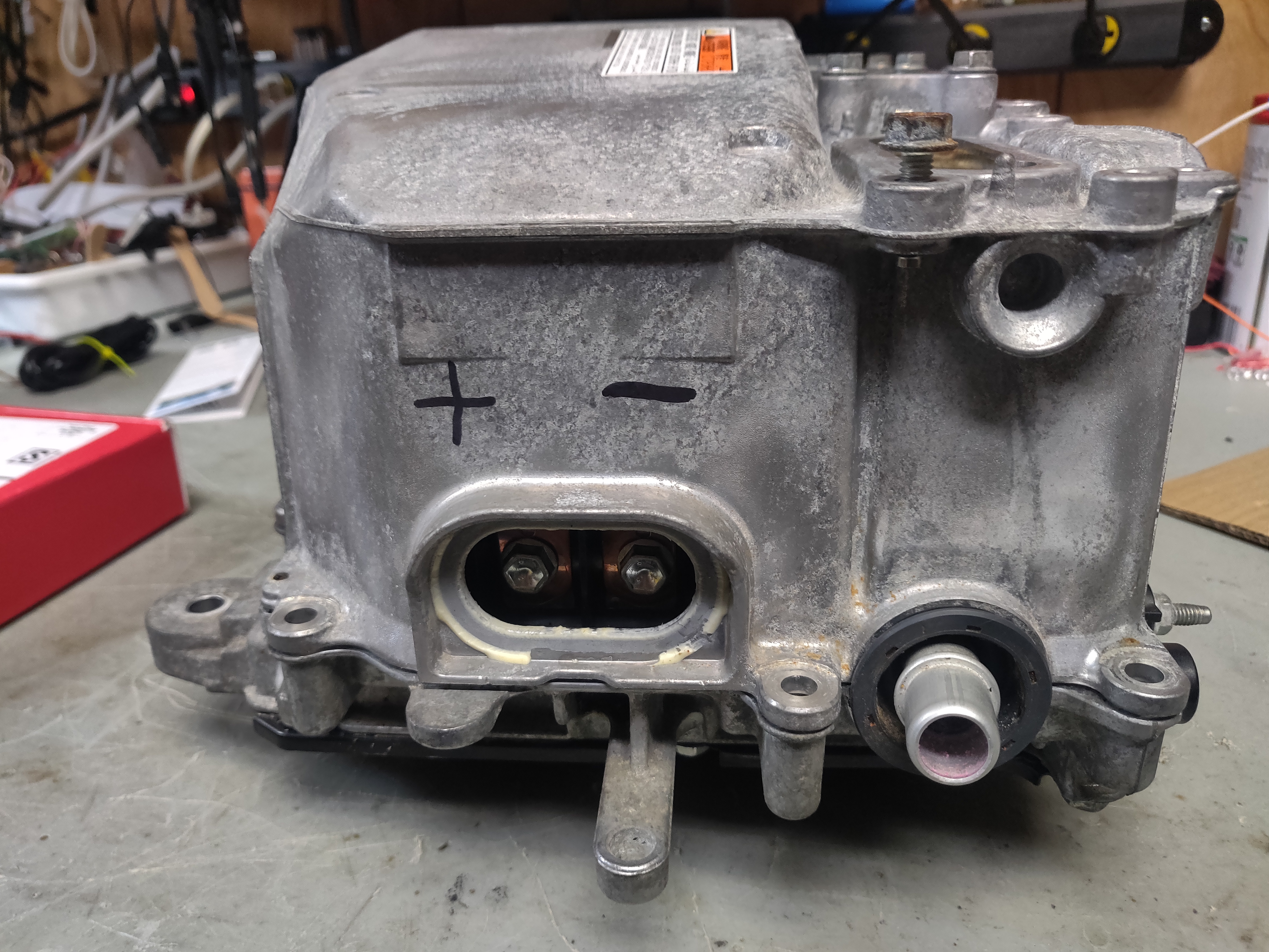

also i'm confused on which side to connect high voltage
somewhere in the photo and video on one side somewhere another side
which one is correct ???
pic #1 or pic #2
#1
#2
Posted: Tue Dec 15, 2020 3:33 am
by sfk
Pic 1 with the 2 connectors is DC and for the battery HV lines.
Pic 2 with the 3 connectors is AC and for the motor HV lines.
Wrong. Sorry

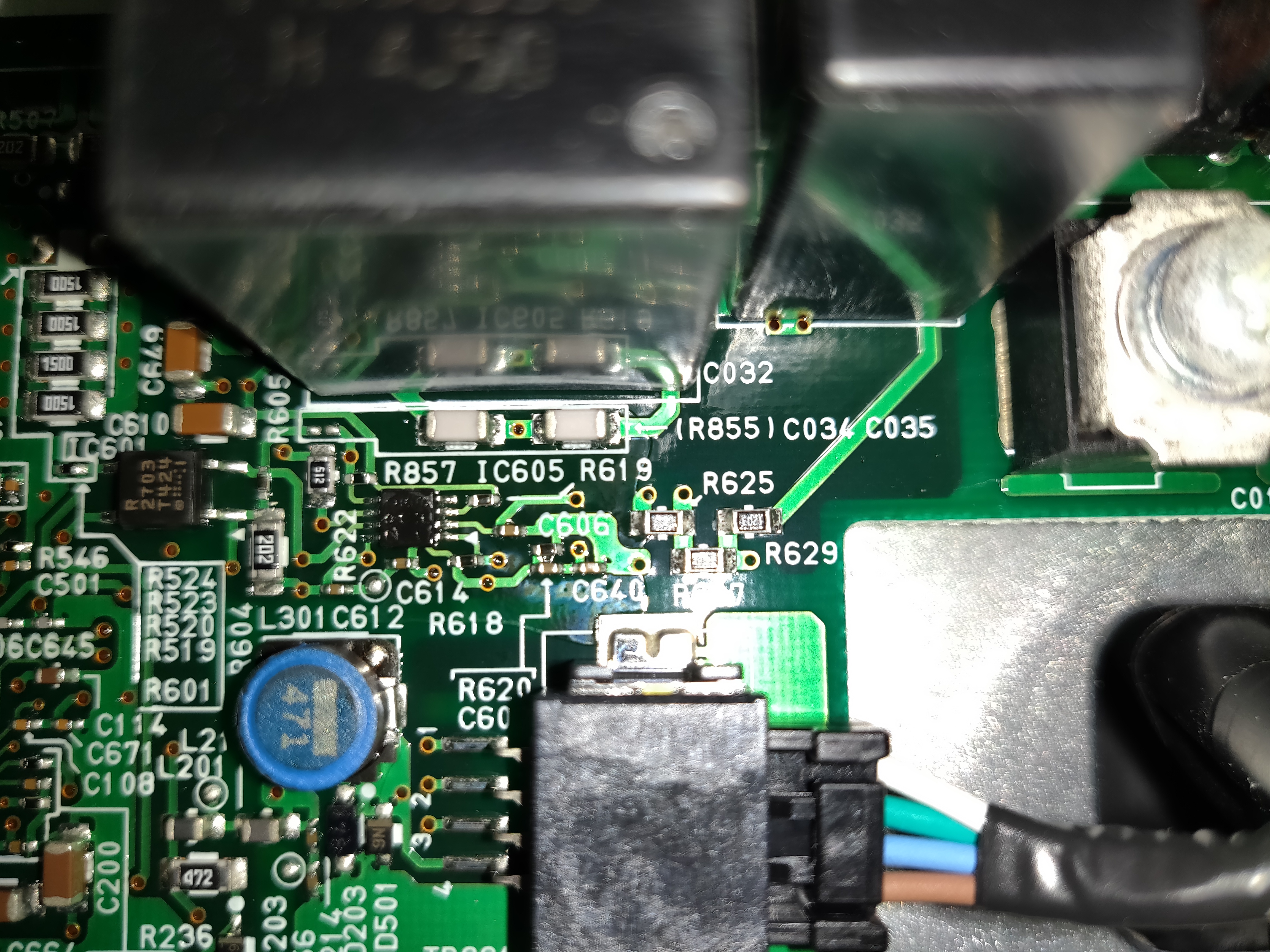

also I could not find the part number of the capacitor ???
which I need to install in order to be able to use Yaris inverter with an input of 400V DC
and as I understand it, I need to change 2 sets of 4 resistors: old 120kohm with new 210kohm (1%, 0.5W, 0805, Manufacturer part#: ERJP06F2103V Farnell #: 2326773 )
Top side: R629, R627, R625, R623
Bottom side: R630, R628, R626, R624
In USA found only Mfr. #:ERJ-P08F2103V this is a large package size but should fit...
Posted: Fri Dec 25, 2020 3:16 pm
by celeron55
sfk wrote: Tue Dec 15, 2020 3:33 am Pic 1 with the 2 connectors is DC and for the battery HV lines.
Well this is certainly wrong.
You can connect DC voltage to either of those, altough I think now it's recommended to use the ones in pic 2 because they are closer to where DC originally is connected to.
The motor connectors are at the top, not visible in these photos.
Posted: Tue Dec 29, 2020 9:59 pm
by kalebludlow
Probably should remove this misinformation. Can't be confusing people
