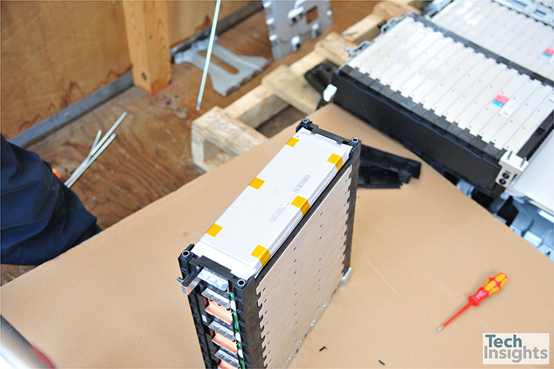

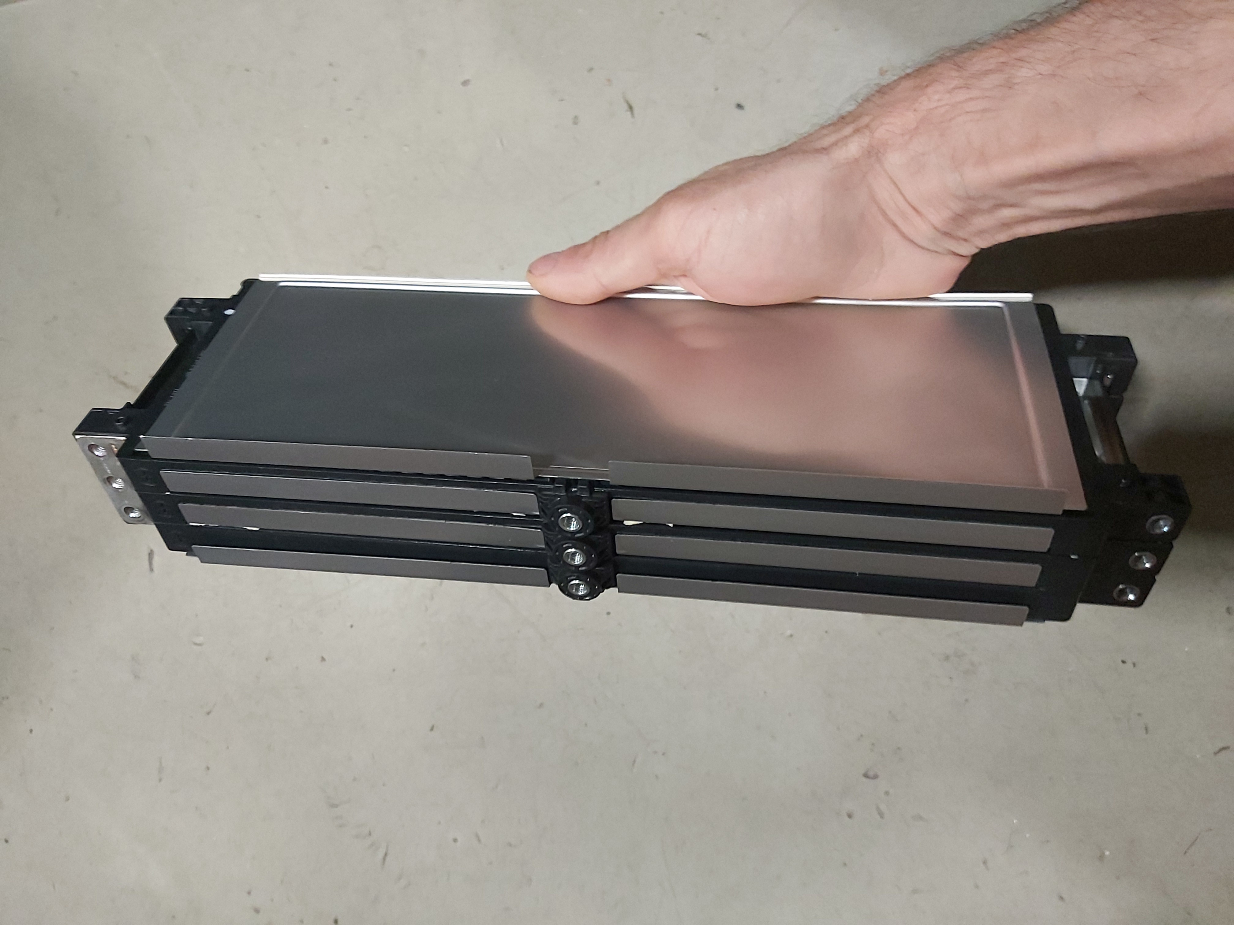

Here is what I found out about the various Leaf packs:
- 24 kWh: 48 modules 2P2S 7.2V
- 30 kWh: 24 modules 2P4S 14.4V
- 40 kWh: 24 modules 2P4S 14.4V (Up to here 192 cells total)
- 62 kWh: 24 modules 3P4S 14.4V (288 cells total)
Apparently the 30 and 40 kWh packs are more or less a drop-in replacement as I installed the packs in two equal sized rows. In summer conditions a 75% charged 24 kWh pack gives me about 80km of highway range. A 40 kWh pack would give me 130 km.
The 62 kWh pack would take up more space, I would probably only fit 16 modules under the car and would have to find space for the extra 8 ones.

I would hazard a guess that Kona and Bolt have practicaly the same 60Ah LG cell as Jaguar IPACE.clanger9 wrote: ↑Mon Dec 07, 2020 4:51 pm I started to compile a list of OEM battery modules on the wiki: https://openinverter.org/wiki/Batteries#OEM_modules
Hopefully useful. If you find any more details, please add them...![]()
In Kona it is NCM622 chemistry configured as 96S3P. https://www.speakev.com/threads/kona-ba ... ec.110601/ In Chevy Bolt there are 96S3P also NMC 622. https://www.techinsights.com/blog/revie ... powertrain
I dont know if this article is assumption or fact https://electricrevs.com/2018/03/09/jag ... in-common/

Does the 40 kWh BMS talk the same CAN language as the 24/30 kWh one? Because I read you need to do some CAN spoofing to fit a 40 pack in a 24 Leaf.
- Extremetaz
- Posts: 54
- Joined: Thu Sep 19, 2019 9:35 am
- Location: Kildare, Ireland
Re: Different Nissan Leaf packs (24, 30, 40, 62 kWh)
Nope, 40kWh LBC won't talk to the legacy VCM. Requires a MITM.
Muxsan and EV's Enchanced have solutions off the shelf (I used the former).
If you're up for the challenge, no reason why Damien's one wouldn't work just as well.
You'll need to capture the battery ID codes from the old pack one way or the other in order to keep the VCM happy.
