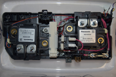

While I am certainly NOT an authority on the subject, some thoughts on the above and second HV relay question...
1) You may be able to take the drive plate off the engine and use the hub to verify fitment or make an adapter for the out drive.
2) The one I have, on a Leaf relay board, is 30 ohms
3) Depends on your power and voltage; Prius is like 125A, not sure about the Leaf
4) Most use a relay for both the HV + and HV-, I think doing so is VERY wise.

by ZooKeeper
Leaf Relays
Leaf Relays
Here is a relay board from a Leaf.
