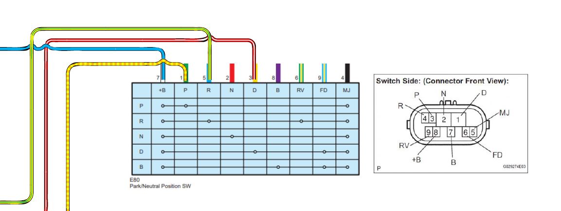

To round things up with my final stupid question :P is the drive selector component - again since I don't have one I figured I'd use something like this https://zero-ev.co.uk/product/gear-sele ... nversions/ but am actually unsure what this component actually is. It looks like it just creates a closed connection(12V) with the corresponding pin for Park, reverse and Drive

third is the gear selector on the transmission side the lever arm feeds back a signal based on its position, you could wire this up or something else.

yeah there is a lever and a socket for position signal, probably best going through Damien's deep dive video

This is the socket

so now that i'm looking at it - is the mechanic level mechanically switching it and the connection is then telling the VCU what direction it needs to go?
Re: Couple stupid questions
Posted: Mon Nov 23, 2020 6:20 pm
by sfk
The gear shift lever inside the car is connected to a metal rod which is attached to the arm of the mechanical switch in the photo posted above. The position is encoded and sent through the wire back to the VCU. Why on earth they didn't just encode this signal at the gear select lever and send directly to the VCU is not known. I imagine it's because they wanted to use 1 setup for all versions of this car's drivetrain, including the non hybrid ones. But still, no transmissions require a physical rod connection to shift drive modes now. They're all electronically shifted aren't they? Perhaps it creates the right kind of "shift feel" that people like??

So you need to use the mechanical switch to then tell the VCU and the transmission what to do. kind of seems redundant if I understand that correctly. Anyone know how park is handled? is there a mechanical lock like in a leaf motor gearbox?
Posted: Mon Nov 23, 2020 7:08 pm
by slow67
The GS450h does have a mechanical parking pawl actuated buy the mechanical linkage like a traditional automatic transmission
