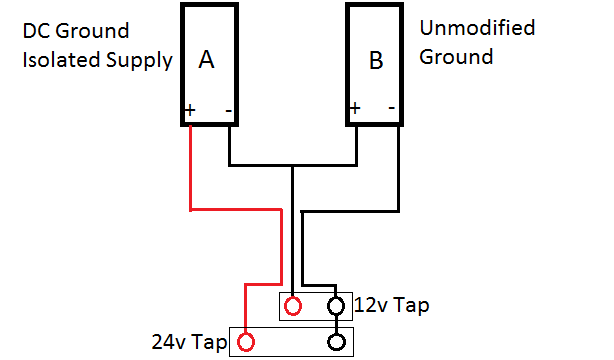

I've used 2x IBM (ARTESYN) for 24V. Isolation important! + a signal wire. (server power supplies do not turn on by themselves)
Server PSU 24v Wiring Diagram rev4.png (6.66 KiB) Viewed 3026 times
Here is info for the IBMs https://www.rcgroups.com/forums/showthr ... 42A-to-24V

dima wrote: Fri Nov 13, 2020 5:59 pm I've used 2x IBM (ARTESYN) for 24V. Isolation important! + a signal wire. (server power supplies do not turn on by themselves)
Normally, yes isolation is important and that RC forum is where I started too! I'm not sure what you mean by "by themselves" but the way you "jump" or "hack" them is by bridging pins, I have mine soldered so...mine turn's its self on?
My power supply runs on 220VAC/DC so it's not tied to ground at all. I know, dangerous. In addition the power sections of my power supply are tied together. So there is no need to modify any of the ground planes and the order of the supplies in series doesn't matter either. This also means I can just add on PSU's in series to get higher voltages
