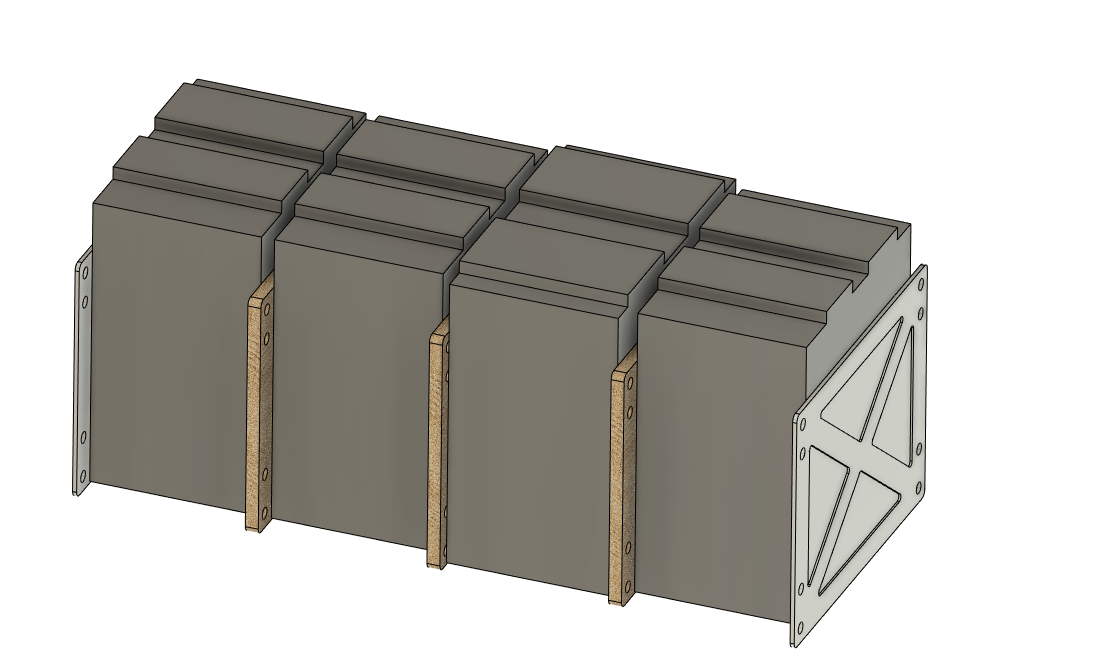

Thought I would add to this thread rather than the project thread as it seems applicable to quite a few others using pouch cells.
So I've been working on making up my battery with the kokam cells. From what I have gathered keep them compressed or at least not allowing them to expand is very important.
I was originally going to make up some steel plates to go either side of my 10s modules, held together with threaded bar. However with 2mm plate that was going to add 12kg of weight. I thought about using aluminium along with some CNC fiddling to reduce the weight.
I am now leaning towards making up the modules in two rows of 4 for my battery box, and using 10mm wood sheets in between the modules to help keep the contacts of each module separate and also to help with the compression. Wood is lightweight, works well under compression and really in the case of fire the material isn't going to make all that much difference if the cells are burning.
2021-10-17 19_36_07-Autodesk Fusion 360 (Personal - Not for Commercial Use).png
What do we think? Seem reasonable?
