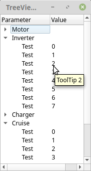

Had a bit more of a think about this and have decided that the current gui could really do with a proper update, the fixed OI parameter fields were nitially quick to do but are now too inflexible and too easily broken by OI code changes. The above idea goes some way to fixing, and the param::change move will still be needed, but I think there is a better solution.
The plan now is to change the OI parameters section of the gui to show a collapsible tree view of the full OI parameter set in much the same way as the OI web interface. This will allow full access to any current or future parameters. The downside is it also exposes a lot of the parameters that are irrelevant to the simulator but the collapsible view should help with that. I'd also like to get the parameter description to show in tool tips if possible (if not it will go in an extra column).
While doing this I'll also add a json parameter import and export using the same format as the web interface functions to make it easier to transfer setups between real installs and the simulator configurations. Probably also make it so that it automatically loads the last json on startup to avoid having to edit the param_prj.h file too.
The last change will be to add import and export for the motor parameters, again using the json format, and the creation of motor files for the common motors (Leaf, Outlander, MGR, etc) to make it easier to switch between setups.
This is probably going to take a few weeks to get to though so in the meantime I suggest sticking with 5.24 for simulation.
Edit - Might not be as big a job as I first though, just had a quick play with the Qt QTreeView widget and it does most of what's needed (even the tooltips!) :

There is now a new build of the simulator on the "combined" branch. This supports both F103 and F405 builds so will hopefully simplify my life maintaining it in the future.
This should be a bit more robust to changes in parameter definitions in the OI project. Instead of having specific parameters bought out on the gui it now displays all parameters in a tree view, this means that the gui shouldn't be affected by OI parameter addition, removal or name changes.
The new interface looks like this:
Any field can be edited but only the low level ones will affect the simulator (most of the Motor and Testing ones, a few from Inverter and throtcur).
The Vehicle and OpenInverter panes are now completely independent of each other.
The Vehicle fields, Torque Demand, Mode and Direction are still persisted between program runs.
The OI parameters are initialised from the OI project param_prj.h file on program start. Either edit this file to suit your defaults or use the new Load button to re-initialise them.
Buttons have been added to allow parameters to be saved or loaded.
The OI parameters buttons use the same format as the web interface so should be compatible (although warnings will occur if moving between different OI versions with different parameter sets).
The Motor buttons just load or save Lq, Ld, Rs and Flux Linkage. The idea is to generate files for each of the common motors but that will have to wait till another time.
