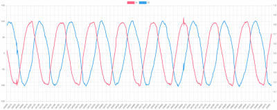

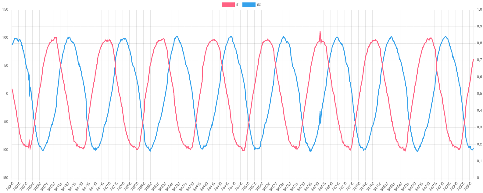

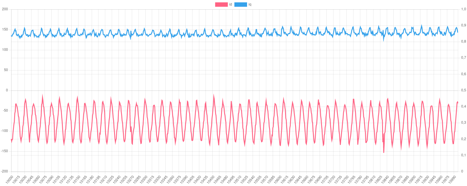

Yes, optimization time.
While Janosch drove from Dover to London I was able to monitor id/iq a bit. Found iq was regulated quite well but id was oscillating really badly, between 0 and -70A or so while cruising the highway. I think I'll add an extra kp parameter for the id controller, it seems it must be lower.

Unless you have already ruled it out by plotting Ifw I'd be more suspicious of the field weakening controller causing the Id oscillation, especially if it's at higher speeds.
Something along the lines of FW starts to come in (-Id increases), torque drops slightly, motor slows slightly, FW drops slightly (-Id drops), torque increases, motor speeds up slightly and repeat. Could probably simulate it by modelling steady state driving uphill (to simulate drag) just as FW starts to come in and see if it happens.

Well ifw was at 0 at that point. We drove in 4th gear at 4000 rpm or so, far away from needing FW.
I've compiled a firmware that allows setting iqkp and idkp separately and will test it later in the week.

Occurred to me that it's going to be very slow to reproduce this with the sim as is because it always starts from 0 so will take ages to get to steady state. To fix this you can change a line in the restart() function motormodel.cpp from m_speed=0; to say m_speed=10; (where the units are vehicle speed in m/s). The simulation will then start at that speed each time (the data will go a little crazy for the first half second at higher starting speeds while the controller tries to synchronise to the already spinning motor though). Probably worth adding this as a simulation parameter at some point in the future.
I've given it a quick try but can't reproduce any instability in the FW controller but then I may not be operating it in quite the right speed/power area.

That's pretty conclusive, can't be the FW controller.
It's not surprising that different kp values could be needed for the two controllers, the measurements for Lq and Ld have been showing a significant difference between the two.
Wondering whether it would be possible to actually scale the Q controller kp value by the ratio of Lq/Ld to get to a value for the D controller without having to add another parameter? Essentially have Lq and Ld parameters and then calculate lqminusld and the kp scaling factor from them. I'm also wondering whether this could be taken a stage further and the two kp values actually be calculated from the Lq and Ld values so avoiding the need to tune them - no idea whether it would work but could be worth a look?

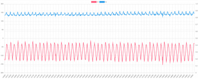

Here are some plots of currents. As you can see iq is nicely controlled while id jumps all over the place. With the hill-hold function it looked like LARGER idkp actually helps reduce oscillation. In movement I couldn't spot much difference between idkp=16 and idkp=100. iqkp=60 all the time.

Not convinced that's control loop oscillation, it looks too stable.
I'm more wondering whether it is a harmonic/saliency. It would be interesting to see whether it is phase locked to the motor current?
Edit - If those two plots are on a similar time scale then I'm pretty sure that's a harmonic current that the control loops are too slow to handle. Been discussed before somewhere on one of catphish's induction motor threads and there was a link to a v.good article on it but can't find it now.
Edit2 - Found it - viewtopic.php?p=52161#p52161.

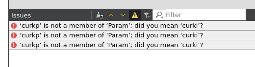

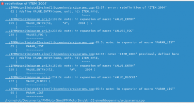

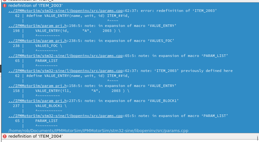

Just a FYI, I think the simulator might be broken with the latest release (2weeks ago)... I am am only amateur will dig a bit more and report back if i find an easy fix.

Looks like it's due to the changes on the param_prj.h file in the new release, probably just needs the Qt project version of the file updating to match the new format. Will try to have a look in the next day or so.
Pete9008
- Posts: 1801
- Has thanked: 102 times
- Been thanked: 351 times

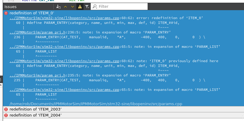

Wondering whether the param_prj.h file in the simulator project directory could now just be deleted (the one in the OpenInverter source code would then be picked up and used by Qt instead and would still need modifying to suit your motor). If so it should fix the above problems.
Trying to remember why the replacement file was needed, think it was primarily to override the resolver, pinswap and syncofs values which could cause problems with simulation. However, the simulator should now override these in the code so the param_prj.h file changes may no longer be needed.
I'll hopefully have a look at it in the next day or so but in the meantime deleting the file might be worth a try as a quick fix?

Delting the file almost works....
- Been thanked: 1918 times
Ah that's because these kps have been split into idkp and iqkp
Will need to be accounted for by adding an edit field to the GUI
