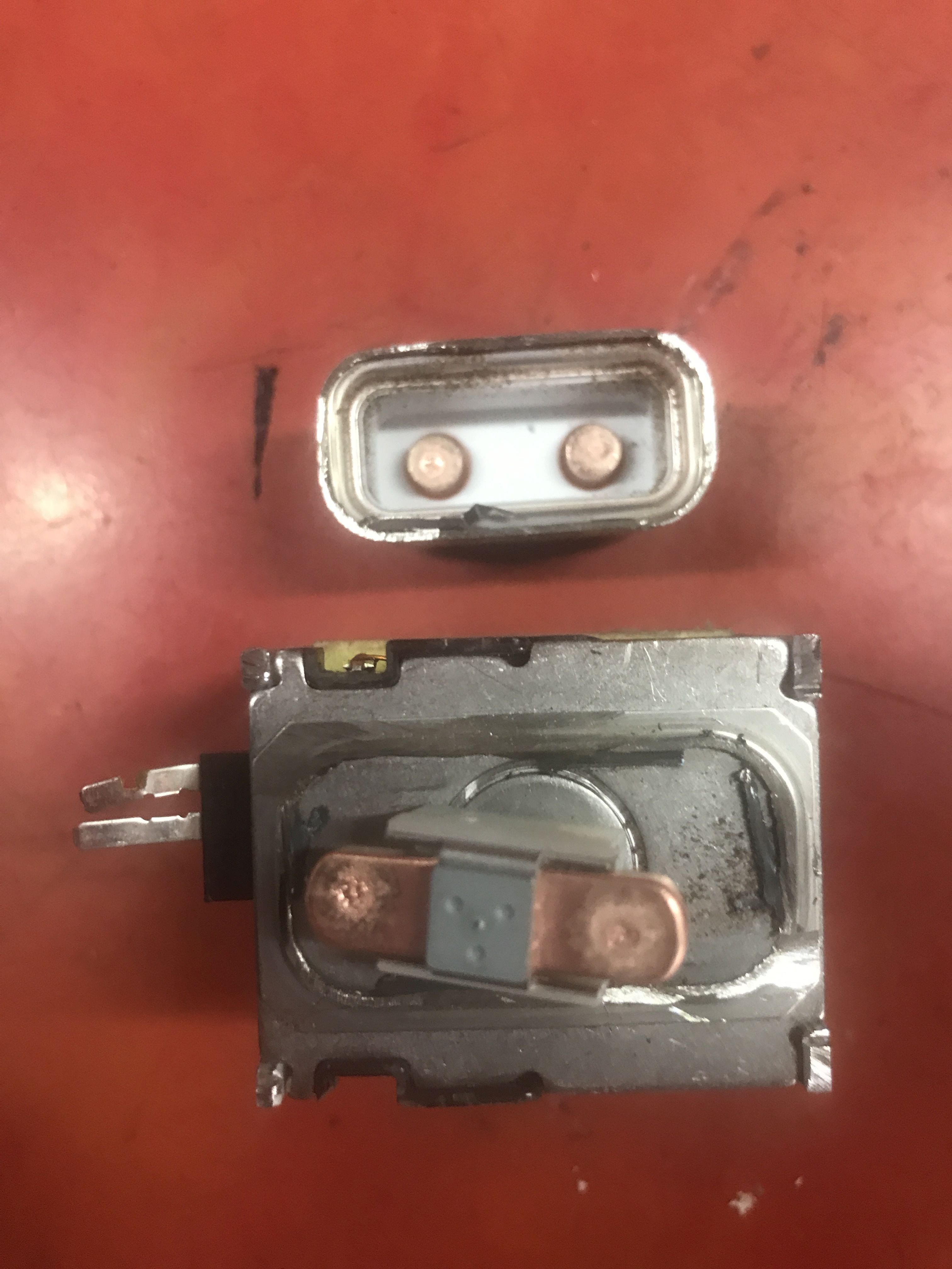

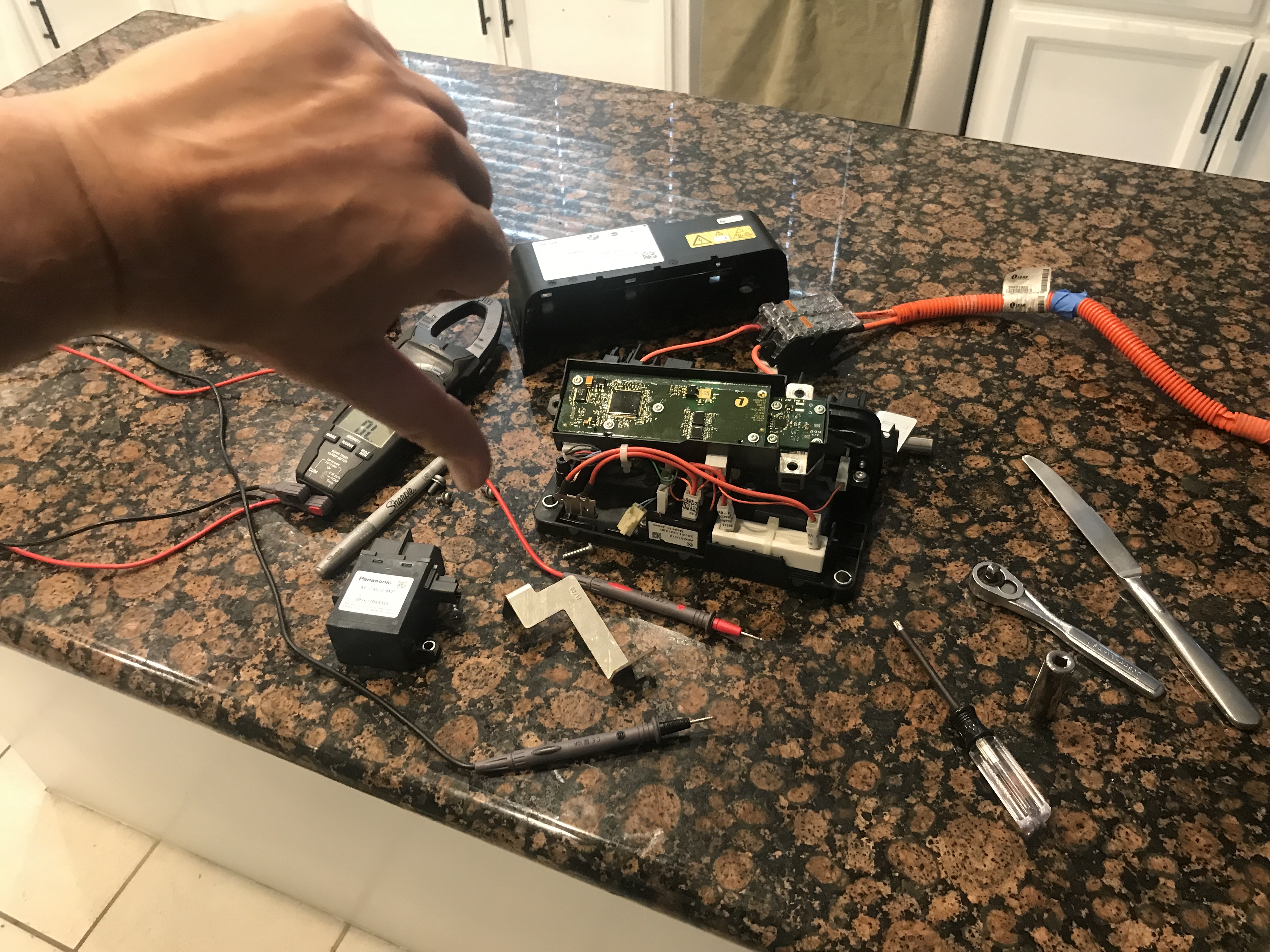

HOUSTON WE HAVE A PROBLEM
so I go to make a high voltage connection from my Chevy Volt charger to my fuse box which is already connected to the Safety Box and serving the DC DC converter, but something tells me to check the voltage first with a multimeter, so I do that and I got 200 volts DC live on that fuse block, that shouldn't happen the S-box is OFF ?!?!
um, no, no it is not, I can NOT turn off my BMW Safety Box, oh it clicks like it is turning off but the voltage remains
a quick audible continuity test and ...
ah yup, both contactors welded shut !!!
it must be a logic flaw in the automated BMW Safety Box code that is supposed to pre charge the inverter and then close both contactors

You can give the contactors a couple whacks with a hammer or screwdriver handle and they should pop free... should.
Posted: Mon Jul 31, 2023 4:38 pm
by Gregski
delgadb2 wrote: Mon Jul 31, 2023 4:21 pm You can give the contactors a couple whacks with a hammer or screwdriver handle and they should pop free... should.

I don't think a sledge hammer was the recommended hammer, but oh well 😅
Posted: Mon Jul 31, 2023 7:10 pm
by Gregski
crasbe wrote: Mon Jul 31, 2023 7:04 pm I don't think a sledge hammer was the recommended hammer, but oh well 😅
this was the positive contactor, I also removed the negative contactor and tried tapping it with a proper hammer to no avail
Posted: Mon Jul 31, 2023 7:14 pm
by crasbe
To be fair though: A once welded contactor usually has a pretty severed degradation of the contact surfaces, leading to either a unreliable connector or repeated welding in the future. It might be fine, it might not be.
Either way, a contactor that loses contact mid-drive or a contactor with high resistance, leading to higher power dissipation is pretty undesireable.
