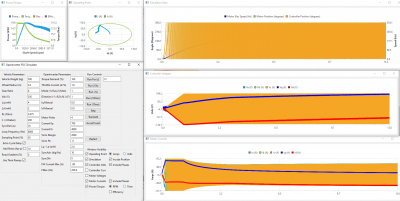

Well I have followed the wikipedia pages as close as I can think of and have things happening
Waveforms are not the same as in wikipedia, I have attempted to make all the settable parameters exactly the same:

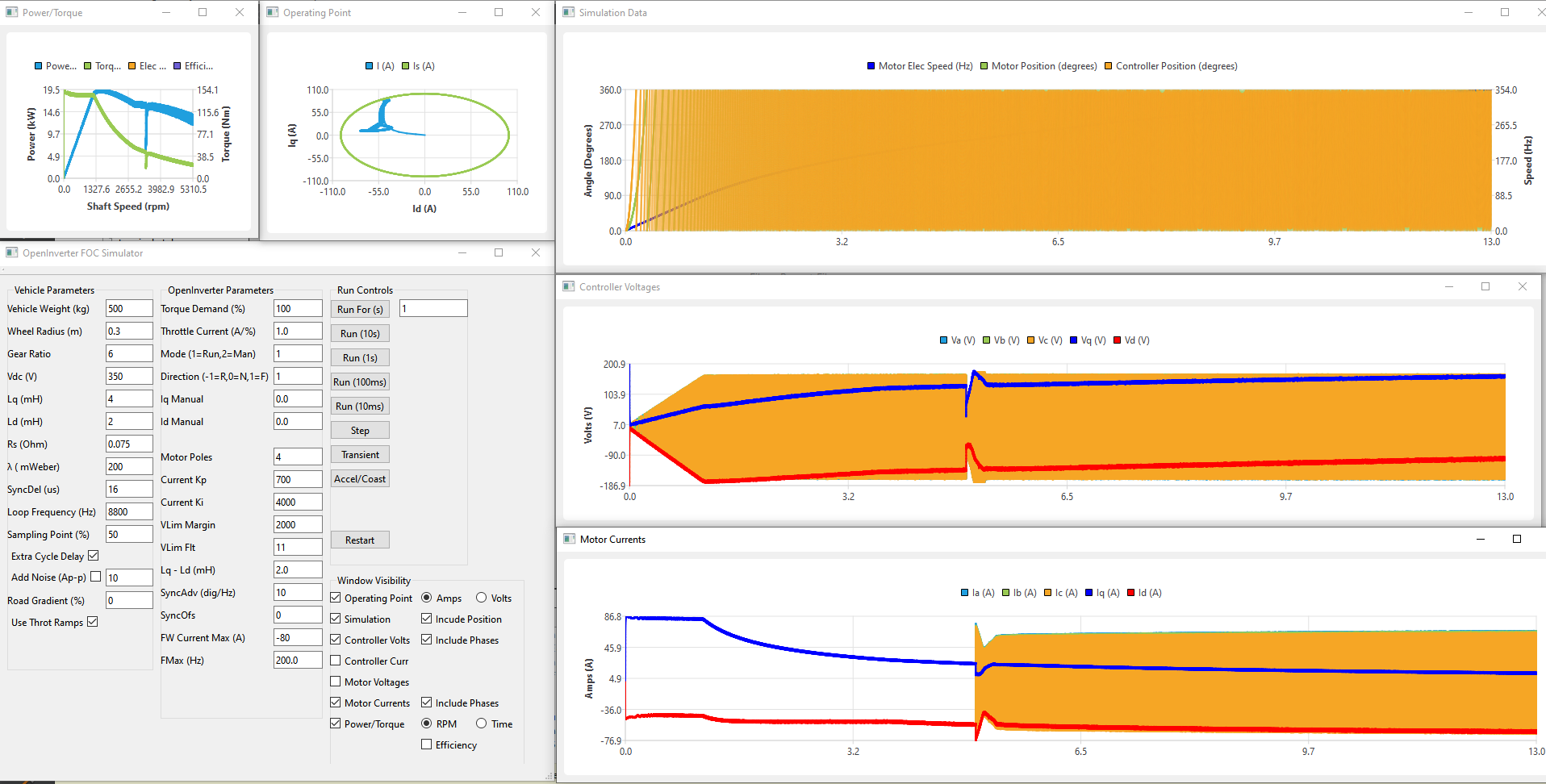

Looks like you're getting there
There are a couple of things that don't quite look right though. In particular the discontinuity you have at around 5sec and the sudden appearance of the phase currents in the Motor Currents graph at that point. The trajectory on the Operating Point graph also looks wrong.
This is what I get with a clean github checkout of the simulator and the last OpenInverter FOC specific build (777271e - Nov 27, 2022) which is what I'd expect to see with those settings: Wondering whether some of the recent sin changes could be having an impact? I'll update my version of the OpenInverter firmware to include them and give it another try.
Edit - Nope, just updated to the latest (git tag 6ff84fc) and I get exactly the same result. Only thought - was your plot from a single simulator run or did you run it to 5sec and then change settings/parameters before running again (but without hitting Restart first)?

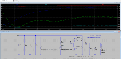

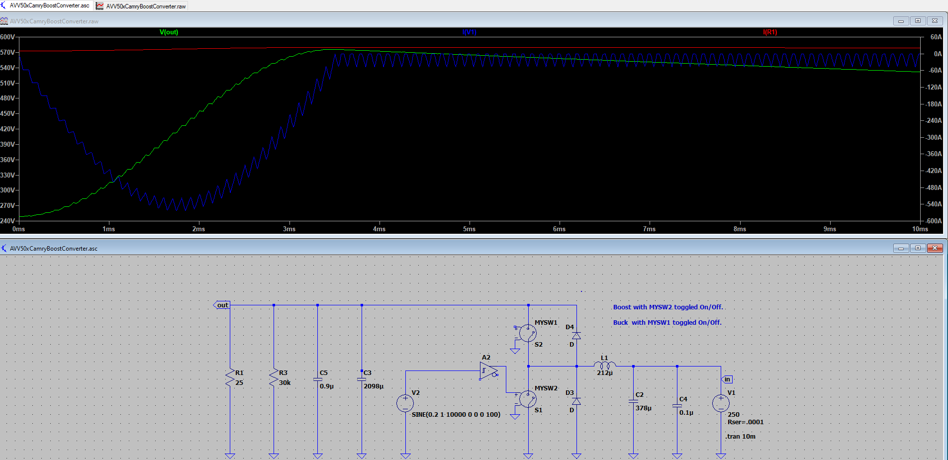

I have made an LTspice XVII model, and have put one graph on the forum:
Operation is more complicated than I thought it would be.
I have included the file as well below.
So far my model only has equal mark / space ratio, but battery voltage and parameter values can be changed.
If anybody wants to, we can explore what this model can do for us with boost.
With this nonlinear stuff, sometimes it is better to use simulation models rather than maths I find.

All looks to make sense but can't quite see what is causing the oscillation in the input current on the RHS of the plot, guessing the inductor and input/output capacitors could be resonating a little? Might be worth also plotting the inductor current to check? If it is then including a little bit of series resistance in the inductor might help clean it up (increase damping/reduce Q).
Not sure you need the flip flop. If you drive the sig gen straight into the buffer you should be able to use the sig gen parameters to set the duty cycle.

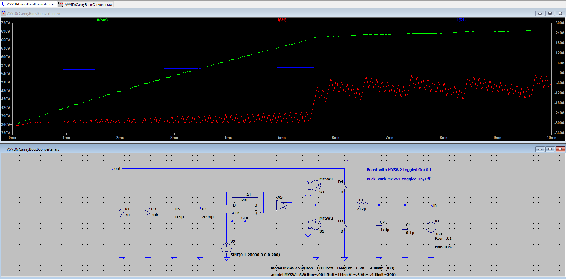

i took your advise Pete and got rid of the D flip flop. But found I could replace it and the buffer with a schmitt buffer. Now I am getting sensible results. For a 250V battery and approx 500V output, current from battery is approx double that going to load resistor.
Also that saw tooth waveform superimposed on the carrier is gone

I can also adjust mark space ratio by adjusting +/-DC offset of sinewave generator. So model becoming more realistic and simpler.

This model now has adjustable mark/space ratio via the adjustable battery.
Very happy with this model, it can be adjusted, and gives realistic values
For this example, I have 3 different mark space ratios for initial conditions, to reduce the large inrush current (slows down speed of getting HV).

Thanks for posting the Prius MG1 data, been hoping to do a bit of simulation to see what it might be able to do for a while now.
I was wondering what to do about the power up current surge as it could saturate the inductor but your soft start does a good job of controlling it.
Might be worth having a look at using the PULSE function instead of SINE for the sig gen. If you give it a Tperiod it generates a continuous stream of pulses rather than a single pulse. You can either use it either with zero rise and fall times and use the Ton argument to control the dutycycle to get a square wave or use Trise and Tfall to generate a sawtooth or triangle waveform to do the kind of control you have above (but more linear). I suppose the next step would then be adding a feedback loop and a comparator to control the switching point based on output voltage to have a fully regulated model?
What's the goal here, are you looking to use it to boost the voltage to the inverter to drive the motor?
Might also be worth starting a separate thread for it to make it easier to find?

So way I will proceed, is use boost converter as resistor during traffic light start, and boost inductor at higher RPMs. I intend putting higher voltage into boost mode than original Gen 2 inverter, AVV50 goes up to 600V I think, (maybe creep up to 550V). I am sure windings will take it. May put my 1000 volt Megger on windings to check it sometime...
If car is too sluggish or converter burns out, will do Romale trick and rewind MG2 for double winding thickness and 1/2 voltage needed, so 350 V battery and no boost will work based on other threads here. [I have access to a motor re-winder or will do myself, have a motor repair book by Rosenberg to help if necessary and also Romale
For this simulation exercise, I wish to make boost converter dance for the above, but also, get boost converter to dance for off grid converters etc.
So like you idea Pete of the comparator. I do have a paper about using variable DC voltage for the inverter, so perhaps will post here or new boost converter site thingy.
My project unfortunately will be the test case for using MG2 and MG1 together, use 50V more than the original Gen 2, the boost converter via Toyota serial bus with zombieverter, and viability of Prius Gen 2. Whoa, feeling a bit giddy.
So intend to start another thread just about boost converters.
Kind regards to all who spent time reading this).

I would like to start a boost converter simulation topic under Software, but cannot find a 'New topic' button, would someone please start one for me,
Kind regards,
Johnspark

Also using the boost inductor is going to seriously limit potential power output,
