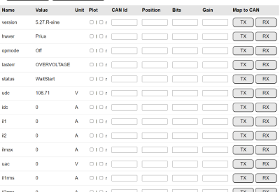

I've had a few misadventures lately and haven't quite gotten to the bottom of them.
Now I turn to the oracle for guidance.
A few weeks back, using a 180v pack and without tuning, I had my car rolling (shuddering) back and forward.
This weekend I set about increasing the voltage and tuning the parameters.
I had a minor(?) incident connecting up 300v yesterday that resulted in (or was caused by) a broken kilovac main contactor.
I got a surge of current on the positive line that melted a copper connector, effectively disconnecting the pack. Wasn't great.
Unfortunately I can't be certain whether the kilovac was 100% before, as I didn't test it that day. Now it lets current pass in open and closed.
I've dropped the voltage down to 240v, and now when the system is turned on, contactors open instantly with an over voltage error.
I've double checked the battery voltage, it's steady at 240, and I've increased the UDCMAX to 300v to no effect.
The inverter turns on and functions as expected otherwise, and there is no visible damage to any part of it.
Is it possible that the initial incident caused the death of another Prius inverter?
Any leads for further investigation appreciated.
EDIT: I get both an over voltage and UDCSW Error concurently.

What does "udc" read?
What's the value of udclim?

UDC is reading as 108.71 volts, pack voltage on multimeter is 244 volts, UDCMIN is 0, UDCMAX is 300.
I dropped the UDCSW to 100v to get rid of the Precharge error in the screenshot below.
My current line of inquiry is that the main contactor was already faulty but that this wasn't exposed when I was testing up to now with lower voltage (had some previous issues with it opening and closing, investigated further but didn't get to the bottom of it). At higher voltage it broke down and allowed current to bypass the precharge circuit in the HVJB, possibly frying the inverter capacitor bank. I was surprised that it caused a surge big enough to melt an, albeit improvised, connector though.

- Posts: 6709
- Has thanked: 368 times
- Been thanked: 1536 times
again, udclim? Set it to 500 or so
The voltage reading is now off but was correct before?

Thanks for the response Johu.
I just got the chance to test again today.
I updated the UDCLIM to 500v, and had the car shuddering back and forward as I tried some different combinations of boost and fweak.
More work to do on that. So far I'm getting DESAT errors when I set boost higher than ~8500, not found a pathway to reducing the vibration just yet.
After about 20 minutes I started getting a precharge error when turning the inverter back on.
Is it unwise to set the UDCSW to zero to avoid this? (If I have to ask, I suppose I already know the answer
